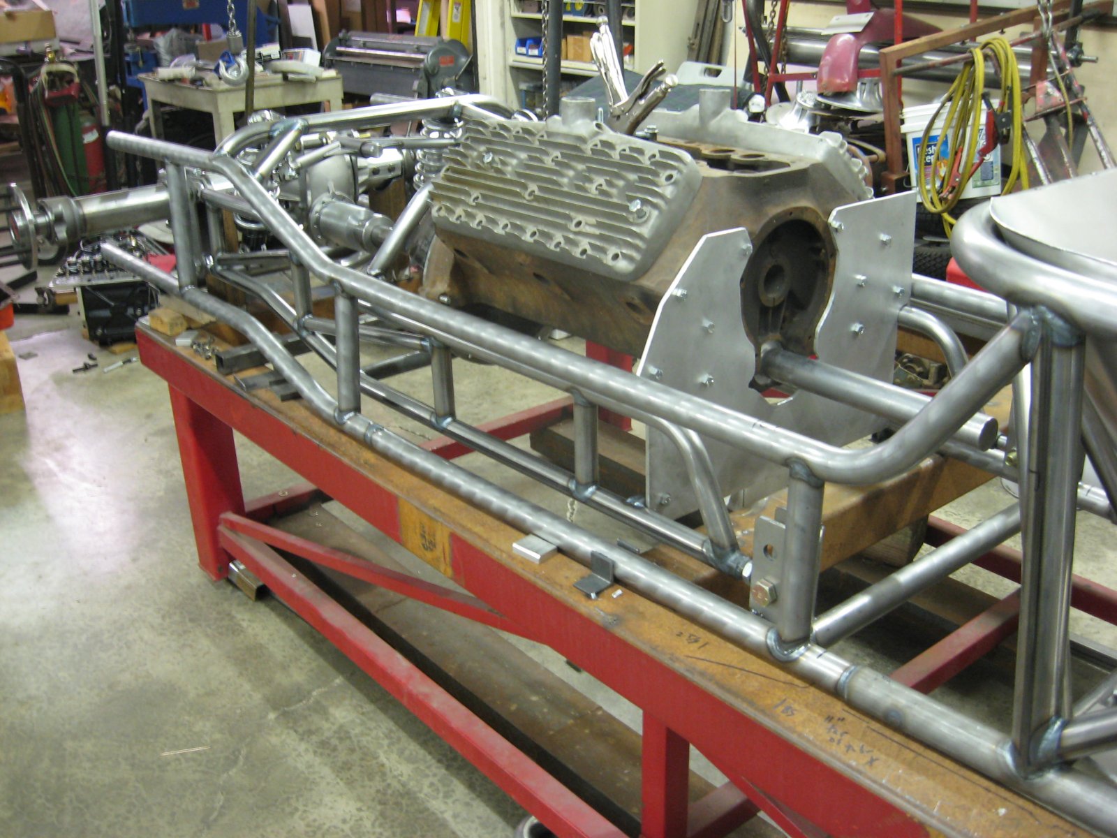

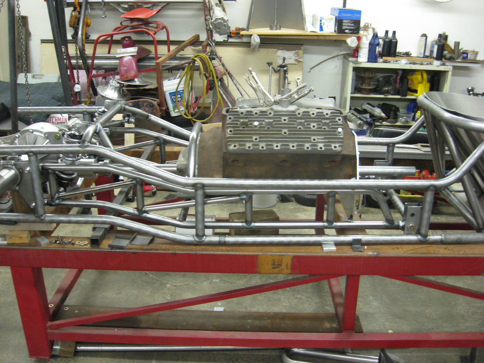

    Here's one for ya. It is simple and it works. JW
  2. 26 T Ford RPU
    Joined: Jun 9, 2012
    Posts: 12,619
    26 T Ford RPU
    And the drivers end. JW
    51 mercules, alanp561, TFoch and 6 others like this.

    Looks relatively simple, sturdy and more than adequate. Thanks for sharing this.

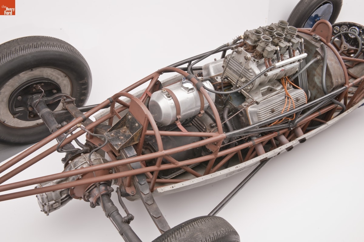

    If you want some rear suspension, and the trans coupled to the rear axle, you might think about a swing arm. IMG_3878.JPG IMG_3877.JPG

    That would be better for the street. This is a Land speed car. Don Waite built a mid engine roadster with swing arm in the 50’s.
