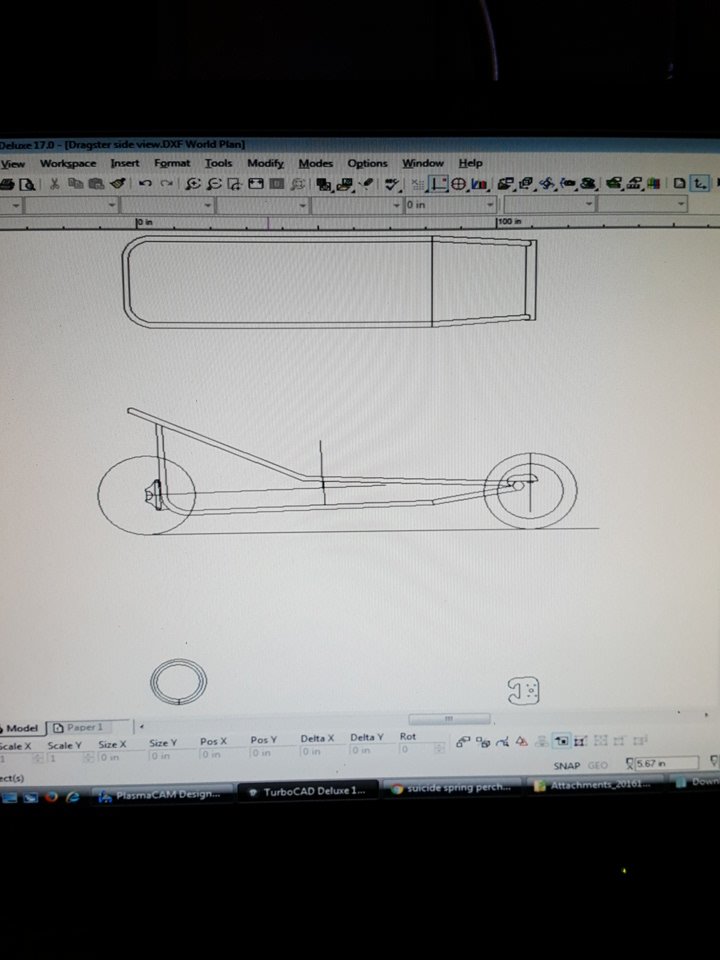

    A small group of us have started getting together one night a week to build a few NW Vintage dragsters basically HAGR's with a little looser rules. We have been pooring over Marty Strodes builds and basically monkey see monkey do for the first one, making alterations for the components we chose.
    After some mockup with a powerglide and a 250 6, we have our basic design in cad.
    We are using T front suspension and a pair of modified Harley 19" front spoke wheels for the front end.

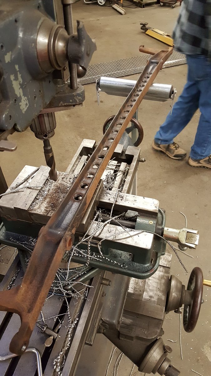

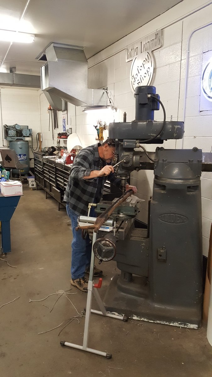

    Here is my old man (Steve) getting the T axle down to race weight.

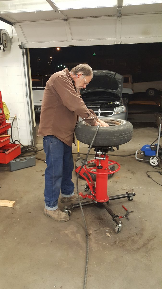

    Randy pulling some wheel centers to fit our Lincoln 9" rear.

    Simplicity is the key to a good design. Nice.

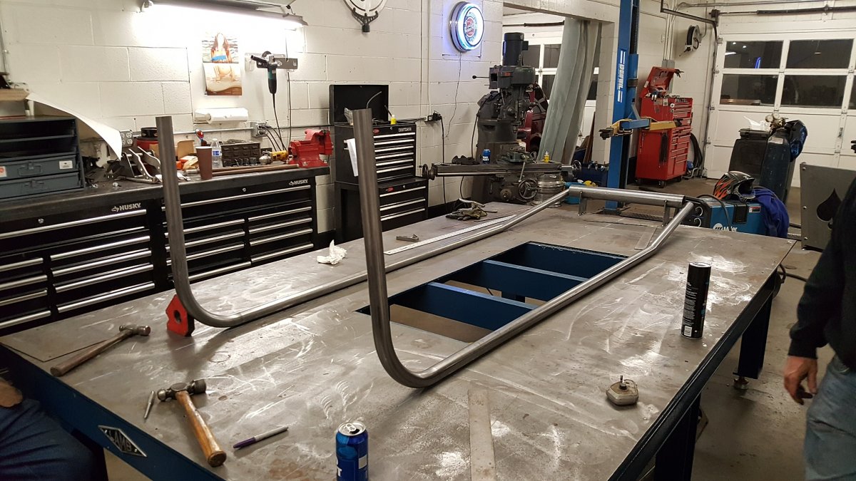

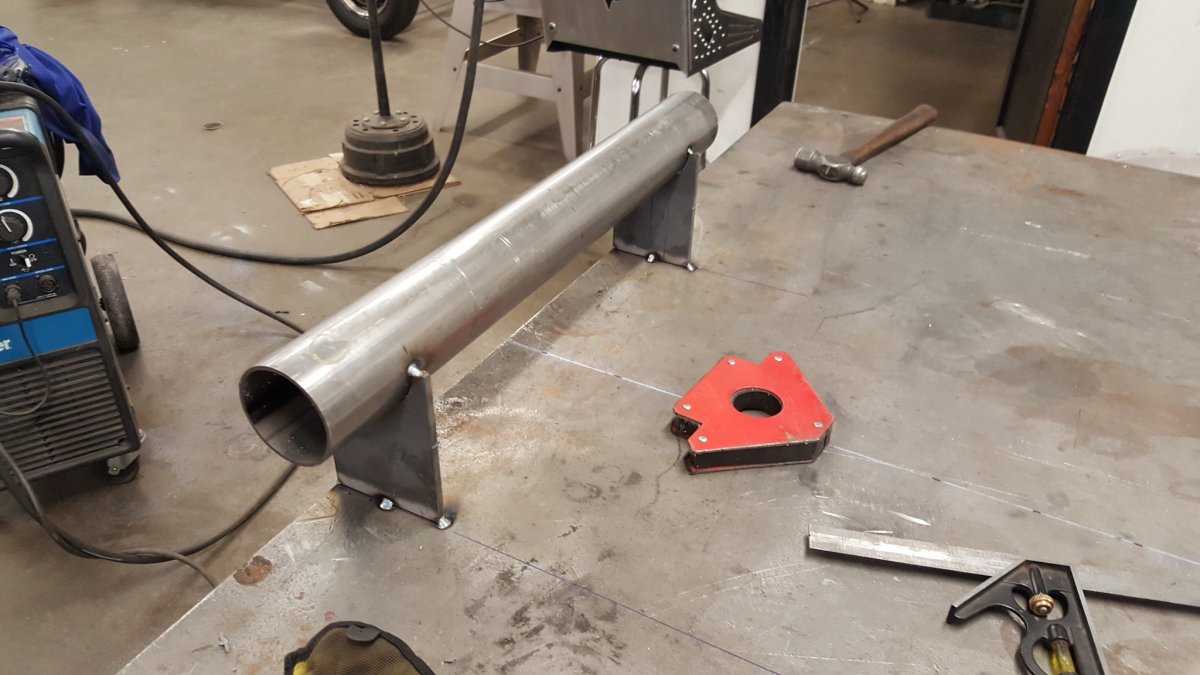

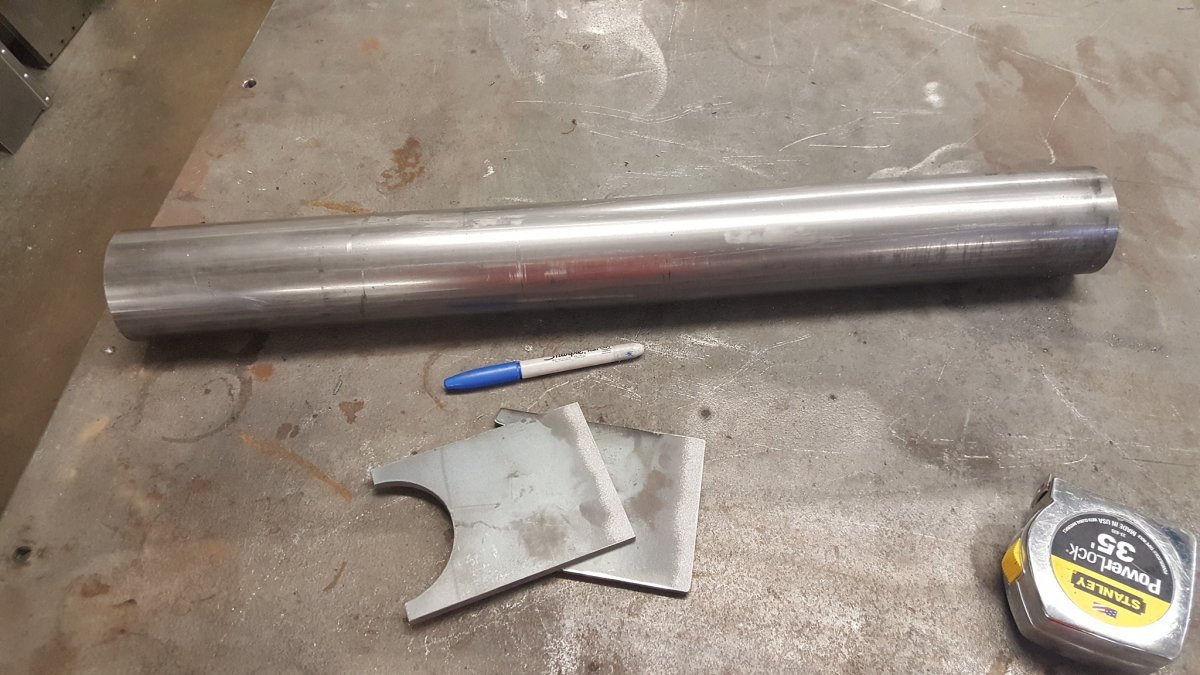

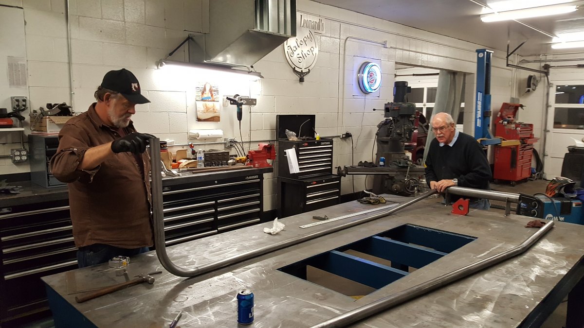

    Then it was on to cutting tube, here is the front crossmember out of 3" .125" wall erw. i cut some stands to hold it in position on the chassis table.
    Then we got to messing with the tubing bender. somehow the angle gauge loosened up and we overbent the first bend, thats it laying flat on the table. as I'm only cool enough to draw 2D cad we had to sort of sneek up on the first bend as it had to rise and taper towards the center of the chassis. after about 4 tries we found 9.5 degrees to be the sweet spot. From there it was just measure back from the bend as per the cad drawing and bend it up at 90 degrees.
    The first tube took probably 1.5 hrs, the second tube took about .5 hr. But now have all of these measurements recorded for the next one.

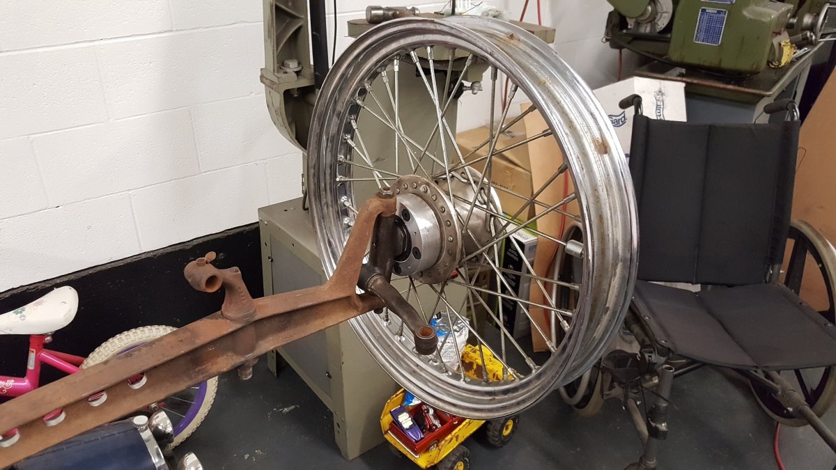

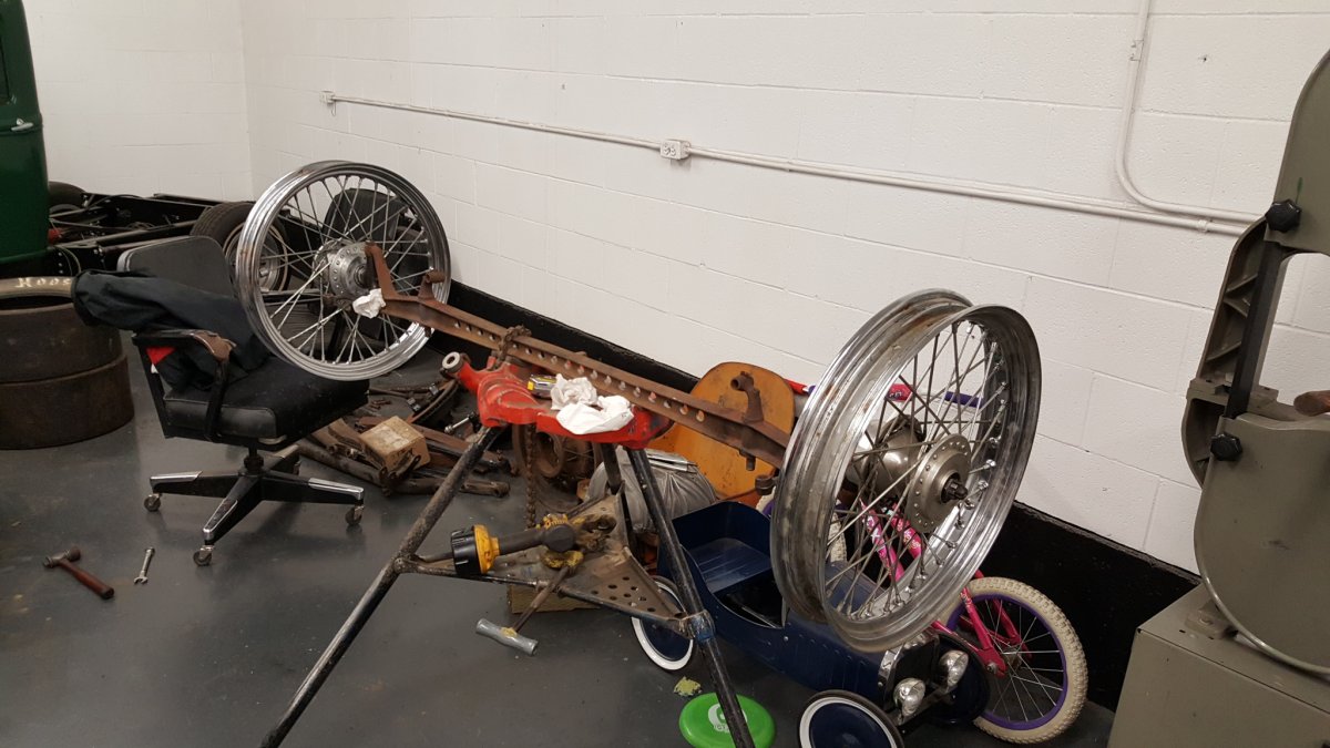

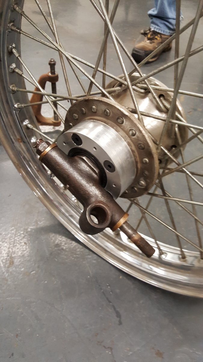

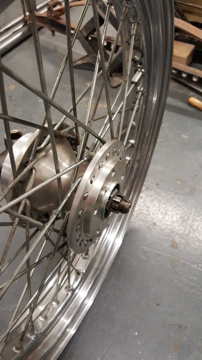

    So that was me, Satler and Randy's night, meanwhile in the next room my old man (Steve) was cooking up some front rolling stock. he took a matching pair of 19" Harley wheels and machined some bearing adapters that bolt in place of the brake rotors that use the Model T bearings and seals as well as space everything out for the Model T spindles.
    Came out freeking rad!

    Yep all 3 look really good! I like the adapters for the front wheels! thats a slick idea! Thanks for posting!

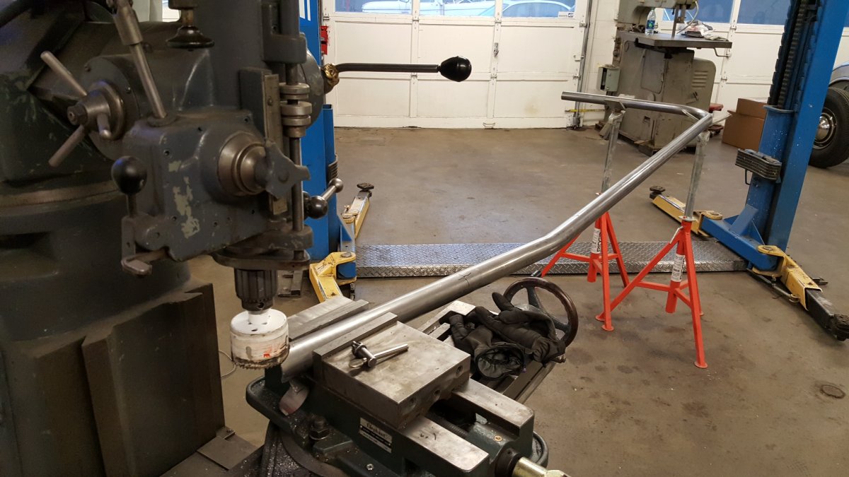

    Having the rails come back square to the centerline and then kick up at 90 degrees made it easy to setup in the mill to notch for the front crossmember. the mill is level in both axis so all i had to do was level the side rail and the kickup to get the notch correct on the compound angle portion of the rail. 20161031_074201.jpg

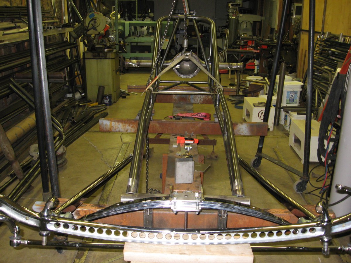

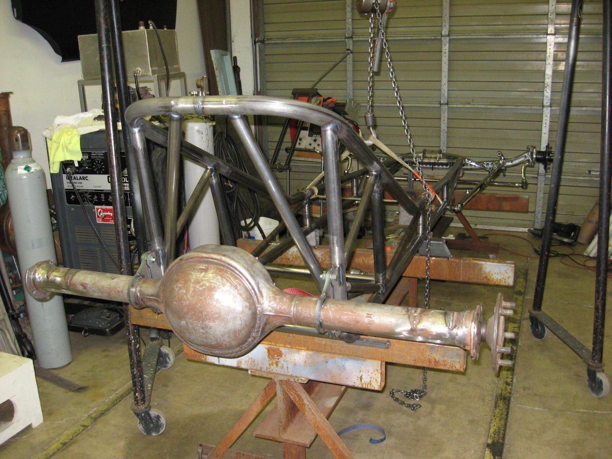

    Rob, Looks like you are off to a great start. Getting some friends together to build a standard chassis for the group, is a formula for success. This is what some of the Oregon cars look like. IMG_0480.JPG IMG_0482.JPG
