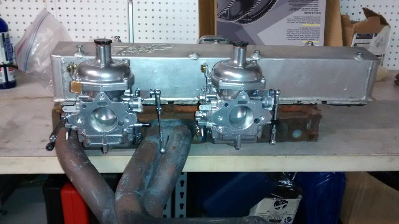

    Your side-draft intake got me fired up to finish mine.
  8. rottenleonard
    Joined: Nov 7, 2008
    Posts: 1,993
    rottenleonard
    Thats looking good Walt, whate are those carbs?

    Those carbs are SU -6's (1-3/4" bore).

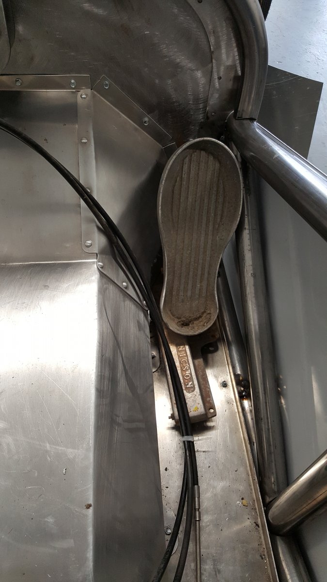

    I'm just going to use it as a pusher, it has enough cable to loop behind the trans and come up the left side of the engine. I think i will have it turn a shaft with 3 bell cranks for the carbs.

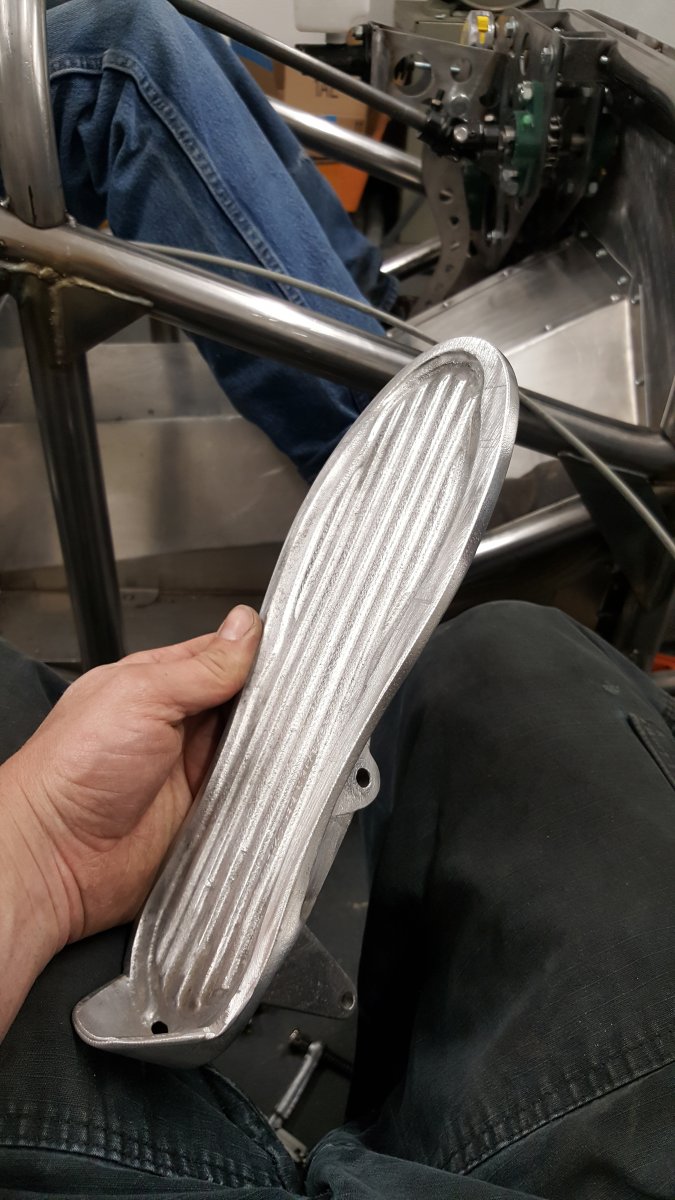

    rottenleonard

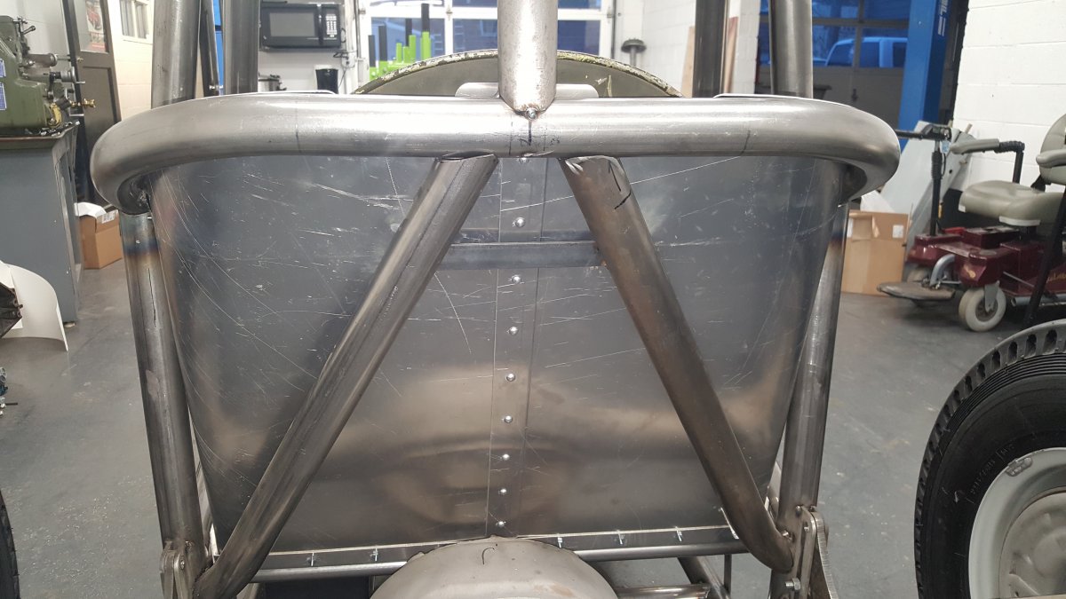

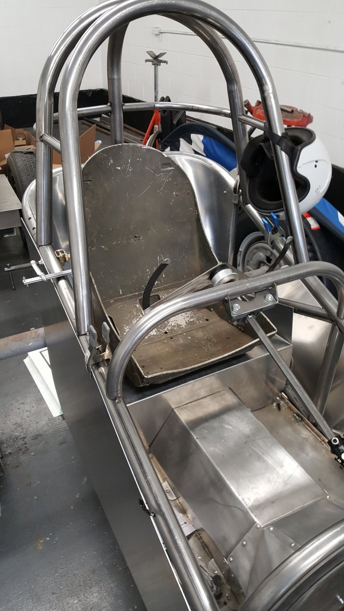

    Last week i Q'd us up some porkchops, and spuds. Glad the weather is finally improving.
    We spent most of the night modifying the seat to fit and making mounting tabs for it.
    And making tabs to mount the side panels on
    The seat will bolt back to this strap too when complete.
    Dad spent some time modifying the gas pedal as it was made to be run barefoot, no ones shoes would fit in it.

    suggest a toe strap on that throttle to allow the pedal to be pulled back in case of a sticking cable don`t know for sure but I believe it`s mandated in some cl***es

    I picked up a NICSON pedal this weekend and you are right about needing small feet. I'm converting mine to a puller and I'm going o follow your father's modification and yes a toe strap.

    Reviewing the recent photos I think the drive shaft loops are to big to contain it in the event of failure. You sure want to protect what is above it. Been there, done that.

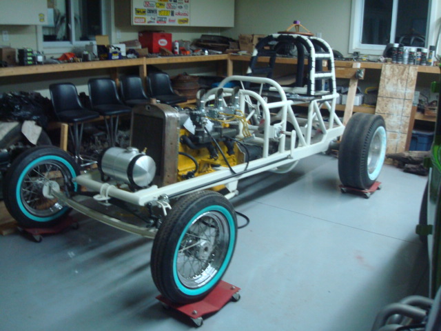

    The car has been moving along steady. The ch***is is finished, painted and padded. The Harley wheels are modified and mounted, looking good with the Ansens. The 261 is installed and mocked up with the triple 97s, headers, hoses, cooling and fuel. Haven't started the engine yet. Waiting for the body to come back from the paint shop so this thing can get ****oned up. Really want to go racing May 20, we'll see.
