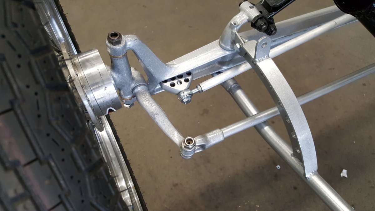

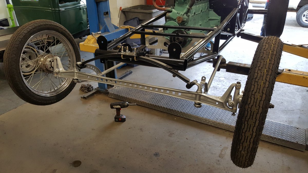

    And it was on to the front suspension, i had purchased some lever shocks for an MG but they prooved to heavy and bulky to work well, so I shelved them.

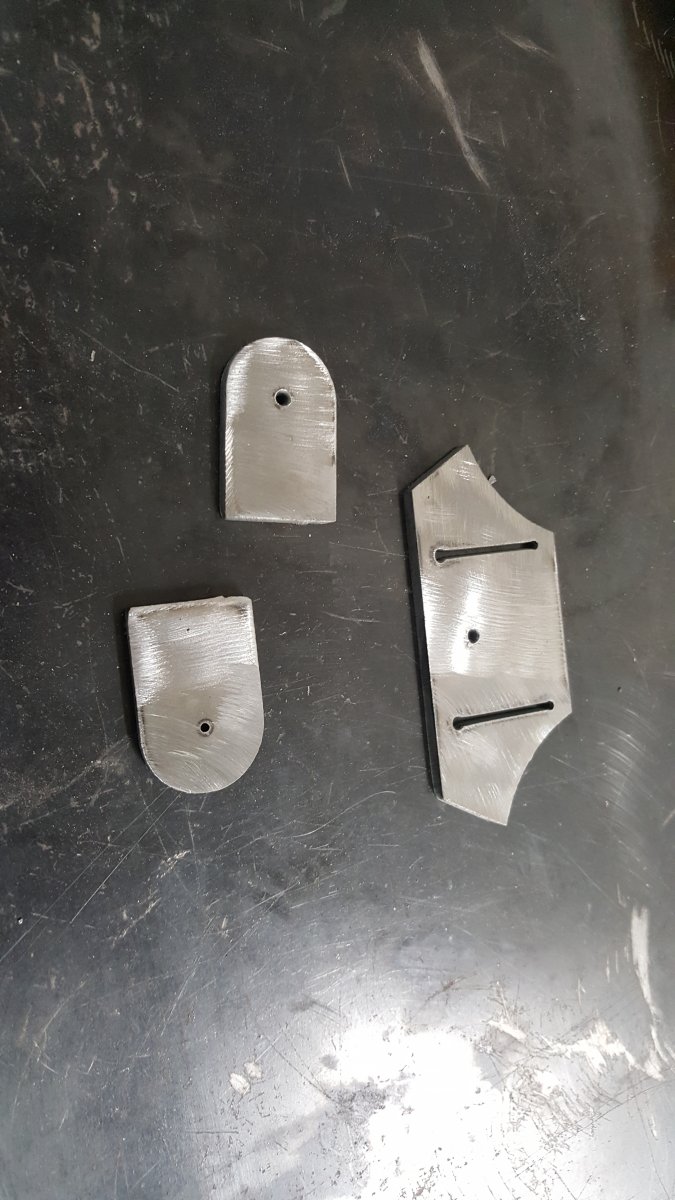

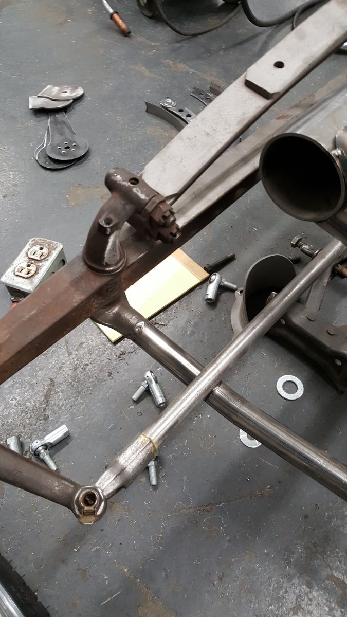

    We cut and formed these braces to help the wishbones control the caster, there wont be a lot of stress on the without front brakes but still makes me feel better...

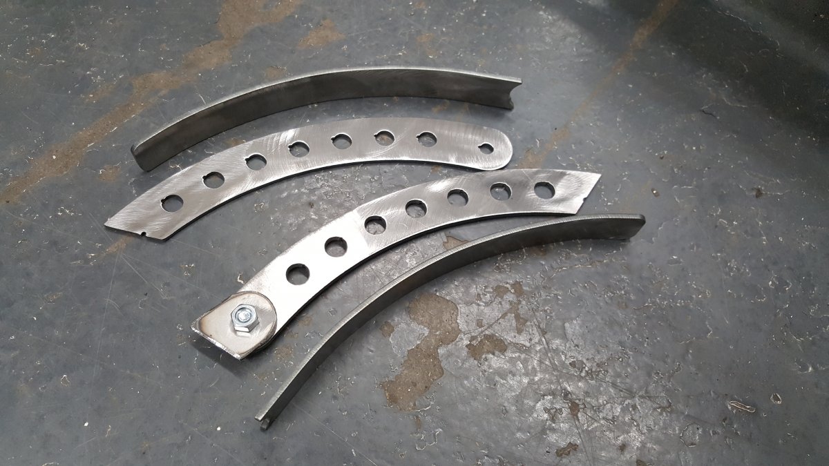

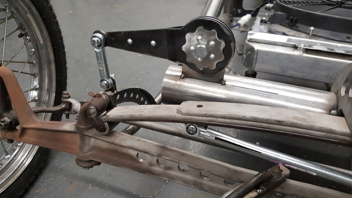

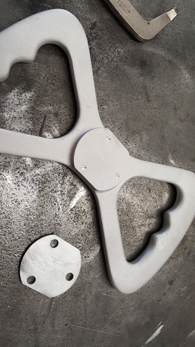

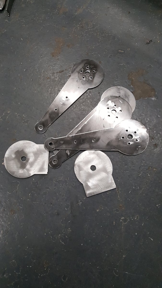

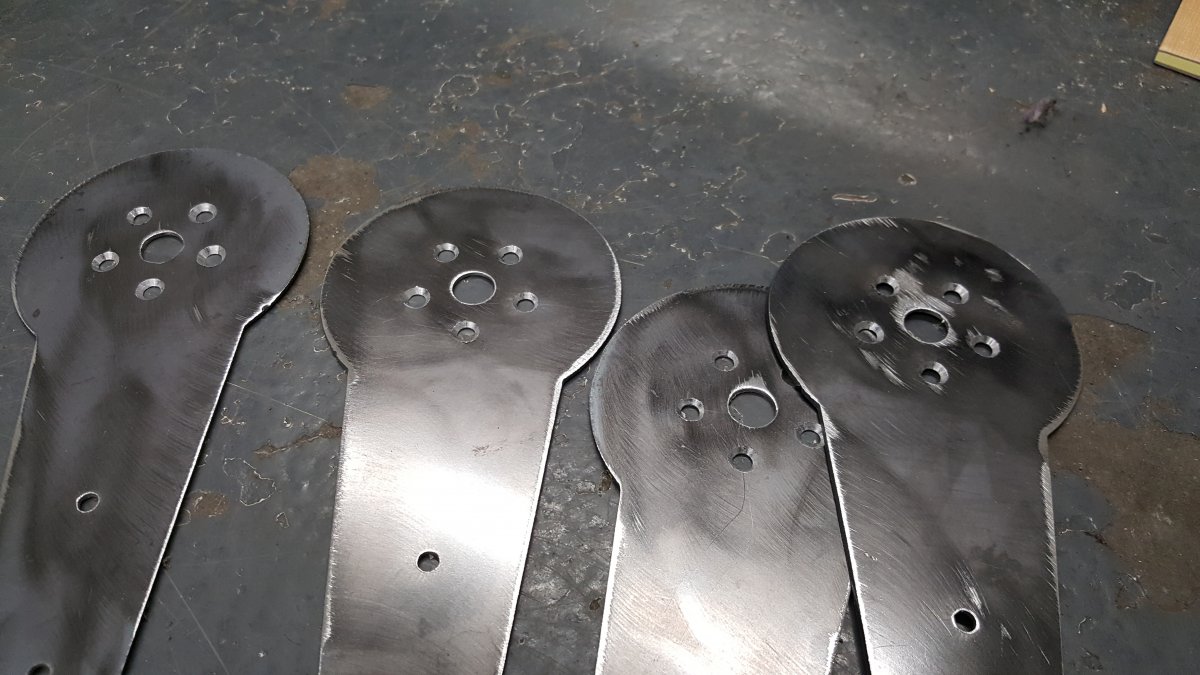

    Then we cut up the basic pieces for some friction style shocks.
    The insides were countersunk for rivets to attach the stiffner plates.
    We made up some forming plates and bolted them all together and pressed them into shape in the horizontal press.
    Next up some tabs for the shocks and the frame side of the panhard rod.
    Everything tack up. Not sure about the look of the wishbones, I'll walk by them for a week and see if they stick.
    Mockup of the panhard rod with a s**** of conduit, it still needs some work to clear everything.

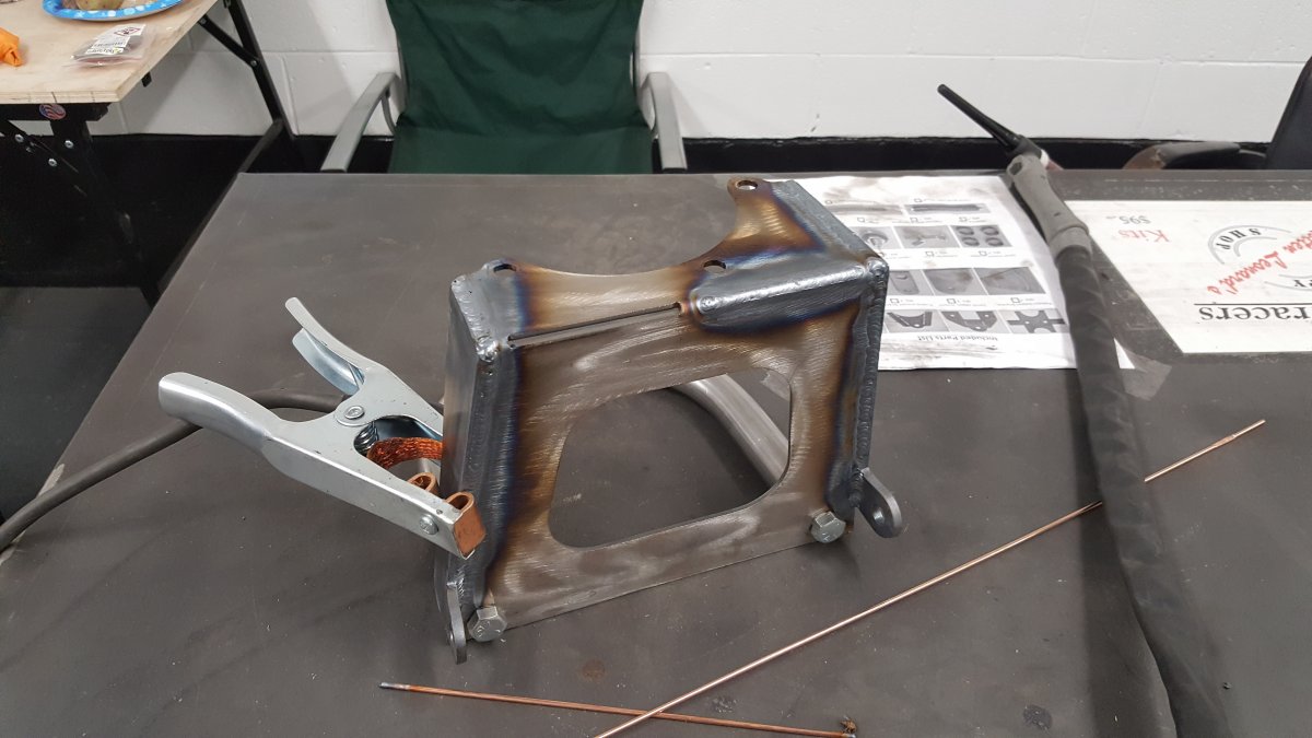

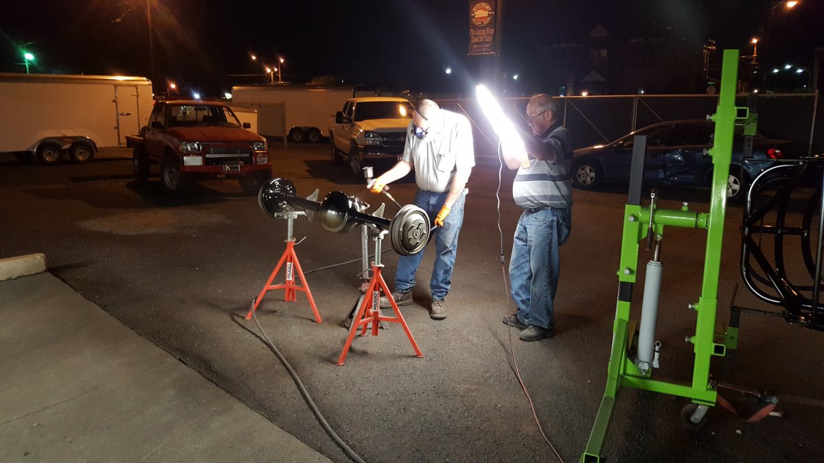

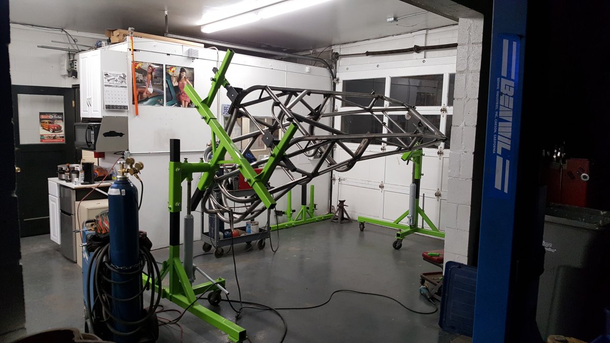

    Cheap steaks and spuds last night!

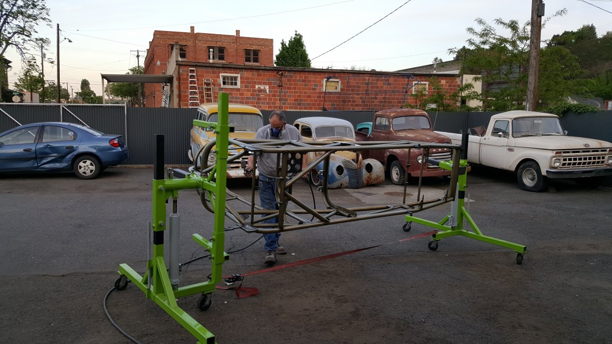

    Then we finished up the welding and Randy and Satler went to painting.
    While they were up to that I was in tig'n up brackets and suspension parts.
    Rear axle anti rotation bracket and driveline hoop.
    Front wishbone

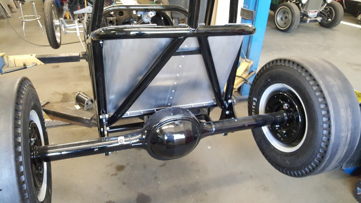

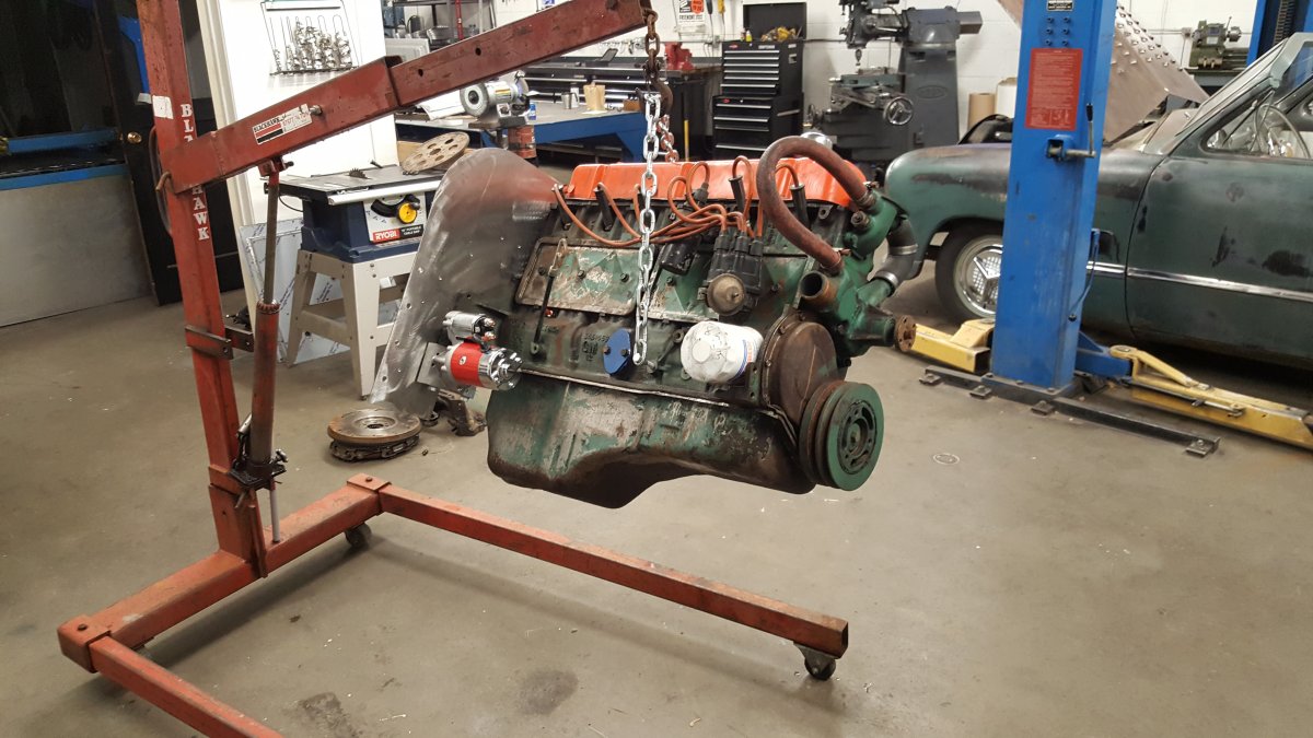

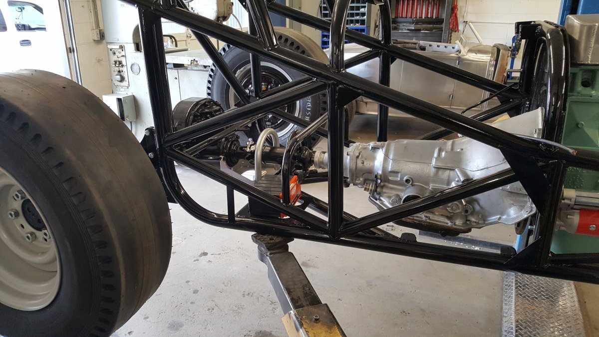

    Not a ton of progress last night as the powder coating didn't get done in time. We did get the rearend re mounted.
    Then put the new rear brakes on and shucked up the wheels and tires.
    Then cleaned up the 292 that is going into the car so I can give it a Crylon overhaul this week.

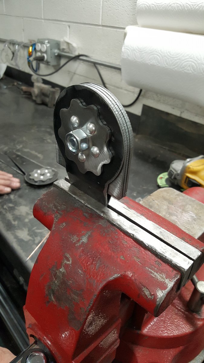

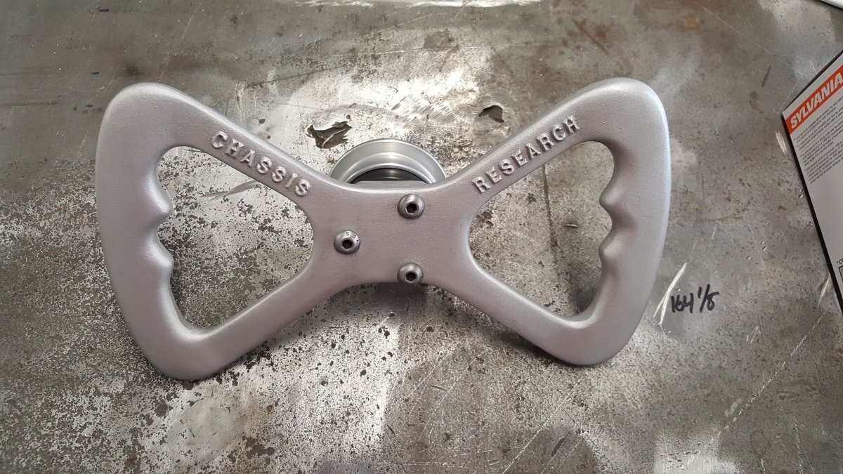

    It's always like Christmas when you get a box from Collin from Imperial Speed and custom, yesterday was no acception.
    Anybody need a new dragster steering wheel?
    I made up a template to drill one to our quick release just basically using it to locate the holes.
    Then finished drilling them on the mill, and bolted it to the hub with some ****on heads.

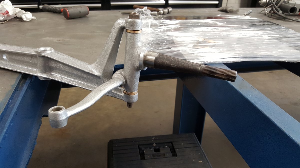

    The ch***is parts are back from powder coat, so i run the spindles down to the machine shop and had the king pins I recieved from Antique Auto Ranch in Spokane fit. Here one is file fit to the axle.

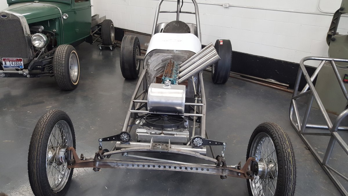

    rottenleonard

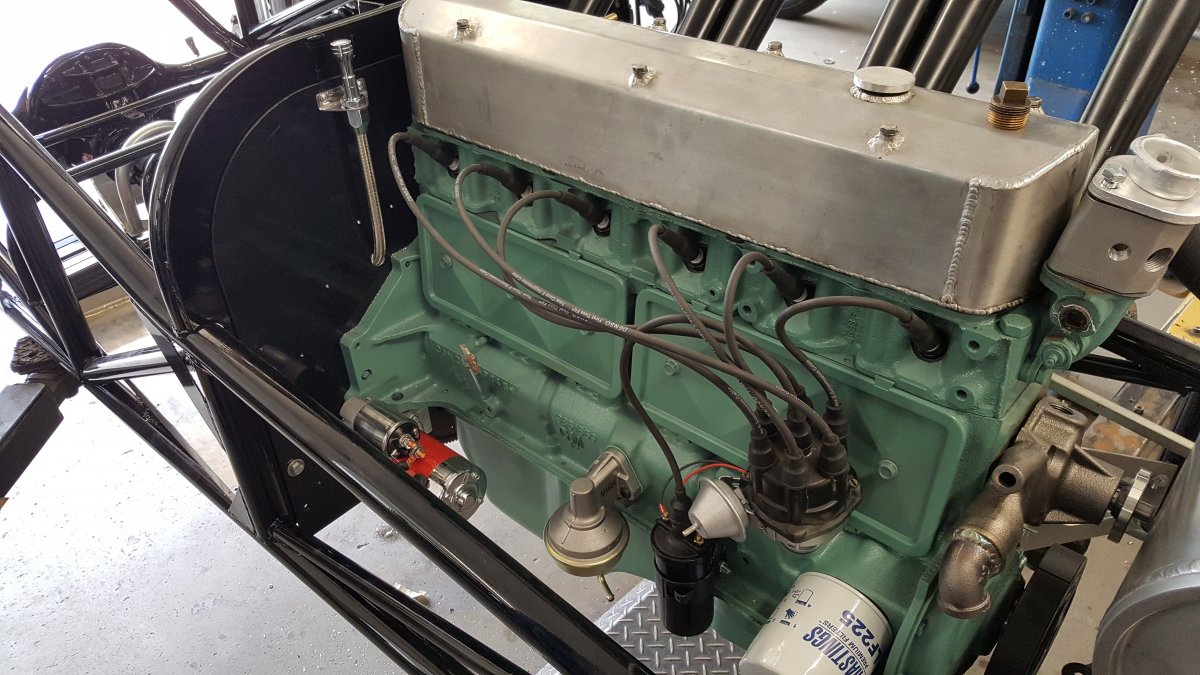

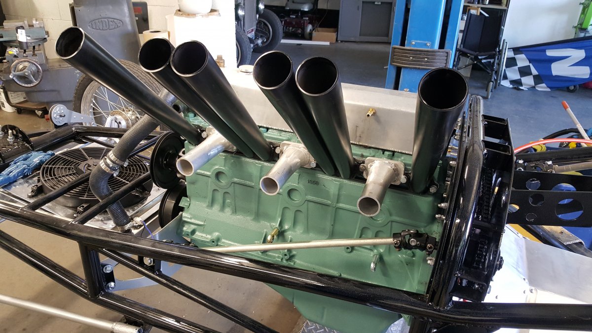

    Been pluggin away, trying to be together for the drags at Woodburn on the weekend of the 25th.
    Pertronics conversion as well as fresh tune up parts
    Panhard rod mount done.

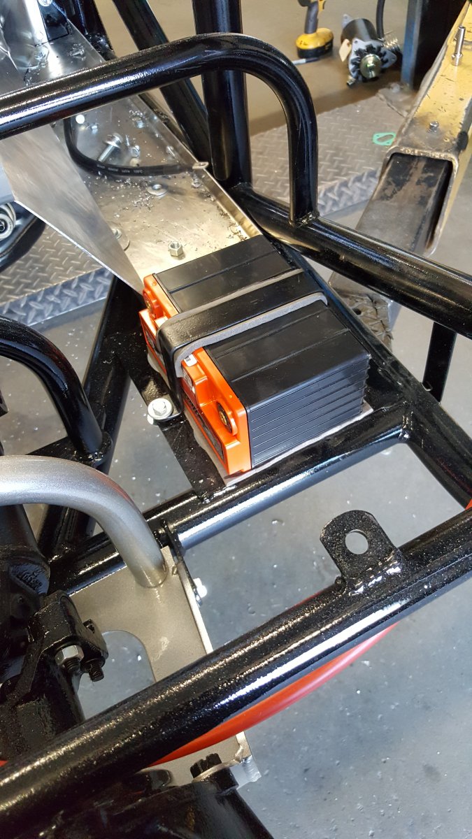

    Battery mounted
    Trans tunnel and steering drive back in for good.

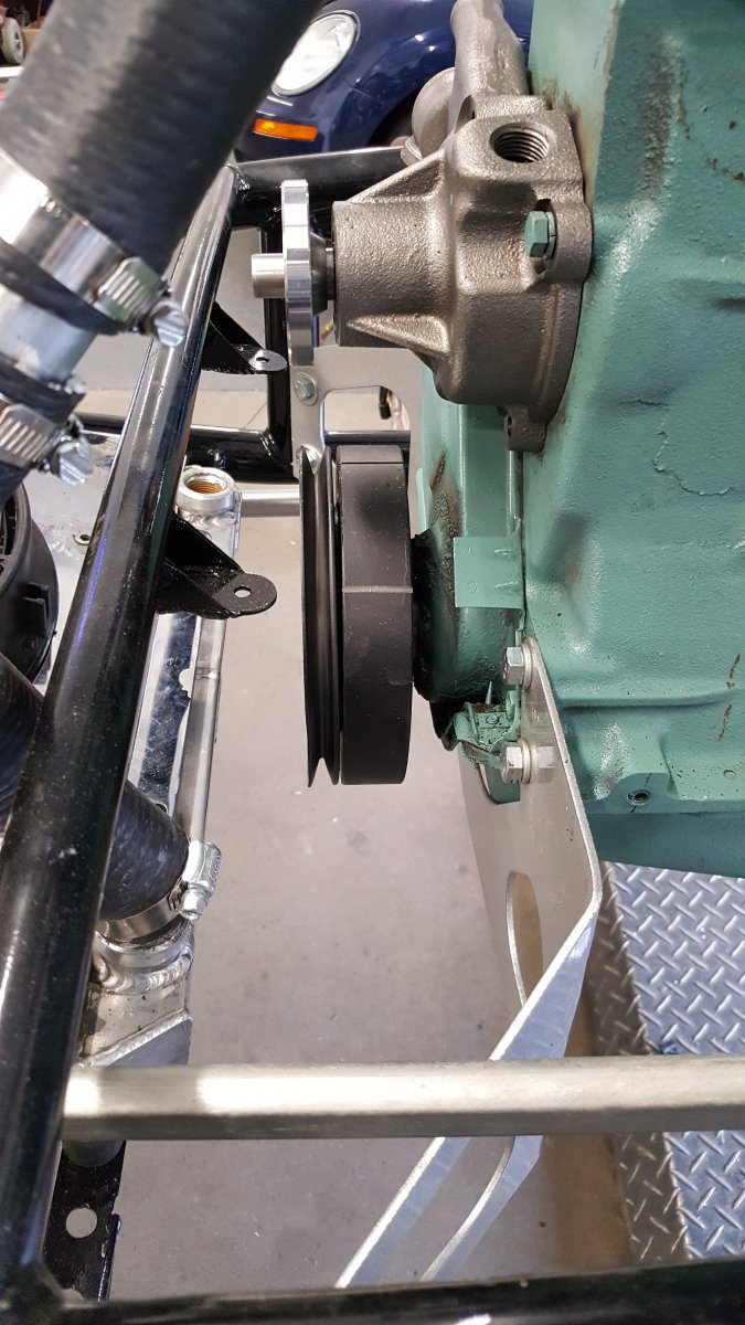

    Air in air out installed
    Cooling system has been figured out for the most part.

    That is the top of the king pin, there is an oil cup that pressed into that hole.

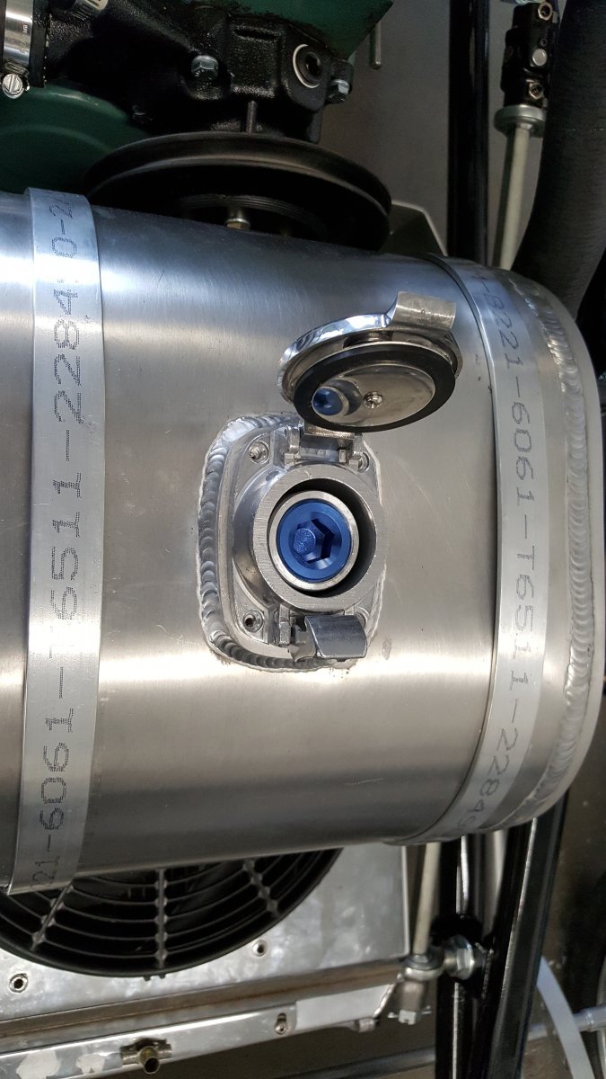

  18. Marty Strode
    Joined: Apr 28, 2011
    Posts: 9,685
    Marty Strode

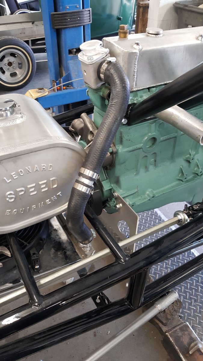

    Rob, That's a beautiful fuel tank ! Is that flip top cap going to p*** tech ? My 2010 rule book requires a positive locking, screw on cap, on all open body cars. As I remember the rule changed after Herm Peterson's fire in 1973, maybe Roo will share his thoughts.

  20. rooman
    Joined: Sep 20, 2006
    Posts: 4,045
    rooman
    Yep! Has to be screw on. A few years back I did hide a small screw on under a flip top on a car that the customer wanted to look period correct.
    Roo

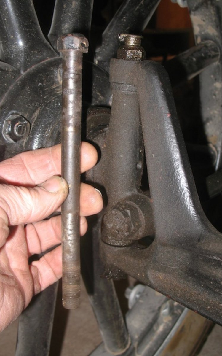

    I hate to find more work for you Rob, but a few pics back, I noticed the length of your rear lug studs, if you haven't replaced them, I would, before taking it to Woodburn.
  22. rottenleonard
    Joined: Nov 7, 2008
    Posts: 1,996
    rottenleonard
    Thanks for keeping an eye out for what we are missing, it is sure a lot easier to fix it here than at the track.
  23. rottenleonard
    Joined: Nov 7, 2008
    Posts: 1,996
    rottenleonard
    Stole Rooman's fix for the fuel cap, still need to decide how to handle venting, open to suggestions, not sure how **** they will be if it needs to have a check ball in it for roll over or if i can just drill a vent hole in it.
    Straps still need tweaking and polishing, but you get the idea.

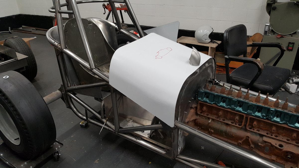

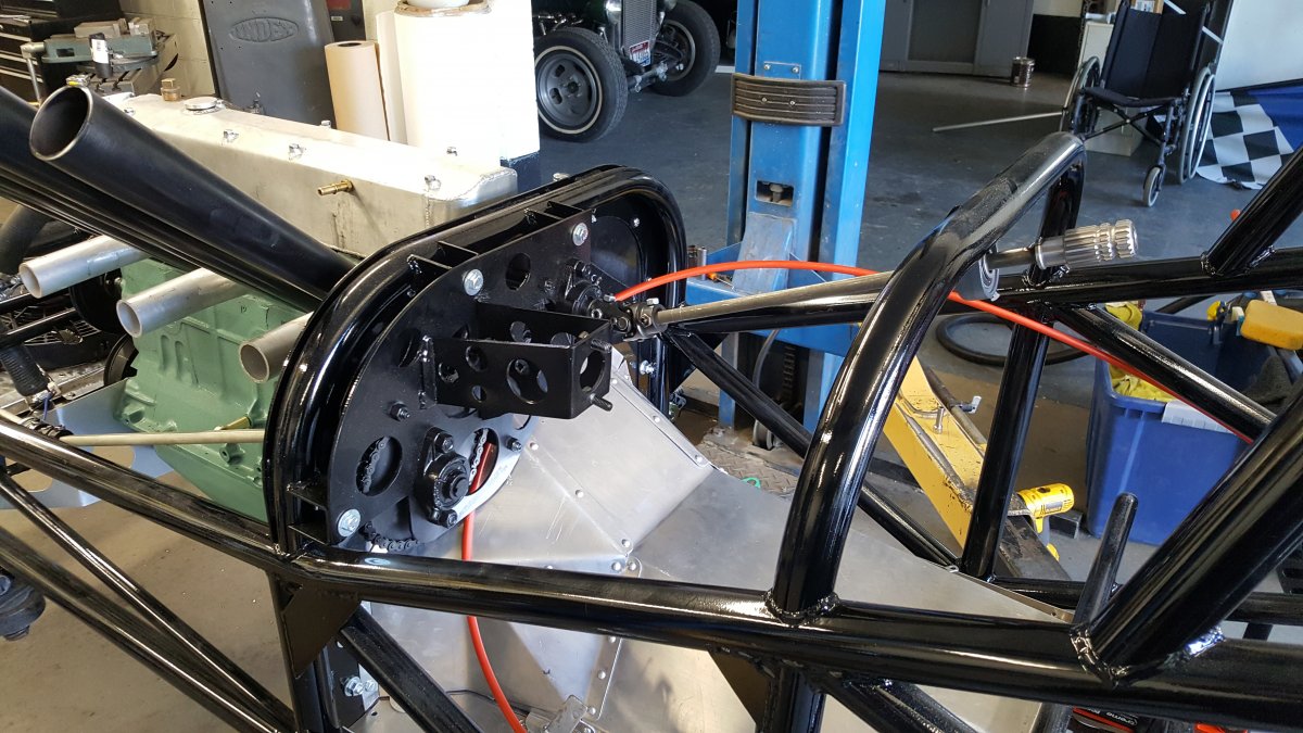

    Back panel in
    Gauges mounted, planning on a formed and riveted in panel as part of the cowling to cover the gauges.
    Brakes plummed, blead and working.

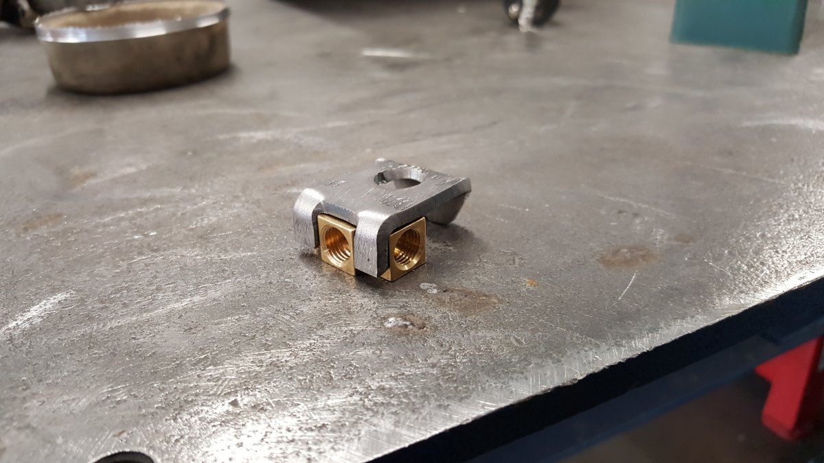

    Little hold down I fabbed up to hold the brake tee fitting.

    from Great NW
    You'll need to add another fitting, but this works well for a roll over vent.
