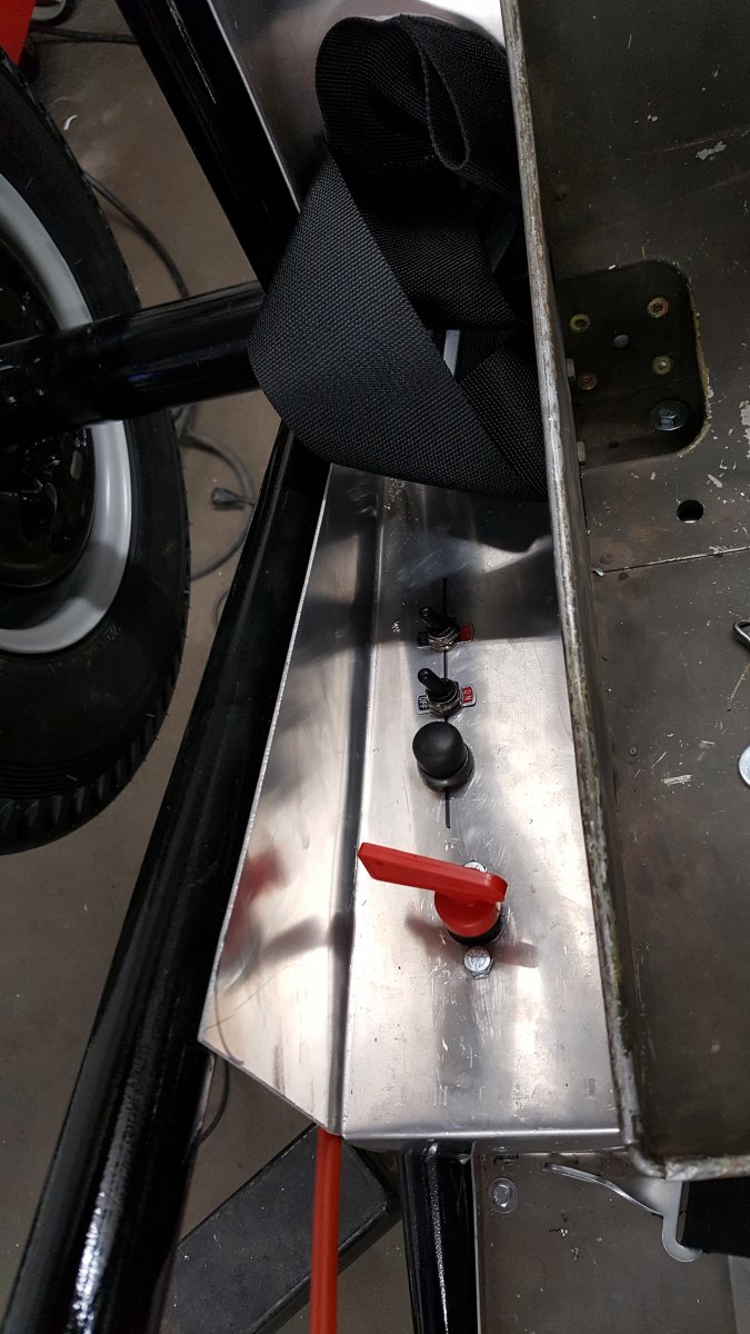

    Last night i stsrted shaping the cover for the gauge panel, my body saw punched it's ticket so I didn't get it fitted into the cowl cover.
    Then Satler and I worked up a alternator bracket. That also serves as a support for the bell crank for the carbs. (Still needs welded on)
    Then a good portion of the throttle linkage was worked out. Went with an old Moon pedal I had as the Nicson was just too bulky.

    Last week Randy knocked out 90 percent of the wiring, he came up with a cool plan for the rear battery kill switch, more on that later.

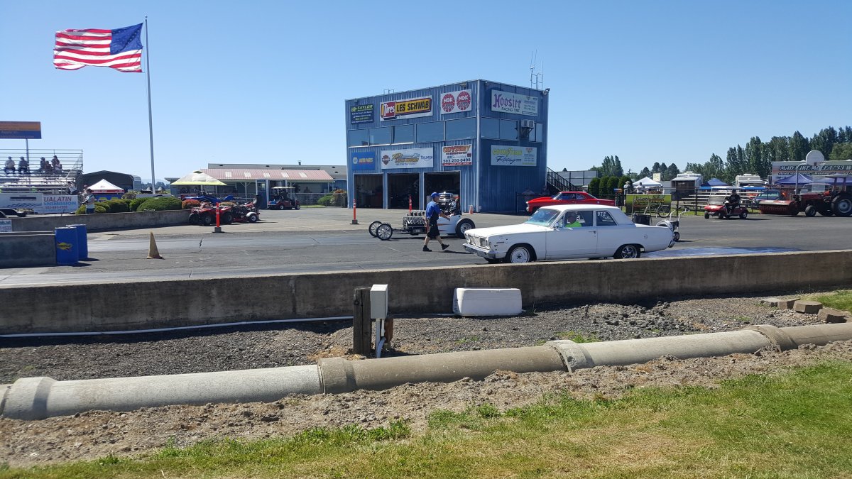

    It was good to meet everyone at the Woodburn race this weekend. Fun to see other peoples take on the same mouse trap. Picked up some good tips and found some things that we need to correct. It was good for the motivation. Wish I would have taken more pictures.

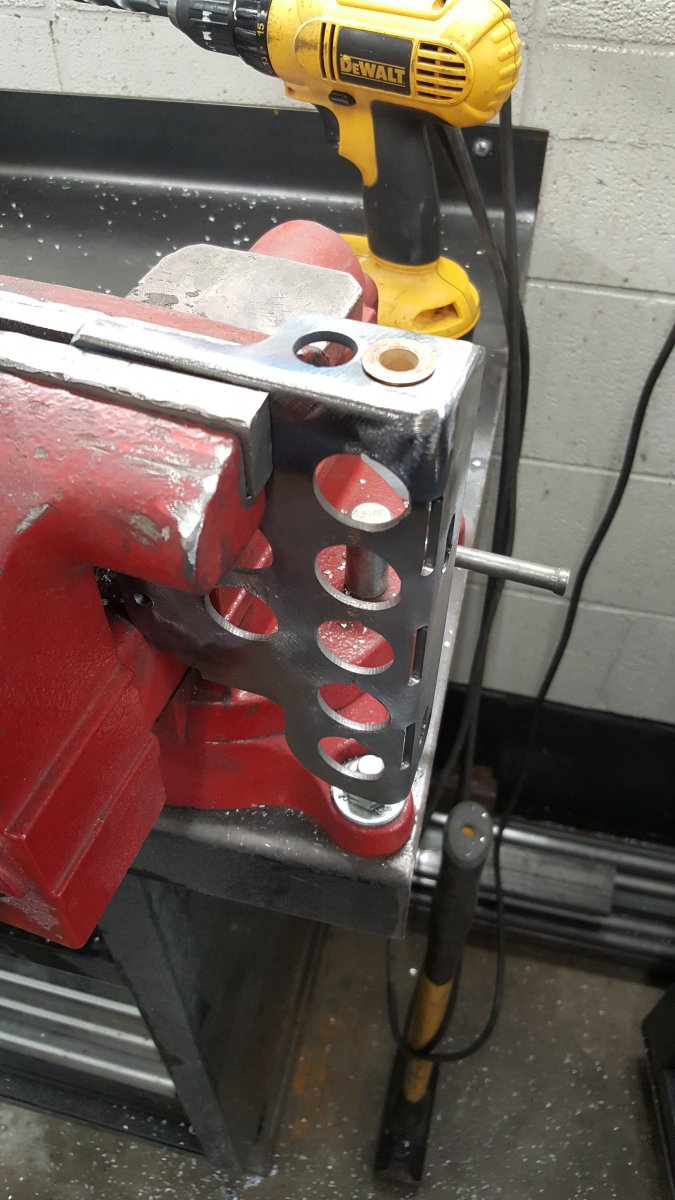

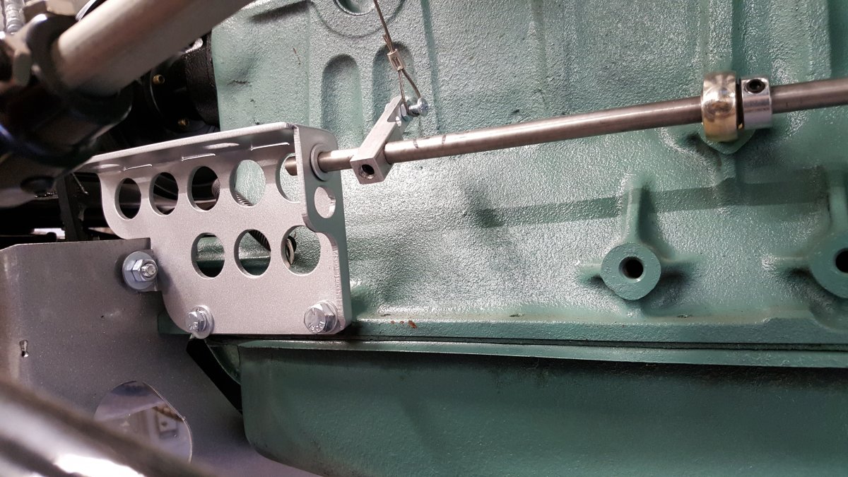

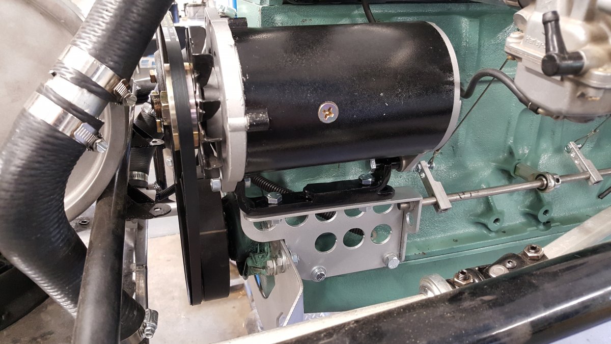

    Worked on the alternator mount a little yesterday. It is doubling as support for the end of the throttle bell crank. I found an extra bushing from a 90's GM pickup door hinge in my toolbox that worked perfect.
    The black portion of the mount is a modified original and definitely doesn't qualify as dainty, but does wualify as done....
    A cheap cad program and the plasma cam sure make things a lot easier.

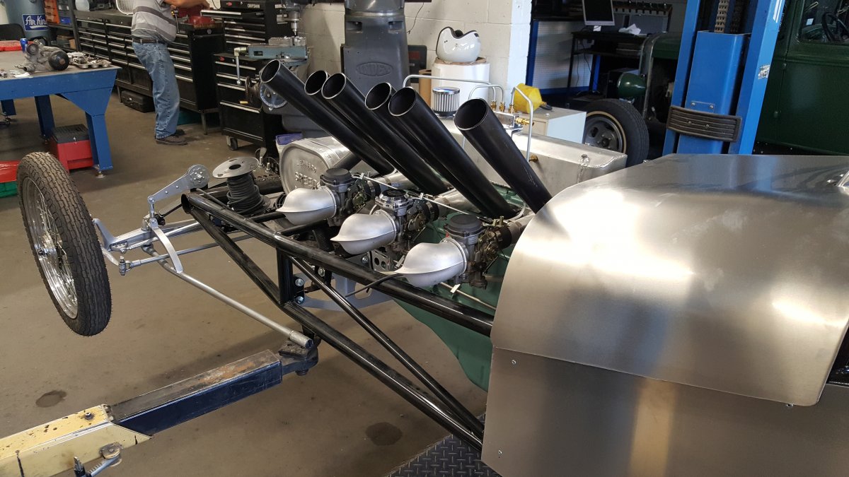

    how about left side of motor, would love to see how you did the linkage on those carbs

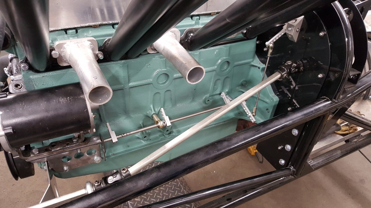

    This picture pretty well tells the tale, a cable runs up to each carb to pull the throttle open.

    Wayne and I worked on the dragster last night. We made up some carb adapters for the Imperial Speed and Custom scoops. Re-made the fuel lines for the new fuel pump location. Wired in the park neutral safety switch, installed the longer wheel studs, and a myriad of other small jobs that needed to be done.
    We pushed it out and gave it another go, the carbs seem to be working good, it starts, idles and throttle response is very good. The fuel pressure is too much for the carbs and pushes past the needle and seat so we will have to make a change there, there is a race next weekend at Walla Walla with a test and tune Friday night so we are going to shoot for that.

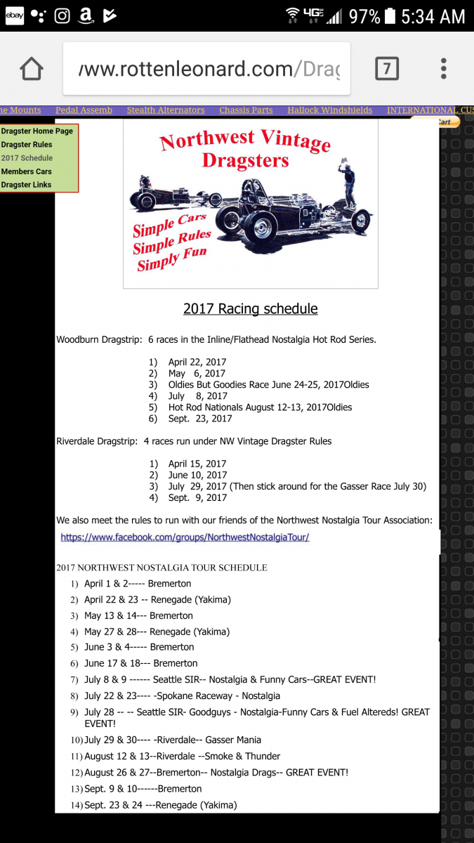

    Hey Walt, what was the 8th mile index?

    Still planning to make the Friday night Test & Tune?
    1/8th mile index is a 7.65 second ET. Under "Eliminations" at the bottom of the rules:

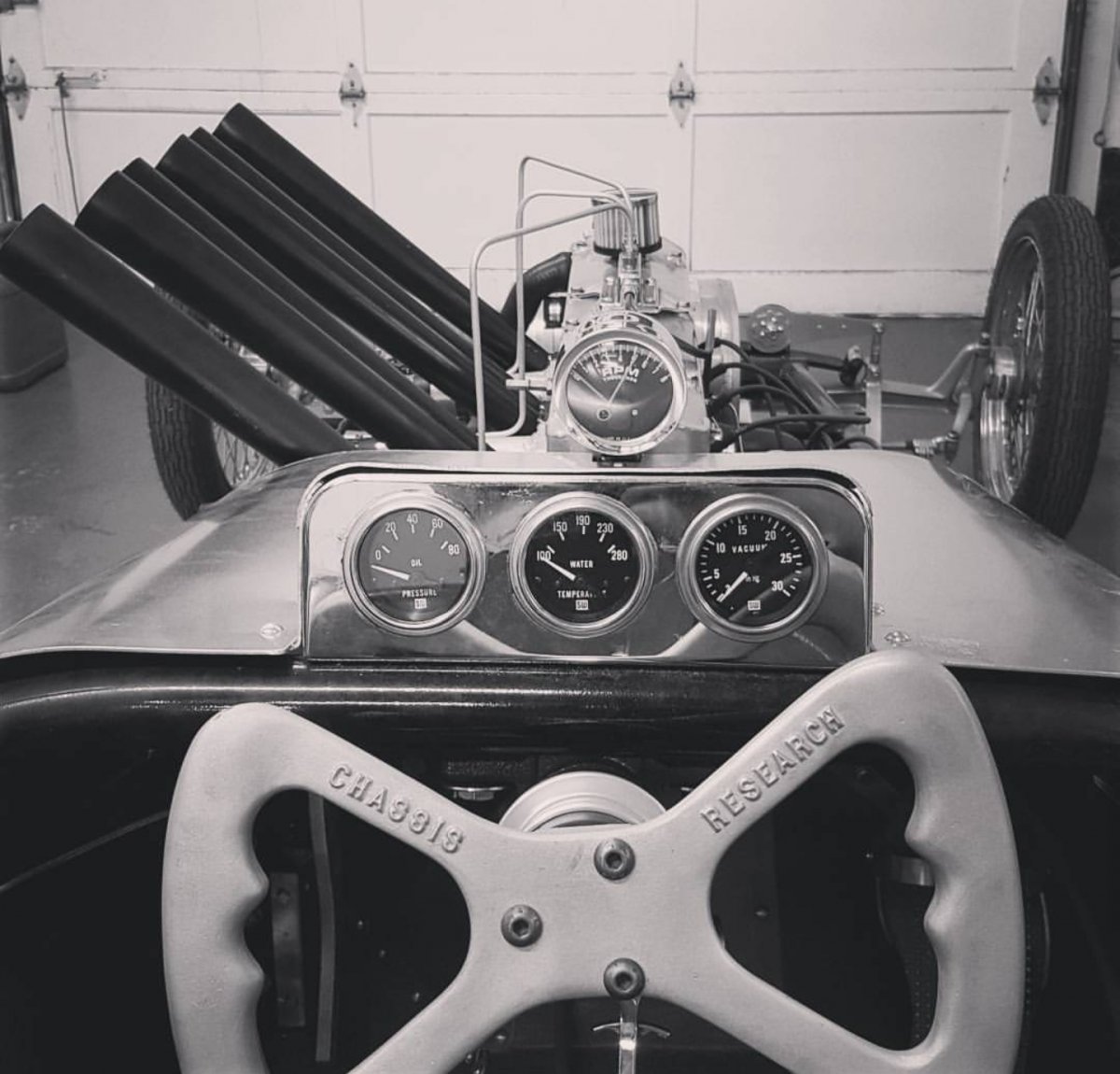

    I wanted to use that cal custom gauge panel, and it had three holes, temperature and oil are a given and that leaves a amp or volt gauge, or a fuel level gauge, or a vacuum gauge. I am using one of my stealth alternators they are pretty reliable so I'm not too worried about voltage. I figure that seeing the vacuum could potentially help solve an issue sometime down the road.
    I have all three ports teed together, and figure that I could block off two of the ports at a time and potentially diagnose which cylinder I may have a problem on.

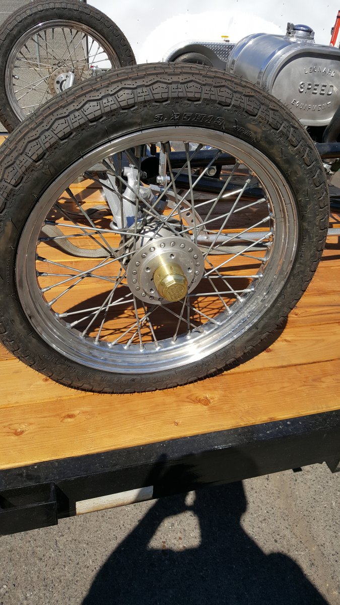

    Dad had made up these cool adapters to screw repop Model T dust caps onto the Harley wheels

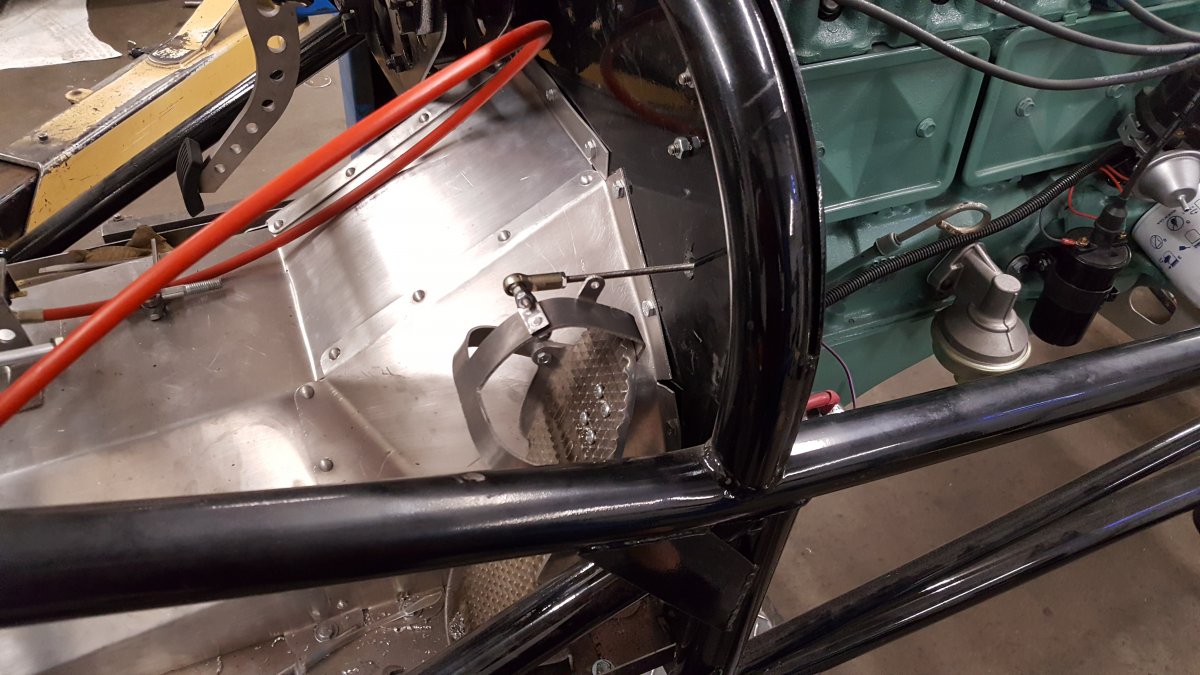

    Push rod setup to kill the power

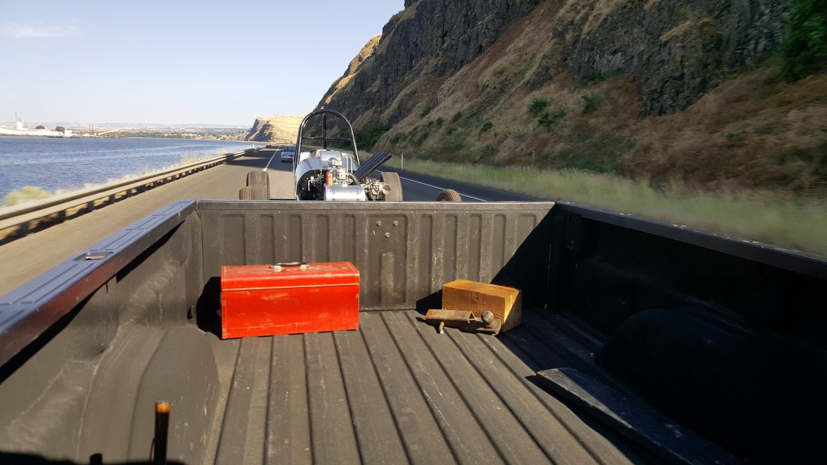

  27. rottenleonard
    Joined: Nov 7, 2008
    Posts: 1,996
    rottenleonard
    So then off to the races

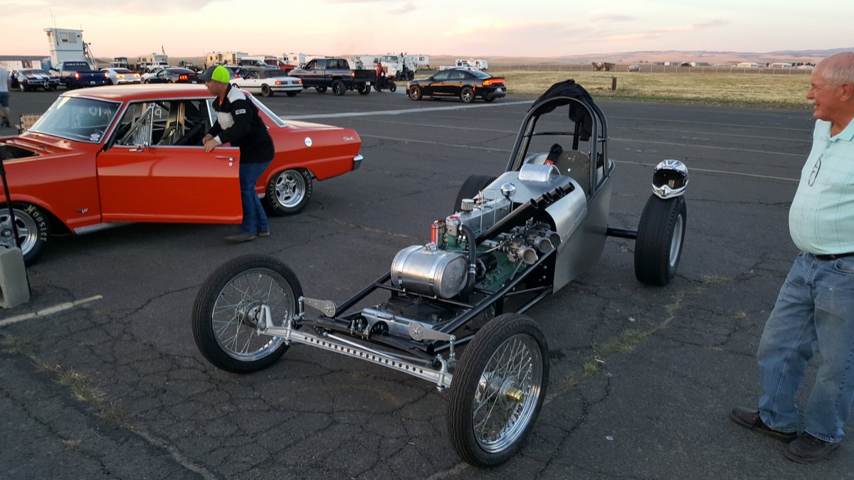

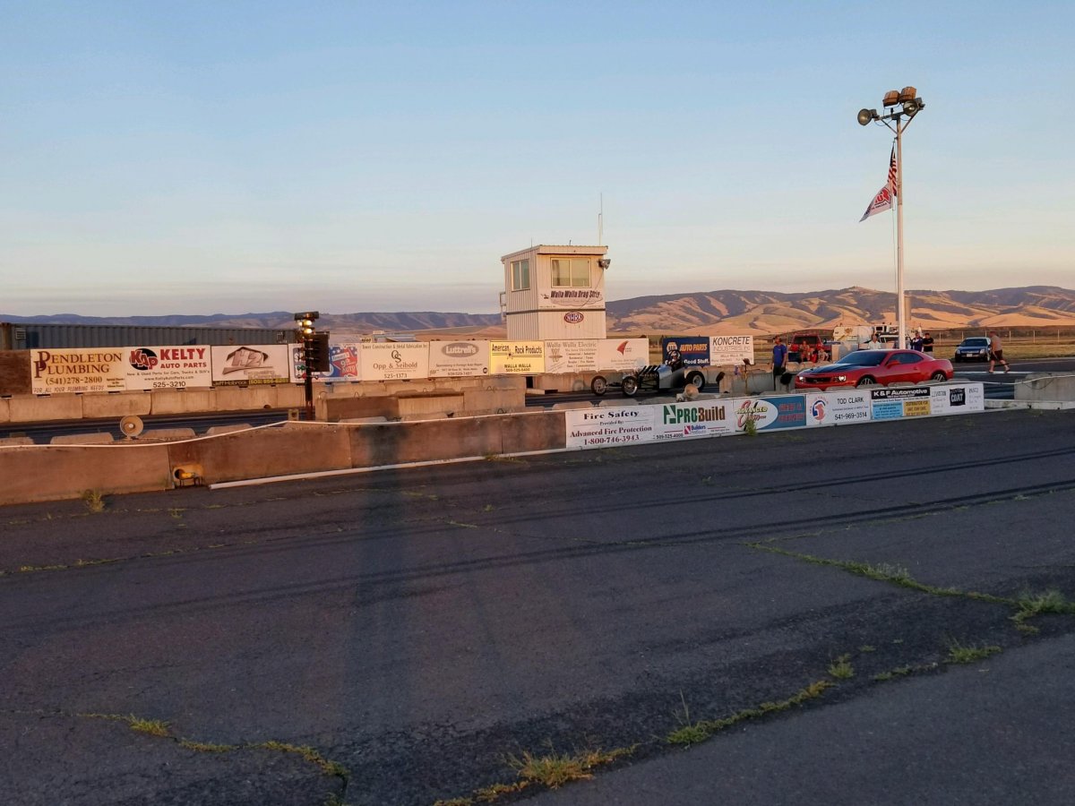

    It was just a test and tune/street race night. Walla Walla's track is in some beautiful country and has a great low key feel to it.
    The car runs pretty good overall, the slides in the carbs are bouncing just off idle ehich foules the the fuel mixture. I think it either needs a low speed jet adjustment or a little stiffer springs in the slide diaphragm. But it idles good and throttle response as well as WOT seem REALLY good! The car hooks up decently for a 1 legger. But we have a problem with the trans as we couldn't get it to shift out of 1st gear. Glad it is an 1/8 mile track, it would have taken a long time to drive to the end of the quarter in first gear
