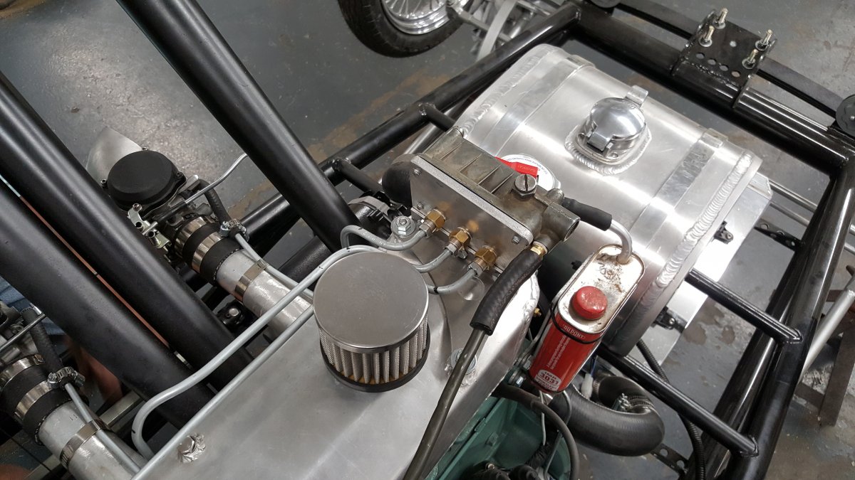

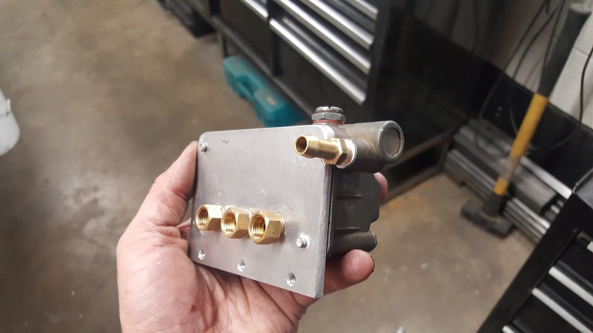

    One of the major issues we had is it kept pushing fuel pass the needle and seat. We changed the needles, lowered the float level, we even put a fuel pressure regulator on it to no avail. So we decided in the end to go back to plan A which was to mount a Holley float bowl up high and gravity feed the carbs from it. This actually worked out really well. We used a secondary bowl from a 4 barrel carb which did not have an accelerator pump to block off and 1/8 inch pipe plug happens to work perfectly in the crossover tube hole. 20170808_180459.jpg
    I got out some aluminum and drilled and tap the holes for the number 12 screws for the bowl and then drilled and tapped three 1/4 inch pipe plug holes in the plate.
    Fittings installed
    Mounted it up high and forward so ALL that wicked acceleration can help flow
    The plumbing is still a little rough but it is a good point to try it out and see if it will work before we get too fancy. We found us a piece of pavement just out of town that we can use for test and tune on the next shop night.
    Also I was pretty concerned with the front tires kicking a rock into one of the carb scoops, we came up with a few plans for solving the issue but while waltzing around Home Depot the other day I ran accross these for 3 bucks a pair.... plumbers must all have Harleys.... 20170808_203954.jpg
    They couldn't have fit better and the edge banding will prevent ununravelled wires entering the carbs.

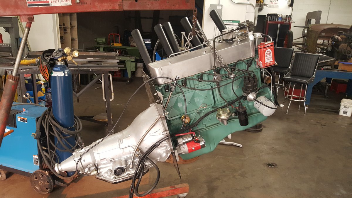

    Gave up on the tranny and bought another, running out of opportunity to run this this year so we gotta quit messing around. There are 3 more races at Walla Walla this year and one down in Boise i would like to hit with some friends.
