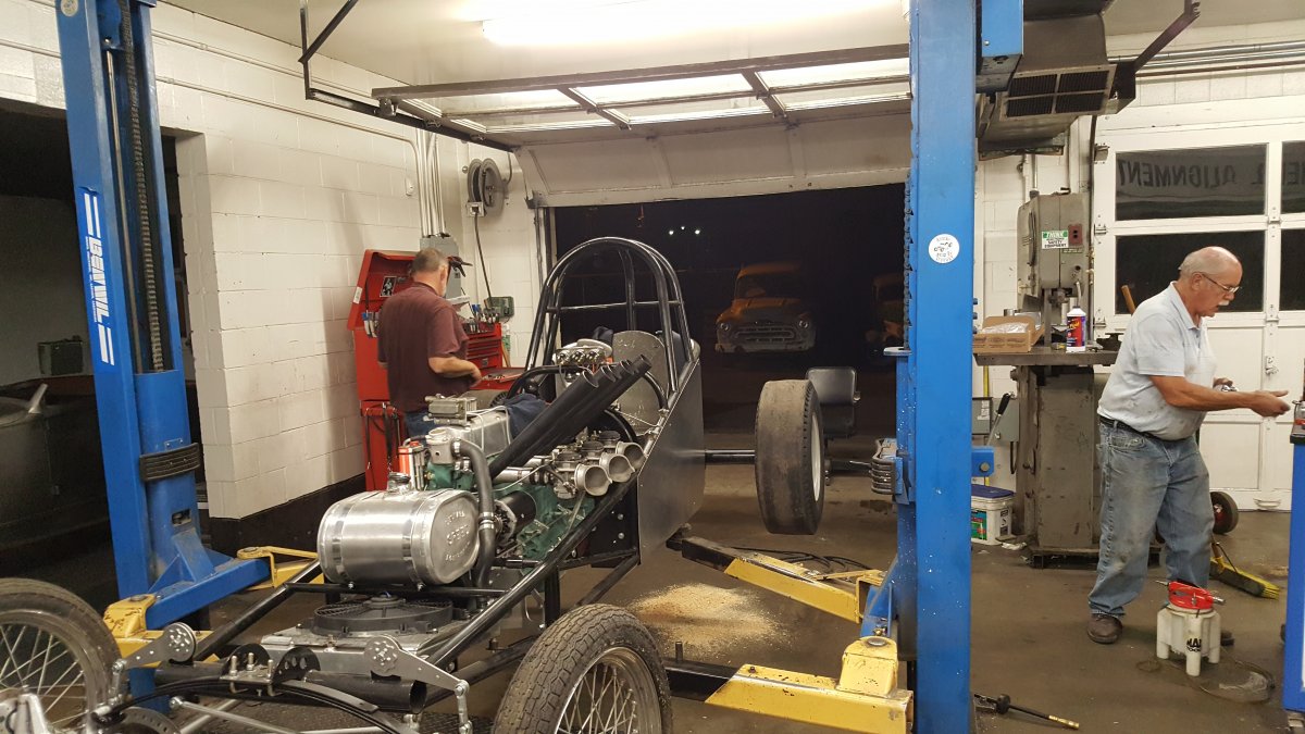

    The guys came in tuesday afternoon, and replaced the truck pan with a car pan after one of us ripped a hole in it coming off the trailer(I wont say who because it was me), and we started putting the car back together making small things better as we went. We were doing so well and someone forgot to bring dinner(I wont say who because it was me) so a trip to the local steak house was in order.

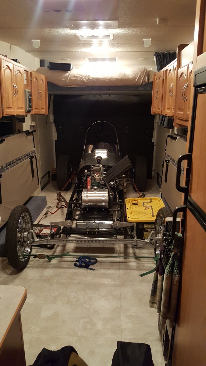

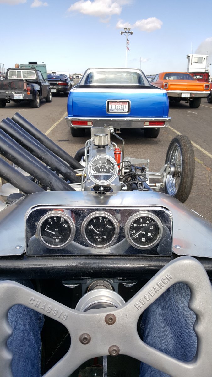

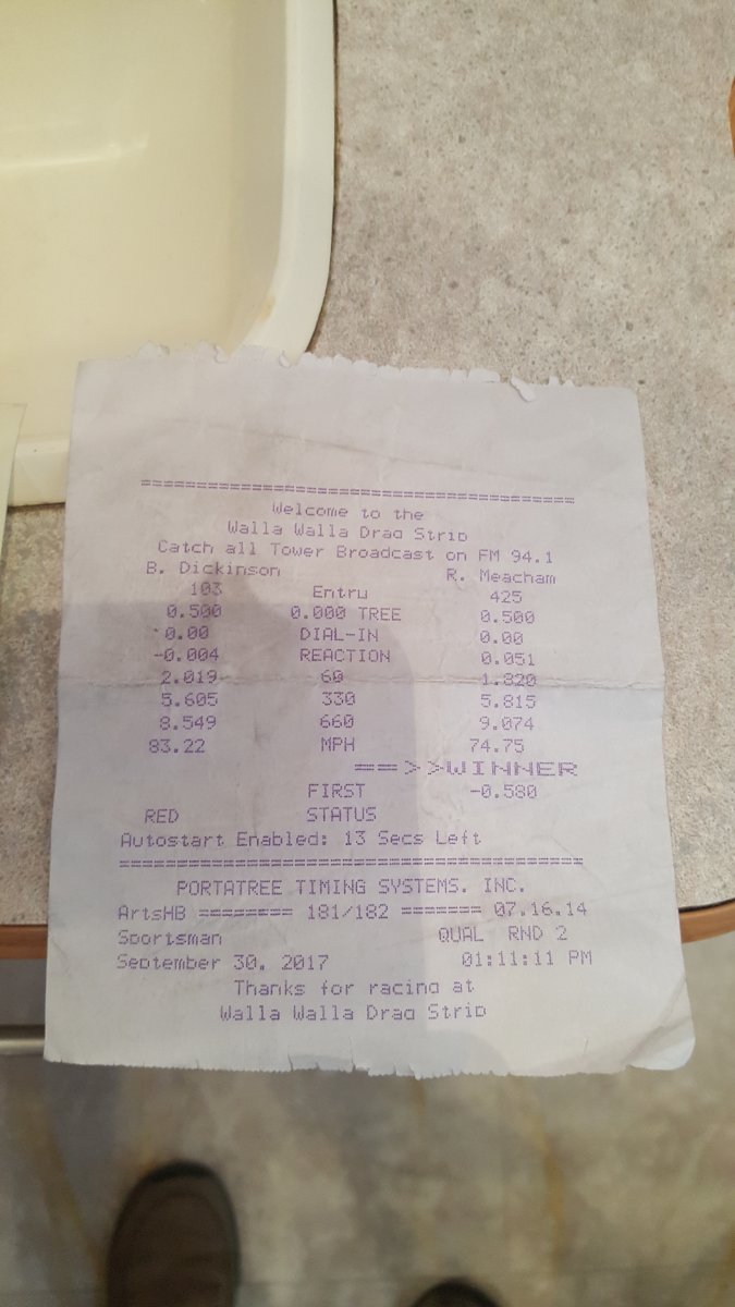

    We loaded up friday night and headed to the 1/8 mile in Walla Walla
    The ****** is shifting...sort of, if you leave it in drive and let up when you want to shift it will, but manually shifting it won't....? Think I will have to give up on the good buddy back yard rebuild. Thinking a TCI valve body is in the future.
    Anyhow traction is a big issue, you have to ***** foot it off the line or it spins baddly, the cheater slicks arent very square on the tread, if you look at the marks it leaves there are two dark patches on the edges and a faint mark in the center. We have been talking about chaining it to the pickup and burn them flat, any thoughts? 1506869715282272308134.jpg
    Beyond that it seems to be running around a 9 second 1/8th, so we need to find about a second and a half somewhere over the winter.
