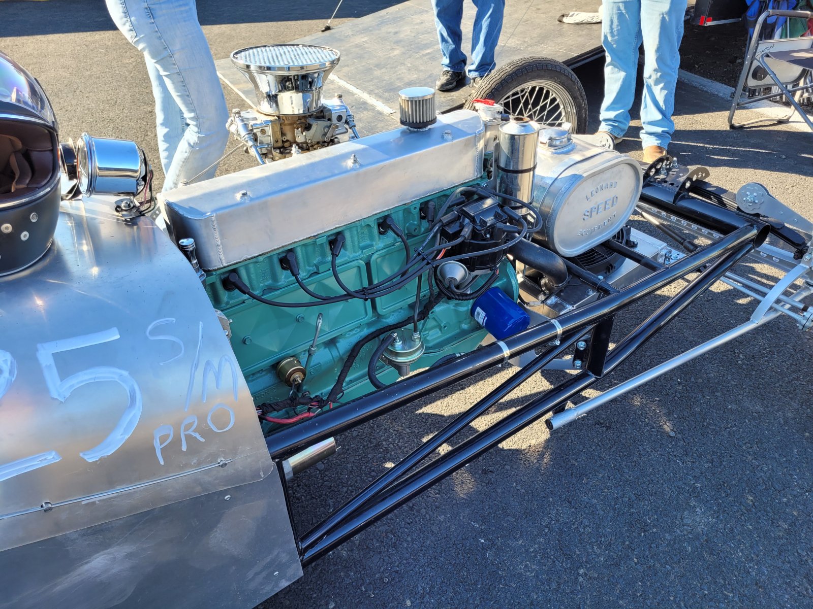

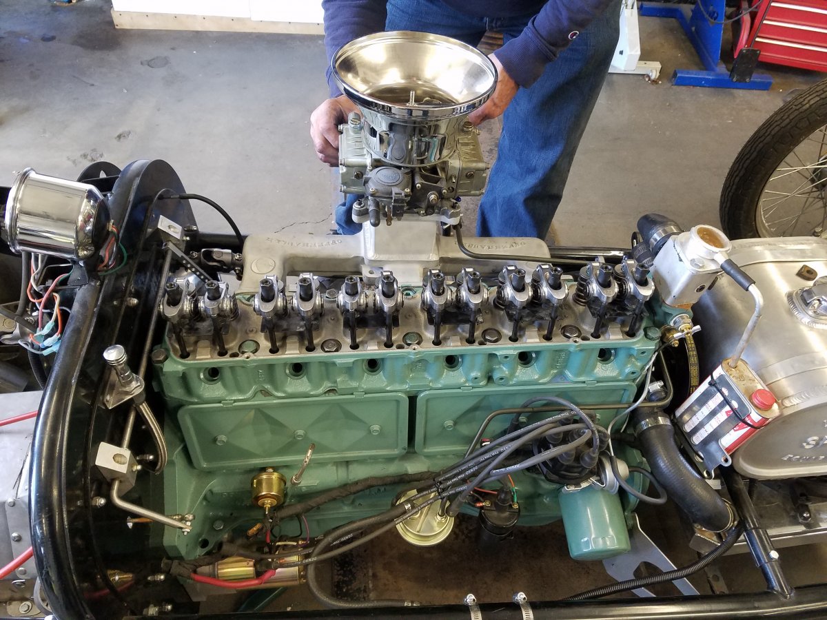

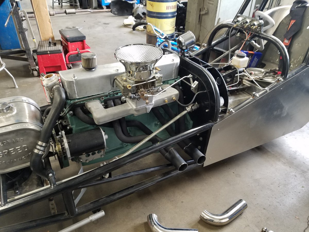

    We are still ****in air, been chasing a lot of other interests this last year so the digger has been just barely on simmer.
    The new engine is back in, got a little scared of the Harley carbs with the high compression motor, didn't want it to go lean so we opted for a holley. Had to modify a Offy intake to get what we wanted.
    Also the engine builder really wanted to see headers with collectors, so we cut up a set of headmans,

    Yes, two left side headers are the basis for a nice setup for the I6 Chevy.

    What carb are you using?
  6. rottenleonard
    Joined: Nov 7, 2008
    Posts: 1,996
    rottenleonard
    Nothing real special, just a vacuum secondary 1850 style Holley, i think it was 600 cfm.

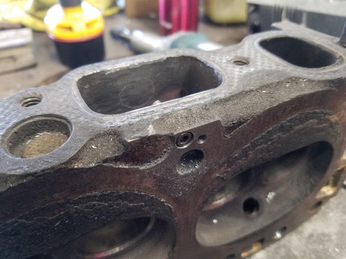

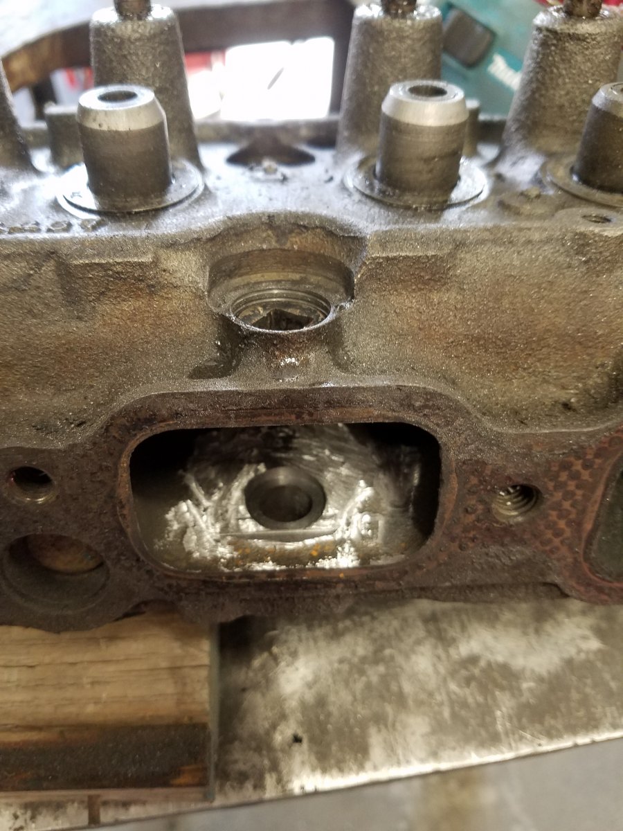

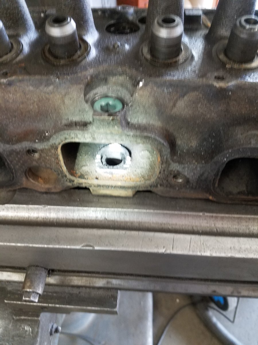

    So here is the update, right after the last post we went to pull the cord on the new 6 and was promptly met with water in the number 6 cylinder......:mad:
    So, emergancy tare down to dry it out and then promptly stuffed it back in the trailer to get it out of sight for awhile.
    Finally we got to investigating and it seems the hardened valve seats were installed too deep and they hit water:rolleyes:
    We located another head and yesterday i got it prepped to go to the machine shop.
    This included drilling out the built in pushrod guides, milling out the head bolt bossed from the intake runners and installing the lump ports after tig'n up the old screw holed.
    Few pictures i took

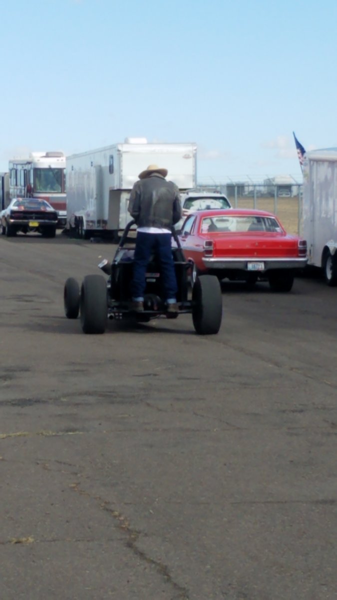

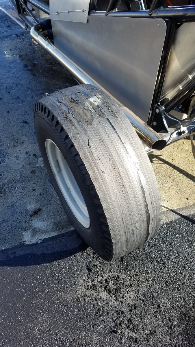

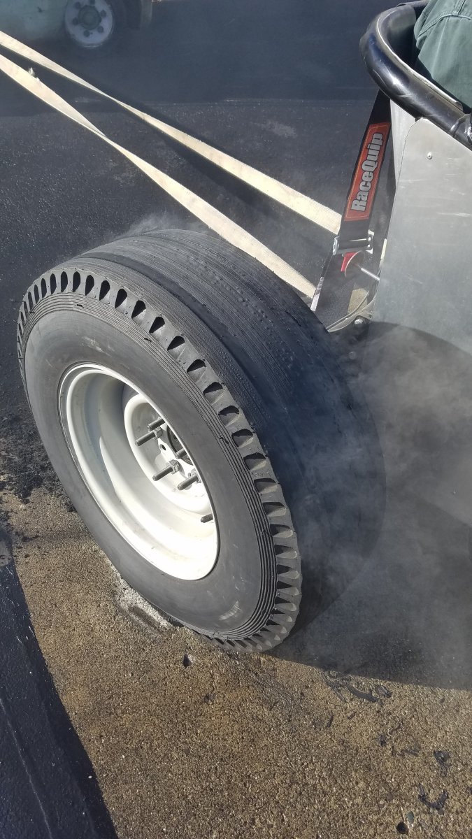

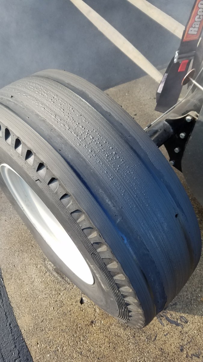

    Since this popped up, we got the tires squared up, took a few wacks. Surprised the fire department didn't show up.

    Back in the 1960s we used to take them to a local tire shop where they would true them up on a machine. If nothing else, your way looks like a lot more fun.

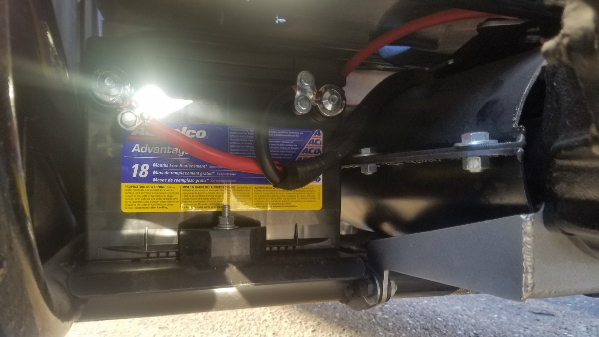

    Well we pulled the NW vintage dragster out of mothballs for last race of the season, went out to the trailer hit the ****on and fired right up , so we spent most of our afternoon before we had to leave cleaning the car and doing essentially unimportant things. Later in the evening decided we better load it in the trailer for The Following morning that's when everything went awry. The battery suddenly seemed to be dead so I stole a battery out of a van project we have herealong with the battery cables and cut out a battery box , I got it all to fit under the seat of a dragster getting rid of the Odyssey Battery we had put in a few years ago as one wouldn't be available on short notice. So once again we tried to fire it up and apparently the low voltage had taken out the pertronix ignitor .... Great. After making a few phone calls a friend dropped off a points distributor and we got the car going again but did not have a ballast resistor. We figure it would be okay to run that way for a day..... Wrong car wouldn't start when we took it back off the trailer and the points were burnt. We ran into Walla Walla and got a resistor coil and another set of points from Napa I got the car going again. The day smoothed out little from there and we made a couple of qualifying p***es spinning tires and eating Donuts at the light but eventually got it going pretty good. It was spinning pretty severely at the line still and the points were causing it to shoot ducks most the way down the track and we ran a best of 7.9 seconds at 85 miles an hour. In the eliminations we kept getting lucky and made it clear to the semi-final in our cl*** I got a little greedy cutting the light and red lit by .020 seconds, the guy in the other line broke out so we would have made it to the final if I hadn't red lit but thats drag racing I guess. There were a couple other NW dragsters there so that was cool. All in all had a great time.

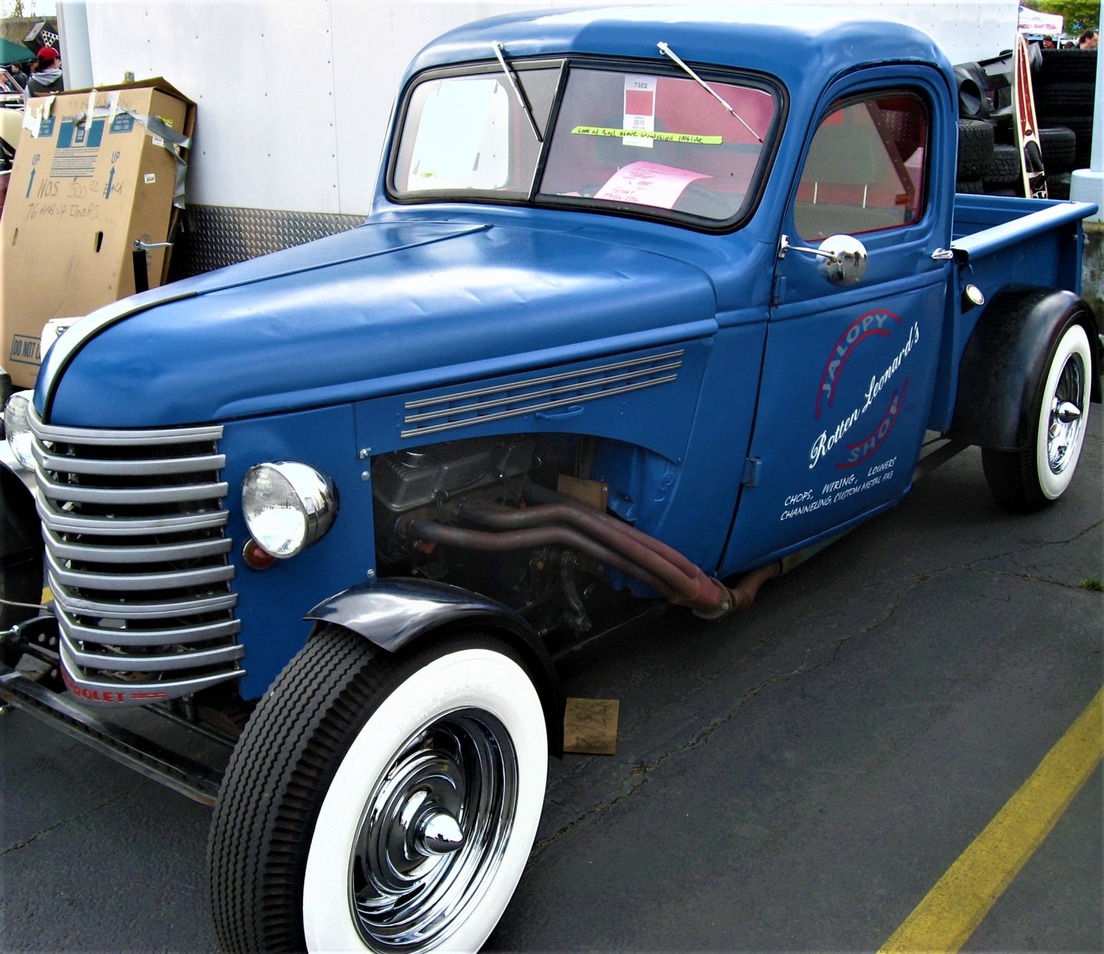

    Your crew wins a prize, a picture I took of the sign on the door, of I ***ume, one of your trucks from years past, when I saw it at the Portland Swap-meet, a number of years ago!
    Thanks for posting and sharing this amazing thread, its truly what hot rodding and drag racing is all about.
    I love well built 6 banger's that " KICK *** " !
    Thanks from Dennis.
  27. rottenleonard
    Joined: Nov 7, 2008
    Posts: 1,996
    rottenleonard
    Thanks for the pictures, i haven't seen that little bobber since it drove away. It was built purely out of leftovers from other projects and worked great like they all belonged together. The cut down box, axles, wheels and tires were from my wifes 56 pickup, the engine was a warrenty from the gmc dealership i used to work for. 3 speed overdrive from an early 50s bel air. Had 50 bucks worth of industrial paint on it. Heaps of fun. Wonder if it is still kicking around out there?
