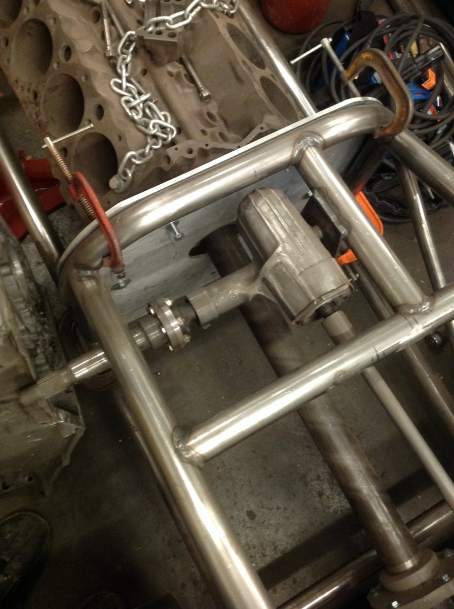

    I used a Strange box in one of the cars, and incorporated the mandatory "leg hoop" as a shaft support. IMG_0968.JPG IMG_0971.JPG

    Marty, looks like your using engine plates, we were planning on using removable crossmenbers and factory mounting points so we can put in different engine trans combos into the same ch***is. Any thoughts on this?
  12. Marty Strode
    Joined: Apr 28, 2011
    Posts: 9,685
    Marty Strode
    When we set out to build these cars, I wanted to make sure they would certify @ 7.50, so that if the cl*** failed, they would still be suitable as an Altered, or Comp style car. Using a motor plate is a simple way to have a solid, sealed firewall along with controlling and engine "rock", when loaded. It makes it easy to mount pedals, and support the removable steering mount. The only drawback is, the 1/4" plate, requires some modifications to the nose of the torque converter, and spacers on the mounting pads.

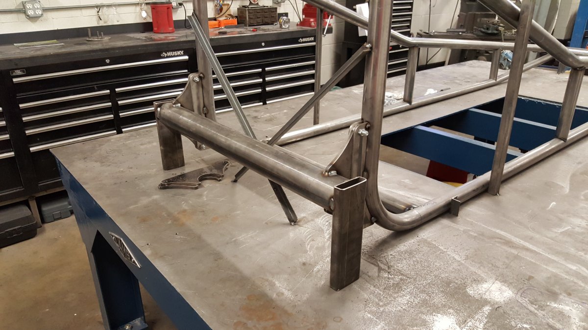

    Satler started us off right with some Hells Canyon Smokehouse

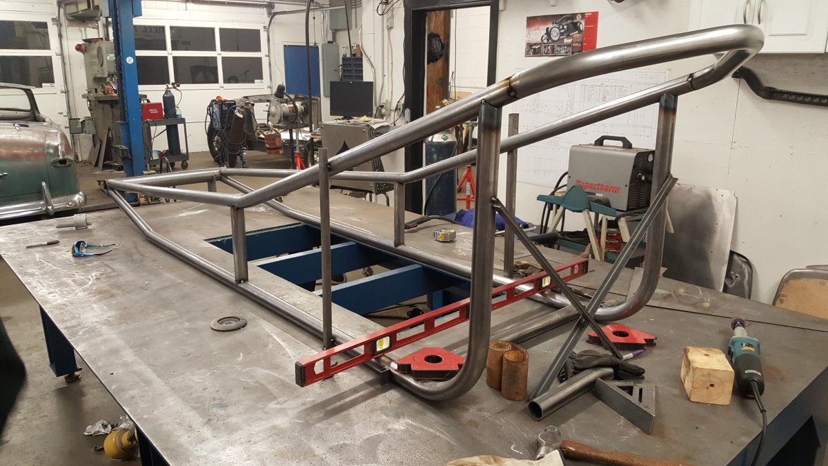

    Then we started squaring the tubes we bent last week and bracing them to the table.
    Next up was copeing the bottom tube to the shoulder hoop. i picked up one of these pipe masters for the 1 3/4, i am pretty impressed with it as it saved us a boat load of time trying to figure out how to get the longer pipes mounted in the mill.

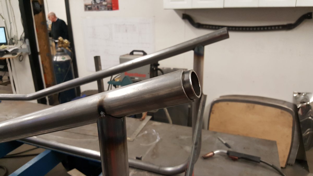

    Because we had so many mistakes last week and a pile of pipes that were just a little too short to meet in the middle like Marty's cars we opted to lessen the dip in the middle of the ch***is and then make the rear of the shoulder hoop a sperate piece. this let us use up more of the material we had on hand. here are the 1.5"OD liners for the joints installed so we can know we have full penitration on the welds and also keeps everything aligned in the process. we did end up cutting these tubes shorter so the hoop wasn't hanging back too far.
    While Randy and Satler were busting out the rear end of the shoulder hoop i coped a cross tube for the bottom of the ch***is.
    It took some finessing to get the rear bar on as it had to go threw 3 bends and then end up being a certain width. they nailed it on the second try.
    I got a couple of verical braces made before it was time to call it a night. we are pretty stoked to see it start to take shape.

    Lookin good Rob, the only thing I would question is the inner sleeves, they should be 6" long, 3" on each side of the joint. Just something to ponder.

    That's why I'm glad your here, that wasn't something I was aware of. one half of the sleave would be inside of the bend but i do have a 1.5" X 7" clr die where i could probably pull that off, do you think that would be acceptable or should we re-bend that back section and move the joints farther forward? that would put the joint right where the uprights connect.

    I would re-bend the back section as you stated, and if the splices fall in the middle of the weld joint, that would be great. I drill 3/8" holes for plug welds, 4 on each joint. IMG_3890.JPG IMG_3891.JPG

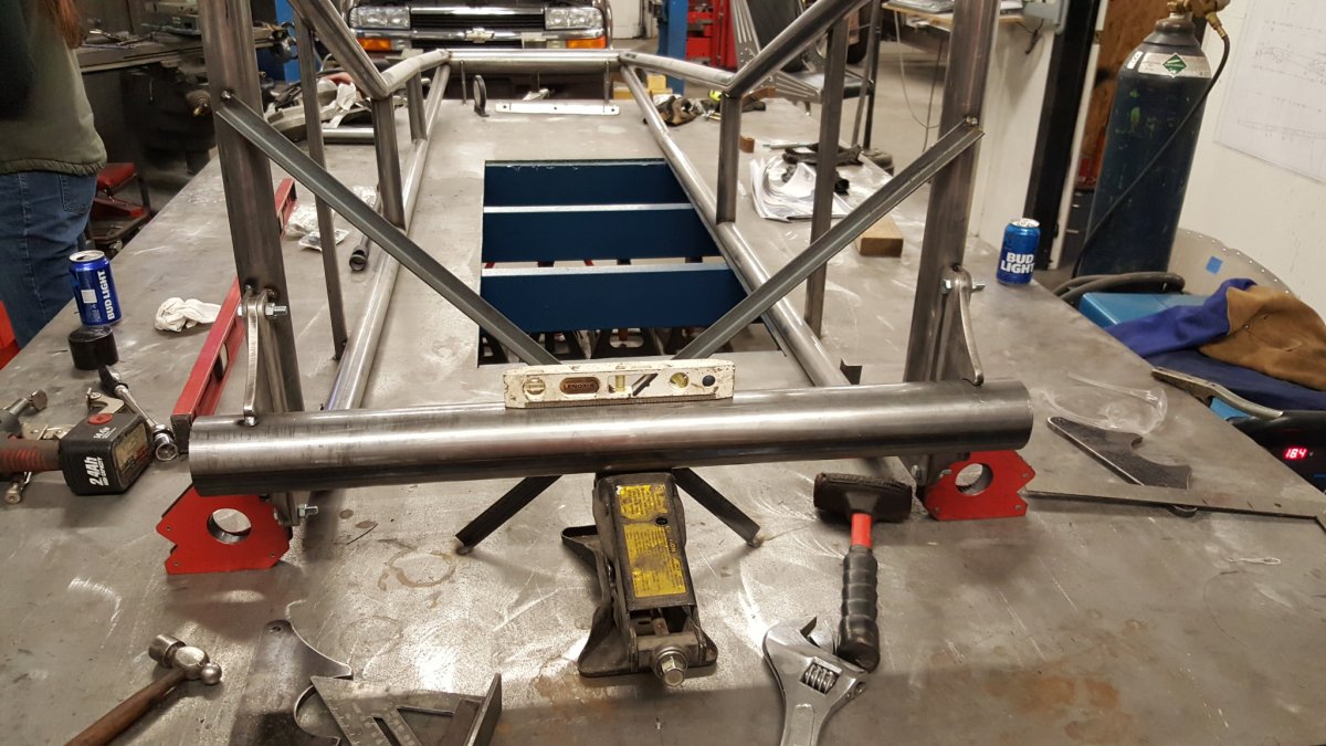

    We started out by burning out some rear axle brackets. we used 3/8" on the axle and sandwiched that with 3/16 on the ch***is. Then we got the idea to build up a jig for welding them on so that we would be able to swap the rearends between the cars.
    Then added some stands for the jig to save some time wth leveling and squaring things up next time.
    Next i hopped on the plasma cam and burned out this front spring perch.

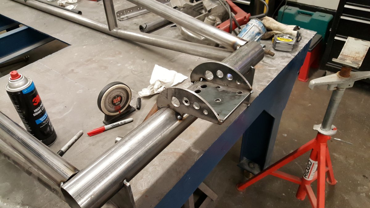

    Marty, how much caster are you guys liking in these things? we have it tacked in at 12 °.......too much?
    Couple of victory shots for the night

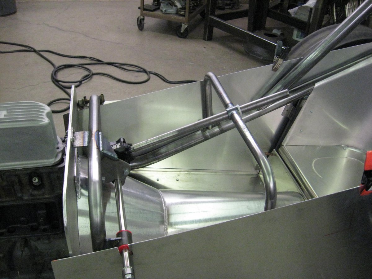

    IMG_3371.JPG We used a mopar steering box

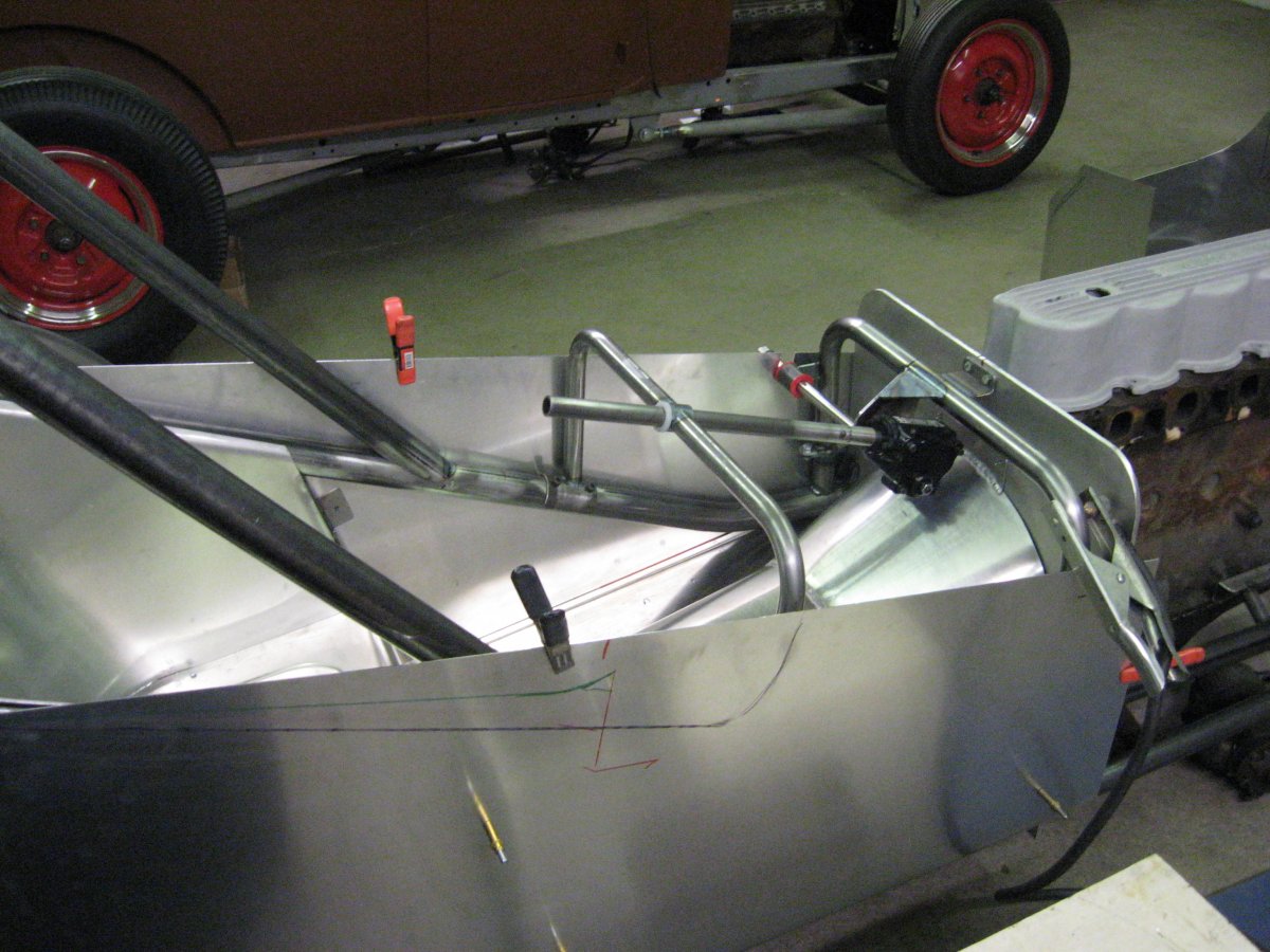

    IMG_0524.JPG This is as far as we have got

    That is a clean looking setup for sure. i need to build a dragster just to hang from the ceiling...adds a little something to a shop;)

    Twelve degrees should be plenty for your application. I normally run my dragsters at 20 and altereds at 15 or less. FYI when I was at John Force Racing the funny cars only ran 6 degrees (and ran 330 mph).
    On another point the rear axle mounts should have 4 bolts (7/16" min.) per side.
    And finally although your car will probably not fall within the SFI parameters any splice in the shoulder hoop should be between the forward and secondary roll cage hoops.

    Thanks for keeping us on the right track, we will make the corrections on the axle brackets and the rear hoop on the next shop night. This build really is a ton of fun.
