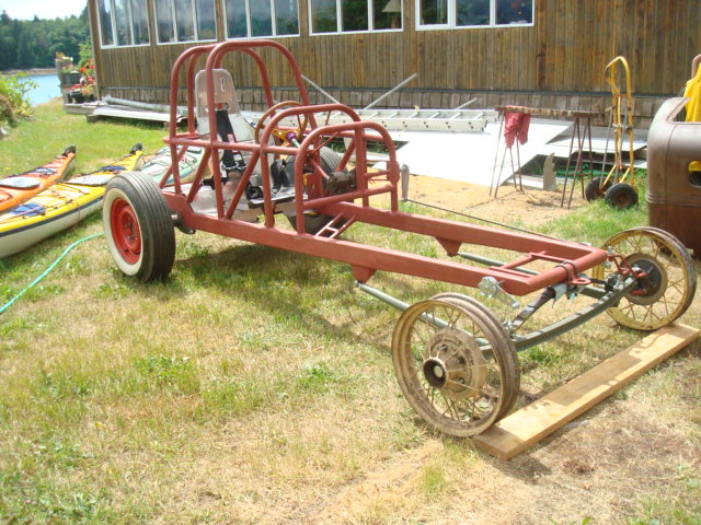

    NW Vintage Dragsters Logo.jpg Thought I'd better get on here and officially welcome you to the Northwest Vintage Dragsters group before you got the car done and running. Glad I did already get a chance to email and talk to you on the phone.
    Also wanted to let any other interested HAMBsters know that we are having meeting on Sat. December 3, 2016 at Noon at the Lemay Automotive Museum in Tacoma, WA. PM me to RSVP if you plan to attend or if you need more info.

    It sure is looking like a lot of fun! I wish they ran those cl***es around here! hey where is the pics of tonight's bbq? also can you run any motor you want?

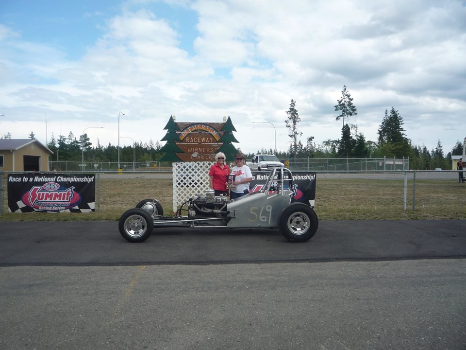

    So back to our regularly scheduled discussion: What does it take to get a 292 Chevy to run a 12 second ET in one of these dragsters? Answer: Not much.
    A stock 292 Chevy is rated at 165 HP. Using a common ET/SPEED calculator, in a 1700 lbs car (driver included) that equates to a 12.70 ET. Want a real world example? Take this one that Dan referred to earlier. This is Debbie's (Scott's wife) Dragster:
    It is a stock 292 with an Edelbrock 4-bbl, headers, and I believe a RV type cam. Powerglide trans, Chevy S10 rear end with 3:70 gears. Runs close to 12 seconds flat. A little more cam, some basic headwork (like a bolt-in lump port), compression (by head and block milling) and it would be well into the 11's.
    Another example: My dragster runs a 225 Slant six. The short block is all stock. I milled the block and head to get 9.5/1 compression. Did my own head port clean- up and run a reground cam. I built a set of Zoomies for exhaust and an intake running two 2 bbl Rochester carbs. Also a Powerglide trans and 3:70 gears. Shifting at 5000 RPMs it runs 12 flat. Up the shift point to 5400 and it runs 11:80's. Car weighs 1550 lbs w/o driver.
    So, I try to emphasize that you don't need to go crazy building engines for this cl***. Spend your time and energy building something fun and unique.

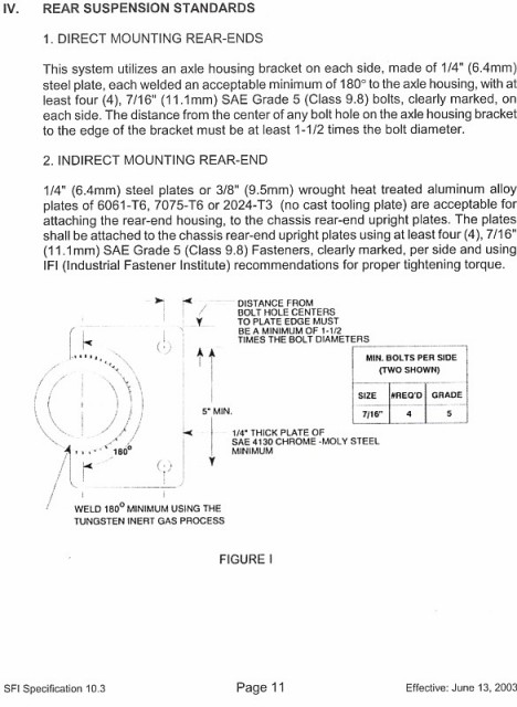

  26. Casual 6
    Joined: May 25, 2008
    Posts: 308
    Casual 6
    from Great NW

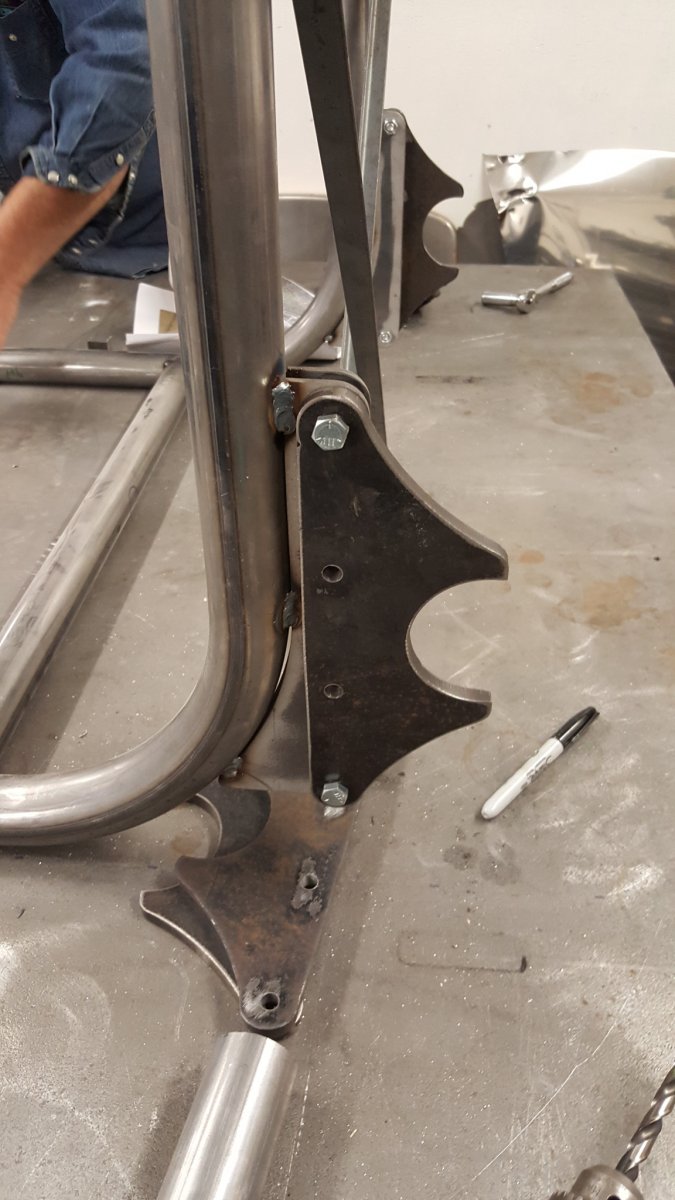

    While you're setting up the rear end brackets, here is the SFI spec on the bolt pattern. It is a little deceiving because the picture only shows two holes, but the requirement is for 4 bolts.
    And you need an anti-rotation device on the rear axle as well.
    I can't find it right now, but I think there is also an angle call-out for the front roll bar hoop. Maybe someone can comment on that.

  27. Marty Strode
    Joined: Apr 28, 2011
    Posts: 9,685
    Marty Strode
    The front hoop angle is a minimum of 20 degrees, as I remember.
  28. rooman
    Joined: Sep 20, 2006
    Posts: 4,045
    rooman
    The SFI 2.4 spec has shown the 4 bolt deal since 2010 and Marty is correct on the 20 degree deal for the front hoop (despite the fact that one of my customers had an NHRA tech guy put a new cage on his dragster with the front hoop only about 5 degrees off vertical).
    Roo

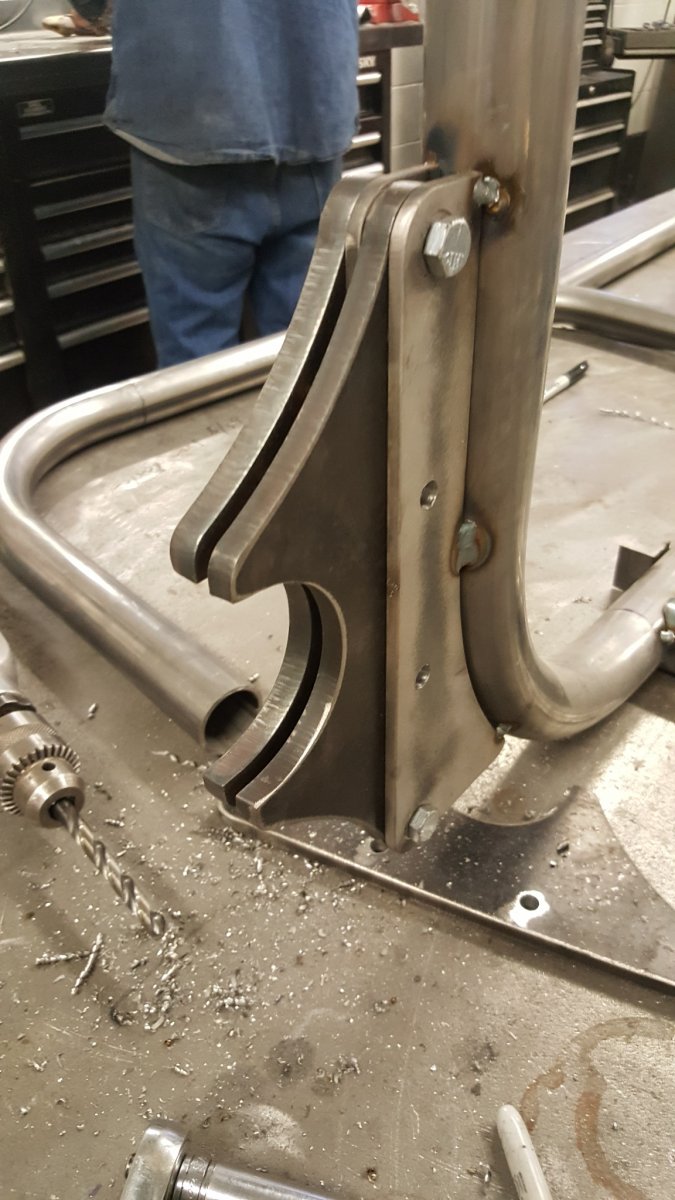

  30. rottenleonard
    Joined: Nov 7, 2008
    Posts: 1,996
    rottenleonard
    Thanks Horace, kind words.

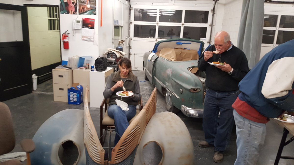

    Randy got the tanks filled with some roasted chicken and awesome broccoli-slaw his wife fixed us.
    My wife eating dinner in her office

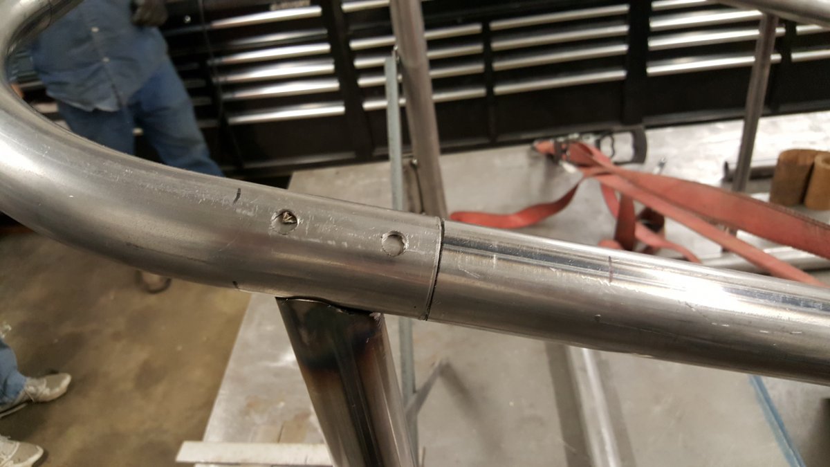

    We got started on the recommended corrections, first redoing the rear shoulder hoop to get the junction ahead of the upright and put in the required 6 inch sleave. this time we just went with a square design verses the trilobal design as per some great advice from Roo.
    I like the square look just as well...
    Next up i cut out some new axle brackets with two more mounting holes and then we used them as drill guides to correct the bolt pattern on the brackets that had already been tacked on the ch***is

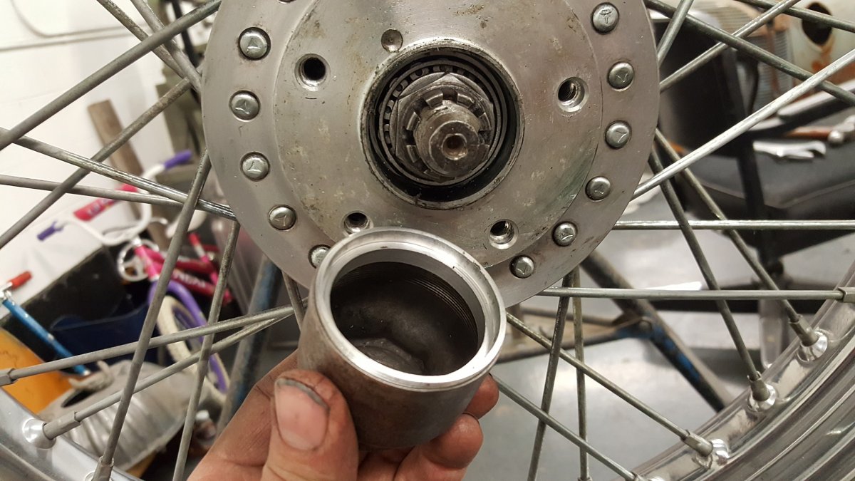

    Meanwhile my old man (Steve) spent the night doing some cleanup and mockup of the front steering setup, he is modifying some model T stuff to work with the car. It is going to look killer!
    He also turned out these cool adapters to use the model T grease caps on the Harley wheels.
    The rest of the night we spent makin up some tubular braces and spent some time with some heave BS... and bench racing.....
