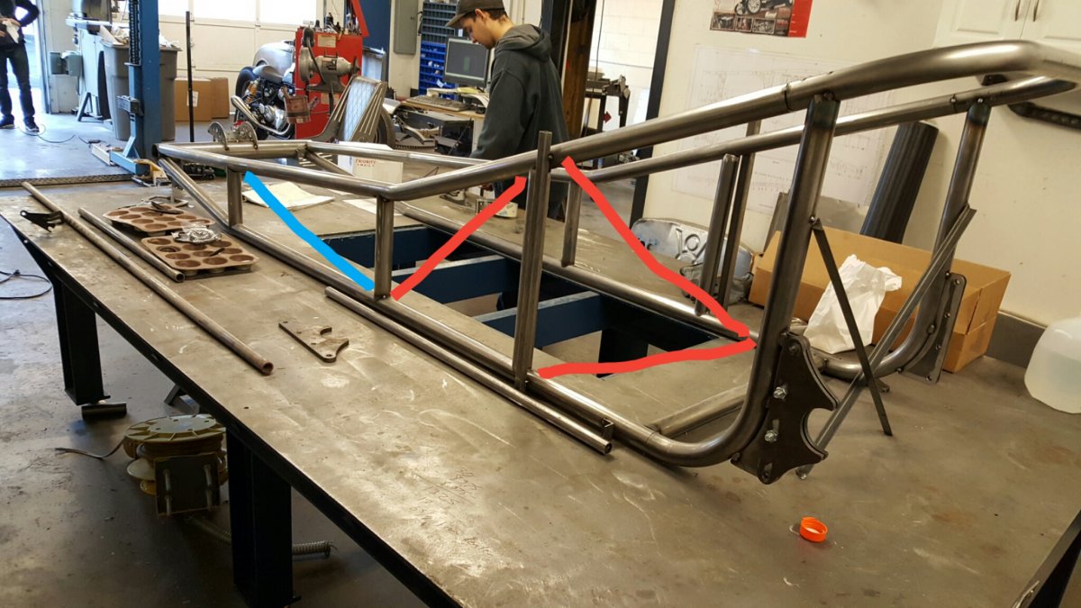

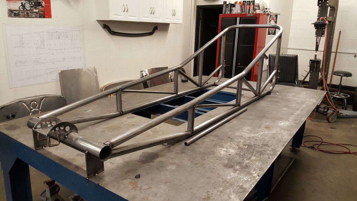

    Thought I would put this up before our panel of judges before we start cutting cross tubes. the blue would be 1" -1/8" wall and the red would be 1.5" -1/8" wall. Any issues spotted or advise is appreciated.

    Don't paint'em blue & red, looks silly. ;)
    Sorry, Sir. Just couldn't resist. :D

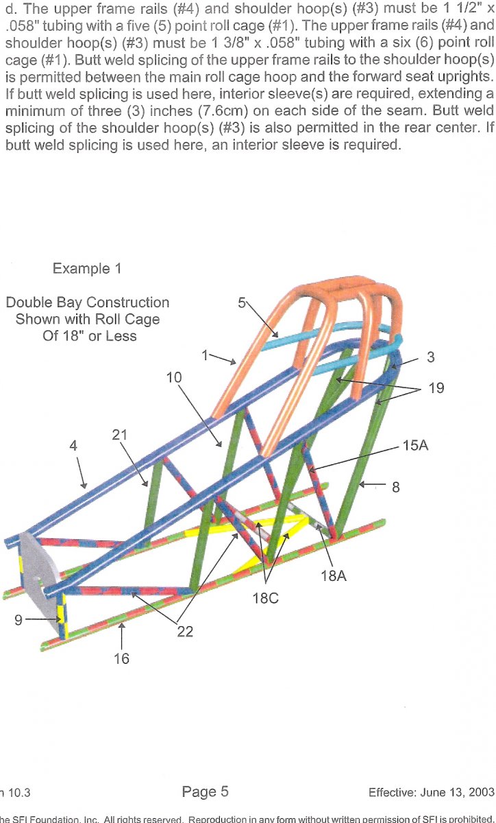

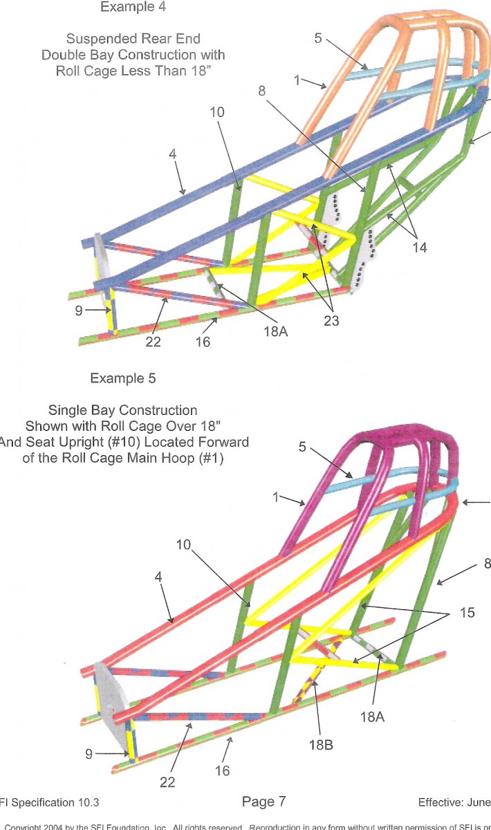

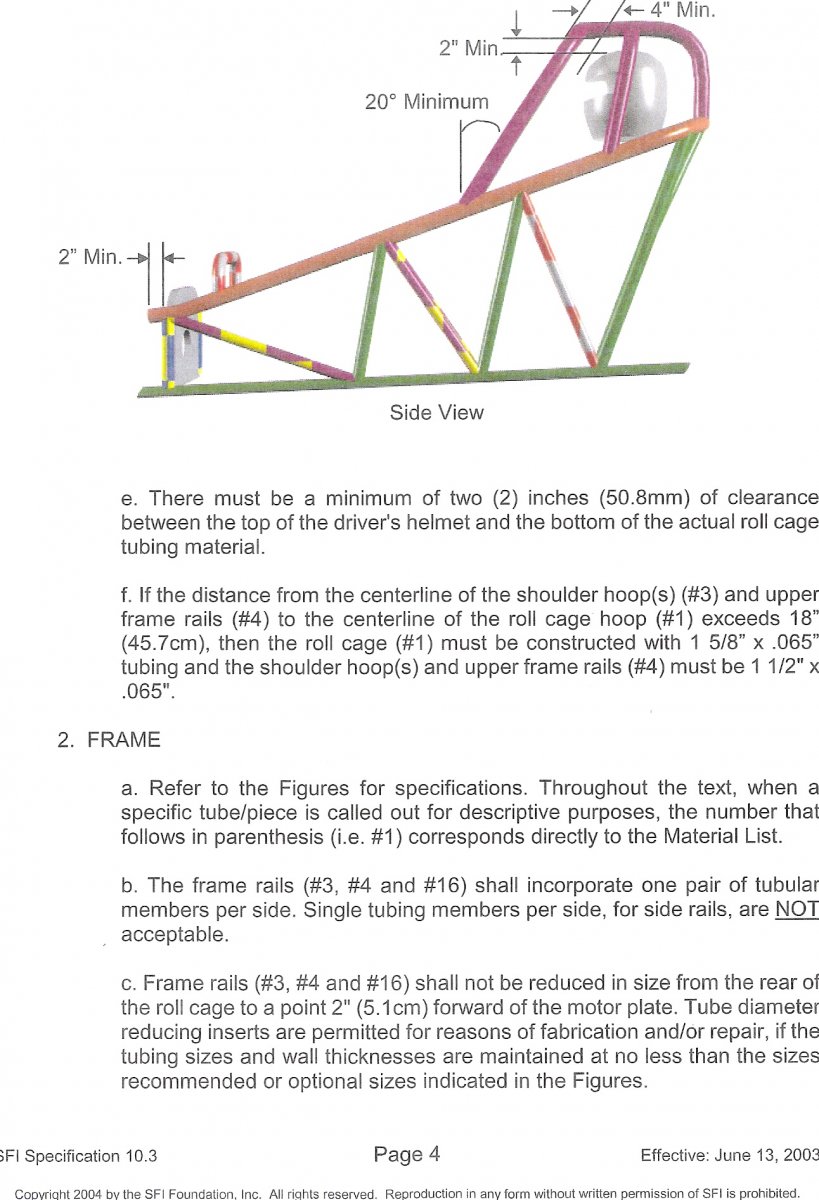

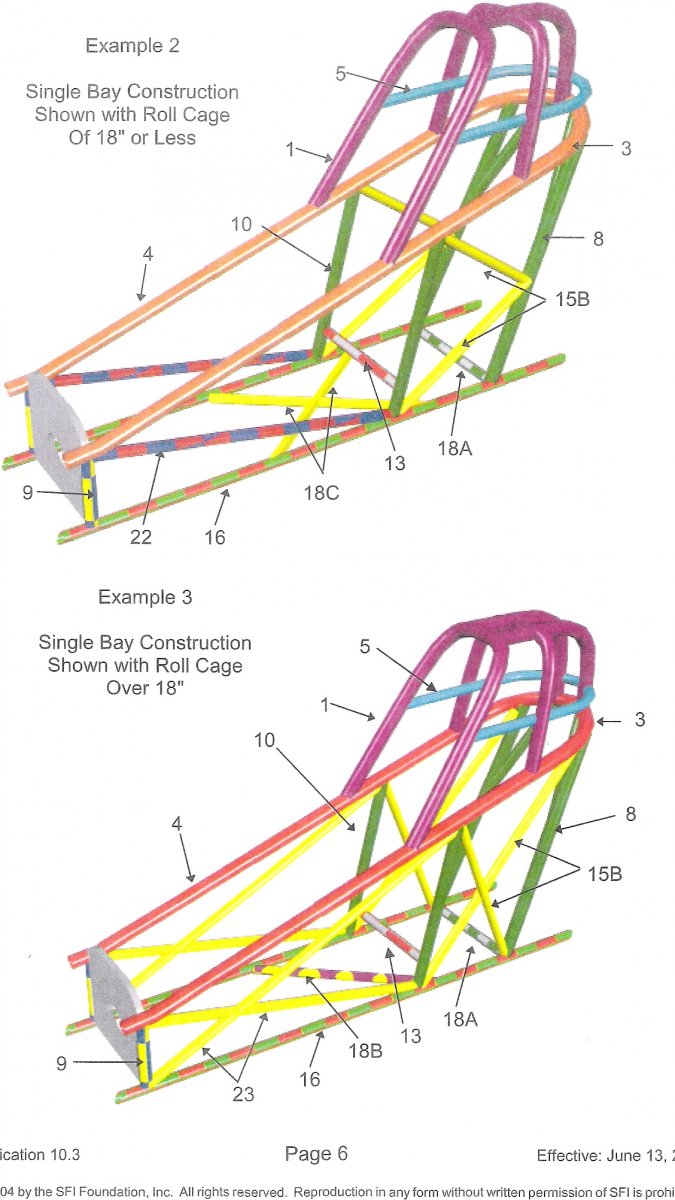

    These should help with the bar placement (see they do come in various colors):

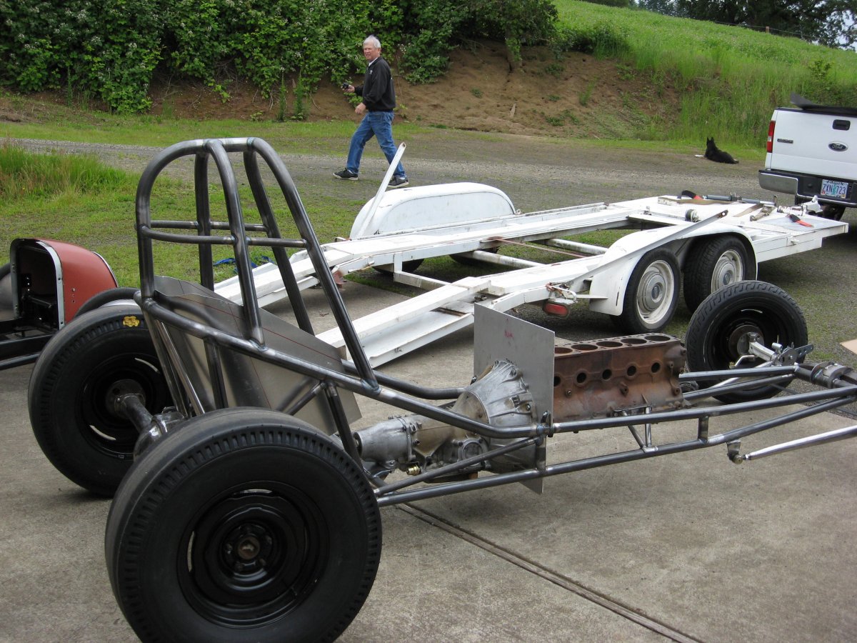

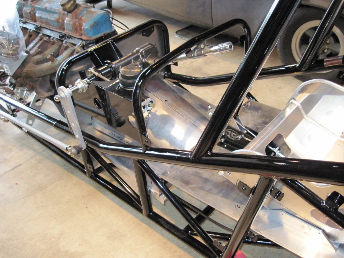

    And a real one:

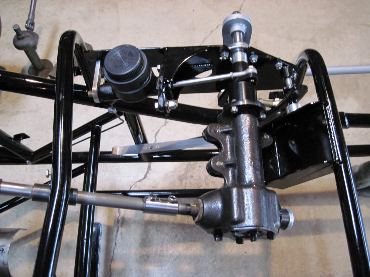

    Also a note about another possible steering box Rob asked about earlier. Since we're not going for the absolute minimum weight on these cars, I used a reversed Mustang box. It wasn't as hard to find as the aluminum MoPar box.

  6. rooman
    Joined: Sep 20, 2006
    Posts: 4,045
    rooman
    I would reverse the angle of the forward red diagonal (as per CASUAL6's frame).
    Roo

    A couple of comments. I ran a mild flathead dragster in late '60. Had 276 cu in, side shift ford trans, and 4.11 rear end.
    With 26" tires ran out of engine at 1000' but got out of the hole well. With 29" tires could nt get off the line but pulled thru the 1/4 mile. Ran in low 12s I hope your not going to run that T front axel over 60MPH. When welding in the diagonal braces one of the vertical draces has to be loose of you have to have excessive fish mouth on the diagonals. Don't ask how I know. Also short wheelbase cars can get squarrelie at speeds.

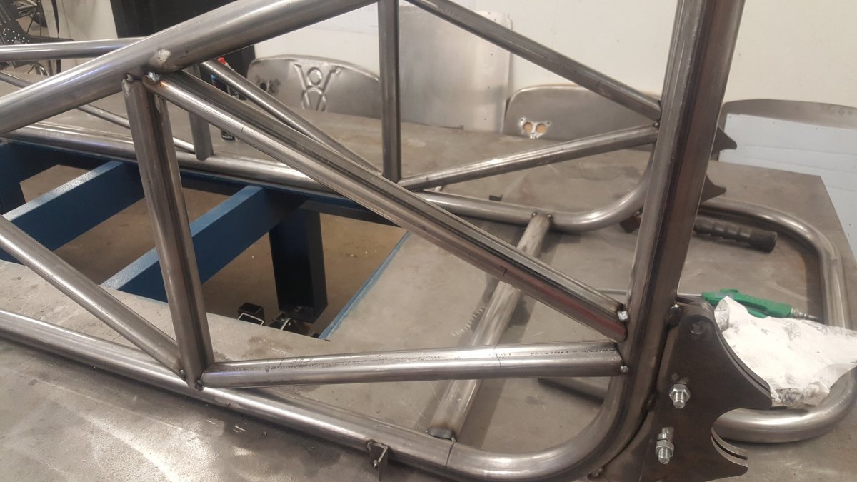

    Not a ton to show this week other than mustard sauekraut pizza is pretty tasty and coping the cross braces is time consuming....

    As an aside, I think FEDs have to have 6-point cages per NHRA rules, if that is of concern. I had to change over a perfectly good 5-point to a 6-point a few years back to stay legal for NHRA.

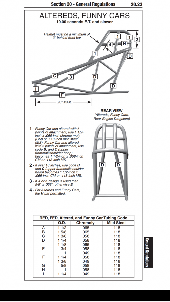

    So if I'm reading that right, we should be good with 1/8" wall 1 1/2" MS no matter if we are over or under 18"...? Seems kind of odd that they would make a height statement if it doesn't change the material spec.

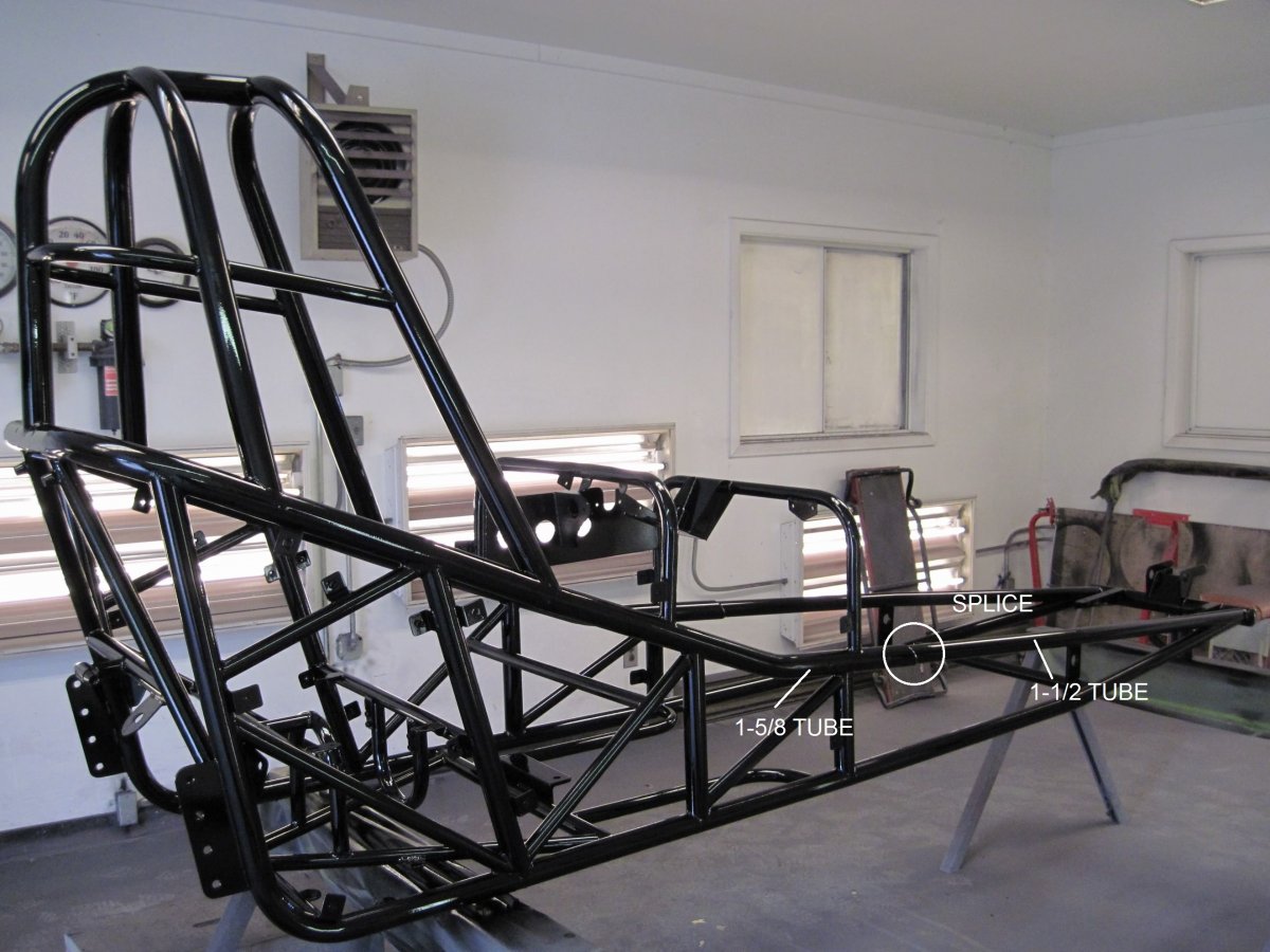

  21. Casual 6
    Joined: May 25, 2008
    Posts: 306
    Casual 6
    from Great NW
    You need to use 1/8" wall 1-5/8" OD (CODE B) for the roll bar hoops (labeled 1) on both (over and under 18" tall) for a 5-point cage.
    And then 1-1/2-inch x .065-inch CM or .118-inch MS (instead of the 1-3/8") for the upper framerail/shoulder hoop (labeled C) is also required for both over and under 18" tall 5-point cages.
    And remember, you can always use larger tubes if you want. These are just the minimums. We used 1-5/8" tube for the framerail/shoulder hoop (labeled C). That way the roll bar hoops match the framerail/shoulder hoop when welded together.
    We also spliced a 1-1/2" tube into the framerail/shoulder hoop 2" in front of the rear motor plate going forward to the front axle. That 2" is also a requirement if you neck down the framerail/shoulder hoop.

    Actually a five point is legal in front motor dragsters as quick as NT/F as per the SFI 2.2 spec. As for the engine location you really should mount it with the rear of the block in line with the appropriate upright (that is why it is called the motor upright in the spec). That way the engine load is transferred to the frame where it is supported and the motor plate acts as a firewall. I have seen numerous cars with the motor mounts "out in space" between the uprights and the results are usually not good, especially once the car gets a few laps on it.

    rottenleonard

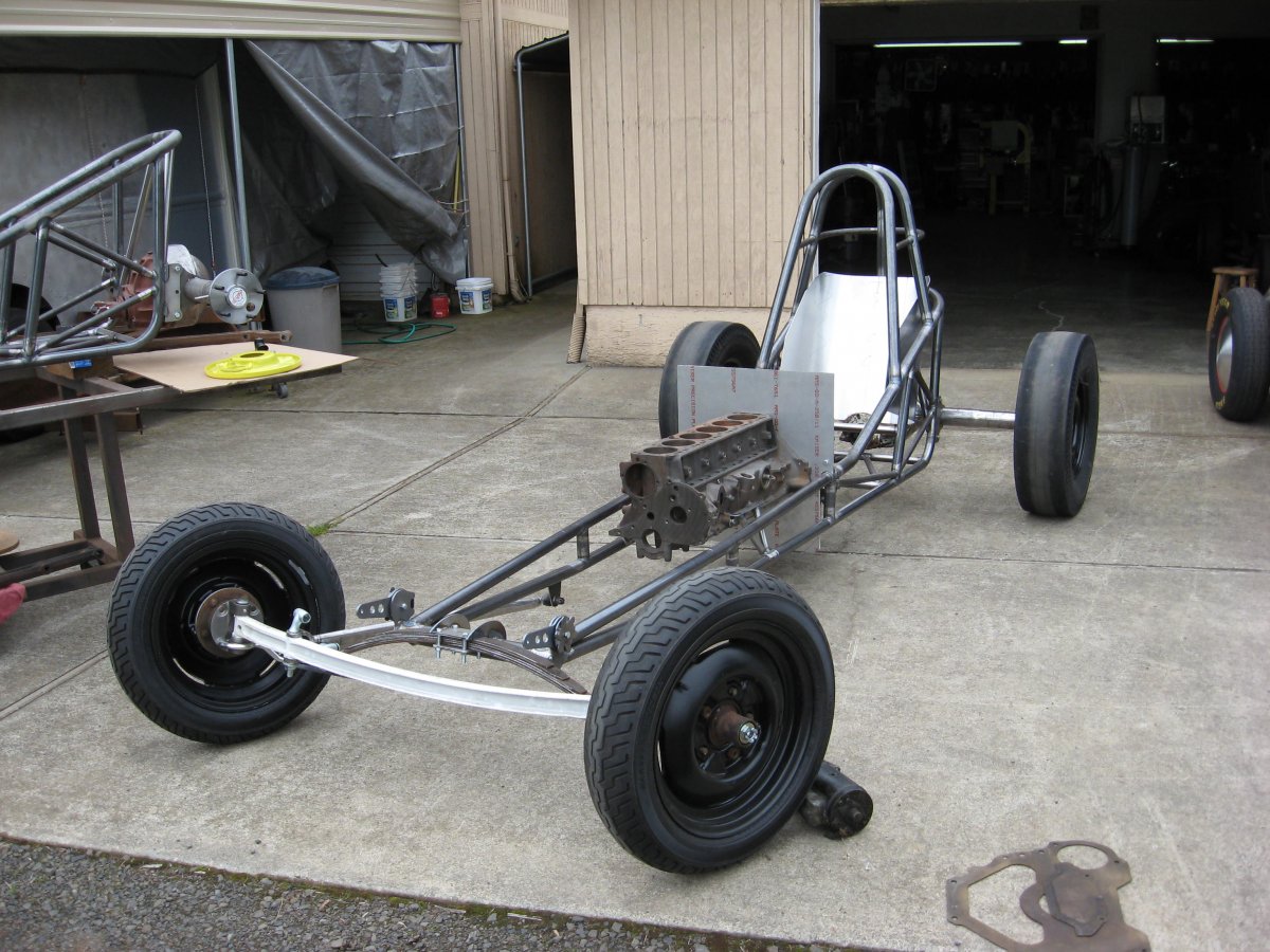

    Dad showed up last night with the roll bar pre-made. (Exaust tubing for another project)
    We got the last two cross braces made up for the sides of the chassis.
    That makes sense and is good news. I had it drawn up to be a couple of inches past that upright. We cut the chassis off the table and put it over our mockup motor. Then made up a plywood mockup seat that looked like it would work with the driveline hoops. Sitting in the car we were able to move the engine back a little over 2 inches which put the front of the bell housing right on the upright. So we decided to go ahead and run a mid motor plate.
    We did notice that the next upright back probably should have been about 4" farther back so a straight cross tube could have supported the front of the seat. As it is right now if it went straight accross it would have to go threw your calves. I think we can get by withsome bent tubes to get it back. And then make the alteration on the next chassis.
    It does work out nice for the trans crossmember, but i would think it would be ok if it were mounted ahead of that upright 4 inches.

    If you are running a mid plate and front motor mounts the trans cross member is unnecessary (and may cause problems) At the most use a factory style soft mount pad if you feel the need to support the trans but all of my dragsters/altereds just hang the trans off the mid plate/block. A lot of people worry about the trans hanging out there but in the factory installation the whole package is supported at the ends (trans mount and engine side mounts) so the bellhousing is plenty strong enough.
    If you are going to use a front plate (from the front face of the block) it would pay to mock up the engine in the next car and place the upright in line with the front of the block. That way the engine weight and torque load) goes into the frame where it is supported (and is also spread into the lower rail as well). At the performance levels that you are planning what you have will work but I have seen lots of issues with the motor "hung out in space" in higher powered cars.
    As for the seat cross member I would use a piece of 1" tube bent to land on the lower of the rear "K" tubes so that it is at least 6" to the rear of the driver's knees.
    Roo
    Hotdoggin DaddyO and loudbang like this.

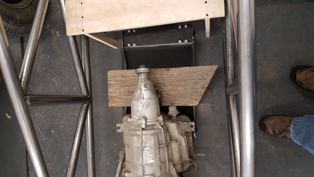

    Fair enough, one question, looking things over, the car would be pretty comfortable with the floorboards down at the level of the bottom of the trans pan. Can the trans be in the cockpit if it is covered with a blanket or shield?

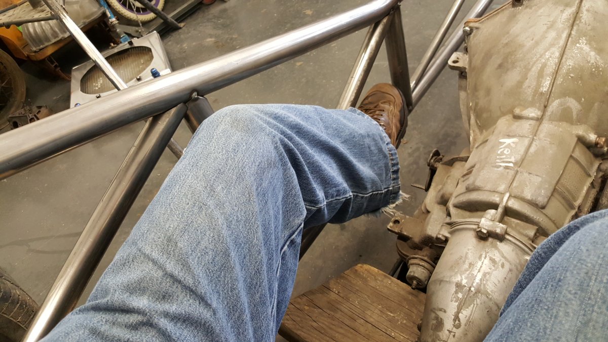

  30. Casual 6
    Posts: 306
    Casual 6
    from Great NW
    If the trans only has a blanket or shield, you'll need to wear a SFI-15 or better suit. I don't think you want to do that (~$1500+ and certs required).
    So, you'll need a complete sealed metal firewall and floor. Then it's Levis and tennis shoes.
    If you run the 12 Second ET, you won't need a trans shield. Then you can wrap the trans tunnel real close to the trans. The floor where my feet are is about level with the bottom of the trans (pics). My seat platform is about 3 inches higher. I also made the trans tunnel in 2 pcs so it is easy to remove.
