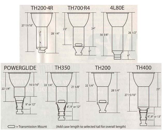

    I did not see this mentioned: the power glide mock-up trans in the photos. Looks like the early version with a shorter output shaft than the more common length output shaft used in performance power glides.
    The common length tail housing measures near 11 & 1/2 inches long over all end to end.

    Yes it is the shorter trans. On previous advise on first gear ratio we are on the hunt for a TH350 and it looks like we should be able to find one that 27 5/8 long and it will still work. Our driveshaft is shaping up to be about a foot long.

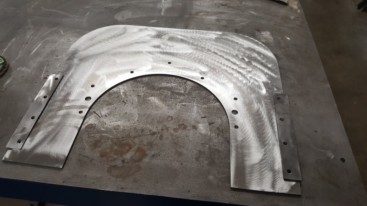

    Why isn't the bolt circle concentric with the ID and OD of the part?

    Bad parts got shipped out. They are going to send another one.

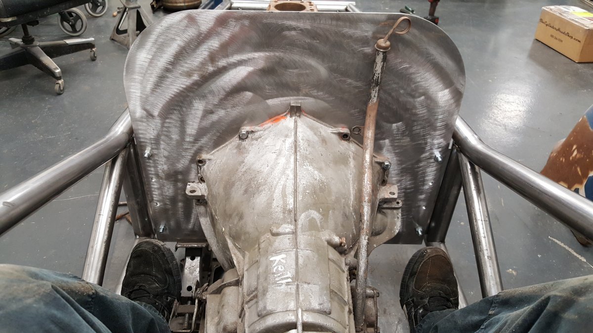

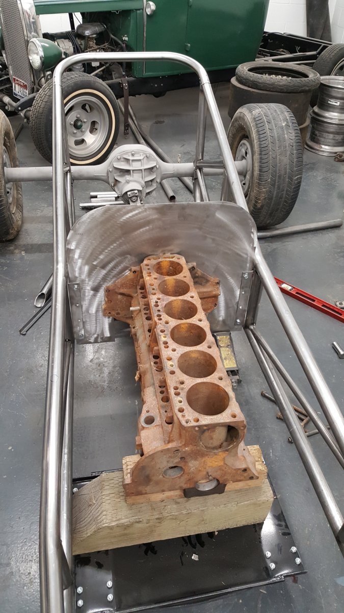

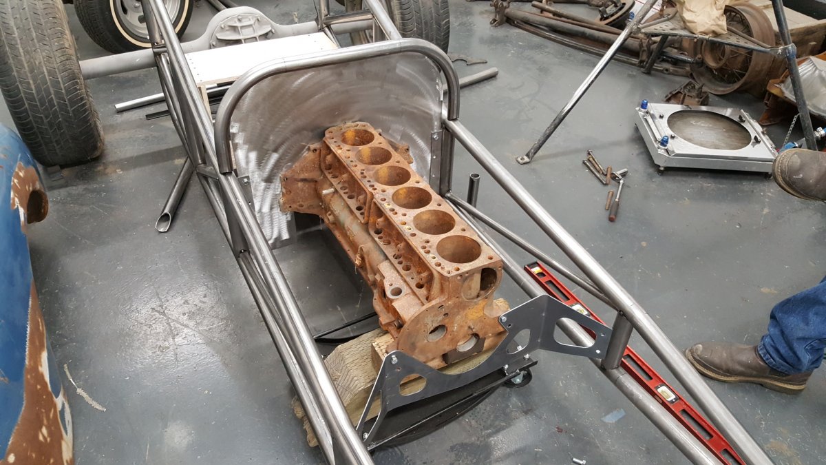

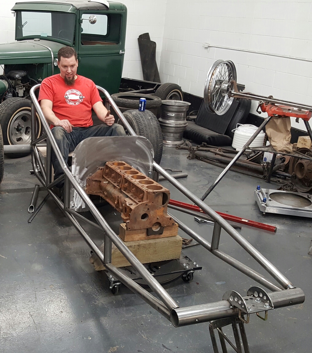

    So with my confidence rattled with the store bought midplate we decided to produce our own, this would work better for the firewall anyhow. Dug around the interweb and found the dimensions and drew up the cad file.
    I burned it out on the Plasmacam just marking the bolt locations then drilled them on the mill.
    Fit perfect much happier with the results
    Meanwhile Randy and Wayne knocked out the two cross braces under the seat that the driveline hoops will be mounted on. And then they bent up the firewall hoop. You can see the front mount I started working on in this pic, it needs some slimming down and cearancing for the timing cover before the final one is cut.

    You guys sure do nice work. Only thing I'd question'd be having the anchors of the front mount off the plane of the engine face. Wouldn't that allow flex at those two bends, and thus at the firewall?

    The flex would be minimal and only in extreme stress. Actually, the angled front plate might even function as a "blowback device" to limit rearward travel. On Halloween of 2000 I wrecked my Logghe car - hitting a concrete guardwall head-on at about 60 mph - and the entire engine / trans deflected about 2" forward in the ch***is. This dissipated some of the crash energy which otherwise may have proved fatal.

    A couple of things; It is usually a good idea to put the motor mount tabs/plates on the rear side of the mid plate as it makes it easier to pull the motor/trans package as a unit. Likewise with the upper hoop.
    And on the subject of the mid plate, with just a hole for the crank (or flexplate) having the lower surface contiguous will provide a firewall and somewhere to hook the front of the belly pan. Of course as you are going to have to put a floor over the trans to avoid having to shell out big $$ for a -15 firesuit to the point is a little moot. It is also a good idea to make the upper part of the firewall the same width as the outside of the frame rails and notch it to drop between the rails. By doing that the weight of the engine is carried by the plate itself and not the bolts holding it to the flanges. When you do that four bolts are sufficient to hold the mid plate in place--one at each frame tube. With that set up the frame hoop is not really necessary as the body will seal on the mid plate.

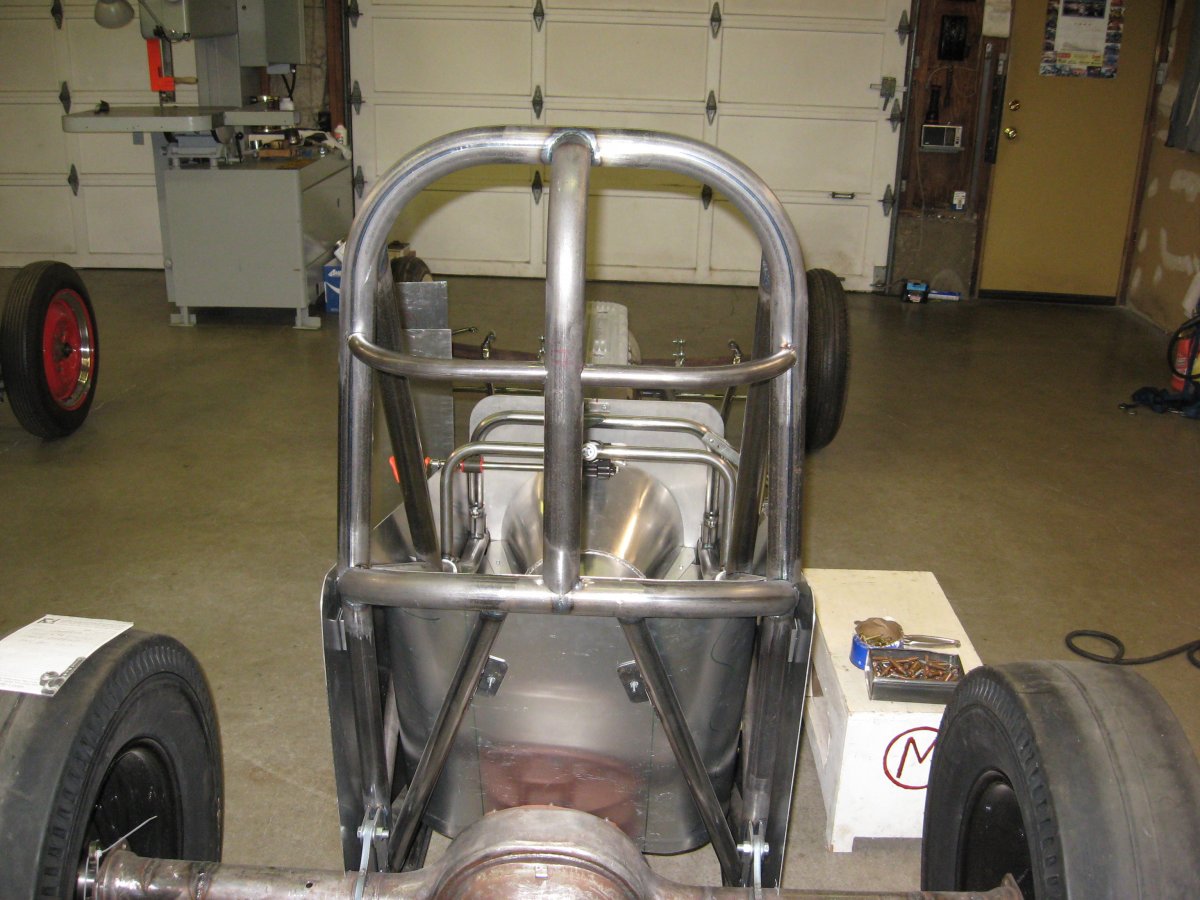

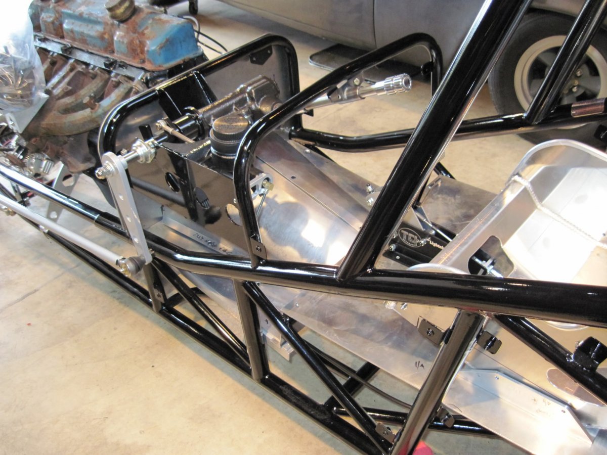

    Saltflats, Here are a couple of shots that show the motor-plate. I use 1/4" aluminum, the drawback is modifications to the nose, and the pads of the torque converter is required. Aluminum is pretty standard stuff on Dragsters, Funny Cars and Altereds. IMG_0970.JPG IMG_0972.JPG

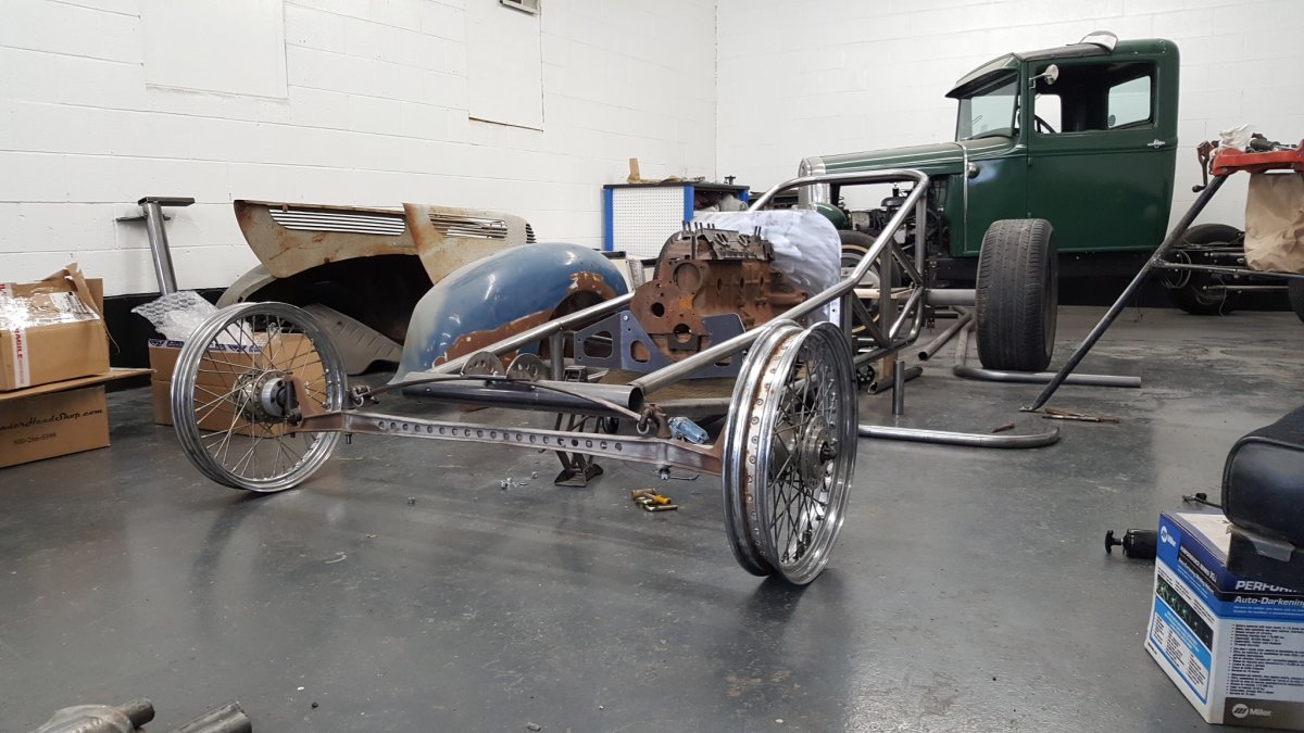

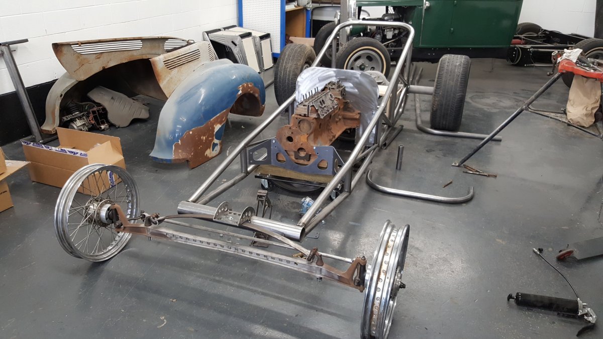

    Just mocked up the front axle. We still need to add some leafs. But it sure looks cool. 20161222_121633.jpg 20161222_131428.jpg

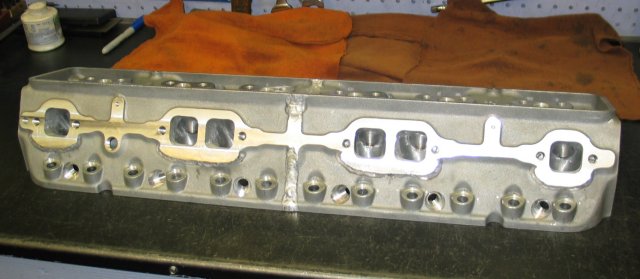

    Rob, Are you going to run that head ? I guess you would save on pistons and bore job!
  28. DDDenny
    Posts: 22,570
    Hey Marty, stop by and pick me up on the way.
  29. rottenleonard
    Joined: Nov 7, 2008
    Posts: 1,993
    rottenleonard
    Ah we were BS'n the other night and reading about how they put these sb heads on these chevy sixes. Pretty quick we had a junk head in the band saw. Would be cool but looks like a lot of work.
