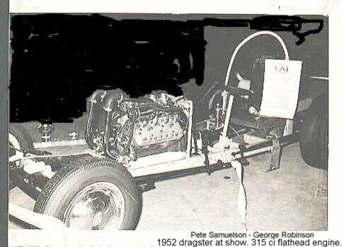

    A few days ago i recieved a cool pm, and asked permission to post it here as I really got a kick out of it. The message came from pete1,
    Hi,
    I just came across this thread.
    What you are doing is neat stuff but a little later vintage than I imagined from the ***le of the thread.
    A friend and I built the first thing that could be called a "dragster" in the NW in 1951.
    It was basically just a frame with a 315 ci flathead in it. No body at all.
    At the time, we figured if we were strapped in tight and had a roll bar, we were safe...LOL
    They had no elapsed time clocks at that time so MPH was all we had.
    The best we turned was 128 on straight alcohol.
    We experimented with Hydrazine and Picric acid but all we got was more wheel spin.
    We ran at the old Arlington,Wa airstrip.
    I see Marty Strode is on the thread also. He is a very good friend of mine and I have raced vintage circle track roadsters with him many times.
    Pete Samuelson

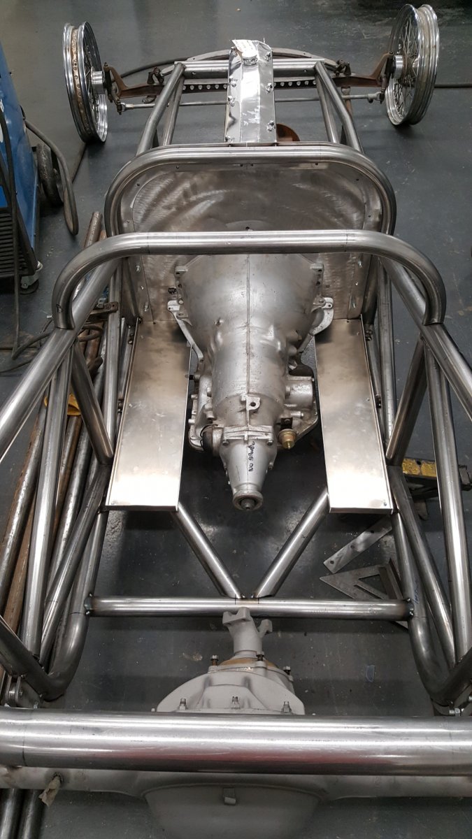

    Pizza and apple pie got us off to a good start last night.
    While it isn't a full new midplate as suggested, one of us forgot to pick up more cold rolled this week (**** that was me) so we collectively decided to save the one we made last week by cutting filler panels that will also serve as the mounting tabs. It will have a row of ****on head cap screws around the perimeter. It definatly won't be as handy when pulling the motor but I don't think we will be going that deep between rounds.
    The tabs are drilled for the mounting bolts seen in this next picture, but we havent gotten around to drilling the midplate yet.
    We reworked the front mount and made up some tabs for it.

    Last night wasn't super productive, a lot of head scratching on the floor l, driveline enclosure, axle anti-rotation and seat but I think we have it mostly thought threw.
    We did knock out the bar that goes over the knees and the start of the floorboards.
    I cought Randy taking it for a spin!

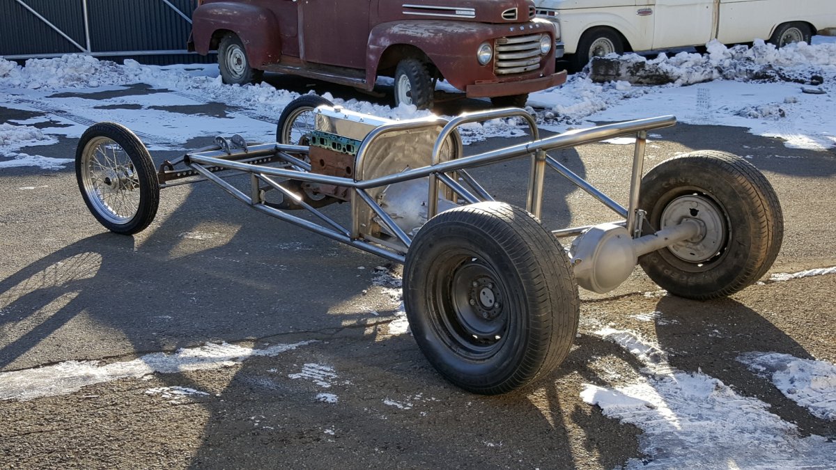

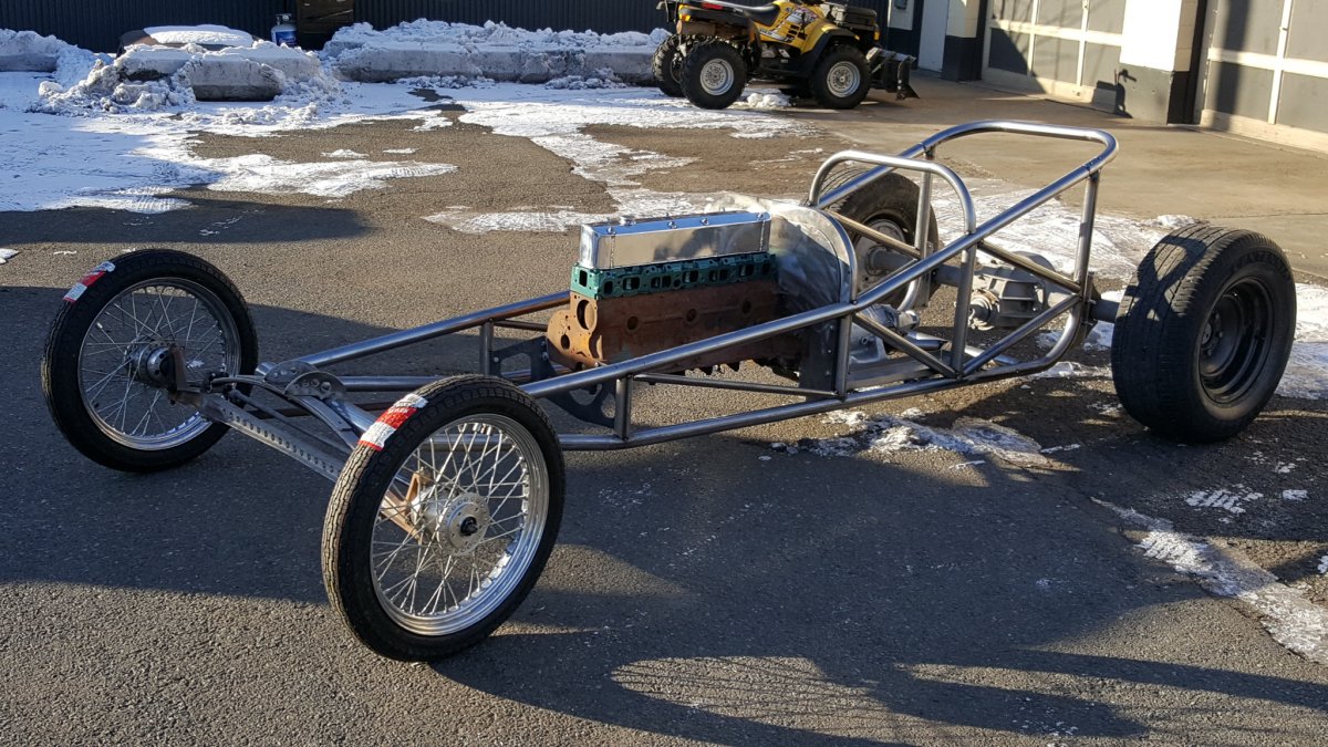

    The front tires made an appearance yesterday
