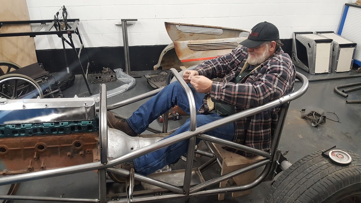

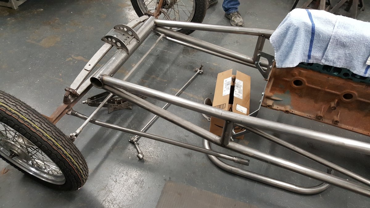

    Is there any rule as to how far the bar that holds the steering wheel needs to be over the drivers knees? The hole that we are going to need to get in and out of is looking a little tight....lol

    Woodburn in June sounds like a good goal.
    No rule to my knowledge on the steering wheel placement. I know the first year I ran my car, my steering was just a straight shaft like yours. It was too low, hit my knees and was a pain in general. My fix was to put a u-joint in the shaft, and mounted a pillow block on the knee bar to tilt the steering wheel up. Didn't take too much of a tilt to open up the drivers cockpit.

    Ok i think we will build the roll cage and then finalize the placement of that bar.

    It just needs to be over the driver's legs so you could move yours forward at least 6" and still be good.

    The knee bar definition I get at Bako is "enough to keep your legs inside when you go greasy side up". Same concept as the arm straps. In our HAMBsters most of our knees'd hit our chest before our ankles cleared the bar (even if my knees COULD make it that far up :rolleyes:), and the techs call it that way.
    I've only seen one guy called on it (and the call was technically wrong in my opinion), but the (young) tech called it as not actually covering his knees in fact, rather than whether they could escape his cage (which they couldn't) in an overturn.
    And in truth, getting in and out of mine became enough of a pita that it was one of several considerations leading me to finally remove the front hoop I'd added, and forego formal NHRA events.

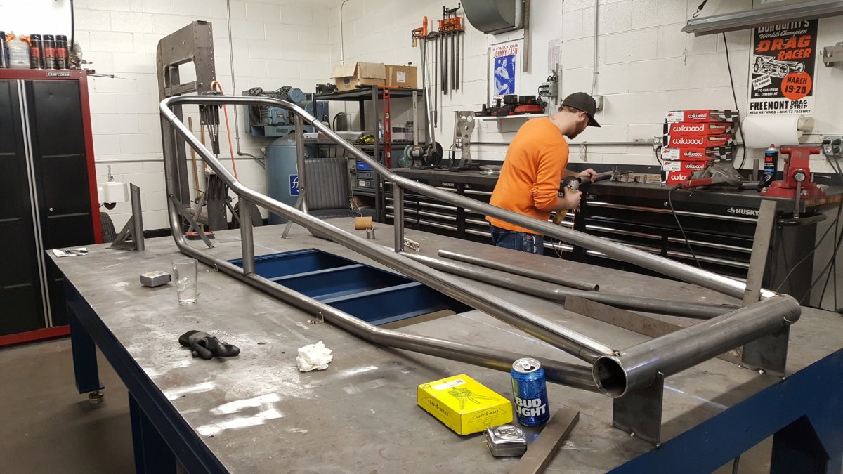

    Last night we fabbed up a hoop for the front of the seat.

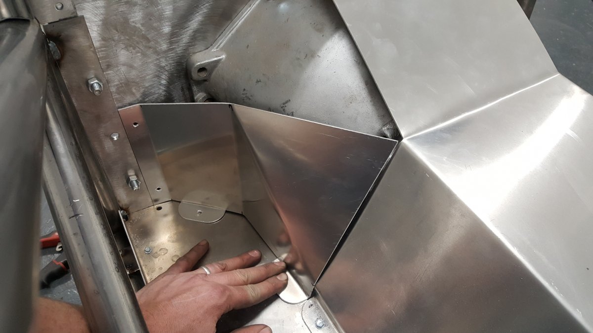

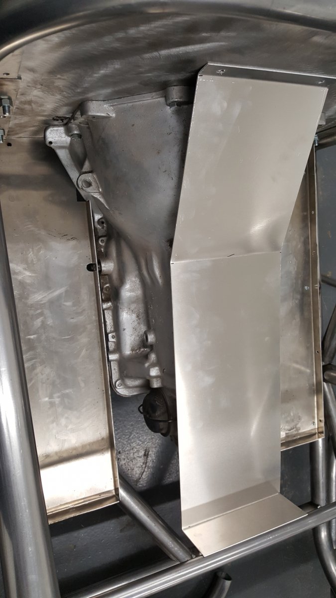

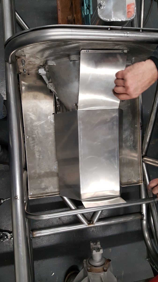

    Then started building the trans tunnel. We wanted the back if the tunnel to be flat to help with getting in and out of the thing.
    Started with this piece as a mockup to get some measurements.
    Then bent up another one with sides,
    The filler panels at the front will be challenging.
    Here is the second attempt, it is starting to show some potential. I think one more try and it will work.
    Meanwhile Randy and Wayne worked up some driveline hoops and and the verticle braces below the rear shoulder hoop.
    The rear driveline hoop will bolt onto the rear axle anti rotation bracket.

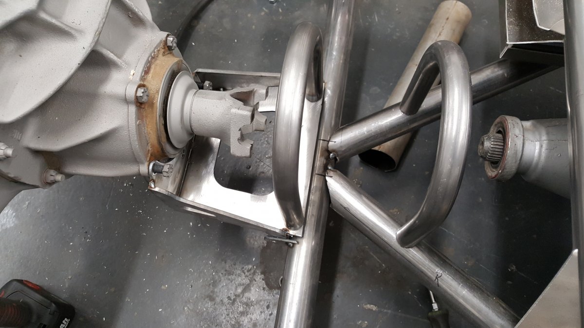

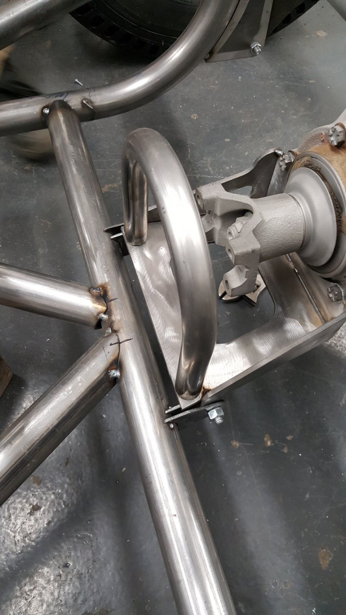

    Worked on the anti rotation braket last night, after a quick websearch i found a diagram for the 9 inch that had the X and Y coordinates listed for each bolt hole of the housing, what a time saver that was.....thanks Al Gore.
    After plotting the holes in cad i was able to knock out a bracket on the plasma cam that will allow access to the u-joint nuts.
    Then the side gussets with tabs that will mount it to the cross member were cut. The gussets were made from 3/16"
    Next up was welding in some slugs into the bottom of the rear drive line hoop.
    This was to allow mounting onto the rotation bracket, i think it will need to be removable in order to get the driveline out. Unfortunately the bolt heads are hitting on the crossmember sooo that will need a little reworking.

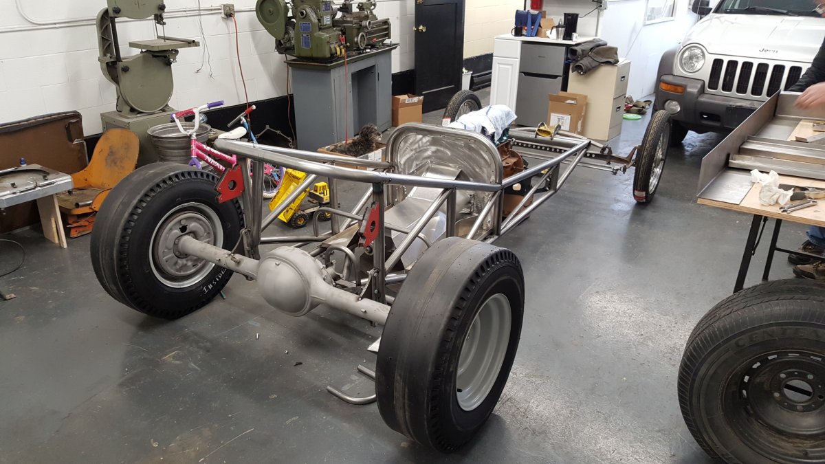

    While I was goofing with that this happened serial number #0002 now we can foul things up twice as fast![

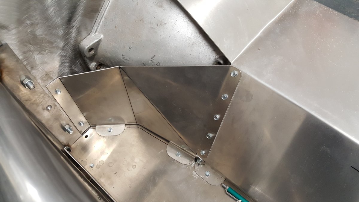

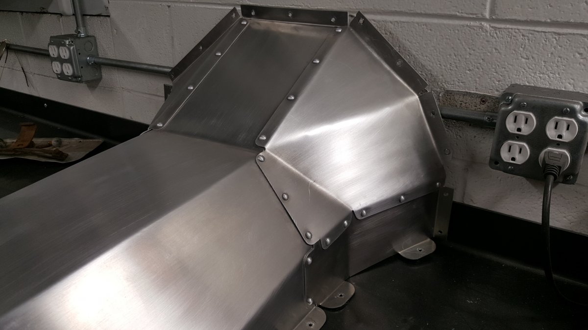

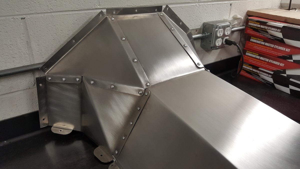

    We pushed on on the trans tunnel, this is were we left off last time
    After some adjustments and the addition of a flange.
    It's amazing how time consuming this crap is, but I'm hoping on the next car we will just be able to hit the cut button on the plasma cam, fold it and install.
    When we tear the car apart for finishing we will replace the screws with solid buck'd rivets.

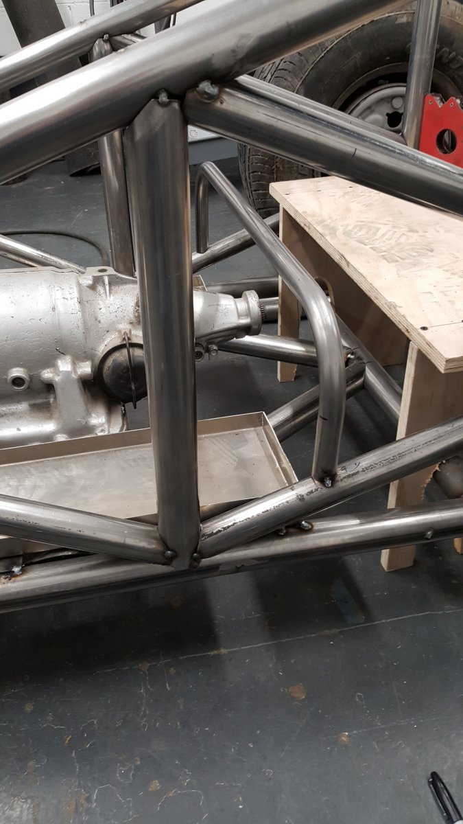

    You might think about a split tube for your driveshaft guard, and cover the u joints and all
    With this set up nothing can come out and get your stuff if you know what I mean

    I think we will monkey see monkey do like casual 6's car and have a upper cover inside of the driveline hoops.

    The first idea we had involved some 5" well casing making a clamshell full coverage thing but it looked pretty farmered up....

    4 inch emt ( electrical metallic tubing ) split. available in 10 ft. lengths at a supply house about .030 wall thickness

    I would use something a lot thicker than .030 !!!!!!!!!

    rooman
    Yep! The NHRA minimum for a car with a U jointed driveshaft is .120" steel. If you run couplers you can get away with .063" aluminum.

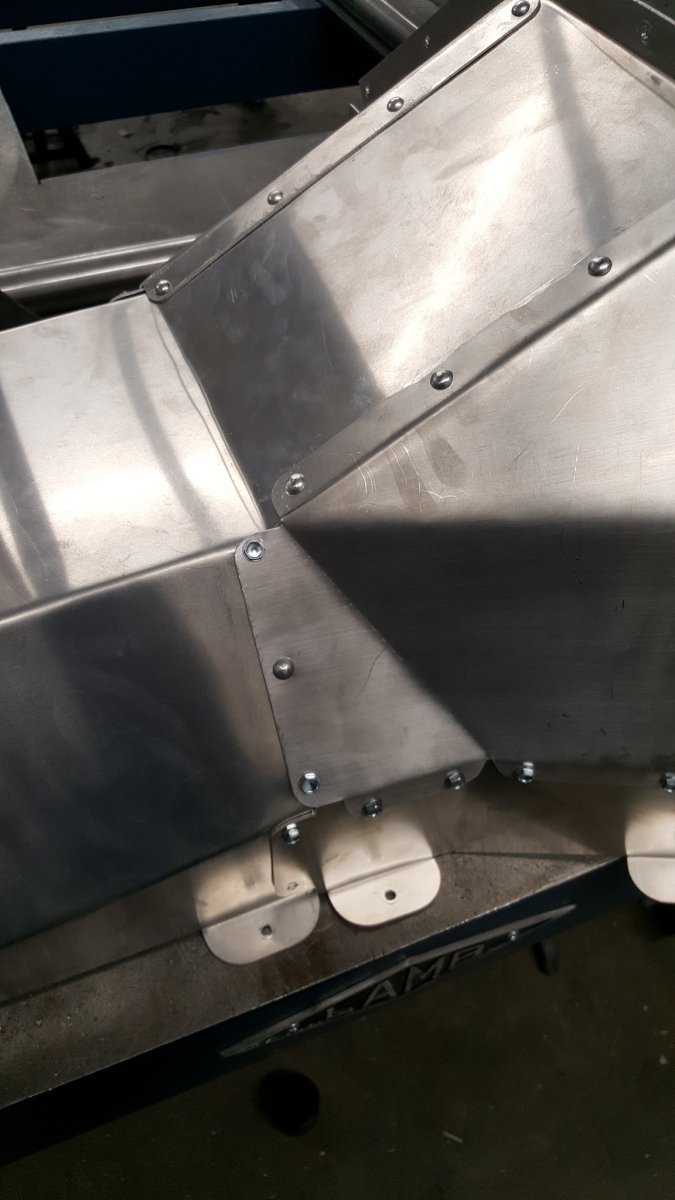

    I got the other side of the trans tunned bent up, hoping i can just hit go on the plasma cutter and make the ones for serial number 002.
    Then removed 1 screw at a time and replaces with buck rivets.
    I'm liking it
