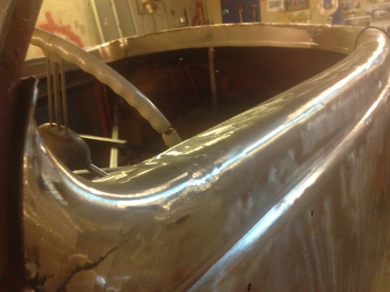

    Lately I've been doing a lot less spectacular, but still alot more time consuming stuff. I welded the window slot shut, and it made the door a lot more rigid.
    <a href="http://www.flickr.com/photos/101906403@N07/9782645486/" ***le="zeph 017 by matsheinrich, on Flickr">[​IMG]</a>
    I'm not yet quite sure what I'll do with the vent window, so I just made a smooth angle towards the windshield frame.
    <a href="http://www.flickr.com/photos/101906403@N07/9782711293/" ***le="zeph 020 by matsheinrich, on Flickr">[​IMG]</a>
