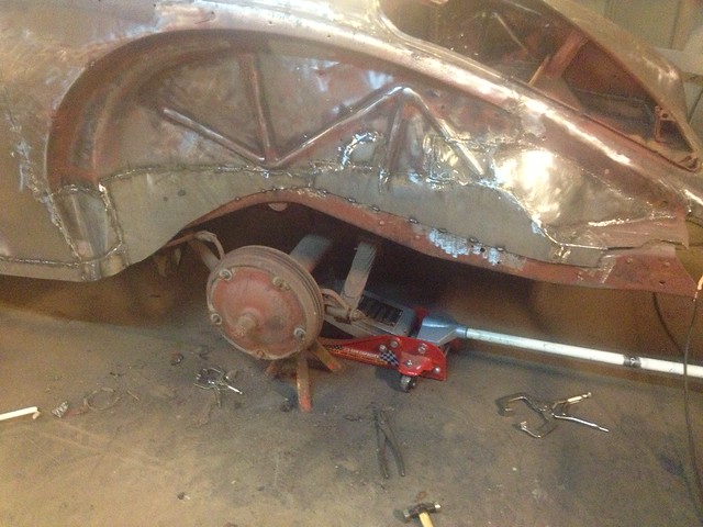

    Next up is molding the rear fenders.
    First I found a rusty spot that I forgot (that means I probably decided to do it at a later point in time, and I guess that time has come)
    <a href="http://www.flickr.com/photos/101906403@N07/9891364445/" ***le="zepher 002 by matsheinrich, on Flickr">[​IMG]</a>
    Next up was getting the fender tacked in place.
    <a href="http://www.flickr.com/photos/101906403@N07/9891360465/" ***le="zepher 004 by matsheinrich, on Flickr">[​IMG]</a>
    <a href="http://www.flickr.com/photos/101906403@N07/9911351963/" ***le="zepher 008 by matsheinrich, on Flickr">[​IMG]</a>

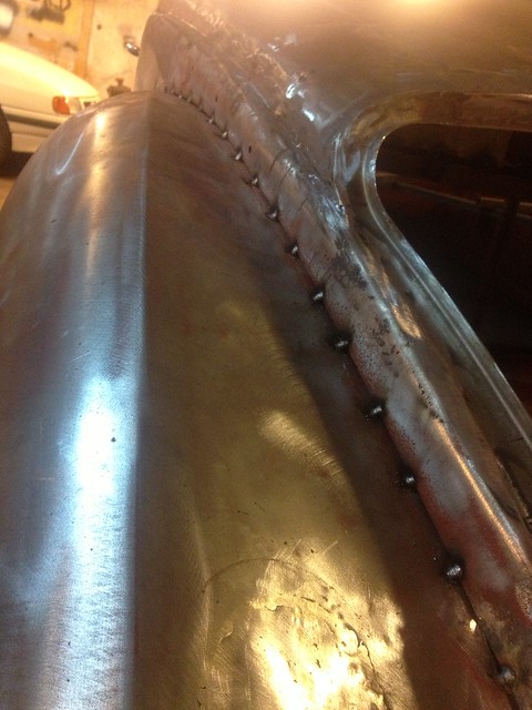

    I want to make the rear and super m***ive and heavy, so I cut out a 1 inch strip of metal and hammered, stretched and rolled it out to fit in the gap.
    <a href="http://www.flickr.com/photos/101906403@N07/9911218636/" ***le="zepher 010 by matsheinrich, on Flickr">[​IMG]</a>
    <a href="http://www.flickr.com/photos/101906403@N07/9911245454/" ***le="zepher 017 by matsheinrich, on Flickr">[​IMG]</a>
    Quite a bit of welding later:
    <a href="http://www.flickr.com/photos/101906403@N07/9911208936/" ***le="zepher 016 by matsheinrich, on Flickr">[​IMG]</a>
    <a href="http://www.flickr.com/photos/101906403@N07/9911212316/" ***le="zepher 014 by matsheinrich, on Flickr">[​IMG]</a>

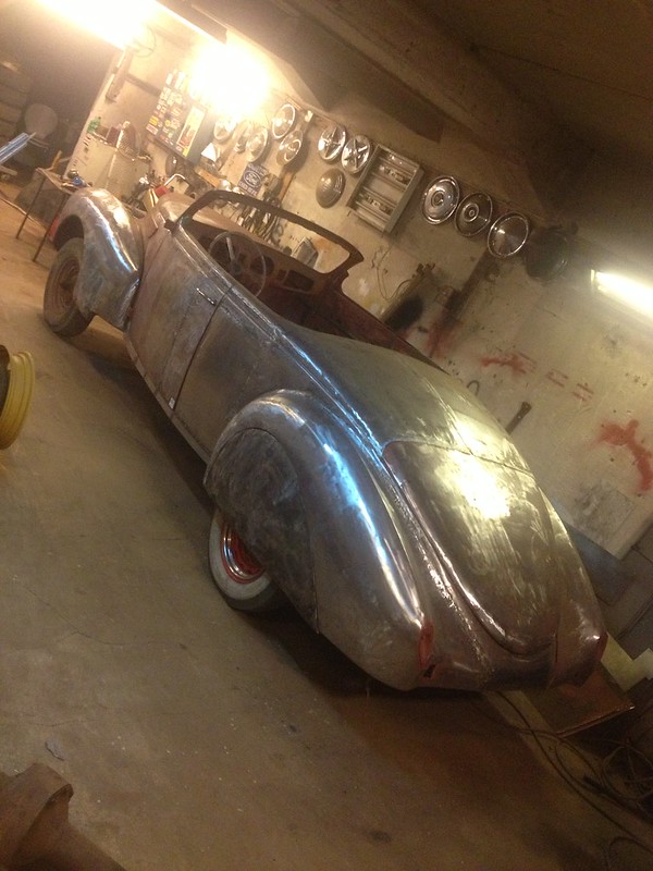

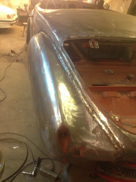

    After I fitted the fender skirts and burnt a grinder m***aging down the welds, I think its getting there:
    <a href="http://www.flickr.com/photos/101906403@N07/9928843585/" ***le="zepher 025 by matsheinrich, on Flickr">[​IMG]</a>
    <a href="http://www.flickr.com/photos/101906403@N07/9928849835/" ***le="zepher 021 by matsheinrich, on Flickr">[​IMG]</a>
    BIG ups to hamb member nickthebandit for donating a 112 housing and some parts! Cant thank you enough.
