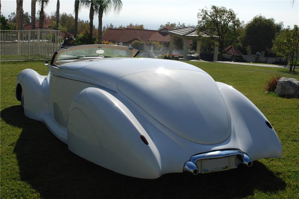

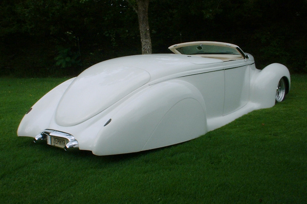

  15. J.B.
    Joined: Jan 7, 2005
    Posts: 1,246
    J.B.
    from Sweden

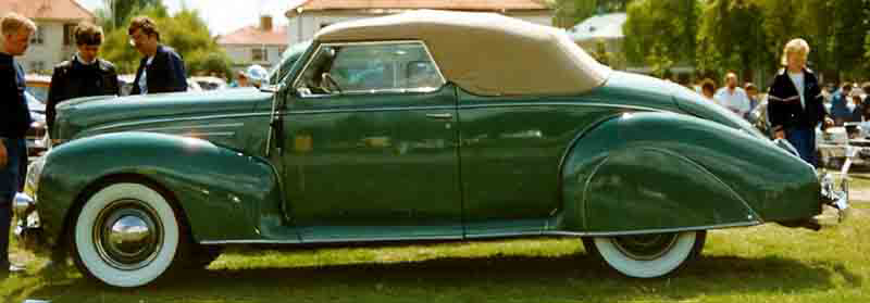

    I don't want to put in cars in the wrong style in this thread, but this is a roadster styled Zephyr with the the same kind of size of the trunk lid. Just to show. I think it looks nice. :)

    And, if you look at an original, their trunk also starts down around about the same area that Mats-Henrick is building his. So it seems completely appropriate to me.

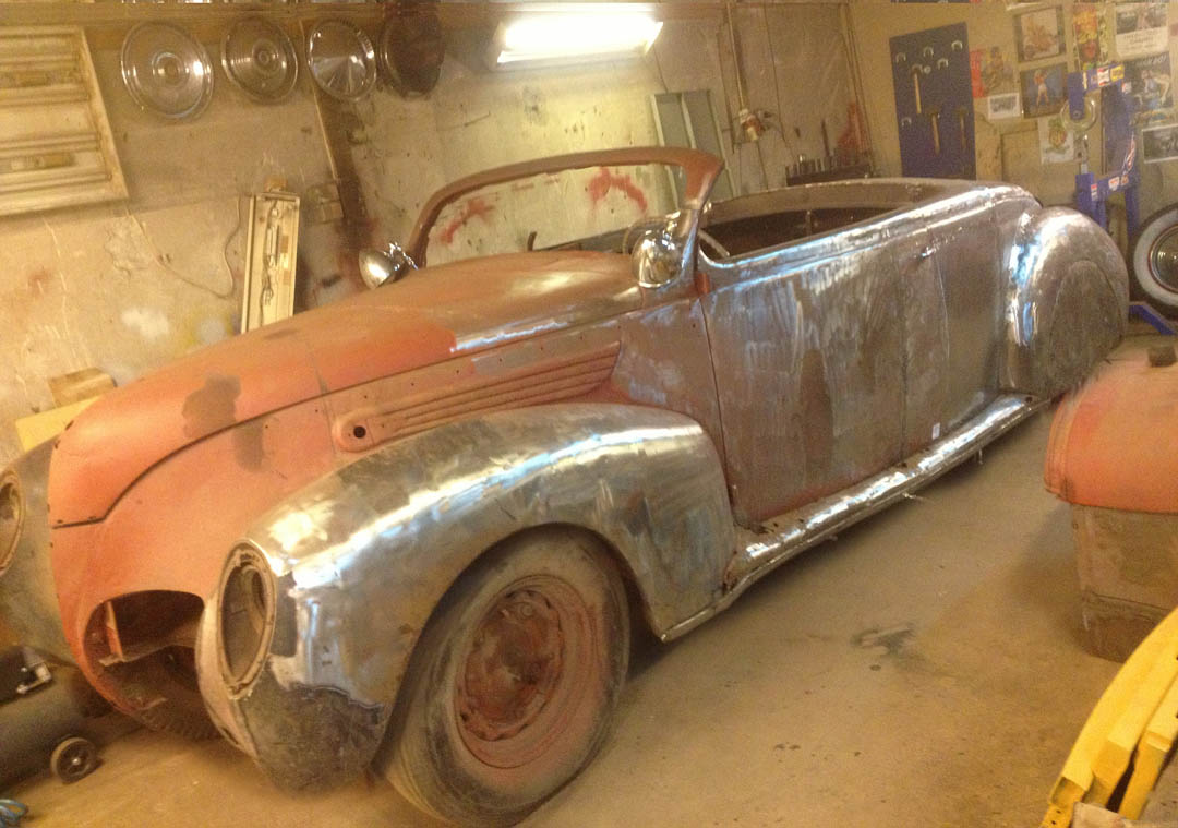

  20. Mats-Henrik
    Joined: Nov 7, 2009
    Posts: 94
    Mats-Henrik
    from Norway

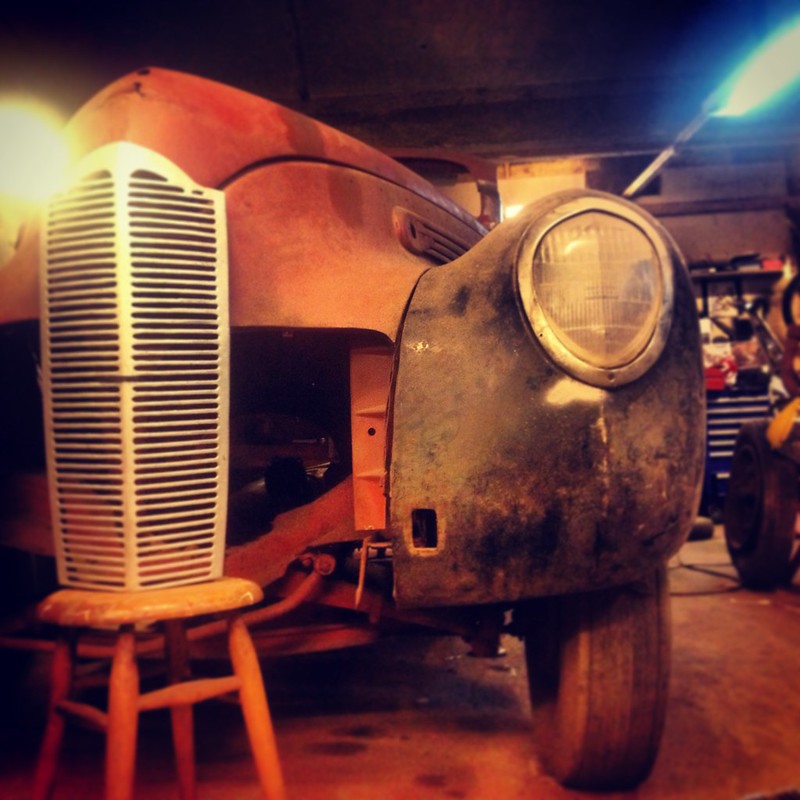

    I finally got around to clean up the front end a bit.
    <a href="http://www.flickr.com/photos/101906403@N07/10015288453/" ***le="zepher 235 by matsheinrich, on Flickr">[​IMG]</a>
    <a href="http://www.flickr.com/photos/101906403@N07/10034861093/" ***le="zepher 236 by matsheinrich, on Flickr">[​IMG]</a>
    <a href="http://www.flickr.com/photos/101906403@N07/10034773335/" ***le="zepher 237 by matsheinrich, on Flickr">[​IMG]</a>
    <a href="http://www.flickr.com/photos/101906403@N07/10049880164/" ***le="zepher 242 by matsheinrich, on Flickr">[​IMG]</a>
    <a href="http://www.flickr.com/photos/101906403@N07/10050025783/" ***le="zepher 243 by matsheinrich, on Flickr">[​IMG]</a>
    <a href="http://www.flickr.com/photos/101906403@N07/10049908555/" ***le="zepher 244 by matsheinrich, on Flickr">[​IMG]</a>
    Next up is molding the front fenders. I'm also considering to take another inch out of the front windshield frame.

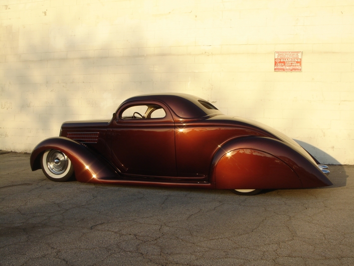

    just a couple of quick photoshops for you with a little drop on the windshield and the whole beast closer to the ground

  27. Mats-Henrik
    Joined: Nov 7, 2009
    Posts: 94
    Mats-Henrik
    from Norway
    Wow, thats more like it! Thanks, that definately convinced me to chop another inch.
  28. Mats-Henrik
    Joined: Nov 7, 2009
    Posts: 94
    Mats-Henrik
    from Norway

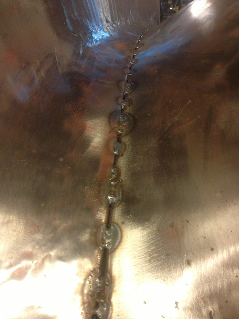

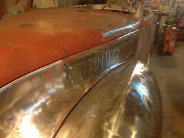

    I just finished molding the left fender. It took quite a bit of adjusting and persuasion to get the fender to fit as good as possible before welding it in place.
