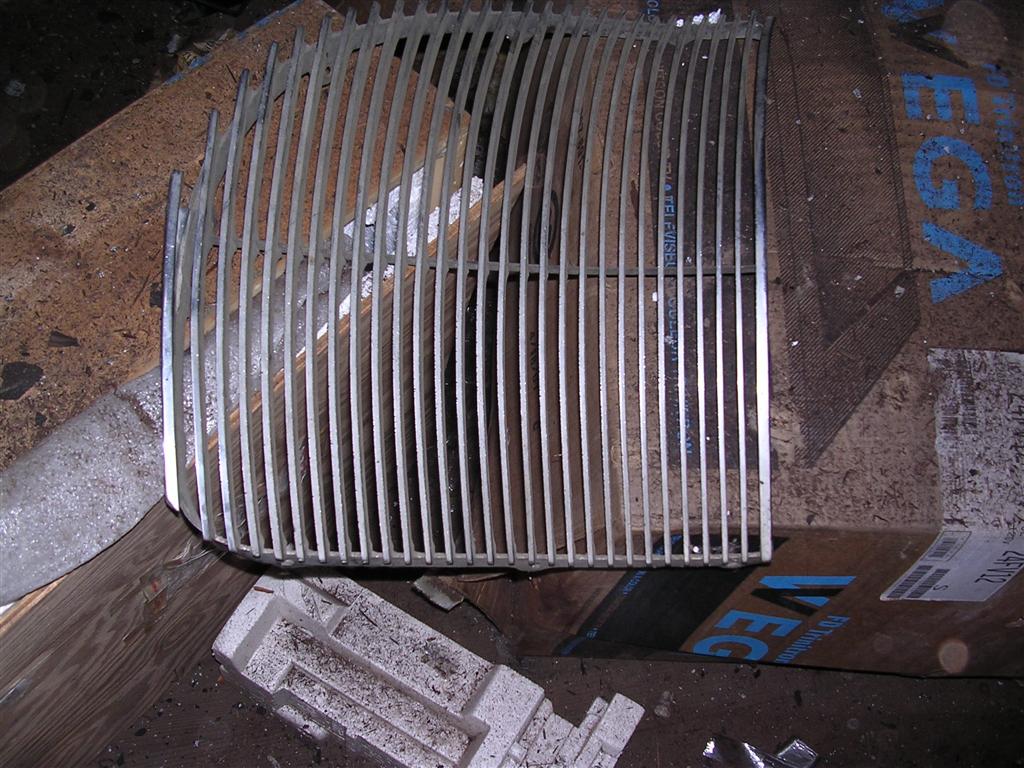

    That brought me to the grille again. I've got three different grille sets for it, but all of them are in pretty poor condition. The top one looks to be original, the one in the middle appears to be home made, and the one in the bottom looks like an old aftermarked unit.
    <a href="http://www.flickr.com/photos/101906403@N07/10341398325/" ***le="zepher 262 by matsheinrich, on Flickr">[​IMG]</a>
    <a href="http://www.flickr.com/photos/101906403@N07/10341587453/" ***le="zepher 263 by matsheinrich, on Flickr">[​IMG]</a>
    I do like some patina on old parts, but these are all in too bad condition to use I'm afraid. Let me know if anyone has one in better condition laying aroung!

    The middle one looks like it was an oven grill? Great work Mats!

    Those grills are very fragile. On my zephyr I drilled small holes and used pop rivets and small sheets of metal to hold the broken pieces together. Also I rechromed them which I later regretted because they lost that cool patina you mentioned.

    Mats, Do you know if other years will be the same? I have a lead for a pair, in real nice condition. I will measure and take some pics.

    I havent thought of that, I thought the material was to fragile to repair. Did you take any pictures of the prosess?
    Yeah, they´re one year only. Let me know what the seller says!

    I love the 38 grilles. The only Zephyr with horizontal grille bars. The grilles are quite fragile, and I've never come across a set without a few broken bars.
    The 38 Zephyr I just sold had its original grilles, but bad broken bars on each side.

    Here is my "repaired grill" I did around 4 of these and some are less noticeable than others. The break that looks huge in this picture is really not that noticeable when viewing the car under normal cir***stances.

    Look into wether there is an artist's foundery somewhere near you.
    If so, you can epoxy the grill pieces together as best as you can, and then use that as the master to have them create a plaster mold from it and re-cast it for you.

    Wouldn't the new be smaller than the original dew to shrinkage.

    That looks like a 39 grille. I may be interested if its for sale...

    Yup, that looks like a 39. Thanks anyway!

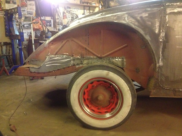

    The car is now ridiculously high up in the air, but I guess wheel well clearance won't be an issue when I finally get to lower it. I can't wait to get it closer to the ground, but I keep telling myself to have all the welding and leading done before I lower it.
    <a href="http://www.flickr.com/photos/101906403@N07/10531869905/" ***le="zepher 265 by matsheinrich, on Flickr">[​IMG]</a>
    I'm working on the p***enger side these days, I had to redo the rear upper part of the door to get everything lined up correctly. I hate to cut up my own work to do it over again, but sometimes you just have to.
    <a href="http://www.flickr.com/photos/101906403@N07/10531950825/" ***le="zepher 276 by matsheinrich, on Flickr">[​IMG]</a>

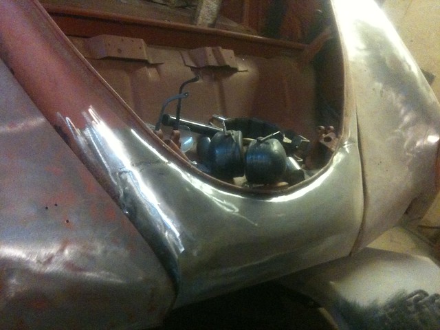

    Next up was molding the rear p***enger fender. I always get to carried away working to take pictures during the prossess, but its pretty straight forward, using as many as possible of the old mounting holes to get the fender in right place before welding it. I also used some extra self tapping screws to get the gap between the body and fender as small as possible.
    To get the rear lamps lined up correctly I used a pretty crued method, but it worked. After alot of adjusting and measuring it was time to weld.
    <a href="http://www.flickr.com/photos/101906403@N07/10531803805/" ***le="zepher 266 by matsheinrich, on Flickr">[​IMG]</a>

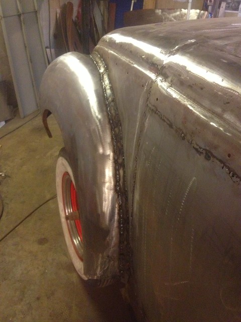

    To get a nice flow between the fender and body I used a 1" metal strip. I considered making it 2", but I think its nice to have a litte "contour" left.
    <a href="http://www.flickr.com/photos/101906403@N07/10532043293/" ***le="zepher 267 by matsheinrich, on Flickr">[​IMG]</a>
    <a href="http://www.flickr.com/photos/101906403@N07/10532041483/" ***le="zepher 268 by matsheinrich, on Flickr">[​IMG]</a>
    <a href="http://www.flickr.com/photos/101906403@N07/10531815286/" ***le="zepher 269 by matsheinrich, on Flickr">[​IMG]</a>
    <a href="http://www.flickr.com/photos/101906403@N07/10532035923/" ***le="zepher 271 by matsheinrich, on Flickr">[​IMG]</a>
    It was nice to see that the fenderskirt lined up pretty good with the fender without any work.

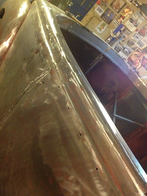

    I also got started on leading up the front fender. Cant wait to get all the leading done!
    <a href="http://www.flickr.com/photos/101906403@N07/10532194163/" ***le="zepher 274 by matsheinrich, on Flickr">[​IMG]</a>

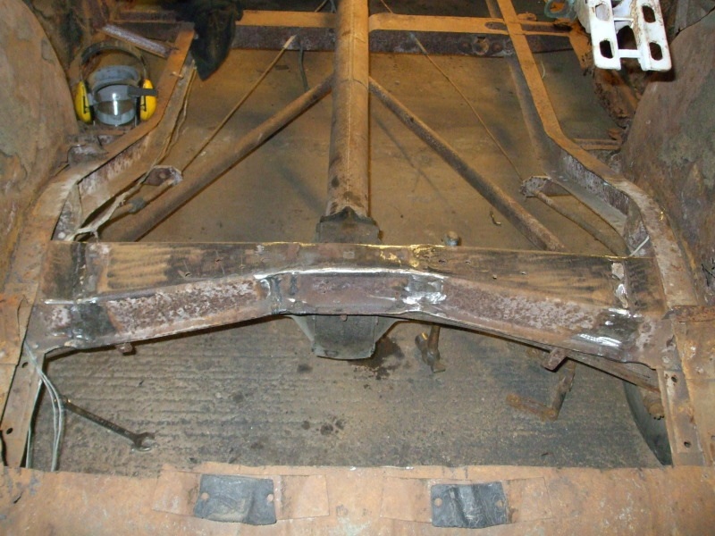

    Looking good Mats, how low are you lookjing to go with the rear end ? I straightened the rear crossmember on mine and got it down to a lovely ride height , trouble is the ch***is hit the top of the axle tubes when it was loaded with gas and driven. I am now about to start a small c notch of the ch***is to overcome the problem.
    Great to see that you are starting to lead it up, make sure you clean that tinning flux of really good with hot soapy water and lots of baking soda.It corrodes (flash rusts) like crazy if not and is a ***** to get back under control (ask me how I know).

    To get it as low as I want, I'll have to get it down 8 inches in the rear. That is quite a lot, and the norwegian equivalent to the DMV dont allow the frame to be altered, so first I'll get it as low as I can with de-arching, removing a some leafes and reversing the eyes, as well as longer shackles. What you say about the axle hitting the frame is bad news for me, but I'll have to figure something out.

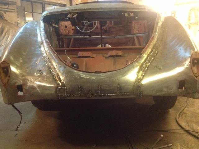

    I cleaned up the rear end last night. One thing I really envy you guys in the US (at least a major part of the US) is the lack of rust on projects. As I mentioned early in this thread, I started out doing alot of rust repair. There is a lot of details that are hard to predict, and you just have to repair most places back to original, wich would be fine if you are restoring an old car, but I'm making a kustom. So then you have to go back, and cut open parts you've put hours and hours in making, to get the car the way you want. But look at the bright side, I could be wasting my time in front of the TV or at a sporting event..
    So, here is the story of the rear end in pictures:
    <a href="http://www.flickr.com/photos/101906403@N07/10553597166/" ***le="zepher 284 by matsheinrich, on Flickr">[​IMG]</a>
    <a href="http://www.flickr.com/photos/101906403@N07/10553596406/" ***le="zepher 285 by matsheinrich, on Flickr">[​IMG]</a>
    <a href="http://www.flickr.com/photos/101906403@N07/10553595426/" ***le="zepher 286 by matsheinrich, on Flickr">[​IMG]</a>
    <a href="http://www.flickr.com/photos/101906403@N07/10553594806/" ***le="zepher 287 by matsheinrich, on Flickr">[​IMG]</a>
    <a href="http://www.flickr.com/photos/101906403@N07/10552634364/" ***le="zepher 278 by matsheinrich, on Flickr">[​IMG]</a>
    <a href="http://www.flickr.com/photos/101906403@N07/10552590406/" ***le="zepher 280 by matsheinrich, on Flickr">[​IMG]</a>
    <a href="http://www.flickr.com/photos/101906403@N07/10552628824/" ***le="zepher 281 by matsheinrich, on Flickr">[​IMG]</a>
    <a href="http://www.flickr.com/photos/101906403@N07/10552824883/" ***le="zepher 282 by matsheinrich, on Flickr">[​IMG]</a>
    Finally its done.. I hope.

    Do you think they would notice if you flattened the rear crossmember in a factory looking way? Pic stolen from Wensum Valley Rods build.
  30. J.B.
    Joined: Jan 7, 2005
    Posts: 1,250
    J.B.
    from Sweden
    I'm afraid there must be a kickup to allow the axle to move without hitting the frame. Any chance on doing that factory looking? I must do that damn kickup on my LaSalle as well, but I don't have a tranverse leaf spring.
