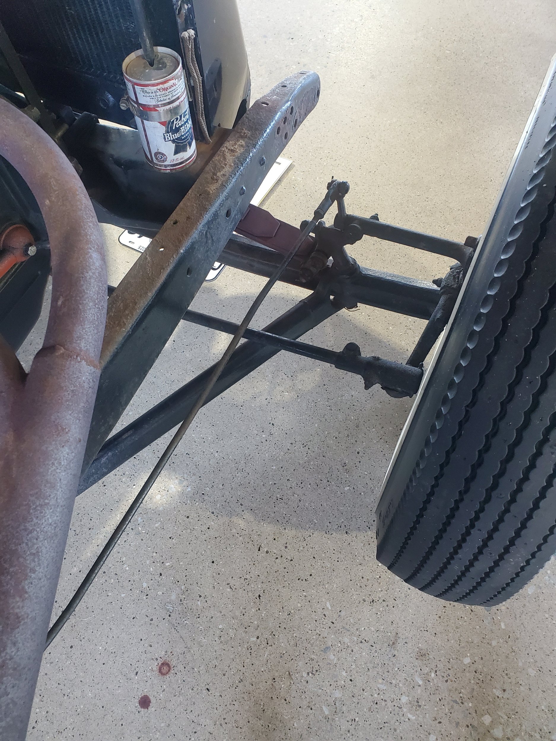

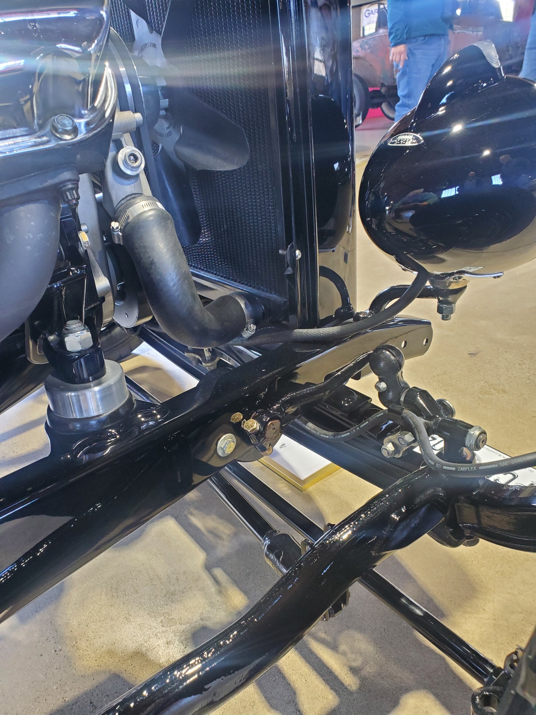

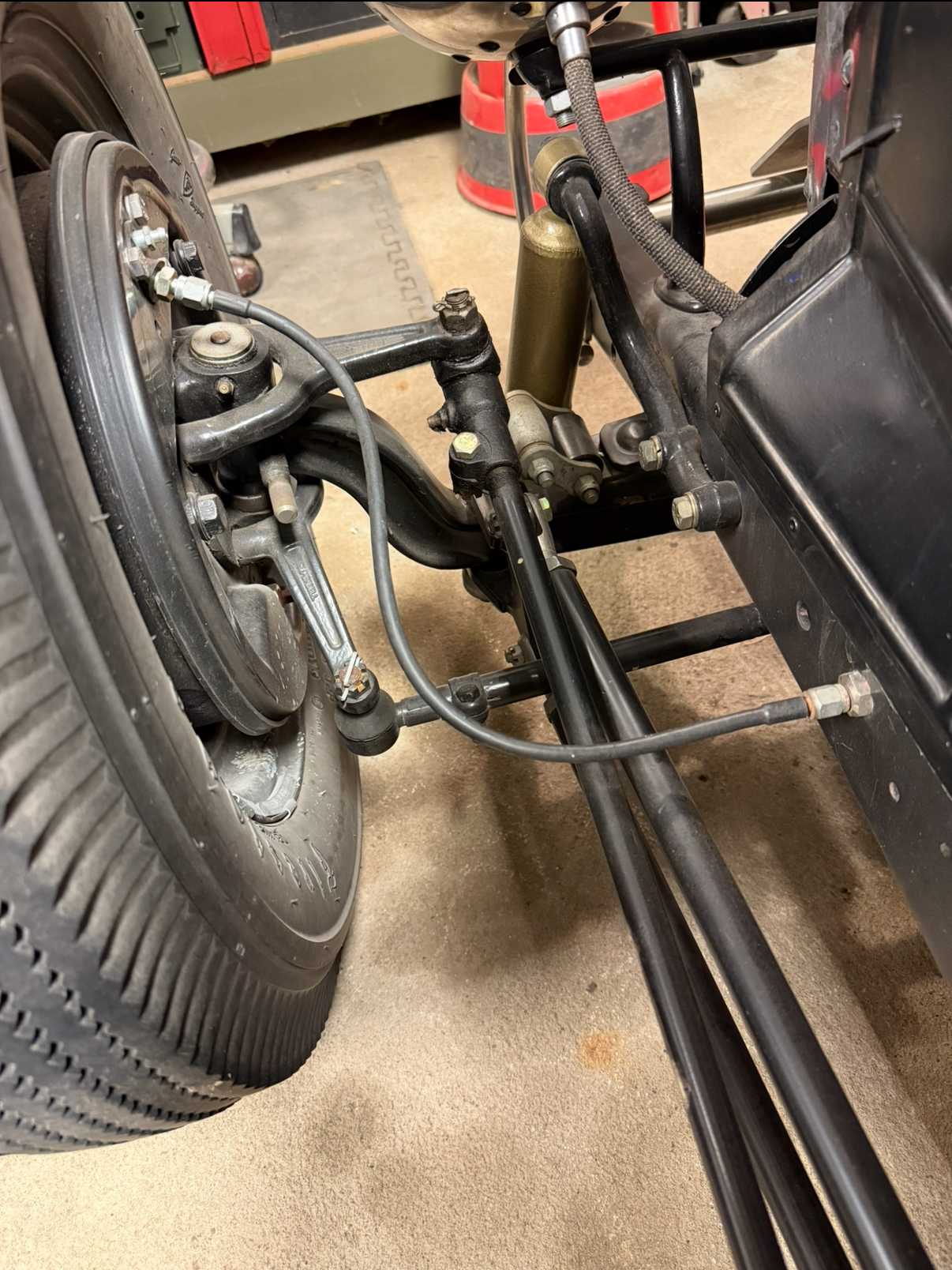

    pics of brake lines and shocks on both boxed and unboxed frames
    tab on top
    tab on bottom
    Un boxed, through the frame
    boxed again, tab on top
    **** it, go back to mechanical
