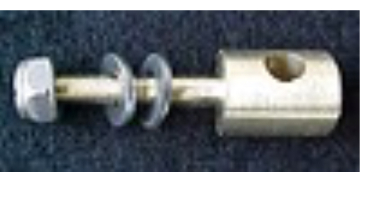

  10. Looks like something like this would help plus a couple collars.

  16. That’s the plan.
    I’ll preserve the box and paperwork.
    Shorten the shaft between the main carbs about 3/8.
    Drill out the main carb lever
    Add this
    should hook it up.

  22. Those new end bases have some strong springs
    We’ll see how they work out when completed.
    vintage speed provided the necessary pieces to complete. Less than $20 shipped.
