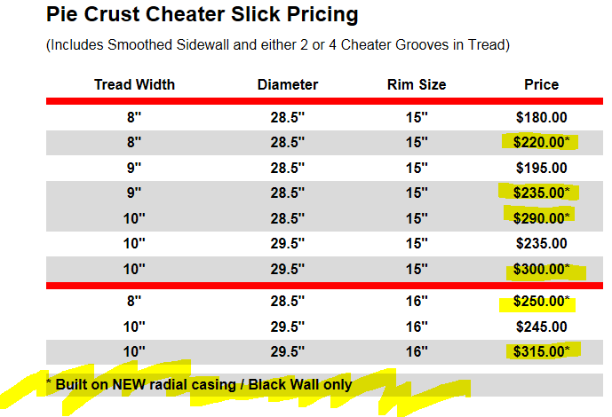

    FYI, the Towel City slicks are built on radial carc***. If running bias front tires that might be a concern?

    For a nominal fee they will use brand new tires not used carc***es. That is what I did on my pie crust slicks on my 34.

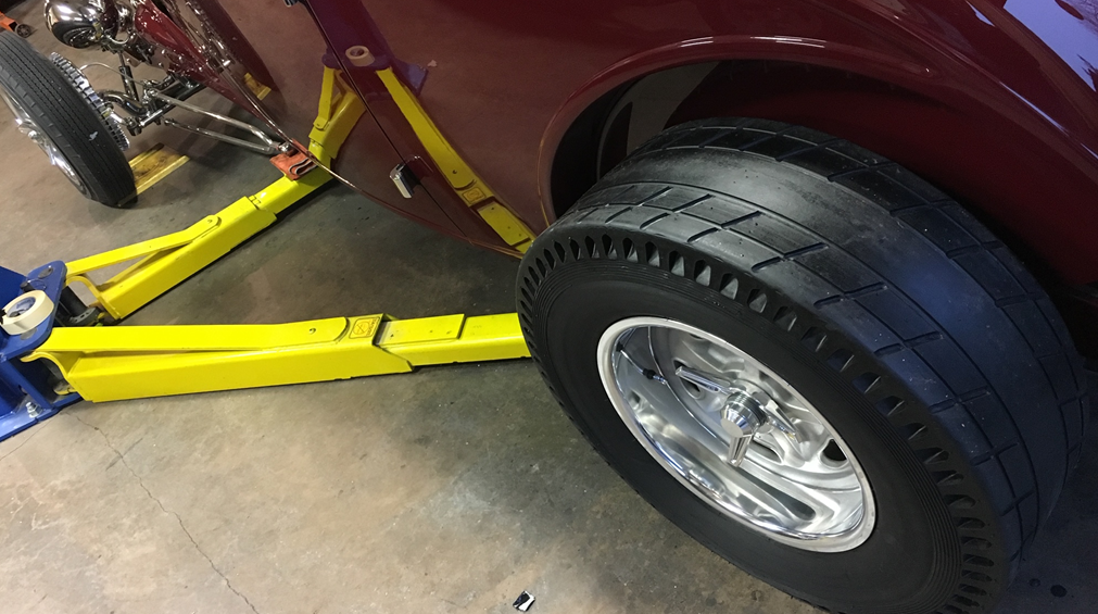

  21. 20130717_102449.jpg for the serious racer get a durometer. that way you can tell how hard or soft the tire is. I treat the tires to achieve a reading under 38. a brand new mh slick is 35-37. a new radir untreated is 45. wrapping the tires post treatment over night in plastic is a more aggressive way of dropping the reading. the tires will return to the as delivered hardness after a few p***es. Your results may vary.
