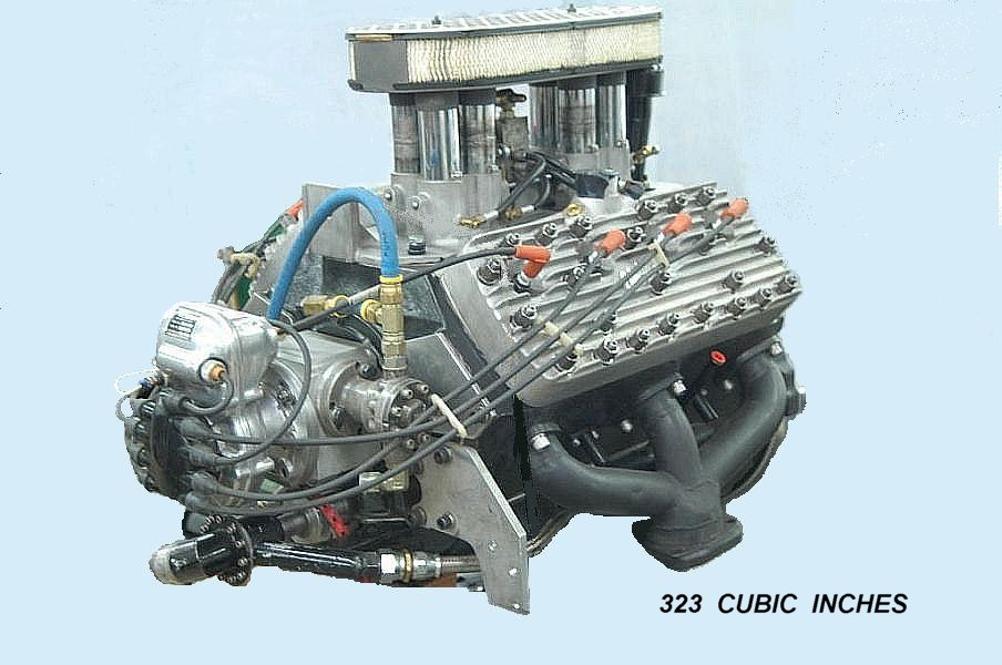

    Back to the engine question. I just talked to nhra tech guy and it sounds like a supercharger would fit in my plans just fine. N/A stroker or supercharged? I'm leaning toward supercharged as, to me, it just looks more "right". What combos do you recommend? Bore, stroke, compression, cam, heads, valve size, blower size, drive ratio, etc...
    I love the pic Petel, looks nice.

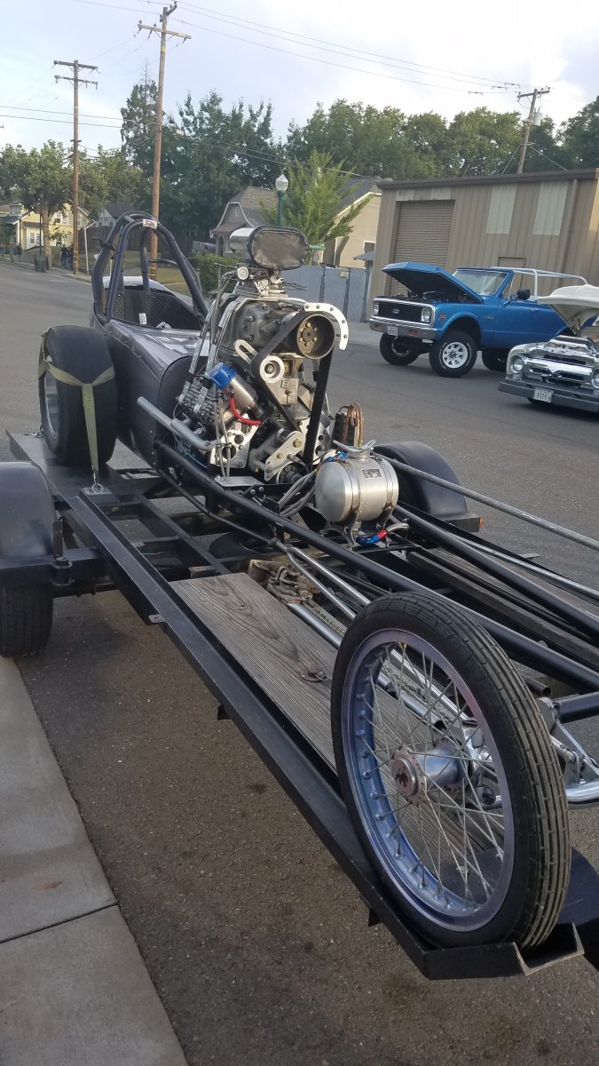

  7. Jalopy Joker
    Joined: Sep 3, 2006
    Posts: 35,416
    Jalopy Joker
    20190702_191447.jpg 20190702_191501.jpg 20190702_191510.jpg 20190702_191426.jpg

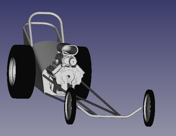

  9. Speedbug78
    Joined: Sep 25, 2019
    Posts: 55
    Speedbug78
    Playing with this model some. I like the look of the low profile setup. I need to model the rest of the car.

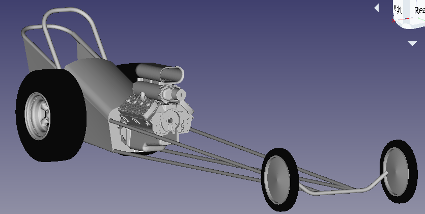

  17. Speedbug78
    Posts: 55
    Speedbug78
    Progress has been slow as I hurt my back, but its getting better and I got out and took more measurements to model the scale of the main parts. I only drew a few of the tubes. It is rough, wheels are ugly-ish and the back of the body is tough to model.
