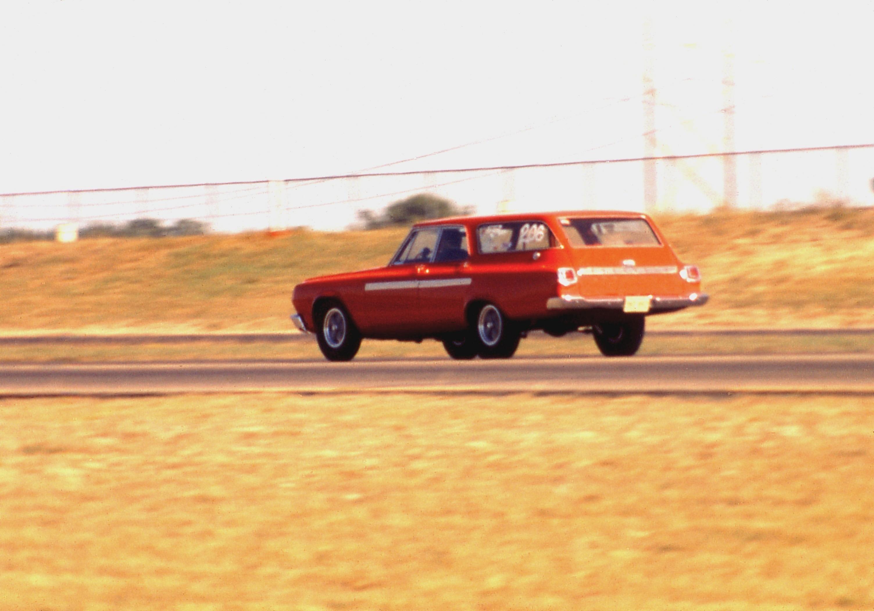

  19. woodienut
    Joined: Feb 17, 2009
    Posts: 349
    woodienut
    from So.Cal.
    This pretty much nails it!
    All good stuff here.
    I run a '64 Plymouth Fury WAGON, 426 back in '70/'71 with all the Mopar stuff, springs, w/aluminum bushings, 3500 stall (it was '70 Stall, so who knows? it flashed at about 3500??) and 4:88 gears. It ran 13 flat at 100 MPH, I always wanted to try 4:30/4:56 gears to see if it would MPH better.
    This was E/SA, 3800 LBS., so I was handcuffed with stock carb and Hyd. cam, & 7" tires. Having said all that, my point is you've got lots of room to improve. Just keep chipping away one change at a time. That was always the most fun part for me.
    GOOD LUCK AND SAFE RACING.
    Sorry these are old pic's takin' with a cheap 1970 camera. LOL

    Very cool wagon! Thanks for the input. We will keep on chippin"!
