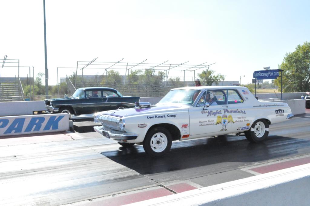

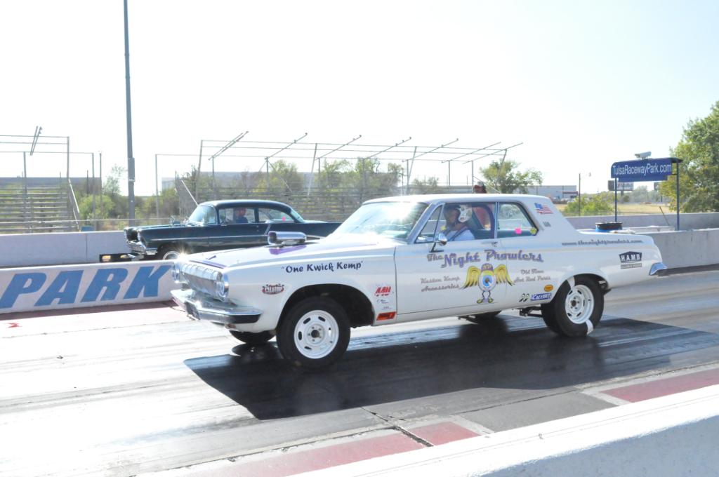

    Thanks to everyone...didn't make all the changes yet, but here is where we stand.
    1. HP is definitely an issue...nowhere near 650...more like 400 if that.
    2. Got the car to hook at Tulsa much better, but still not launching hard.
    3. Changed from the Holly to a Carter and got insane throttle response now. Also 2 inch spacer.
    4. Added MSD and Champion J63Y Race Plugs Gapped at 46 , spiral wires. Had Mopar Elec. Ign. before. Kept same dist. Mech. Adv. and recurved for narrower range.
    5. Unbanded rear half of leaf springs...made a difference, but not good with the Caltracs...now car lifts at launch. (see pics)
    6. Experimented with preloads and shock settings...best was with 1/2 turn on the Caltracs preload and rear shocks at 4.
    7. Timing advance was from 28 to 35 total and best was 35.
    8. 104 Octane fuel
    9. Air temp was 72
    10 Got the SureGrip working right...launched straight. Tried launching from idle, at 1500 and at 3000. 1500 seemed to work best.
    Best 60 ft. - 1.881
    Best 1/8 ml. - 8.177
    Best 1/8 ml. speed - 94.14
    Best 1/4 ml. time - 12.902
    Best 1/4 ml. speed - 103.18
    Next planned is the SS Springs and check of Torque Convt. and 6cyl torsion bars...Where to find TB anyone?
    Also wondering about gearing...maybe we need to go deeper?
    Going to experiment with tires...the Hurst hooked when really heated.
    We may mount a pair of M/H just as a test 26/10.5X15 is all that will fit. They won't work with the vintage thing, but they might give us a better idea of potential...we're not far from MOKAN and they still have a couple of TT events we could try before snow.
    Then gradually go after the finer points mentioned previously until we find a combination that works. Right now we are going after the MPH and getting it to launch hard.
    I was fairly proud of my rookie reaction times....314, .430, .090, .278, .339
    Best,
    HG
