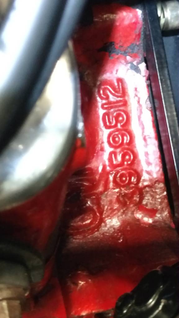

    Probably not, no Corvette covers. Nothing stamped on the pad....

    I believe the 512 block were later replacement blocks. Small journal with a breather hole but extra meat like a 350. I don’t think they came in any particular car.

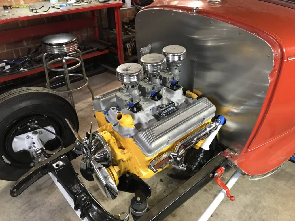

    I had a dead on Early Olds "Eric Rickman"drag motor copy a few years back and after sitting on the road with rare broken magnesium parts I decided to make more practical decisions that fit my driving style for my '39 re-build. This SBC is what I did... I spent a few years searching magazines and gathering a mix of what I felt was right era look but updated where I needed. A first year 327, destroked to a 311. Early double hump heads, Comp version of a Dontov 30/30, Creitz intake (while I have some early hi-top AFBs I decided to take my 90's Webber/Edelbrock versions install a ring style restrictor kit and paint them to look old keeping electric choke - more of a driving tuning decision over perfect period correctness). Generator - you'll have to make your own mounts with headers. A lot of other details and keeping more black than chrome, avoiding hardware store bolts here and there, using cloth early wire harness or vinyl with soldered ends help make up the details. I tossed the P&J mounts for an Ansen mount. Working on a Spaulding Flamethrower with basic black wires. Biggest kicker Is I'm running a Hydro-Motive modified Hydromatic 4-speed, thats been the hard part... reason for the excessive linkage.

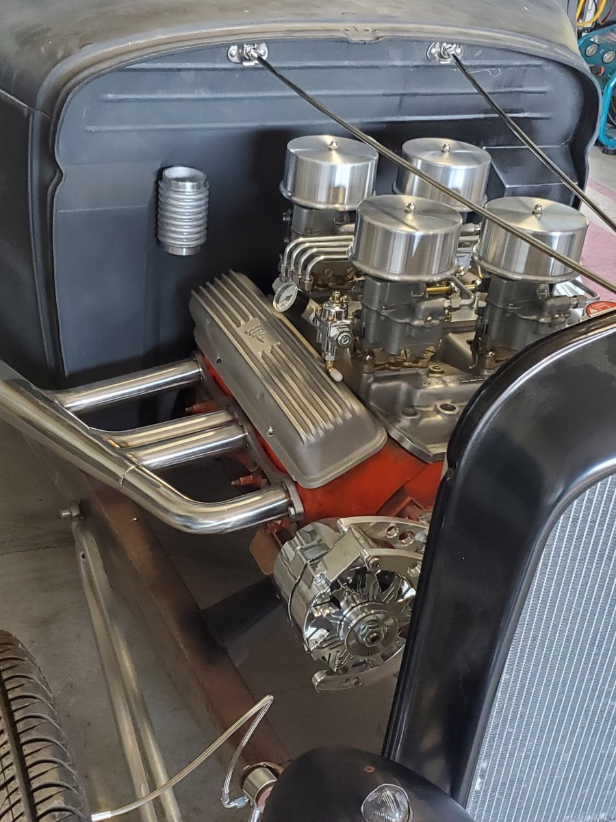

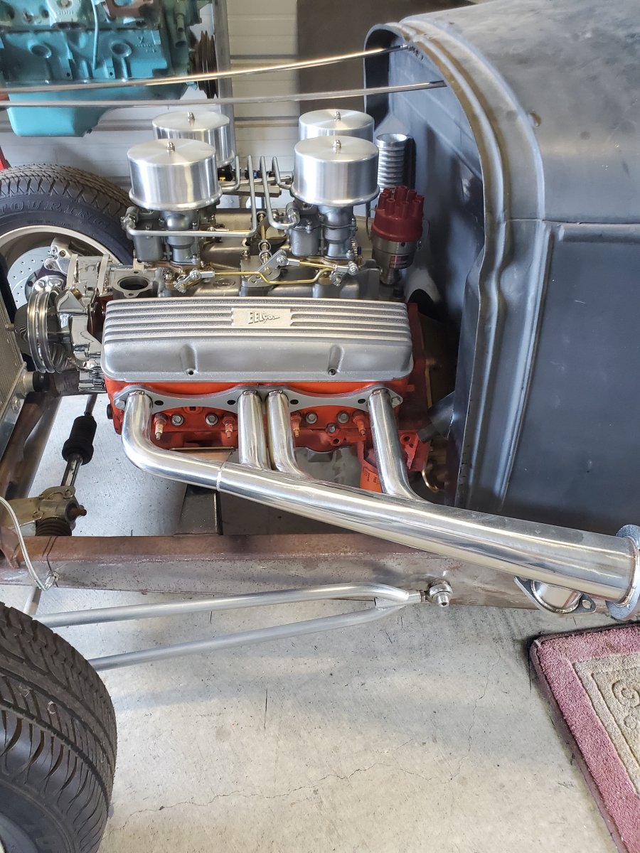

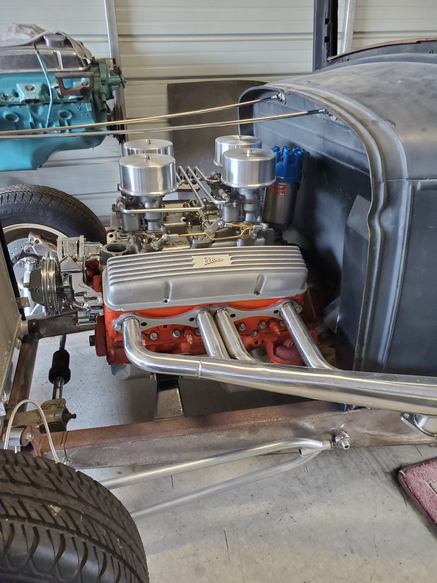

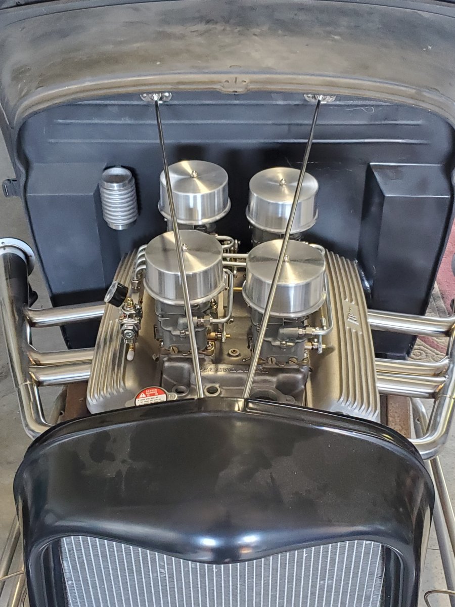

    So here is what I put together so far ... the front accessories are mostly for clearances mock up ect.. I like the style of headers , but its not right , ill have to revisit that ....
    Getting close , 20200421_170049.jpg 20200421_170539.jpg 20200421_170056.jpg 20200421_170438.jpg 20200421_153727.jpg

    A lot of stuff has gotta go if you’re gonna pretend any of that is 50s or 60s. That firewall screams 90s, the unisteer, even the Chinese grill shell. Sorry. [​IMG]

    No its fine ... I get it , I can pick it apart too . But at the same time , this is what I got . ... firewall is gonna stay tho.. ( I would've just flipped the orig one) , but its done ... i only wanted to get close ... guess I'm just stuck with a black street rod ...
    I have my eye on a nice little ( orig) grill set up ...

    And yeah , that fire wall is ugly as ****
  17. I know it is very difficult to try to achieve your goal. I've tried that myself. Sometimes the HAMB isn't so kind to us that never lived during the period we would like to pay homage.
    I would try to focus on key items that put you in that time period. Don't sweat the small stuff. Your car will forever be viewed as a "copy" of a period car by some. Just like my car will always be a plastic Milner clone.
    I would:
    Change air cleaners to a more aggressive style
    Add a firewall insert?
    Use a old school alternator mount.
    Paint the aluminum radiator black.
    Add a fill color to the valve covers
    Have fun! It's a great car. Don't worry. Find vintage pictures and try to make something those hotrodders would have liked.

    I've learned on past projects where I had new-style stuff that it's much harder to make it all jibe. It might be worth it to go all-out on the next project. To get authentic, there's a lot of big stuff to change, not just the powerplant.

    Thats real nice of you ! Thats the bit of advice and outline I was looking for ... thanks ..
    The firewall insert is a idea I've considered, still kicking that around .. I'll see what I can do with the rest....
    Cuase gosh knows I have time to do it , with all this going on around us

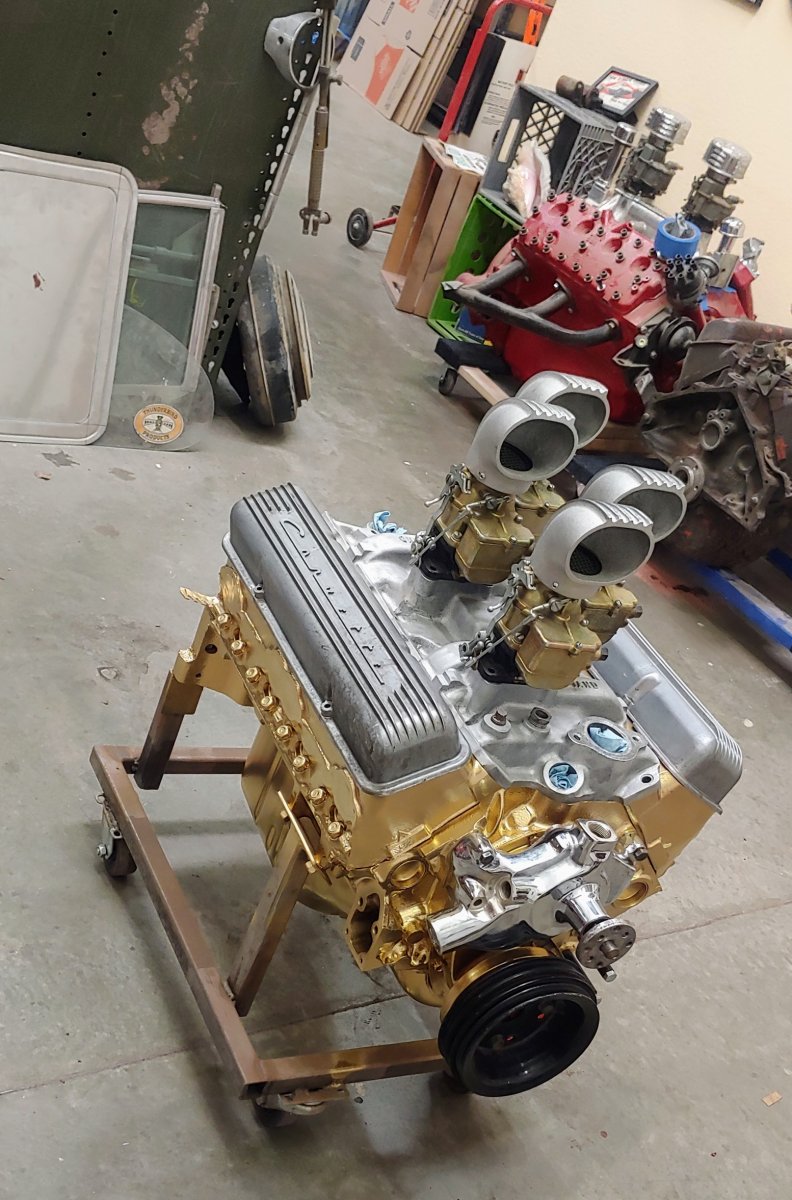

    There's just something about gold on a motor .... looks great!!!

    so I plan on painting the motor gold , and the car will be white on white , with gold touchs here and there ...
    Those bug catchers are awesome!!
