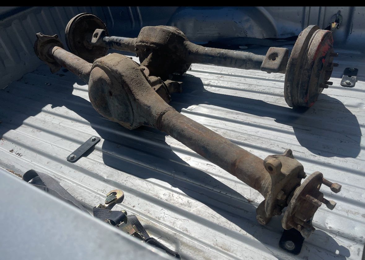

    IMG_6476.jpeg Picked this up for nothing, 5x5 looks like 63" fl to flange. I thought it was a 9 inch but my searches say maybe 9-3/8? I don't think that's right, but the weird (possibly) brake mounts have me puzzled....anybody ?

    Could be….there are bigger than 9” Fords that look very similar!

    A picture of the pumpkin will tell if 9 3/8 . It’ll have a curve on the horizontal rib

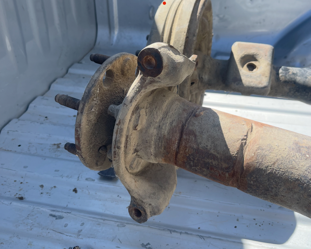

    that looks the disc brake mount used on full size lincolns in the 70s.
    show us the rest of it...

    Lincoln Versailles had disc brake 9" (or 9 3/8") rears that were popular on '80's street rods. Replacement parts are no longer available, so their value has plummeted.

    didn't the Versaille have 4.5" bolt circle? that's why I mentioned the big cars...he said it's 5 on 5

    Big 70s Lincoln Continental or the like

    How are you measuring that bolt circle?

    it's a 9, not 9-3/8. No curve on the top horizontal rib. S****e the **** off the front of it where the nuts are that hold the center section in, see if there's still a metal tag under one of the nuts. It would have all the info you want about the rear.

    I have one for my '27 Touring Car. It came out of a 1978 Lincoln Continental Mark V.
    The best way to build it is to utilize a 9" center section. As mentioned, there are no parts
    for the 9 3/8" center sections. The 9" center section will bolt right in and you can use your axles
    (28 spline) and Disc Brakes.

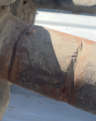

    Looks like the axle tube is badly cut into:

    yah just can't get good parts for free any more.

    IF I remember correctly- they run a 28 spline diff,
    check it for sure then.....
    buy a new car based smooth back 9'' case with small bearing ends to match the width of the 8''
    put the 9'' diff into that
    slide in the shafts from the 8''
    utilise the 10 by 1 3/4'' brakes
    57.25'' wide 9'' axle with correct brakes for a little car in the ideal width 1928 - 1940
    or, easy to find brake bits 1968 mustang complete brake set back plates out sub 100 bucks
