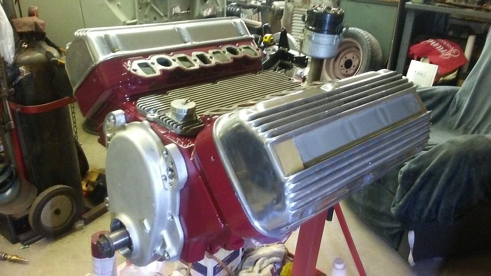

    Got the front wheels and rear backing plates back, freshly blasted and epoxy primed.
    Traded some NOS Mallory pieces to Mike B for the Y-Block in his 32 coupe for getting this stuff done so I didn’t have to screw with it. Win-Win.
    Mike also milled off a spot on the valley cover for the addition of an oil filler. I layed out the mounting holes, drilled and tapped for 6-32 screws and cut the fill hole without screwing up!! WHEW!!
    I had saved this mil-spec. cap for years and finally put it to good use!
    It will tuck under and clears the intake runner and water neck.

    A solution to a problem: how ya gonna put earl in this thing?
    Stock tin cover had a big *** tube and breather. FUGLY.
    HHH has a finned cover with a fill plug, but I’m a tight ***.:rolleyes: And already had this one.
    Bandit Billy put a cool (but rare) Donovan fill elbow on his valve cover. Hero.

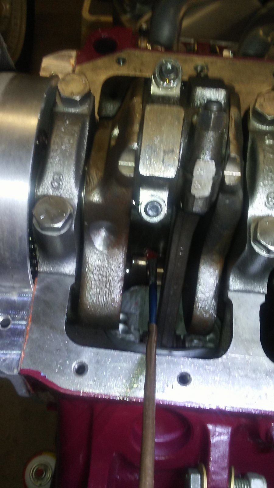

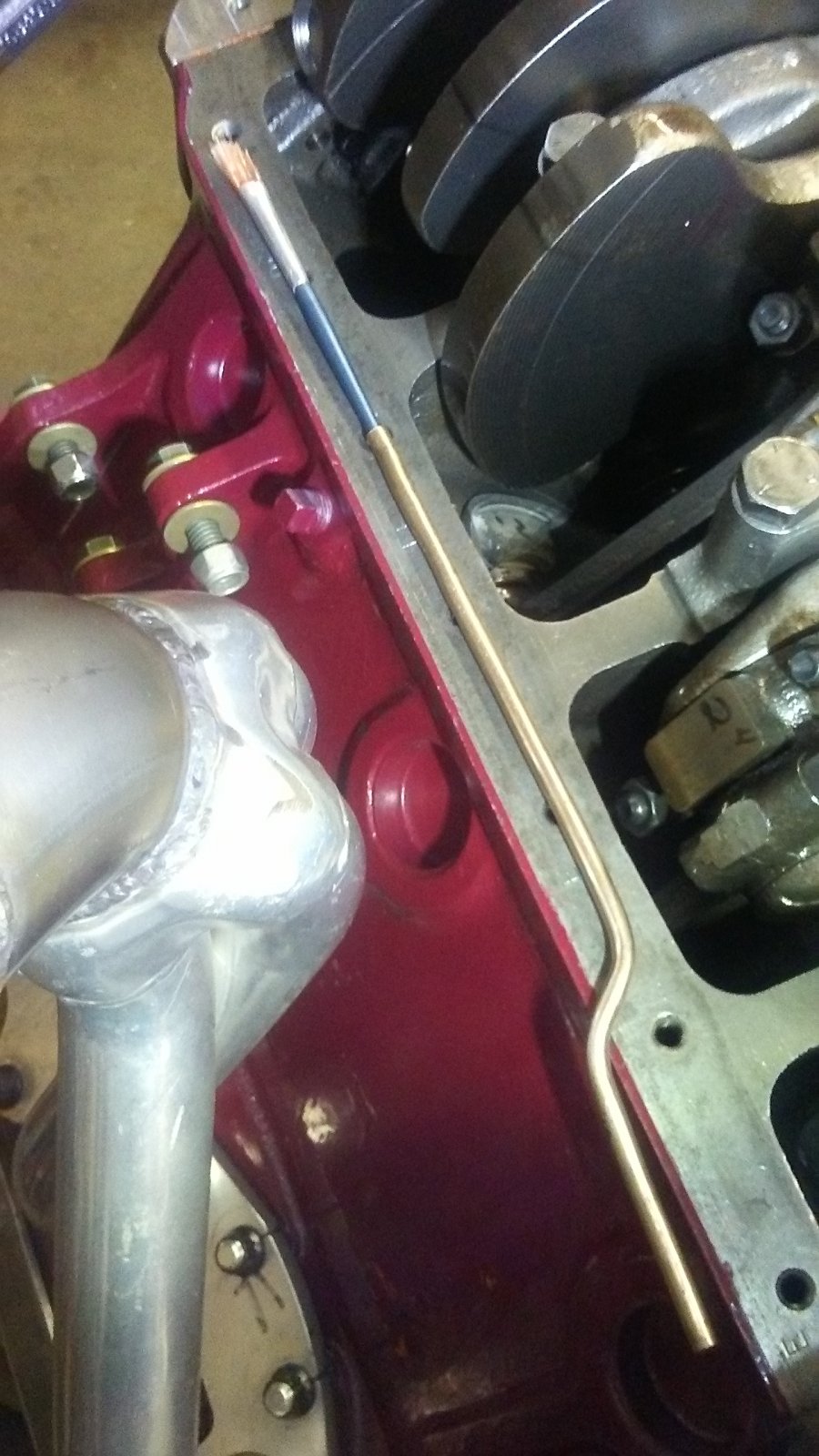

    Oil pan was next up on the engine, but I was worried about sufficient break-in lube on the cam. You just can't call Summit and get a new cam for a big D..
    Necessity being the mother of invention, I used a narrow artist's brush with a "custom machined" brake line handle extension. Piece of cake to reach the lobes from the bottom with the journal at BDC. A couple of rotations and everything is slathered with the Melling lube.
    Peace of mind, if nothing else.

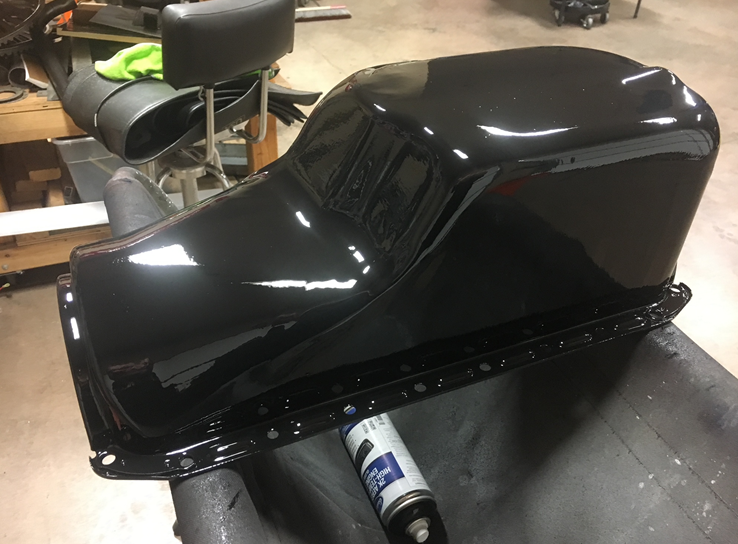

    Also got the rough cast valley cover fins sanded down and polished some.
    Next the pan.

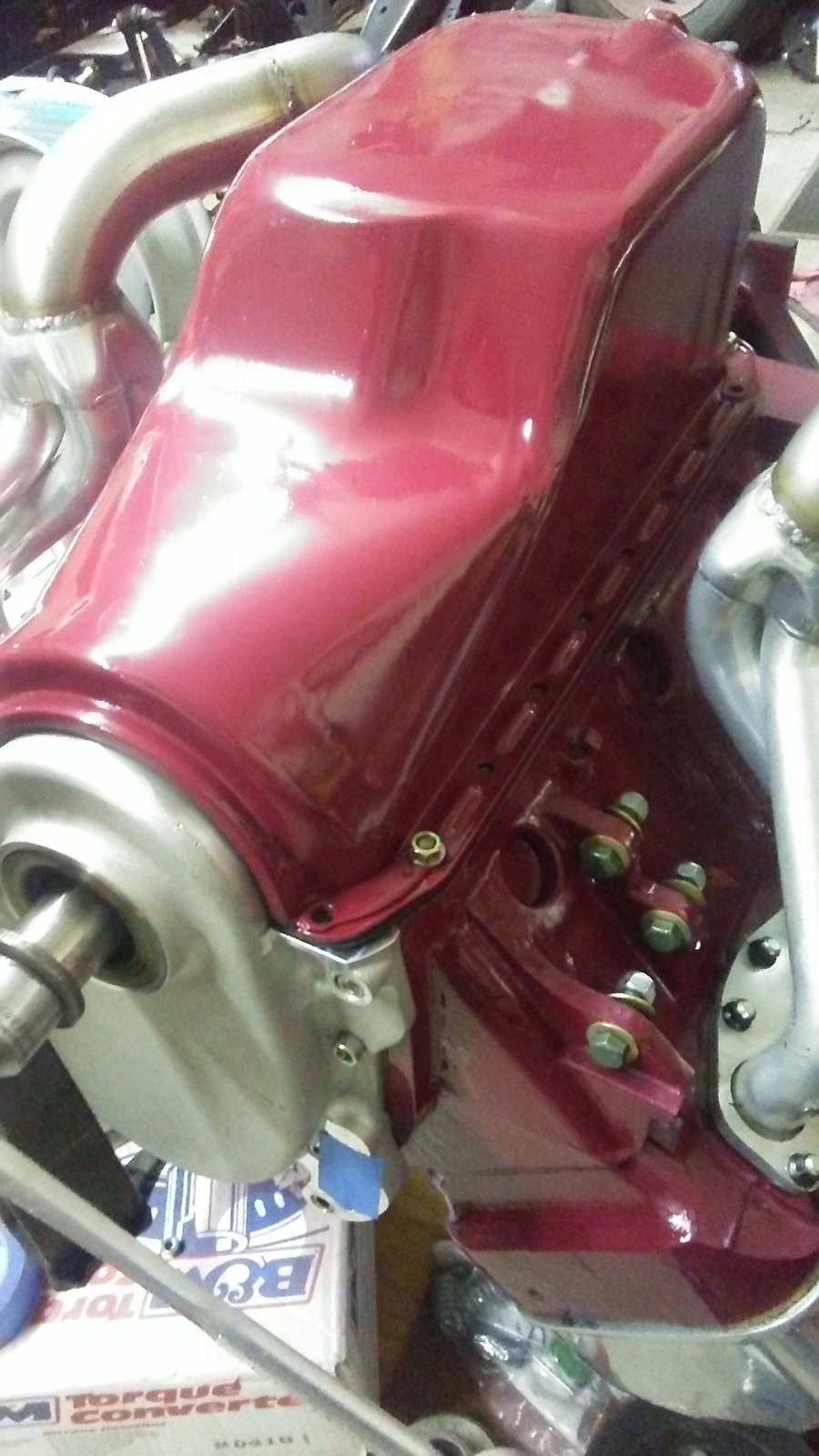

    Started on the pan after the cam lube job. Decided on studs and nuts instead of stock bolts.
    Finished with the oil filler after a little more polish. Ready to bolt on when I upright the engine.

    Also got the pan cinched down for good.
    Time to roll her over!:D

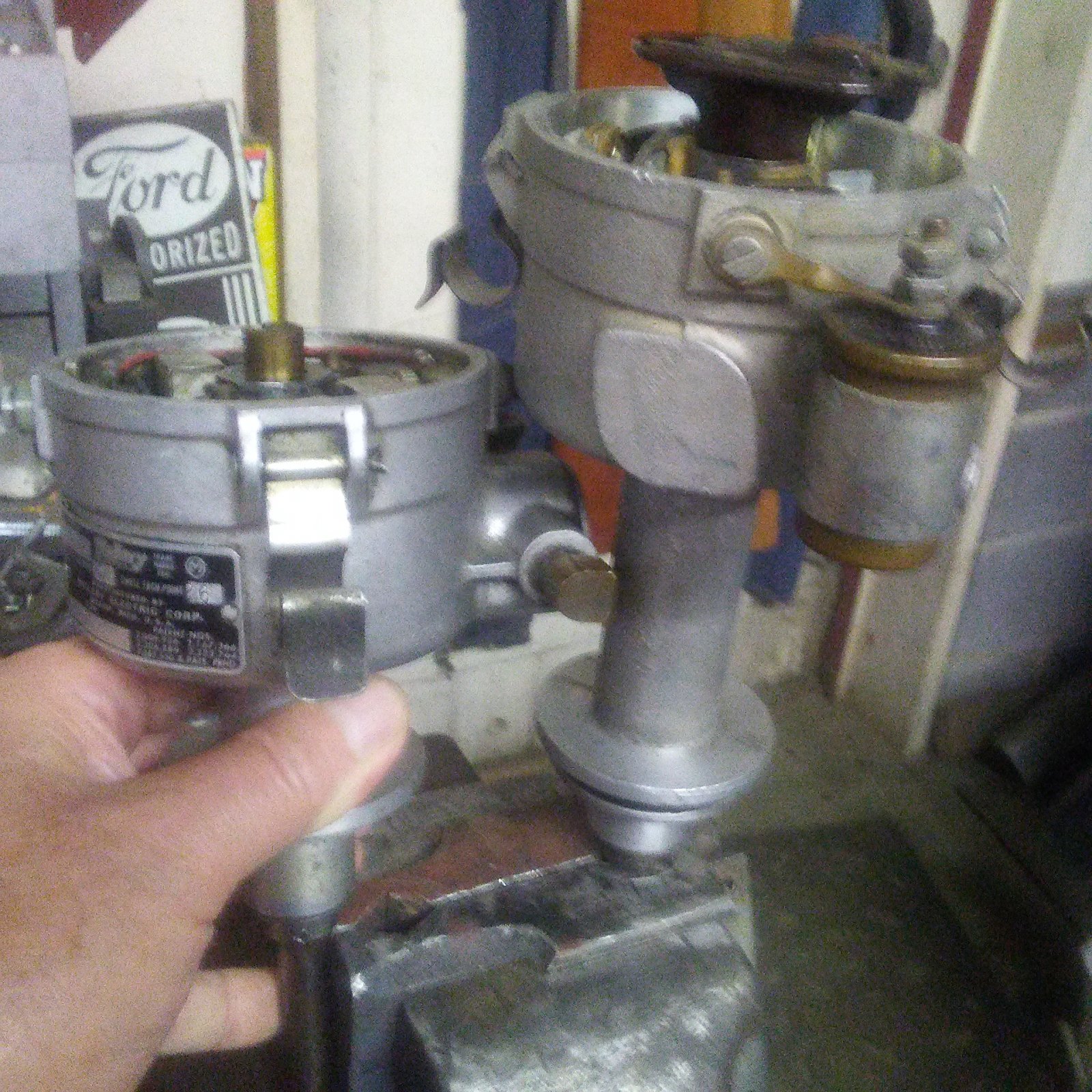

    Got the HH modified harmonic balancer on for the third (!) and final time, along with their bottom pulleys. Also took @dave g in Gansevoort’s advice and sent the water pump off to Howard Stewart for their rebuild. Dial indicated TDC and set the timing mark and glued the tape on.

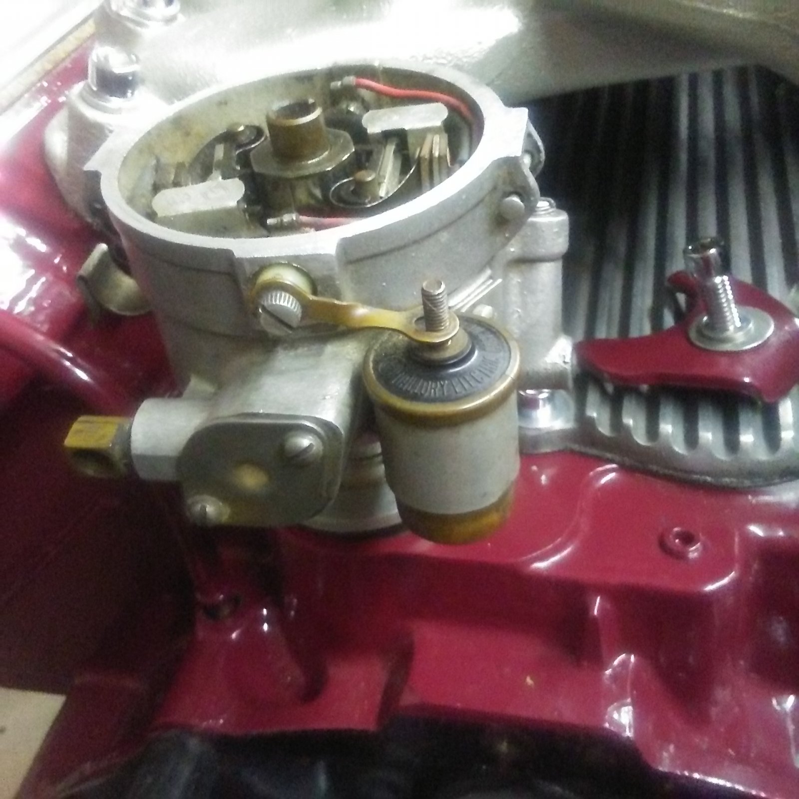

    Found out that the Mallory flat top I had was the wrong rotation, but after checking in some other Mallory stash, found the one with the correct part number and rotation. The first one was for a BB wedge motor, but fit perfectly.
    Quite the difference in height also.
    The correct one also has the vacuum advance/retard setup, so that will be a plus.

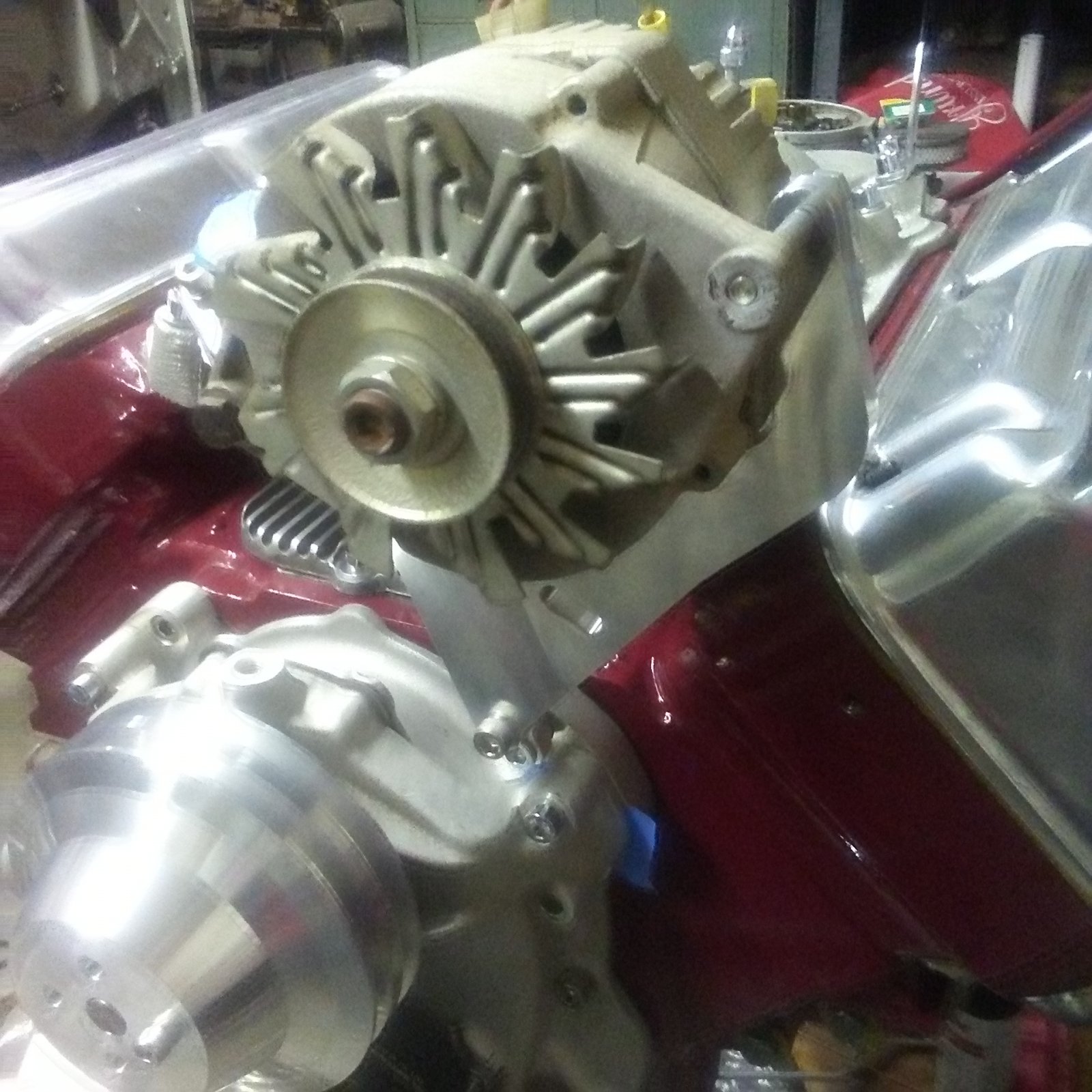

    I also stole @BanditBilly’s idea and moved the HH bottom mount alternator bracket to the top, but
    since it’s for a GM, and I wanted to use this early finned Mopar unit, it was fork in the road time.
    Do I go with the GM or fab a bracket for the Mopar? It’s been totally rebuilt and bumped to 90A.
    We shall see.

    Looks like the alternator's penthouse, or ba*****t, home will have to wait until the Desoto is back in the frame. Mocked up as intended by HH, and it looks like it won't clear the stock 40 crossmember.
    I thought I could adapt the Mopar piece to the HH bracket but it's a larger diameter.
    We shall see.

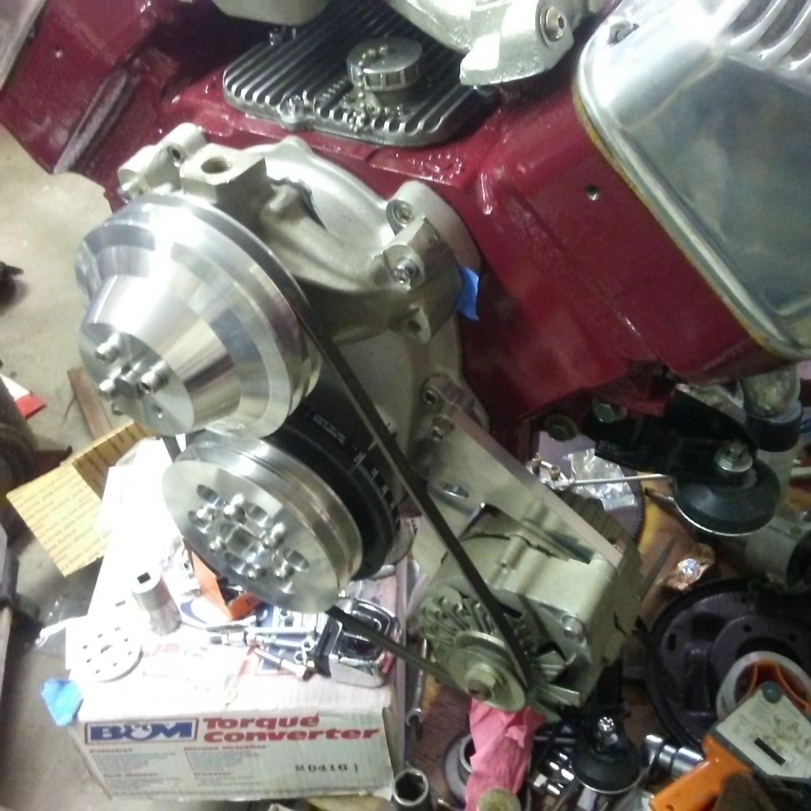

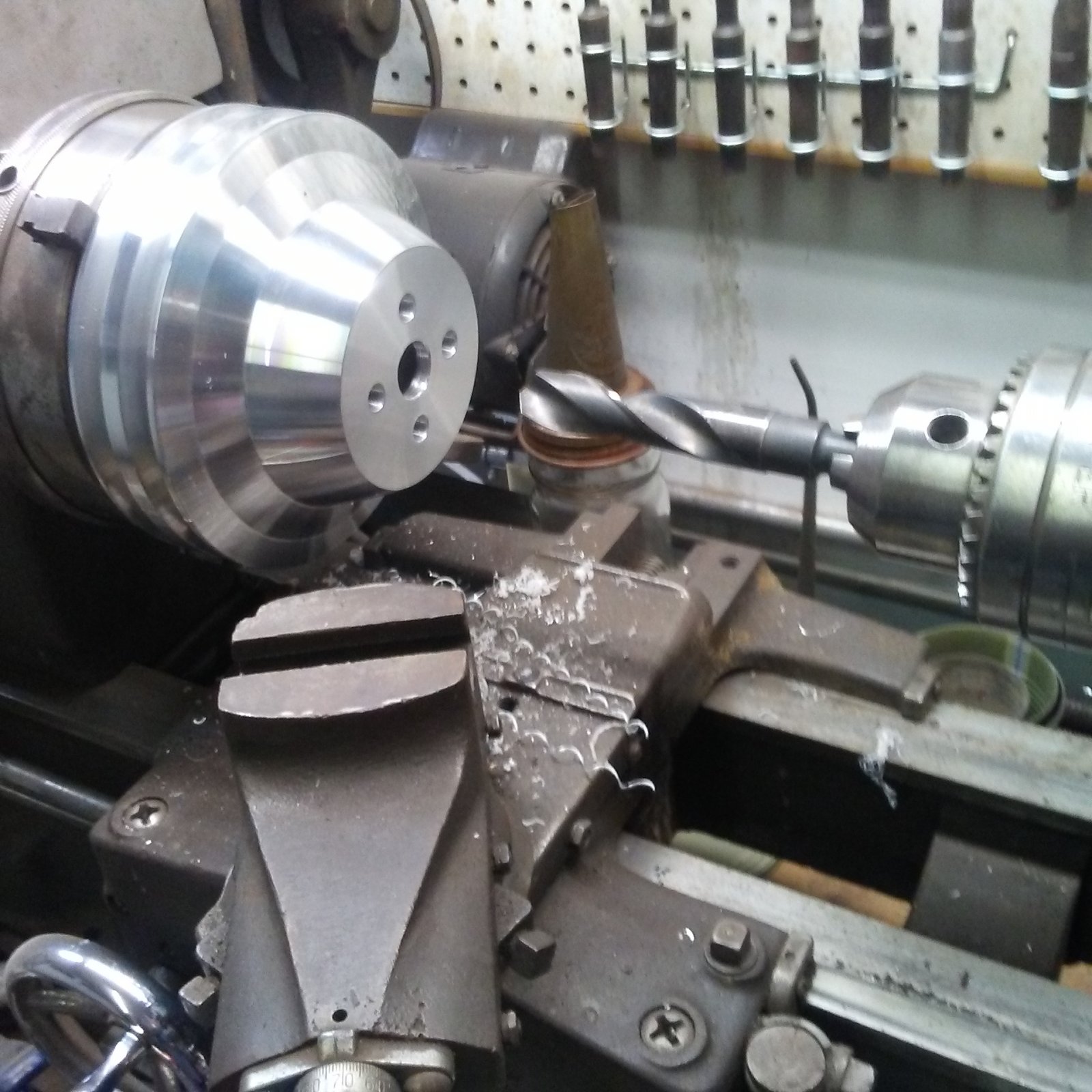

    After burning limbs and trash all day, I was whipped, and went out to the shop for a breather.
    Got the pump mocked up (again) because the new fan hub was pressed on way too far, so I got that pulled out to line up the pulley sheaves.
    HHH pulley comes 5/8”, so I had to bore it out to 3/4”.
    Easy enough to do, thanks to the antique Craftsman lathe.
    If I can find some pump gaskets (not included):rolleyes:, I’ll put it on for good tomorrow.
    Another piece to the puzzle.
