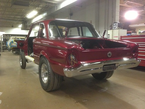

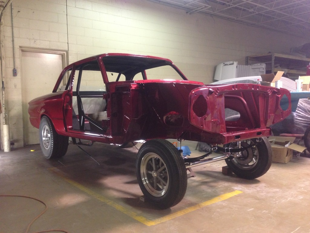

    First time on its wheels in over a year.
    Ive gotten a few questions on how the brakes will be done and thats all coming together right now. The next post will have better details on the subject.
  2. Oh man!, Now final ***embly. Take your time,the result is in the detail & this build has the Hallmarks of an outstanding Car. :)

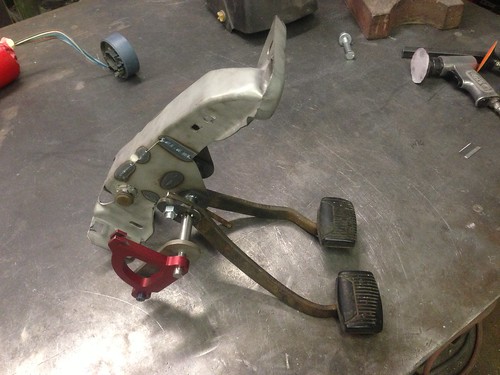

    I got around to building the clutch pedal ***embly. The original plan was to use the stock clutch pedal but 2 problems came with that. The quadrant mounting point was on the inside of the pedal and I needed it on the outside for cable clearence on the firewall and there wasnt enough room for the clutch quadrant to swing and pull the cable. I should note im using a latemodel mustang adjustable clutch cable and quadrant. So to make life easy i got a mustang pedal ***embly and just reversed engineered it. I did have to drop the clutch pedal down a little to clear the brake pedal bump stop but theres still plenty of geometrey left for pushing. The only reason I didnt weld the pedal to the rod was for easy instalation purposes.

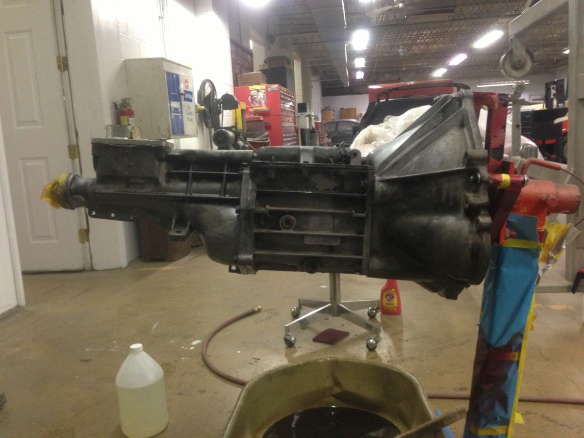

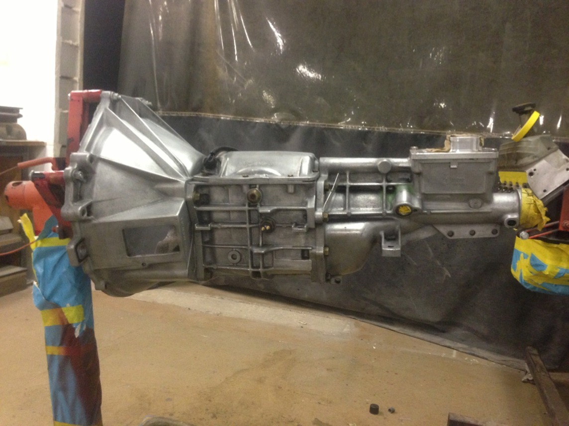

    Engine and trans almost ready. The trans is a before and after pic. Used a product called alumabrite. For what condition the trans was in and how it turned out I give it thumbs up.

    Don't remember if you mentioned it earlier, but what is the trans? Is it a WC T5?
  19. BrickTopp
    Joined: Dec 13, 2008
    Posts: 173
    BrickTopp
    Yeah it is a WC, ...I know it's my weak link but my thinking is a trans is a bolt on and there's room for which ever way we go. I've blown a tail shaft apart on a t-5 and know its capabilities. There is a company Astro Performance that has parts to build up the t-5 but if funds were a little more I would love to have a liberty 5 speed. So well see. It's kinda at the bottom of the list.

    Clutch pedal mock up

    This is the adjuster for the clutch

    What kinda' quadrant is that on the clutch pedal?

    The quadrant is an aftermarket one for fox mustangs. I like to use a lot of that particular car for parts because there a dime a dozen and have a huge support in aftermarket and parts stores.

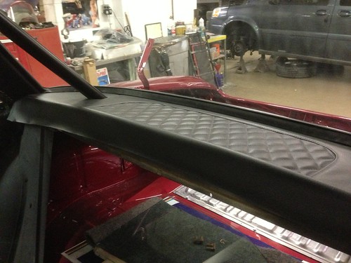

    Thought this is a better idea than just a piece of cardboard hiding the back seat

    Looks excellent, loving the rear shelf trim.
