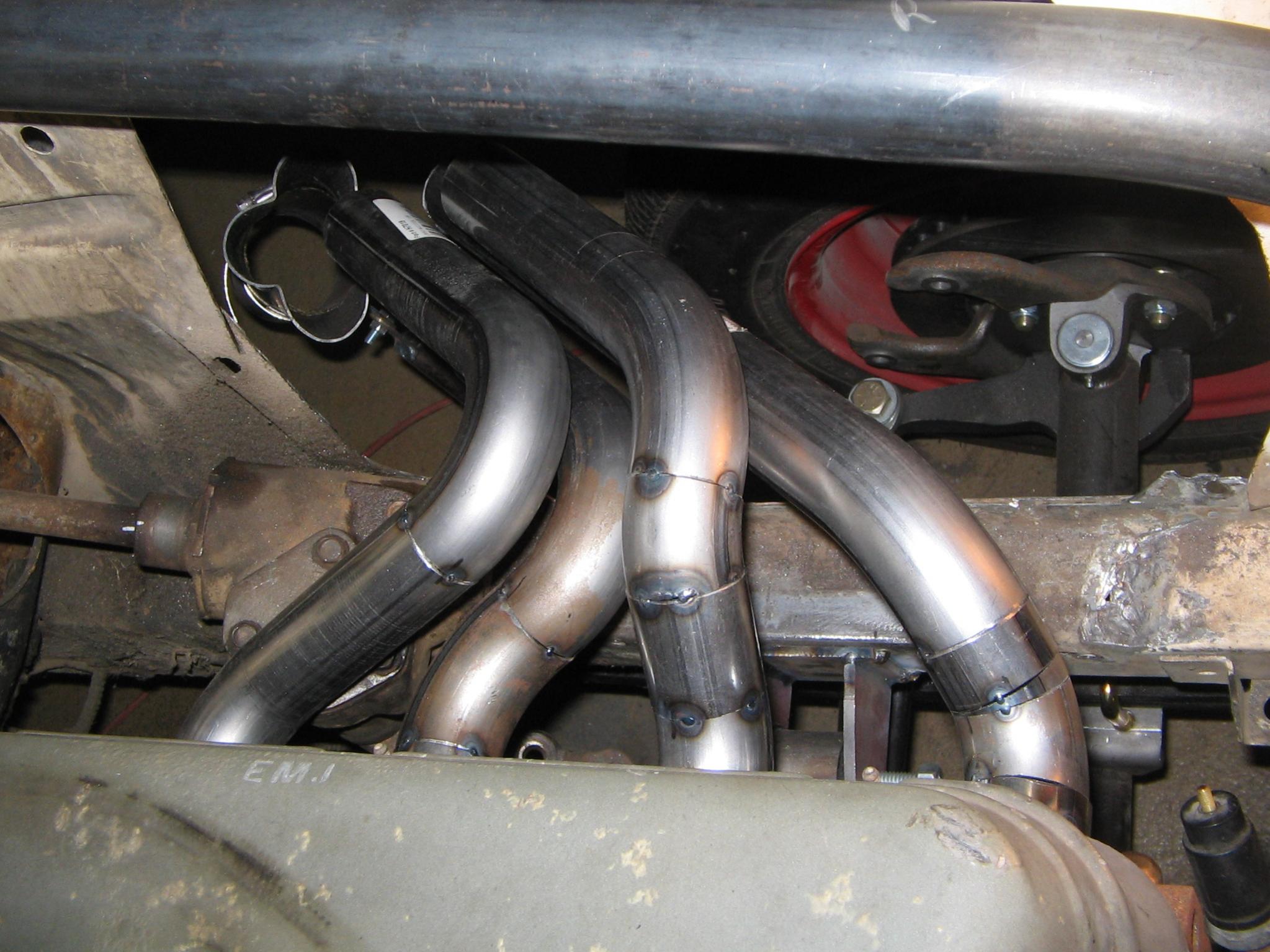

    well this is what the header will pretty much look like, one side down other to duplicate. the whole goal was to have it dump and follow the fenders wheel radius. there will be a full exhaust, you dont think its just meant for the track do you :D. the right side door bodywork is also done.

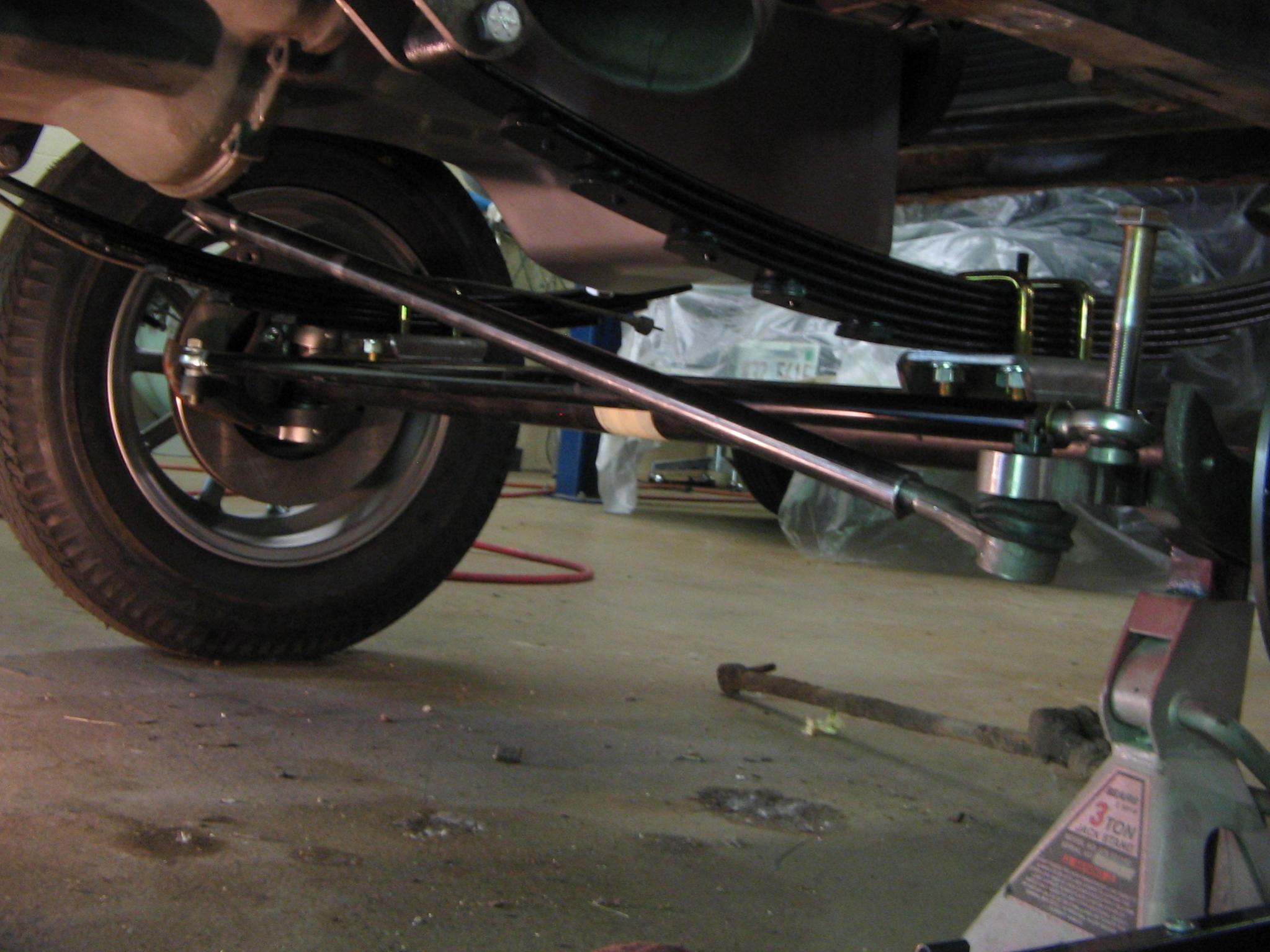

    well its been long past due since i update my post and i thought id share the rear suspension. We used a maverick rear end and shortened it an inch and a half on both ends to **** the wheels in a little for launching clearances. theres nice new moser axles on there way with long studs. the whole system is a leaf spring ladder bar. im kinda thinking coilovers i could have had done in a day. but it was cheaper. the 8 inch sits on full floaters that ride on the springs. i did move the locating pin for the leafs forward an inch to keep my rear wheels centered in the wheel well. the pin also acts as a stop now if for whatever reason something is to break. lets hope not with 3/4" rod ends and a small block i think were on overkill. i will have a plate bolted a 1/2 inch behind the floaters to act as the rear stop. i did put on a panhard bar now that the rearend can move side to side with a left and right hand threaded ends for ease of adjustment. as for the ladder bars they have 3/4 inch rod ends and urethane bushings on the ch***is end for street driving. it all gets tied in to all crossmember that slams into the roll bar and subframe connectors. i also made new shckles for a little bit of an adjustment even with the adjustment in the floaters. pinion angle is set just under 3 degrees.

    for the steering we used camaro tie rods to connect the stock box to the steering arm because they were the right size for the tubing we were using and gave us the room needed to use the pitman arm on the box. not super cheap at 50 bucks a pop but for durability no compromise. and for connecting the two steering arms we used left and right hand threaded rod ends. the right steering arm we extended a bit for turning radius and reamed both the extension and pitman arm for the tie rod ends.

    Not to be negative but the drag link has too much angle, when you hit a bump its gonna flatten out and make the wheels turn causing it to be all over the road. I just did this setup on mine. The drag link needs to be as parallel to the tie rod as possible.
    Looks great other than that. Thanks for the header build thats next on my list and the pictures helped out a ton.

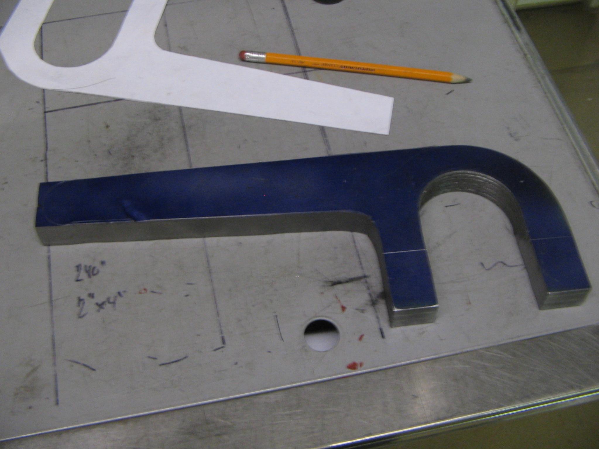

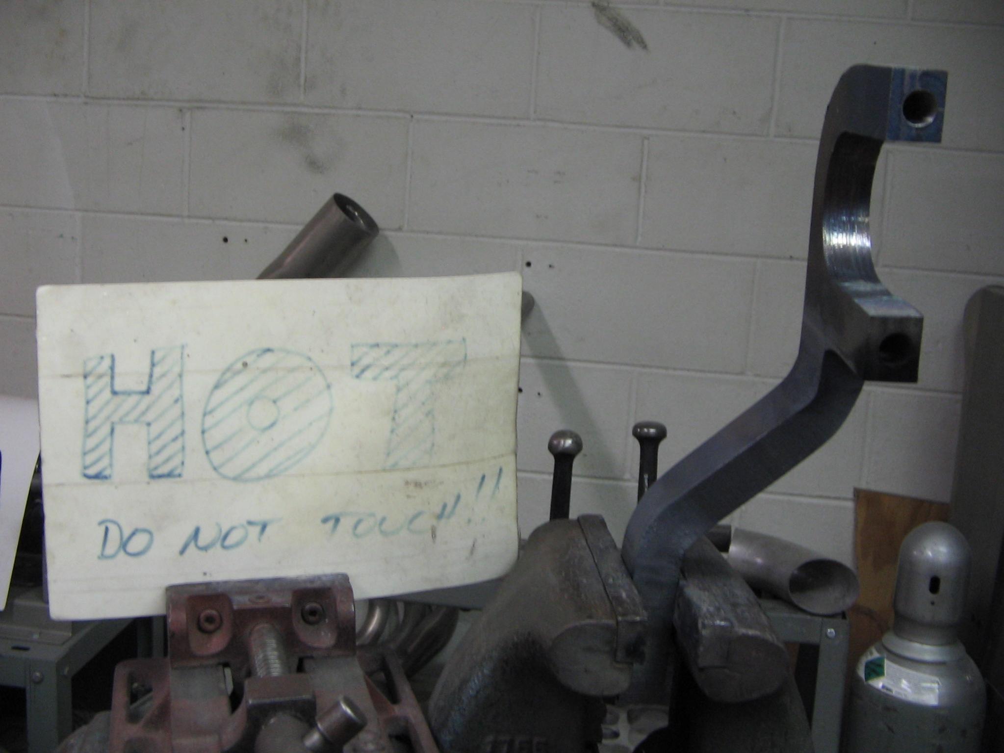

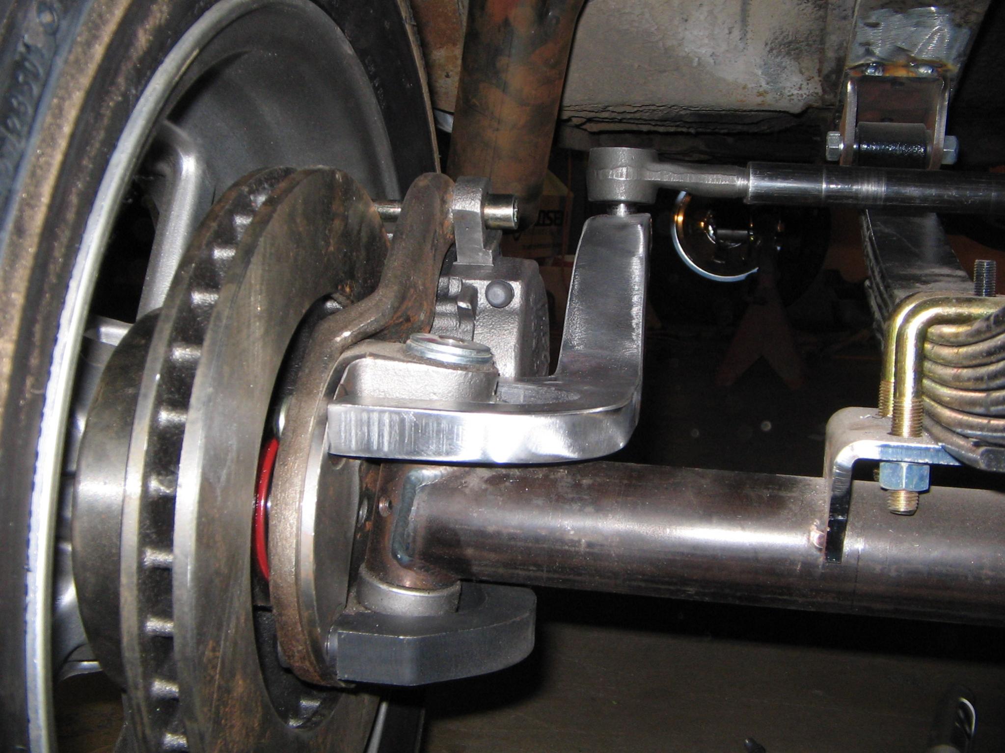

  19. BrickTopp
    Joined: Dec 13, 2008
    Posts: 173
    BrickTopp

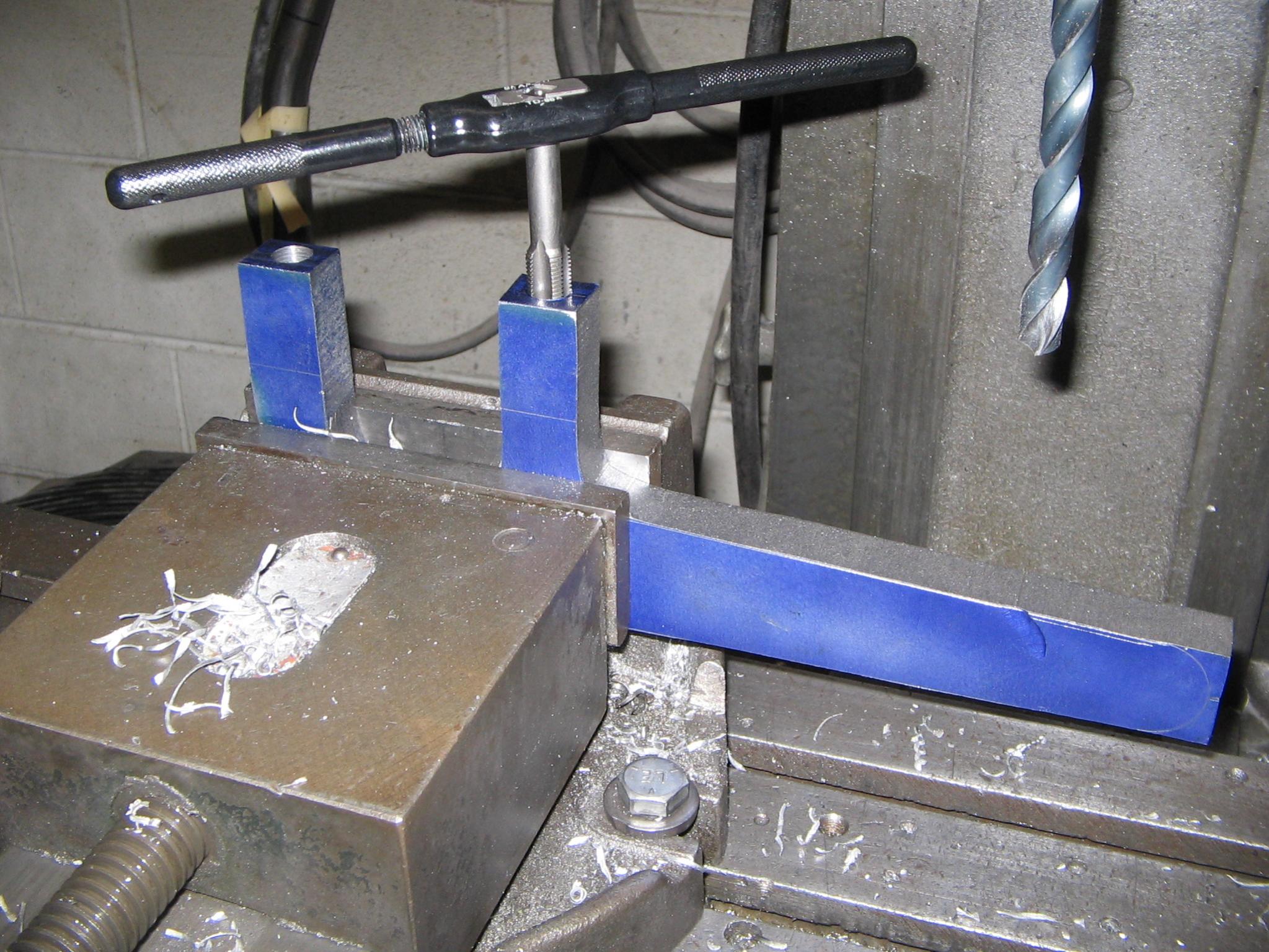

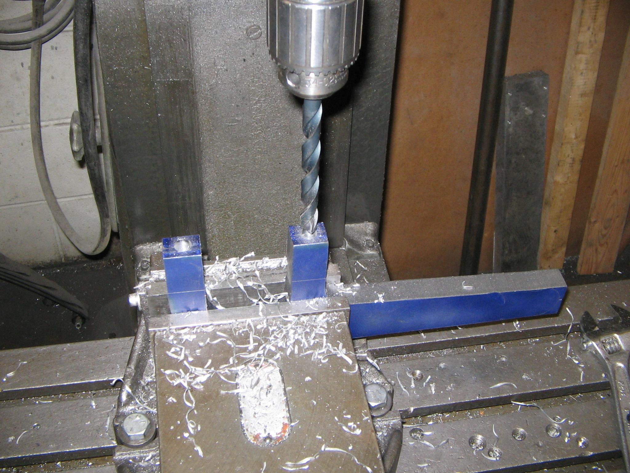

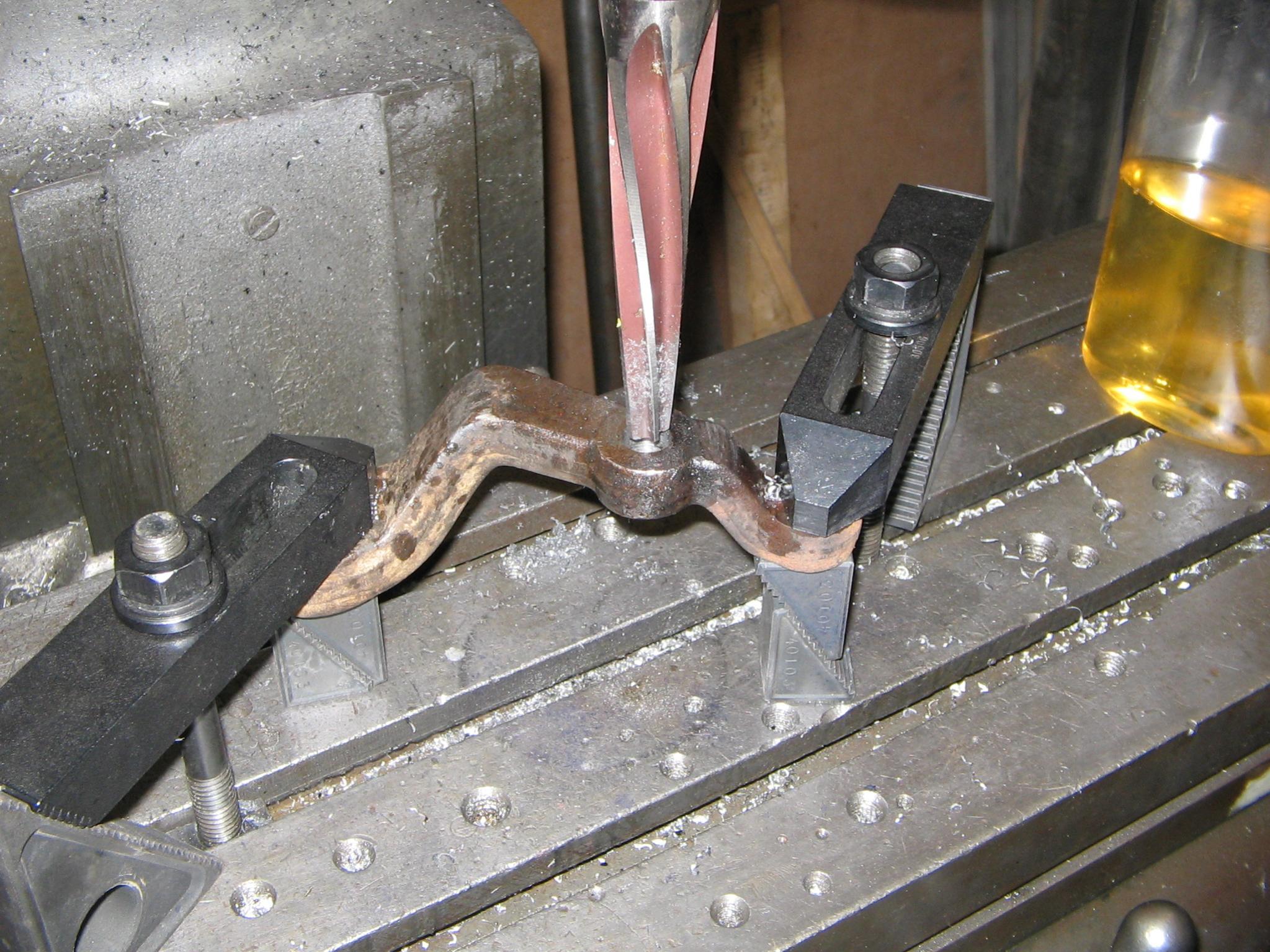

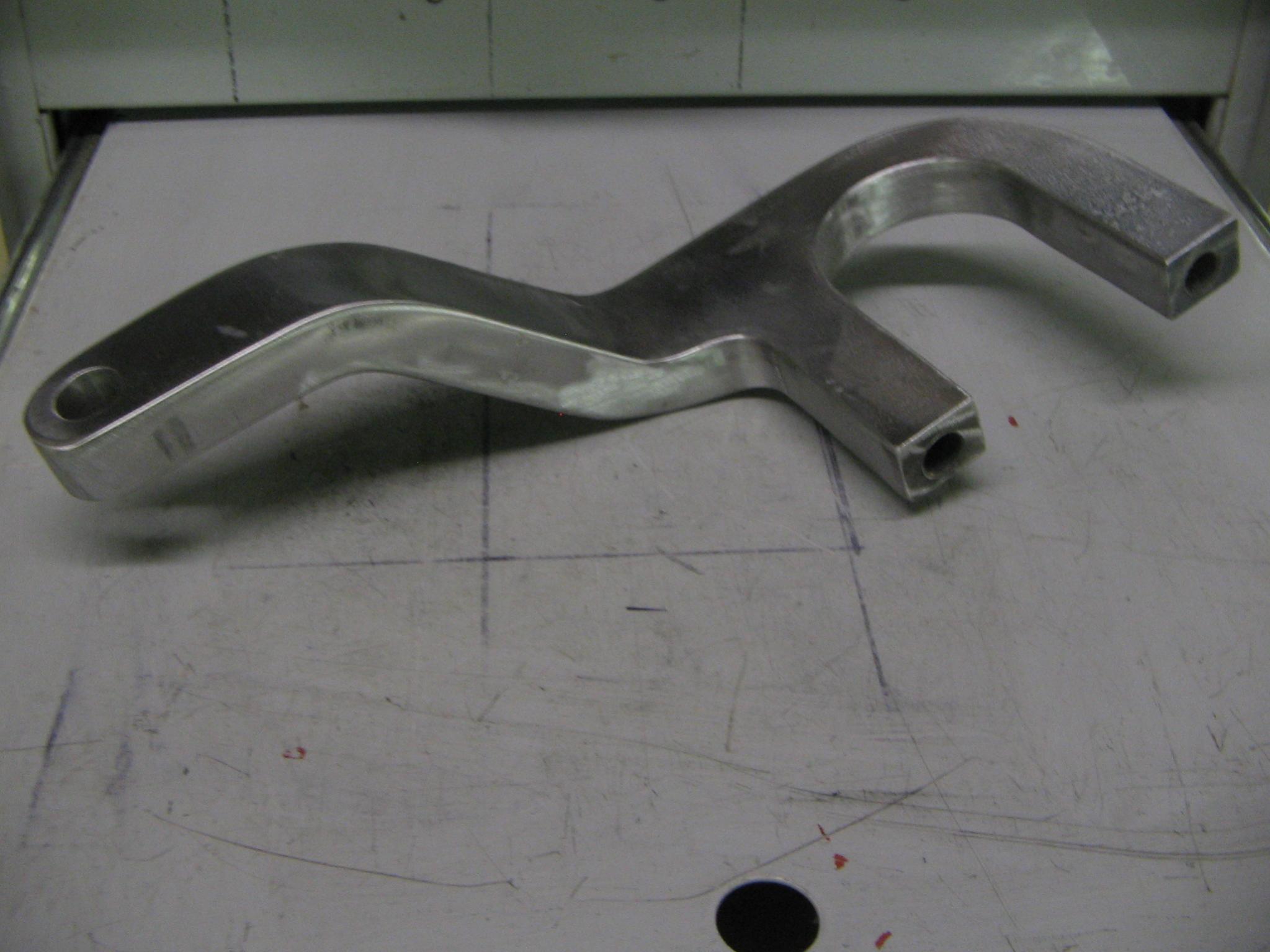

    all right this is my fix to bump steer. make a new steering arm. caliper works, its still in the rear and everything is level and i scored a little more turning radius with no rubing anywhere. the lower steering arms will need a little tweaking for the caliper but nothing major. pictures explain and its 3/4 plate.
  20. Shizzelbamsnapper
    Joined: May 13, 2010
    Posts: 317
    Shizzelbamsnapper
    from Ohio
    That looks great, it should be good to go now.

  22. Gotgas
    Joined: Jul 22, 2004
    Posts: 7,297
    Gotgas
    from DFW USA
    Holy ****, that steering arm is awesome! :D So is the rest of the car. :cool: Not sure if there is any other way to build a Falcon!

  26. Kerrynzl
    Joined: Jun 20, 2010
    Posts: 3,619
    Kerrynzl
    Cool at***ude! Cool Car!
    Looks like your bump steer is sorted out , nice work.
    If the bump steer is still a problem, I have a recommendation.[ and to others open to suggestions ]
    Use a panhard bar, identical length as the cross steering arm, same angle [ and parallel to the steering arm ] and mounted on the ch***is on the same side as the steering Box.
    The idea is to have the RH side of the axle beam move in an arc identical to the cross-steering arm arc [ it cancels out bump steer ]
    I've seen this on a vintage dirt car when my dad raced in the 60's
    Again Cool Car !!!
