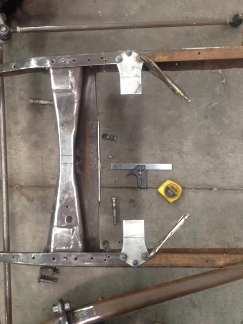

    The first job was to pie cut for a 2" front sweep. I also cut the behind the front crossmember to bring the front back down. I'll make some 4mm plates and weld them on the inner rails to support the pie cuts. Here in Australia we need to have our cars inspected and engineered. It recently went through it's first inspection. The engineer was happy which made me happy!

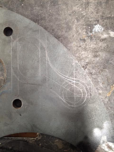

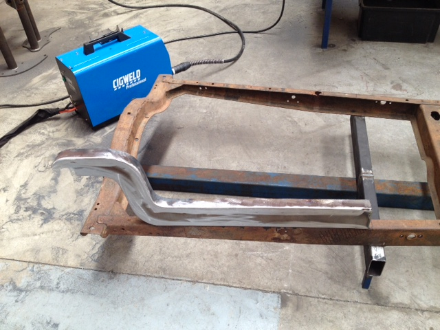

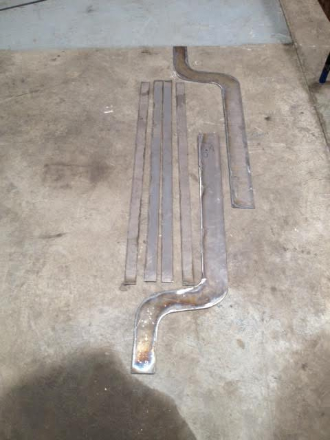

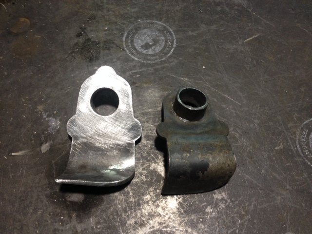

    Then cut out some 4mm steel for the rear "Z"
    Welded, cleaned, polished and ready to weld in.

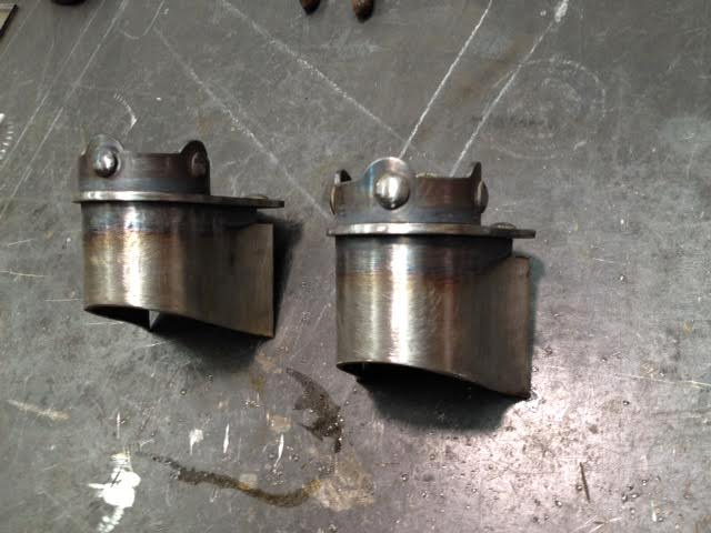

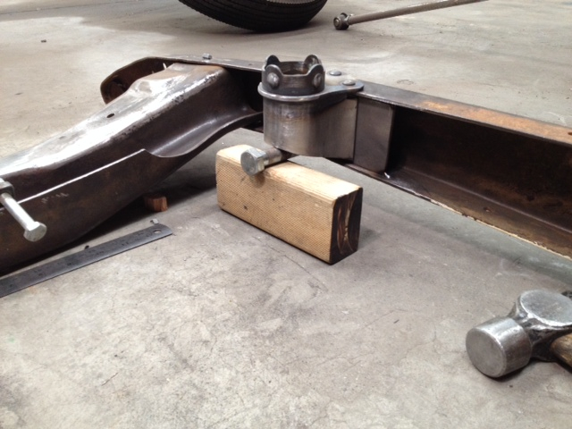

    Fabbing some engine mounts. I wanted something different and something that looked original so I made some faux rivets by modifying some old bolts
