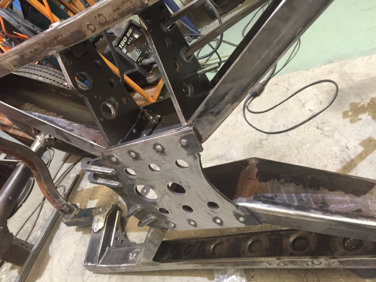

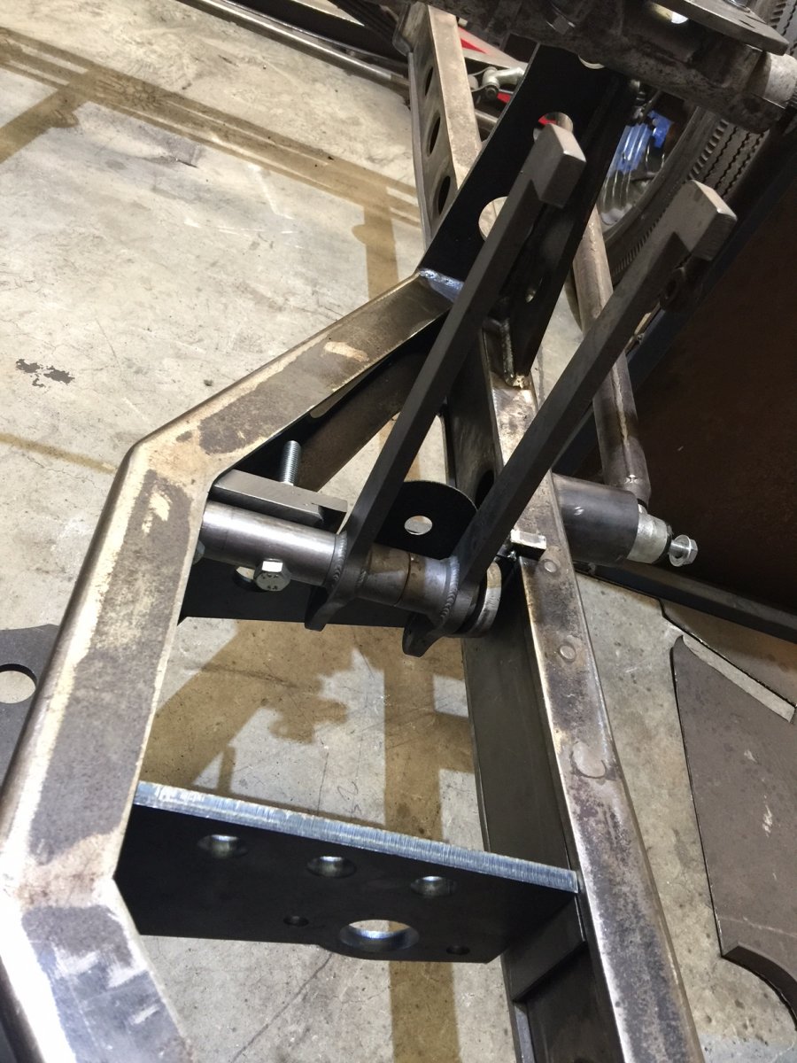

    Pedal set mocked up. Brake and clutch master cylinder will bolt on the plate behind with the push rods connecting them. The 10mm plates also act as a support from the K members to the ch***is

    I spent some time last night finishing off the pedal set and mounting brackets which also act as a K member strengthener.

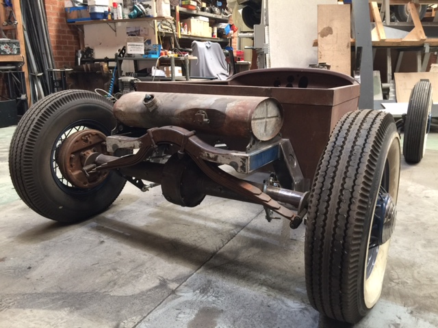

    The car mocked up to date
    IMG_3240.JPG IMG_3244.JPG IMG_3251.JPG IMG_3254.JPG IMG_3255.JPG IMG_3257.JPG IMG_3259.JPG
    waxhead and Jet96 like this.
