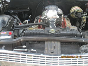

    I might have to go with dual carbs if I can not get a single 2 bbl to work,since I have a spare motor I might try to make my own 2 bbl intake when I get bored during the winter months.

    Mill the head .100". (Requires sinking the intake valves and shimming the rocker stands the same amount.) More power across the RPM range, more MPG, still looks stock. Petronix converter in stock distributor. Hi-Lift rocker arms (if you can find them!)

    235, very mild cam, cleaned up ports, 390 4bbls or 2 two barrels, split ehx = 165 Net HP or so.
    Now that's about what a 15 more than a 283 had in 57 or a 305 in 77.
    If I wanted a little more add a bit more cam, maybe 185 HP.
    After that move on to V8, much cheaper even with the transplanting.
    But if 283 power works, cheaper to fix up that 235.

    I like this intake,can have a plate made to mount a small 2 bbl and grind all the letters off for a more stock look. It has fentons on it now so I do not need to do anything with the exhaust.

    Langdon makes an adapter for a 32/36 Weber to the stock manifold. Claims 10 HP increase at full throttle. http://stoveboltengineco.com/catalog/store/#!/~/category/id=361512&offset=0&sort=normal
    You probably saw this on another thread, but Rich Wright posted this great pic of his 261 with a 94, also on an adapter by Langdon. He, too, claims significant power/mileage increase.
