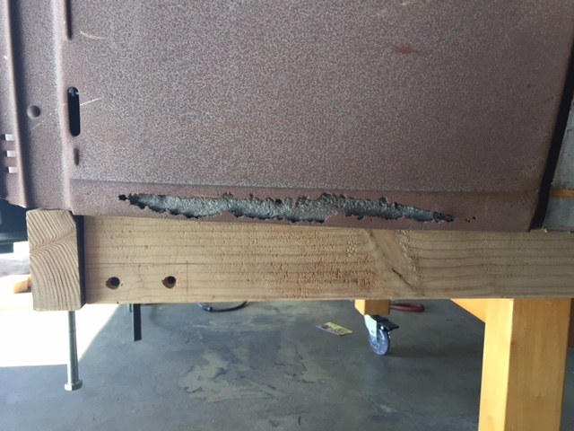

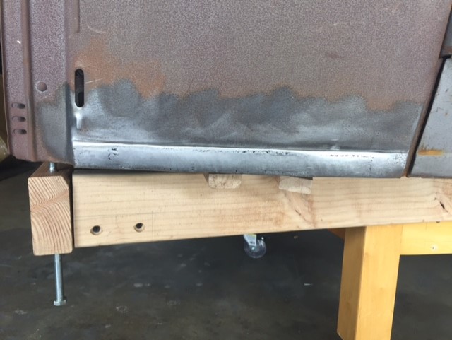

    Not a bad body to start with. Rust in the common areas.
    The sub rails at the rear wells has the worst condition where there is a lot of damage; however, a stedfast kit will be installed and will remedy that.

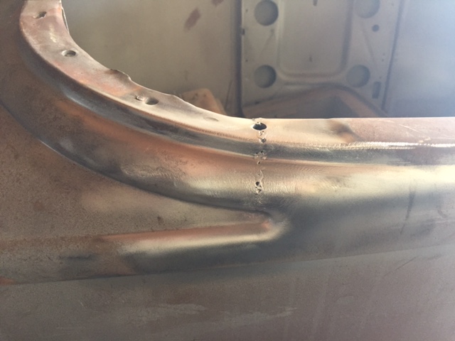

    Just to get going with welding again, I started by welding shot all the holes for the fire wall

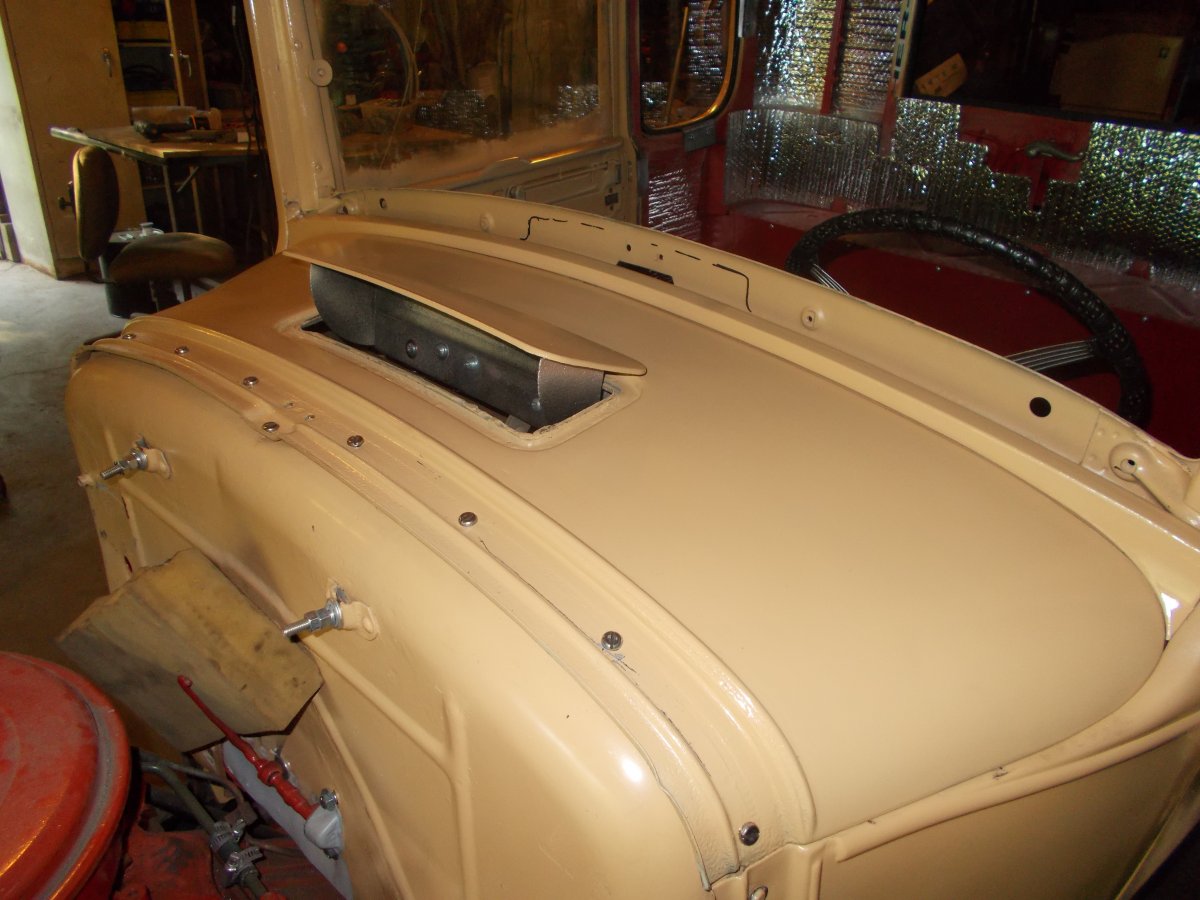

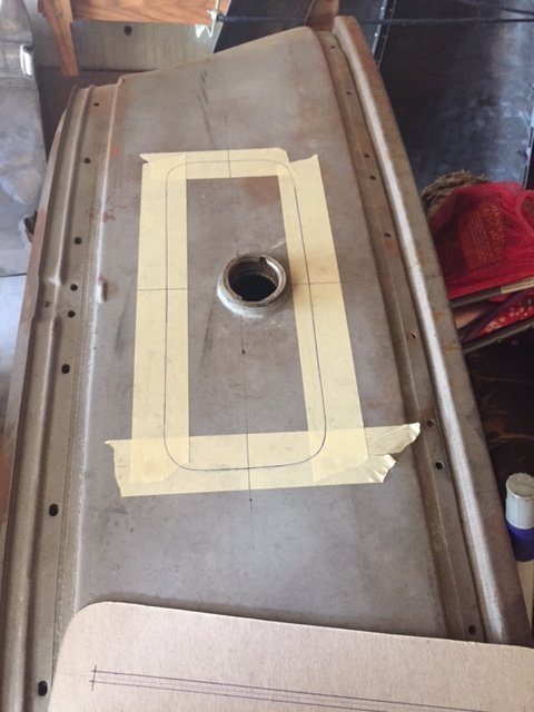

    I decided to add a 32 vent to the gas tank.
    I measured bout 3/4" off the top of the tank and cut all the bottom off.
    Made me a quick cardboard template to help me center the vent.
    thumbnail_IMG_2719.jpg thumbnail_IMG_2714.jpg thumbnail_IMG_2715.jpg thumbnail_IMG_2716.jpg thumbnail_IMG_2720.jpg thumbnail_IMG_2721.jpg thumbnail_IMG_2722.jpg thumbnail_IMG_2732.jpg

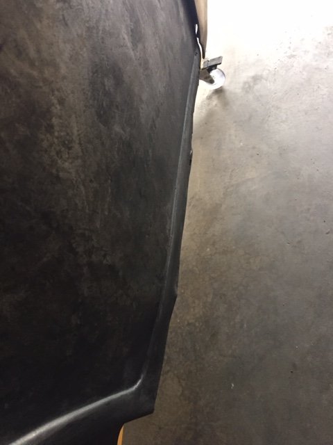

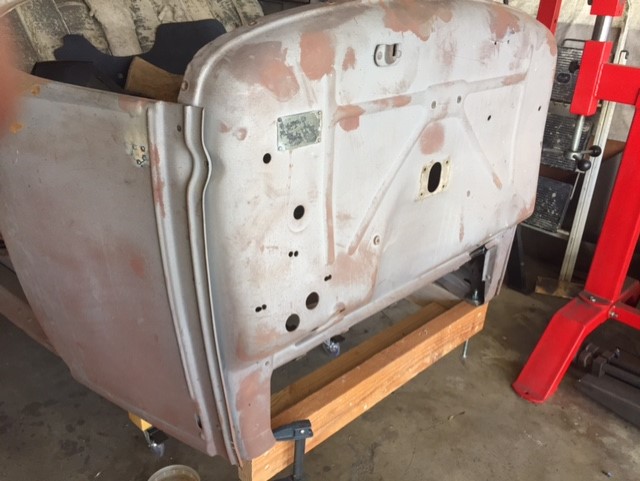

    Next on the list were the lower cowl patch panels. I figured I would get patches from Mac's and simply cut away the rust and weld-in the new panel. Boy! was I wrong.
    The replacement panel had the wrong curvature for the bead line, so cutting and welding was not an option since the replacement bead would not match the door's or the rear cowl panel's bead.
    Instead, I cut away as little as possible from the damage area, keeping most of the existing bead's ****er curvature. I then cut the same patch from the patch panel I bought and hit it with the english wheel to flatten some of the crown off. A little bit of dolly work and it was ready to be welded.
    thumbnail_IMG_3108.jpg thumbnail_IMG_3148.jpg thumbnail_IMG_3145.jpg thumbnail_IMG_3147.jpg thumbnail_IMG_3111.jpg

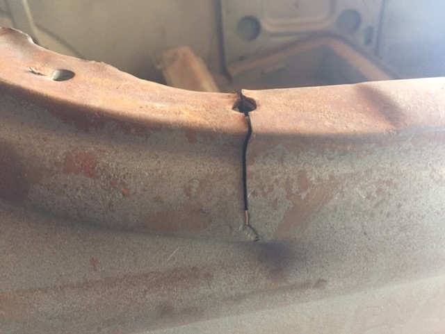

    Next it was the splitting metal at the upper area of the convertible top and the damage to rear upper cowl panel. Looks like it was just smashed by the door opening and closing combined with thin metal, it finally gave away.
    Little repairs that took some time. A bit more metal finish and lead work and it was done.

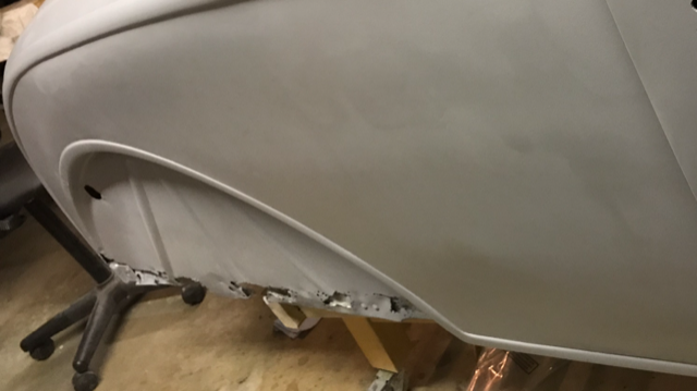

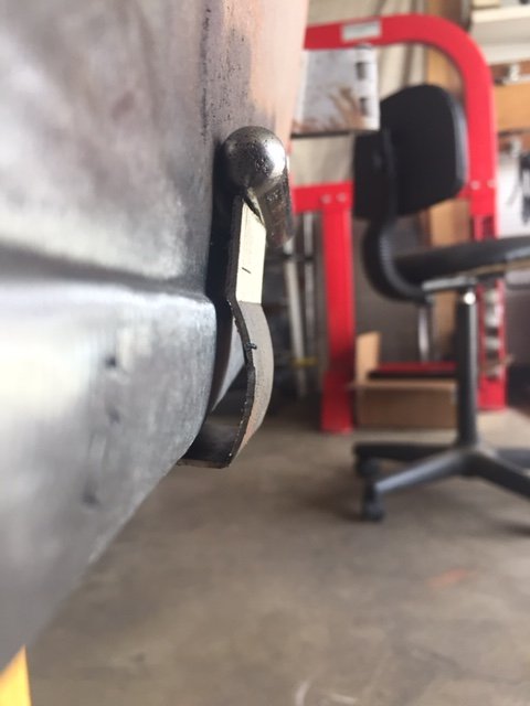

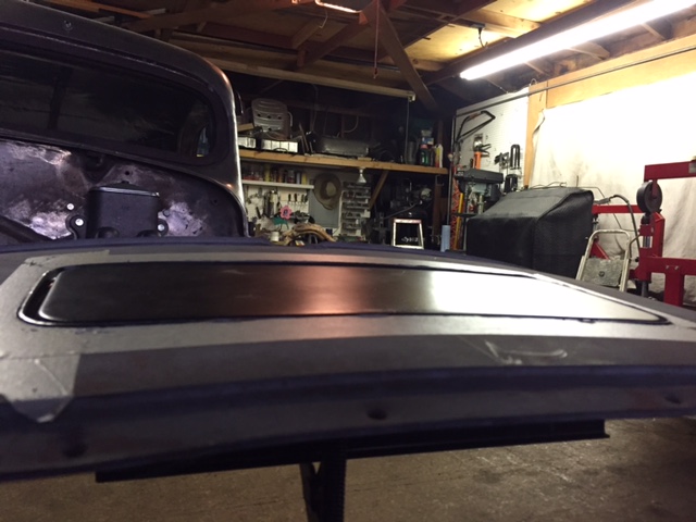

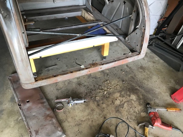

    I removed the rumble seat floor and started working on recessing the Pontiac taillights to the panel below deck lid.
    Before that, I removed the old panel, which was ***** to remove since all the bolts were rusted/welded shut.
    After a bunch of fire/water/penetrating oil. I was able to remove

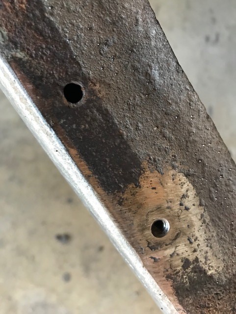

    Since there was no threads on the old rear cross member, I decided to add and weld in 1/4"x20 bungs

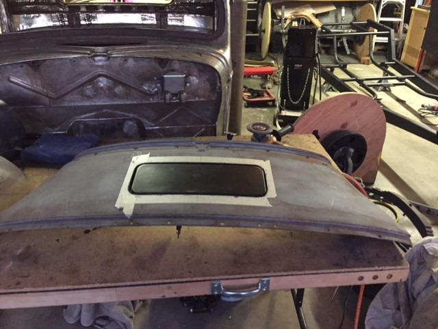

    I spent a good amount of time laying out the bucket placement in relationship to the license plate and license plate light. I will be using a Hollywood light for the license plate light.
    As a side note, Little did I know that there are 2 types of replacements lower panels for below the deck lid. One that has a soft curve to it and another one that is straight across the back. The one that I got from Mac's has the soft curve to it. This will become a problem down the road for me as my deck lid is straight across the bottom.
    One needs to make sure to match the right bottom panel to the deck lid to be used. Non of the ads I read mentioned this curve and only became aware until I saw the problem and started asking...it was too late then.
    The original deck lid I sold had that soft curve to it; hence I bought the lower panel with the curve. The replacement deck I bought is straight.

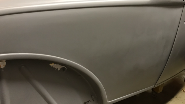

    Time came to tackle the p***enger rear quarter panel. That is the part on this body that I feared the most. Man, I hate straightening dent.s I simply **** at bodywork.
    For some reason, no matter what I do the low spots always end up lower, the highs spots even higher and the spots that were right to begin with...well, they are not right anymore. I can't feather body filler to save my life.

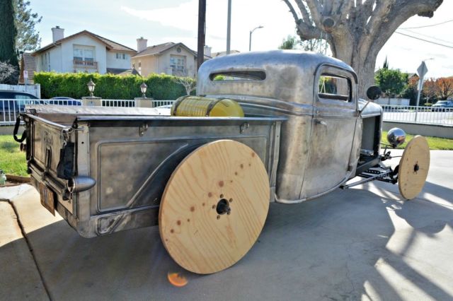

    To give you an idea how much I dislike bodywork; I built this Chevy truck with a patina paint job to take advantage of how straight it was and to avoid doing bodywork at all cost. I can so an ok job painting but bodywork, hell no!
    thumbnail_thumb_DSC_0373 (2)_1024.jpg thumbnail_thumb_DSC_0376 (2)_1024.jpg thumbnail_thumb_DSC_0381 (2)_1024.jpg
  27. roll of the dices
    Joined: Jul 15, 2010
    Posts: 1,349
    roll of the dices
    Lots of you can look at it and think this is a piece of cake, but not me.
    I sprayed a light coat of primer and block sanded the entire panel. You can see all the low/high spots easier.
    The bottom of the panel was rotted so I would need a replacement. I bought a patch panel from Mike's and the bead molding was a very good match.
    Outback, 1947knuck, dwollam and 3 others like this.
  28. roll of the dices
    Posts: 1,349
    roll of the dices
    Knowing that the bottom would be cut anyways I concentrated on the overall panel.
    Without any research, I started beating on the low spots from the back, that was with the body hammer only, then I started using a dolly. I've now learned what I did was called "hammer on dolly". In no time I had an over stretched, oil canned, dented panel.
    I stopped and did some research. Google is a good friend. A replacement quarter was too expensive and out of the question.
    I found a shrinking disc online that could cure cancer and bring work peace. I bought it and went to town with it....the results were far from better. the panel was very much out of shape.
    I did some more research and learned about "hammer on dolly and hammer off dolly"
    I bought some spray-on guide coat and went at it little by little with a hammer off dolly. I checked the contour with a cardboard template I made from the other side.
    Since I don't have super long arms, I made cut a wedge like piece of wood to rest the dolly and put pressure from the back while slowly hammering the front.
    The highs and lows started to go away.
    I used the shrinking disc in selected spots to get the oil canning off and I must say, it came out really good!

    Once I got the panel to where I felt comfortable I cut the bottom off and replaced with the patch panel.
    I will eventually replace the wheel wells, once the frame is here, so for now I didn't worry much about the arch well.

    I am satisfied with the end result. The shadows on the pictures is just dust but it came out good.
    Once I do some body filler, a thin skim coat, it should look better. The door aligns very well with the molding bead and the crown on the panel seals well with the door.
