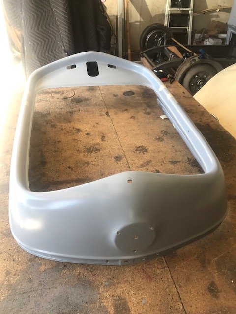

    In the meantime, let's chop a grill shell. The plan is not to chop it 2" but raise the sides, so it can sit 2" lower on the crossmember..
    Should I cut the opening for the filler neck and use the stock location?
    Always thought it looked goofy the side filler on the back of the radiator.

    I chopped the grill shell. Still have to do the welding part. 2" are now gone.

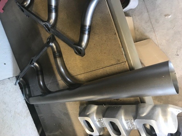

    X-mas came early this year. I treated myself to set of headers from Gear Drive and couldn't be happier. Very well invested money.
    Haven't work on the roadster much, still waiting on my radiator to move forward; in the meantime, I have been spending more money than anything else....No Bueno!
    I had my eyes set on a set of these headers but unfortunately Matt announced that he was no longer fabricating them. Luckily enough, I reached out to him and he had a set available., with turn outs and slip-on baffles. I pulled the trigger and yes, all the great reviews out there are accurate.
    Great communication and outstanding customer service! Thank you Matt!

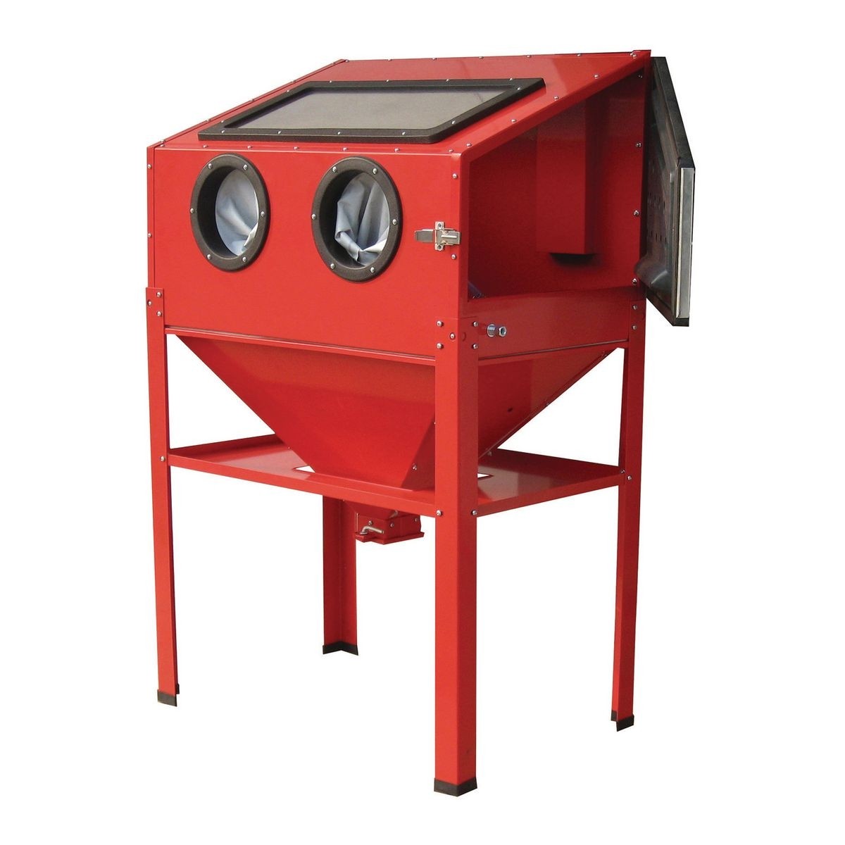

    My HF blasting cabinet has been one great investment!

    Very nice. Which HF blasting cabinet do you have? Thanks.

    I have their 40 lb capacity floor unit. Bought it for close to nothing in Craigslist and been using it with HF's Black Diamond abrasive.
    I learned that HF discontinued the Black Diamond. I haven't had a need to buy more but I do like a lot the finish that it leaves on the metal.

    Tractor supply has a black sand in two grits. I have the same blast cabinet and like the finish I get.

    Do you use the Fine or Medium grit?

    We use the fine. Seems to work well. They don't always have it in our local store but usually can get it within a week from their dist. center.

    I use both depending on what I am doing. I also have a very fine powder close to baking soda. I store them in 5 gallon plastic pails, they fit under the dump door on the blast cabinet

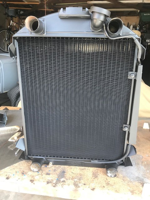

    Back on the roadster...I carved out some time to mock up the radiator and I couldn't be more happy with it.
    After some t******* of the bottom bar, locating and drilling the mounting holes, it fitted like a glove.
    The overflow tank on the p***enger side fits right at home. Br***works sure does some quality work.

    Measured back 6 1/2" from the centerline of the radiator holes to help find a location for the water pump mount holes and it seems to be in the right location.
    The engine is close to center and close to level, front to back. Still adjusting my level side to side. Frame is level.
    Using a spacer at the transmission mount to compensate for the rubber mount.
    It is looking VERY VERY tight in there,
    I am trying to get the engine fully leveled while trying to keep the water pump mounts as flush to the frame as possible, as pictured. Right now the sweet spot appears to about 1/2" below the top of the frame rails. I am adjusting the transmission to see if I can gain some height.
    As pictured, I am 1 degree off from level, at the top of the block
    The transmission is as high as I can go, without creating an issue with the level of the rear end., using the 3+ / 3- method.
    I am so closed to the frame that I will have to custom made mounts, maybe scoop out the frame some to fit them properly.
    The Vega steering box is not in yet and the room for the lakester headers is looking very confined. Those Gear Drive headers are walking a thin line....
    On a positive note, I still have some room to the firewall. :) But I am yet to measure my distance from the fan to radiator.
    The water pump outlets line up pretty good to the radiator, as the engine sits now....

    I raised the frame to the final rake, ***uming 16x550 tires in the front and 16x750 tires in the rear. That made a huge difference. I was working with a leveled frame before
    The rake on the frame forced the front of the motor to come up. That put the feet of the water pumps above the frame. Engine mounts mounts will be flush to the frame.
    Water pump outlets and radiator's are almost in line. The water pump outlets are about 1/8" higher than the radiator.
    I pushed the engine back and now have between 7" to 7-1/2" centerline to centerline from the radiator mounts to the water pump mounts. I might go with the 7-1/2" as final measurement.
    7-1/2" helps me get 1" clearance between the radiator and the fan blades.
    In the rear of the block, I have 2-1/4" clearance to the firewall.

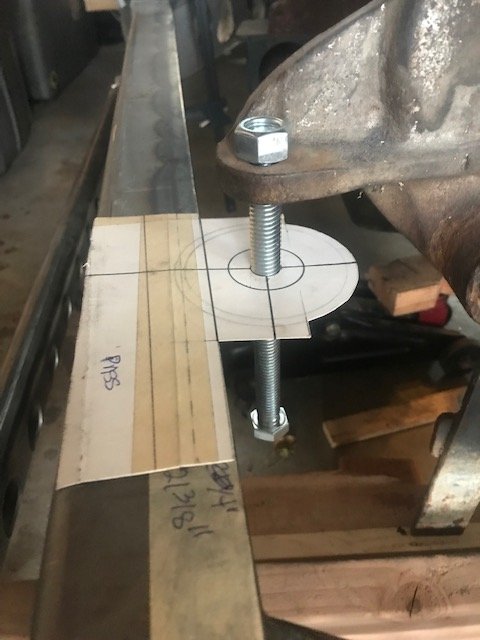

    I made some cardboard templates to have an idea of the angle for cutting the mounting brackets. Measure a lot times and cut once...I don't want to mess up the cut and have to buy new mounts again.
    Everything is looking good, so far. With the new location, the Vega box seems to clear fine. I still haven't tried the headers on for fitment.
    Hoping to start cutting and welding on the brackets this weekend.

    All the paper templating, measuring and cutting once is paying off. Tomorrow or Saturday I will be spot welding them in place. Just ran out of time this afternoon.
    7 -1/2" ended up being the magic number between the radiator mounting holes and centerline to the mounts.
    2-1/4" is my clearance to the firewall.

    Might want to throw whatever exhaust manifolds or headers you plan on using on that as well to see what they will interact with. I used an F1 steering box on mine and had to push the motor over to the p*** side as much as possible with the mounts in place and got about a half inch clearance on the steering column. You may have no problem there with the vega box but should check your steering mast as well. I think my motor is about 7 inches from the rad. mount holes and I have about 3/4 inch clearance from fan to rad.
    oliver westlund, loudbang and brEad like this.

    Thank you. That is a good advice!
    Room is very tight in that area. As is, I think I will need one or two universal joints to connect the steering to the box.
