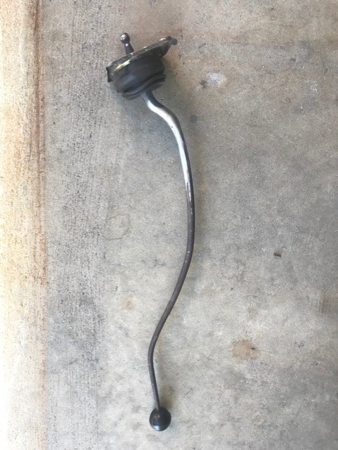

    Went to the junk yard and pulled an aluminum driveshaft and S10 shifter. Best part of it, the parts where already removed on the side of the truck and waiting for me.
    Felt so good to be back at the junk yard with my dad today, brought back some good memories...
    Back in the days, many years ago, my dad and I used to go almost every weekend looking for VW parts, and was one of those things we used to do together...Back then, I wasn't too eager to be there but today, as he is getting older and reaching up in years, I found myself wishing to hold on to the day and for time to stand still....
    I will be cutting down the driveshaft later on. I figured a lightweight driveshaft would be a good thing.

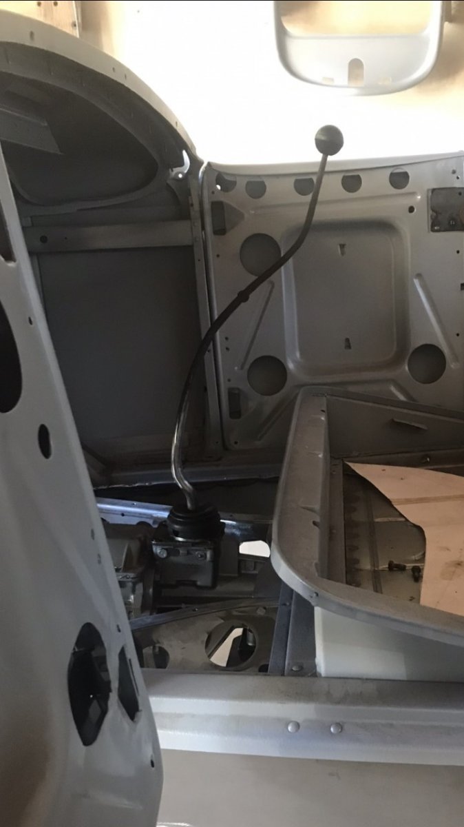

    ...Started work on the shifter
    Cut opposite halves on both shifters to have more meat to weld on
    Too lazy to get the bottom seat from the rafters, so used a couple of sticks to mock up seat height
    Clamped both halves together once that I found rthe ight angle and clearance when shifting.
    Not the prettiest welds but enough material to grind down smooth and blend.
    Made 2 holes on each end of the halves to pin it and ensure both halves won't come apart, even if welds brake.
    Almost done. Just need to grind, smooth out and blend them.
  5. Shifter is done for now. Happy with look and height of it.

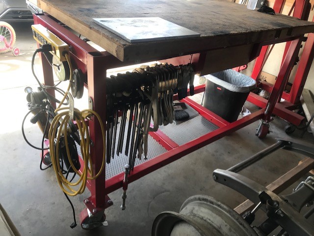

  7. Happy New Year!
    The roadster was put on hold the last month or so of year as work got on the way.

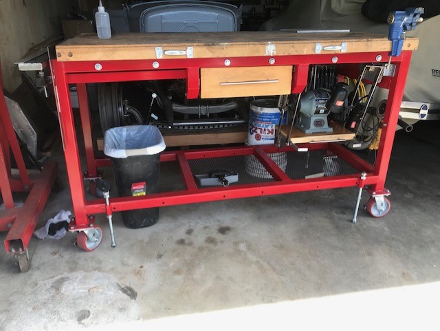

    I also decided to work on building a decent workbench table that took much longer than I expected...and still is not finished :) I am still missing the top. You can still see my old top on it.
    Most ideas came from google and YouTube but so far very happy with them.
    The workbench I had before was made from a an old front door and the folding legs had come from from a broken party table that I found on the side of the road...It was terrible for welding, caught on fire a couple times, and even worst if I wanted to fabricate something.
    This new table will have finish dimensions of 72"x 32". I decided to go with a 2x2 frame and 6-1/2" casters to move it around easily. The plan is to add a 3/8" or 1/2" metal top to it.
    I had an old kitchen rev-a-shelf bracket meant for a blender which I re-purpose to hold my bench grinder.
    I added a space for my grinders on the side and clamps, plenty of electrical outlets so I don't have to be dragging extension cords and even a side extension that expands another 24". Metal mesh makes the bottom shelf and since my floor is not the most level floor, the bolts on each corner now help bring it to level.
    I left a side open so I can pull up a chair and weld sitting down.
    I am still planning to ad a bracket my 6" vice that is in the other side of the garage. Plan is t be to remove it when not in use and keep the top completely cleared.
    I am still debating the thickness of the top...Got a smoking deal on a sheet of 1/4" but I think is too thin and I am afraid it can warp. Also a good deal on a 1/2" sheet but too damn heavy to move and too thick to cut to size....I am leaning towards 3/8'. More expensive than 1/4" or 1/2" but easier to move around and cut.
    So far I am happy with and not a bad deal for $200 worth of materials, not including the top

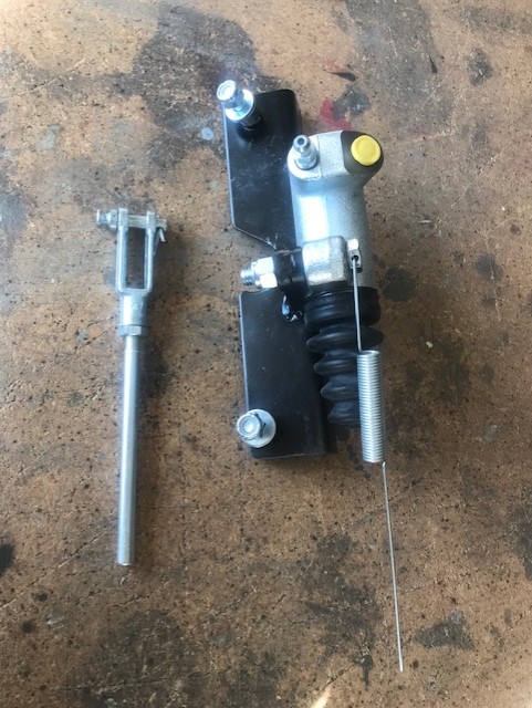

    I added the handbrake using the Limeworks T5 brake. I am using a Lokar trans brake.
    I really was hoping to use a pistol grip style hand brake since I hope how those look but couldn't find one that fir the body right. I settled for the Lokar
    Next,I built a frame of 3/4" square tube with a piano hinge the middle. My goal is to be able to remove both pieces at once. I used the same bolt locations as the wood panels have. I will sheet it later.

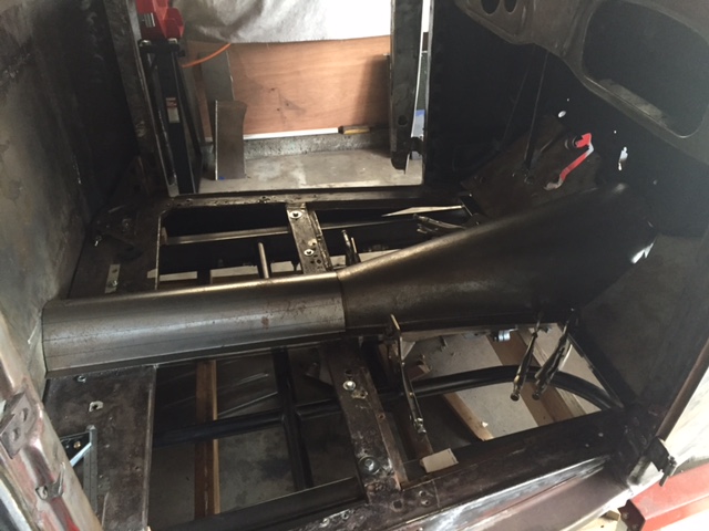

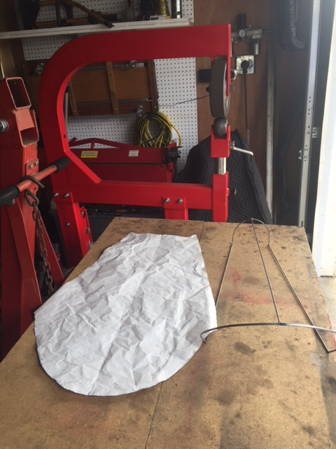

    Here comes the cardboard again :) I want the bead rolls to match the rest of the floors I made but I will get to those later on, once I have the brake & cutch master cylinders to make the access panels for it...

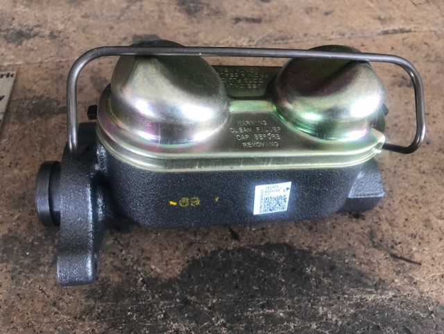

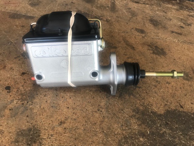

    I ended up buying the set of master cylinders from Gary at Cornhusker....Great guy and willing to help.
    As for the trans tunnel I went back and forth trying to decide the best way to get it done. I want to use either the Lokar shift gear and brake boots or the original Model A rubber boots, so laying out the distance between both was important. I ended up not using the spacer the hand brake came with to gain more room in between. I made my own spacers
    Cardboard templates again to help lay it out.
    Last time I built a trans tunnel for my '36 truck, I used the english wheel. I think it was right for that build, especially cause I had never used an english wheel before, but not for this Roadster
    I want something more low profile, rounded edges, almost flat on top with rounded sides and something that fits tight to the transmission.
    I opted to use a 2" exhaust pipe that I cut in 4's to have 4 quarter rounds. This should make the sides and the round piece in the back.
    The round piece in the back will be the most difficult to make, for me at least...so I am starting with that, sink or swim, let's see if I can make it happen.
    Cut pie cuts in it and ran it through the english wheel....Not bad, thus far, but a long way to go,

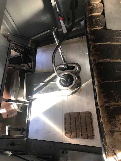

  25. Had some time to spend on the roadster this weekend, so I continued working on the trans tunnel.
    Finished both the shifter and handbrake pods. Same method of cutting a tube in 4s, slicing it every 1/2" to make the round turn, weld and sand it.
    Added the lid for both and started to figure out a way to join them at the right location.
    ...Still a lot of work to do but starting to see the idea come together....Still need to cut it to the right length too.
    The white cardboard rings should be the same dimensions as the Lokar universal boots's chrome rings. Plan is to paint and pinstripe it the tunnel to the same color as the body, and let the carpet come up to it...at least for now, that is the idea.

  27. Trying to squeeze minutes out of the day to work on my roadster.
    I was able to do some cutting and trimming and very pleased with the outcome so far.
    First dry fit
    Time to start trimming it to the right length and start adding the flange.
    Another 3/8" hair cut and will be right where I want it.

  29. Another good day...got to finish the trans tunnel, other than some final finishing, the shape and size is all there.
    I started installing the brake and clutch master cylinders.
    I got these from Cornhusker. pretty happy with the way they installed and the way they look
    Got them mocked up and in place.
    Another cardboard template for the floor and access panel
    Transferred to my final template and I should be ready to start cutting it out of metal and start bead rolling. it
