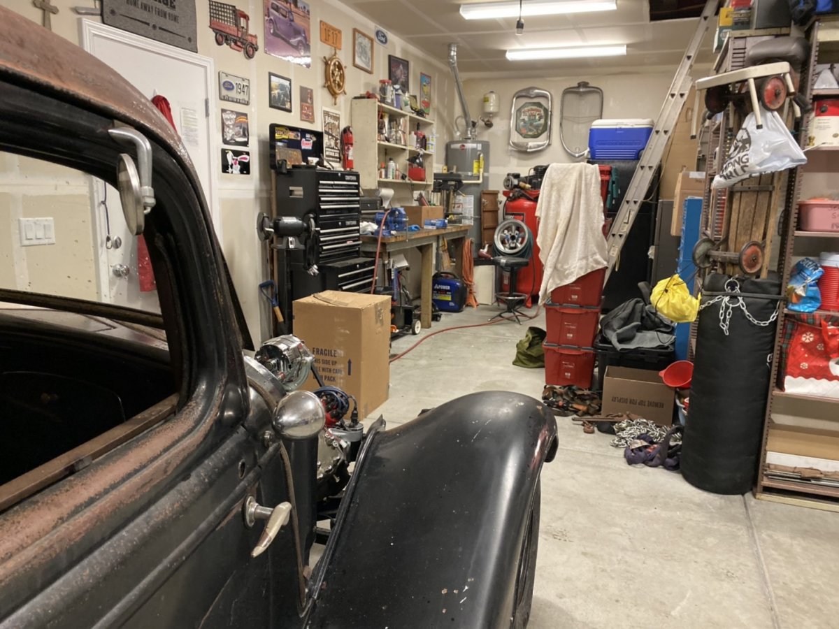

    My garage is starting to look like that!
    And the car is still mostly together!
    Thanks for the tips! IMG_7695.JPG IMG_7696.JPG IMG_8043.JPG IMG_7808.JPG IMG_8046.JPG

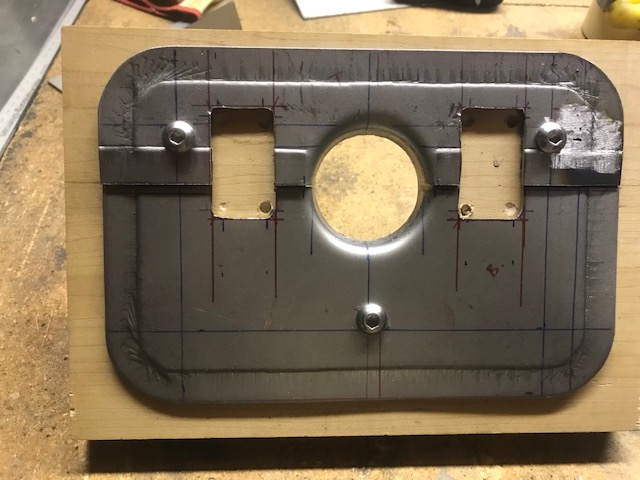

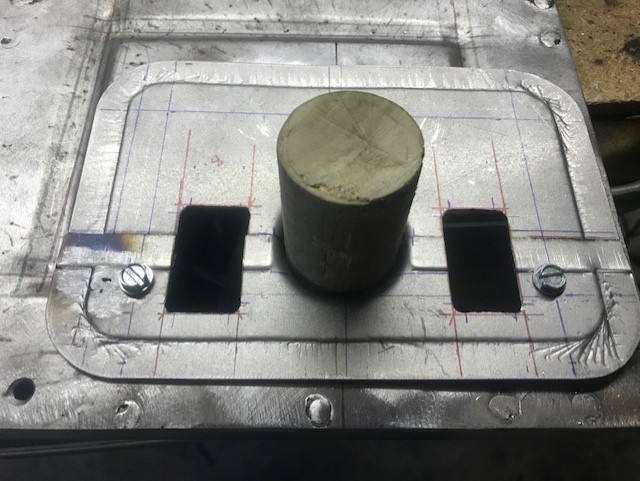

    You know that feeling when the day is almost over, you are dog tired ,and you can stand back, look at it, and know it is almost done?
    That's how I felt this afternoon. Cracked open a beer and just enjoyed the moment.
    Not bad for being only my 2nd time doing a trans tunnel....and feeling happy
    Wanted the lid to have the same beads so everything look like one piece once installed.
    Rivet nuts in each corner. The bolts will be replaced at final ***embly. I plan on using stainless steel ****on allen heads through out the entire car.
    Not bad! I really like it.
    One piece ,with a hinge in the middle. Easy to remove.
    I ran out of rivet nuts to secure the tunnel in place...
    I am sure once I get the steering column in I might have to trim back some material.
    Very low profile and round edges. Just what I was looking for. The boots will give it a nice touch
    Easy access!
    The best part of this project is being able to look back on it and realize that I made it.

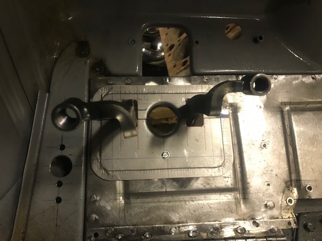

    Pedals found their location. Just need to get the final hardware and can move to he lines.
    I will have to wait until the body is off.
    Steering column might be next...
    Pedal studs in the back are 1/2"-18 thread. There are 3 different sizes in the market...found out the hard way

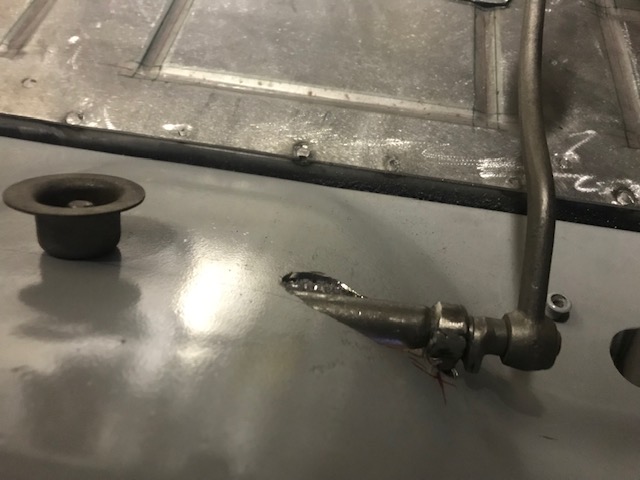

    Spent last few days researching how to install the accelerator pedal. I knew I wanted the s**** pedal but had no clue on how to get it done.
    I found member Lodaddyo's thread and really liked the way he got his done (picture below) so now, I had a goal in mind. I really like how clean it looks.
    I had to start by figuring out how the pedal mounts and how it works, so I used a quick metal template to get a better idea. I started with a '36 pick up pedal...luckily I had a complete set up.
    I learned the spring puts a lot tension on the return and having the pedal stick up high like that, is normal, until it gets connected to the carb with the linkage rod... :) then it will drop down to a more useful angle
    Lots of measuring....finally my the first set of lines.
    The arm will sit level with the top of the manifold. I am using a two carb Offenhaunser manifold and the ball in the arm of the pedal will line up with the connecting ball in the carb. Hoping for no binding.
    3 holes and some grinding later the pedal was in
    The pedal was fitting nice and tight. With the one bolt and the pressure against the firewall, I might have not needed a connecting point on the other side...but better safe than sorry.
    With no easy way to mount the original hood on the other end, I decided to build another knuckle same as the one next to the spring...just some tubing with a cut off bolt.
    Split it down the middle and re-weld so no need to take the pedal apart.
    Another hole later, it fits really nice, works super smooth and not going anywhere now.
    Pedal is nice and flush against the firewall
    Very pleased with the way it looks in the inside. I will be adding a foot rest later
    Planning on taking the same idea of the original cover and make something similar to cover the shaft from the outside and keep moisture out...we'll see what I can come up with
    And there it is...After all the dust settled, I went back and noted the measurements I used to make it work...maybe somebody else can find them useful

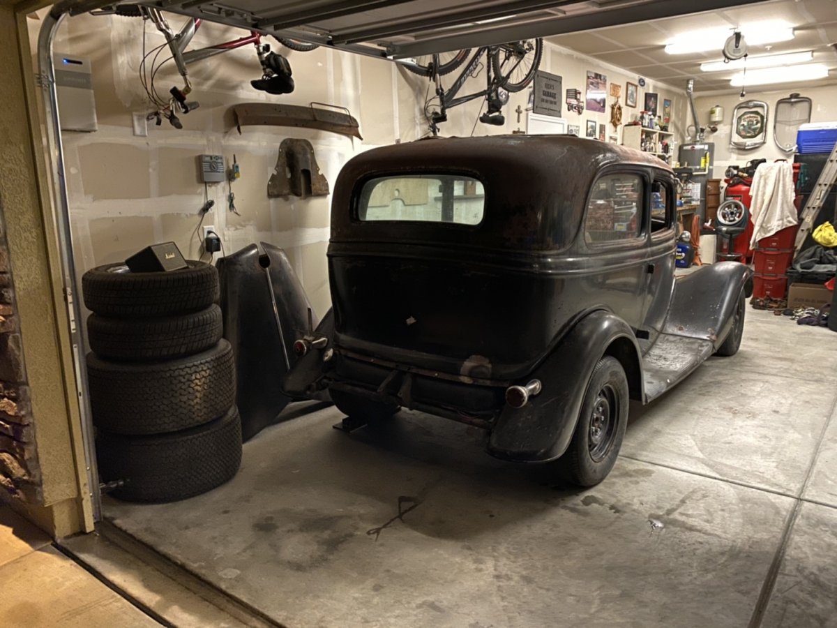

    The '29 found a new home.
    Mixed bag of feelings...I wasn't quite ready to sell but really needed the space back in the garage and at good chuck of profit, it was the best decision.
    When on a shopping spree right away :)..more parts coming soon!

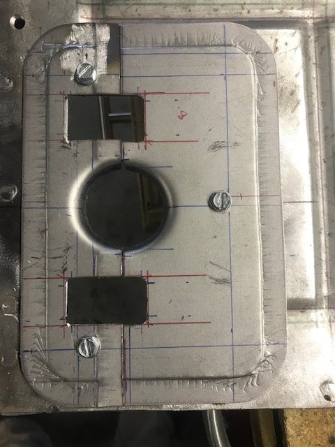

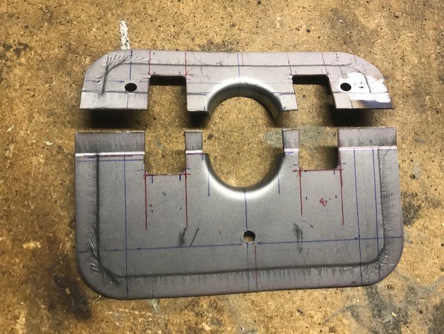

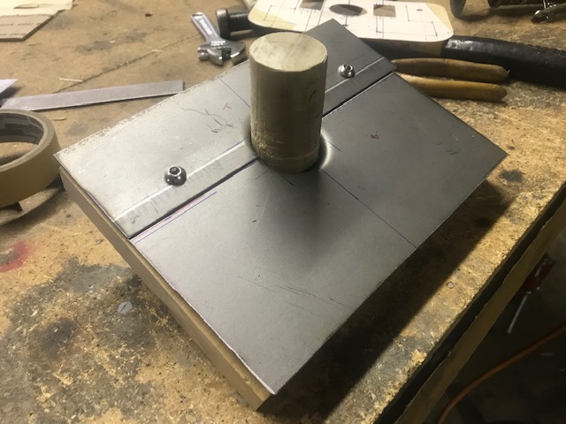

    Started working on pedal covers. First made a dimple hole for the 1-1/2" column with two pieces of wood and a wood dowel
    I cut two halves to make one. This way it can be installed as two pieces.
    I still have to spread the pedals apart some, but it is starting to take shape....

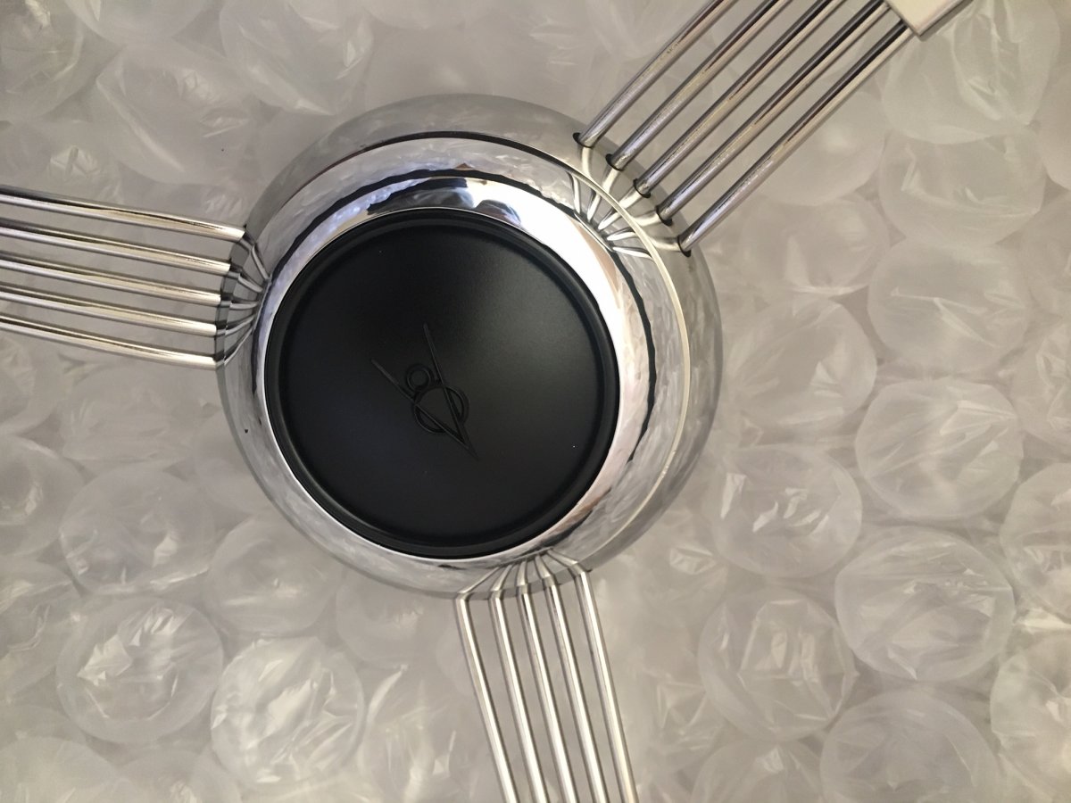

    What'cha thinking about for a center cap on the banjo? I have been told a Model T hub cap fits real close. I was going to try that when I get my 31 out of storage and back in the new shop one of these days:(

    I've been thinking about that one for a while but haven't made up my mind yet. I was not aware of the Model T option...I will look in to that one.
    In a perfect world, I would like to use the '37 horn ****on, but all the searches I've done, on how to make it work and be able to use the Limeworks steering column wire, have come up empty handed
    Maybe if I can find one cheap enough to play with it, maybe I can come up with something that works.
    I might have to settle for the Limeworks V8 ****on and call it a day. Not my favorite, but at least I know it works. That's what I used on my '36 truck.
