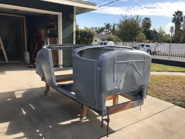

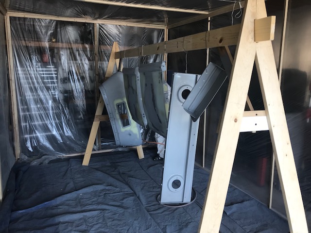

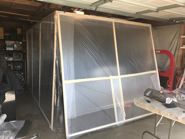

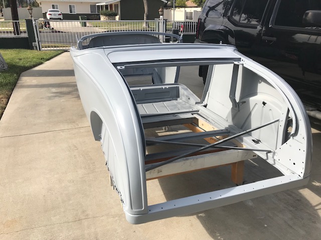

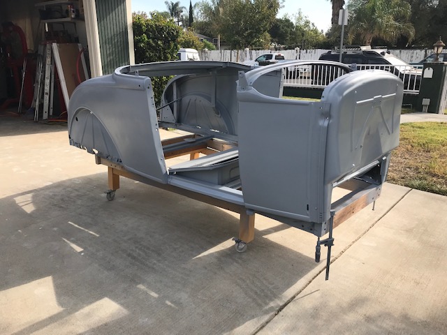

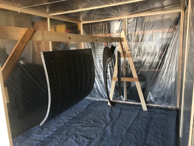

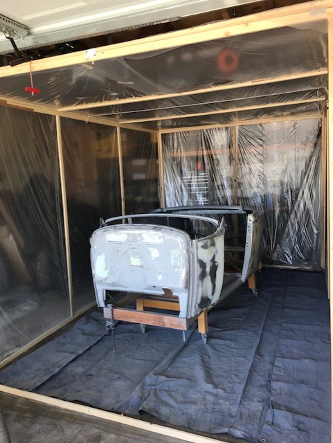

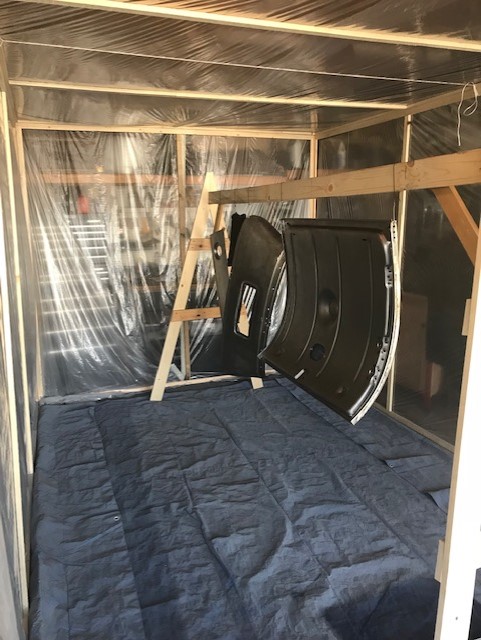

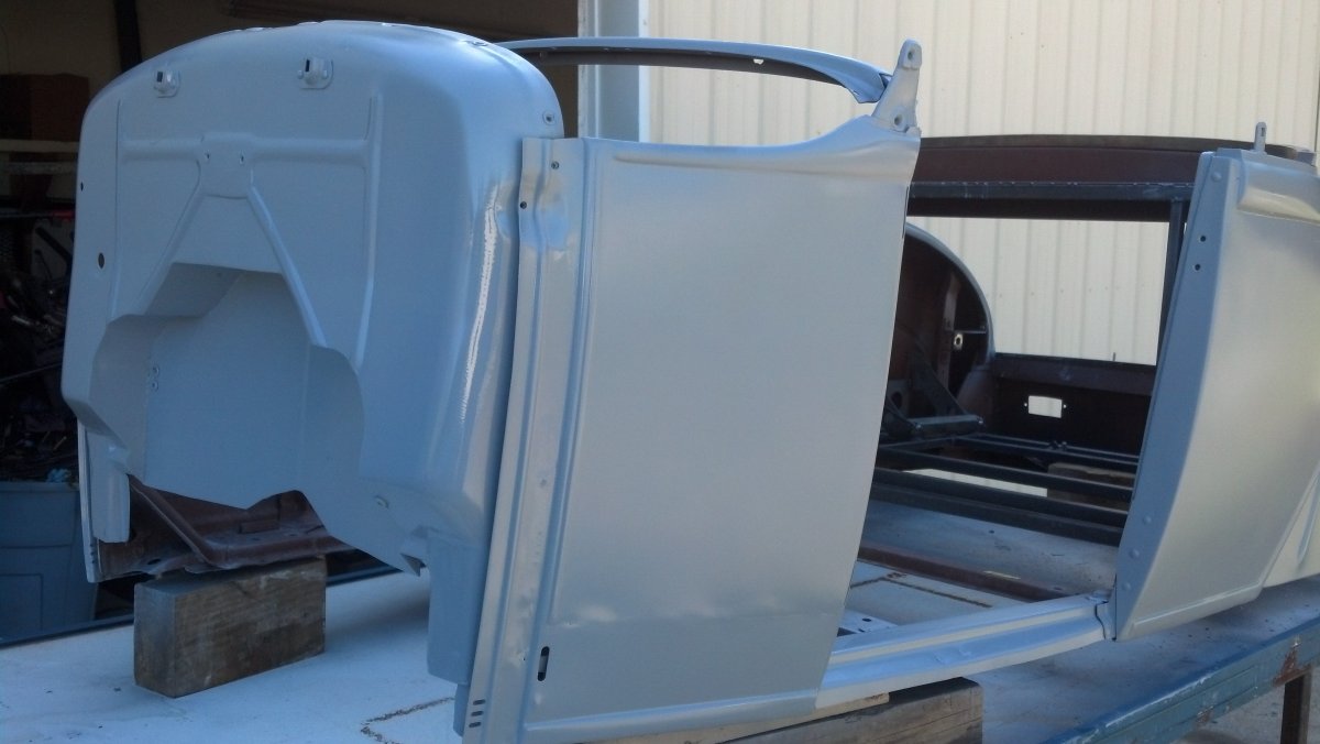

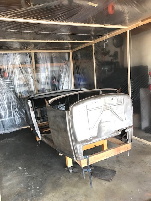

    Time came to spray some epoxy primer. Got the body repair as much as I could without having the frame here.
    Didn't want the body to oxidate or start rusting. The rear wells and corners still have to be repair but rather have the frame so I can fir the rear subrail, at the same time.
    I didn't want to over spray the entire garage and paint all the floor, in the process so a quick trip to Home Depot, a few 1x and a roll of plastic did the trick.
    I can easily dissemble and re***emble the box as need it, which will come in handy for the rest of the spraying.

    I used SPI's Epoxy Primer. Mostly, because when I bought the car it came with 2 new gallons of SPI's primer that the previous owner had bought and wasn't used. I want to use the primer, to keep my cost down, so I used the same epoxy primer to keep everything from same brand and avoid paint reactions down the road.
    I read good stuff from Southern Polyurethane and my local rep was very helpful too, so I feel like made a good decision.
    I also bought from Eastwood a DeVilbiss Dessicant Snake, since in the p*** I had issues with moisture in the line, despite having filters and all. This Snake made a huge difference.
    The epoxy primer came out so smooth, it even had a sheen to it, almost looked like paint.
    All parts are now coated inside and out and can start doing some bodywork.

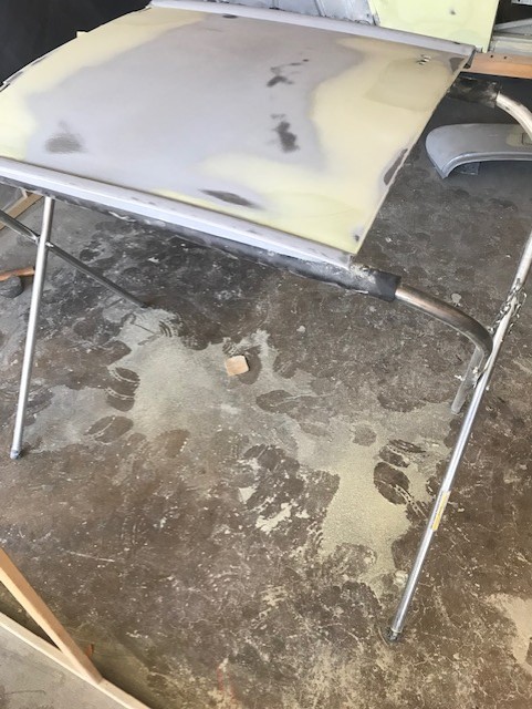

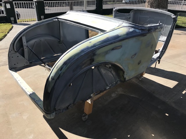

    Time came to start some bodywork. I will soon be adding cost for the materials I am using.
    Since the frame is not here I am only doing some light bodywork and mostly to the panels that I will not be revisiting/cutting/welding later on or removable panels like the fuel tank, doors, decklid.
    As I said before, this is the part I dread the most. In my past experience, bodywork and I don't see eye to eye.
    After lots of research, watching videos and asking plenty of questions I decided to use Eastwood's line of body fillers, a set of dura-blocks and 3M as a guide coat.
    I opted to do a thin skim coat over the entire panel or area with the contour body filler and block sand, and block sand, and block sand some more...did I said block sand.
    Once I got it to the right point I used the guide coat to show me the way to a straight panel.
    I got to say....I am getting a lot better at it. The body filler makes a HUGE difference and it feathers really good. This thing is made for first timers like me :)
    Even though there is a lotto sanding the material cuts quick and easy. Because I am doing a thin skim coat on most of the panels, a big percent of the material ends on the floor but ending on a straight panels and no waves in it.
    The Dura-blocks are also great to work with. I bought them from ebay and the seller sent me the wrong blocks (Velcro style) he then sent me a new set (PSA style) and let me keep both sets for the price of one. :)
    These things are awesome!

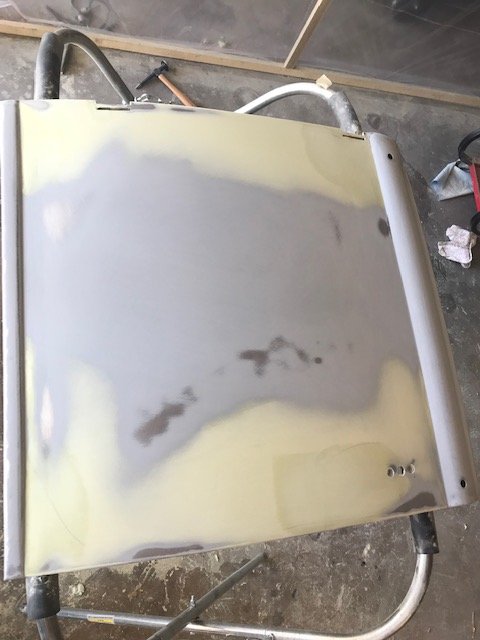

    Remember the re-skin doors I did?
    They looked pretty damn straight to me but guide coat said different.
    This is after blocking the guide coat after applying over the epoxy primer.
    A quick skim over those areas and some good block sanding and now they are really straight.
    Most of the material on the floor and very little material on the door, the way it should be :)

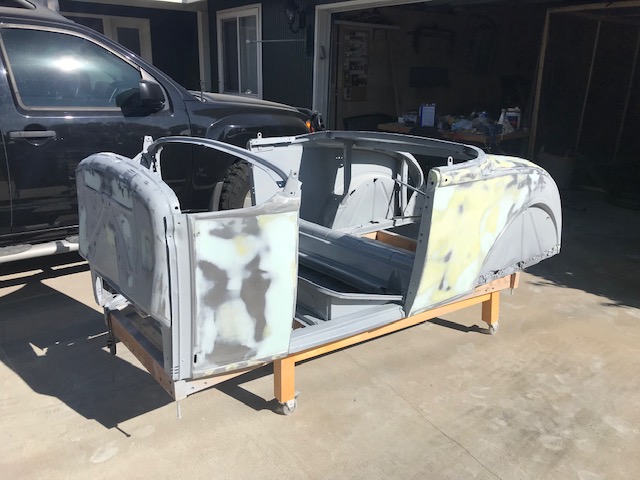

    I continued with some body work.
    Couple lessons learned,
    1) Use a respirator when sanding the body filler.
    I learned the hard way. All of the sudden I started feeling like **** and though it was a cold. Turns out allergies to the dust. Nothing a Benadryl and a respirator didn't took care of
    image_22079.jpg 2) Second lesson learned. Add enough hardener cream. I did a beautiful job on the rear quarter panel with full skim coat, just to comeback 24hrs later and find it still soft. It was not fun take it all out and redoing it again.
    Now I mix smaller amounts of body filler to ensure I have the correct ratio to hardener.
    Only one way to learn, by making mistakes
    Car looks like zebra again but coming out very straight. A very thin of body filler is doing wonders. Happy with results!

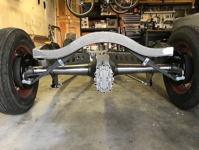

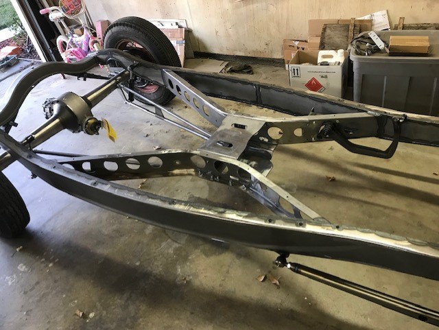

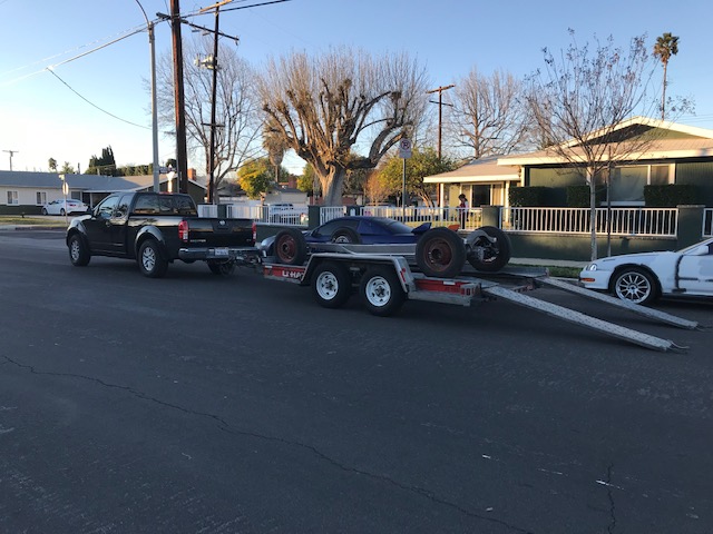

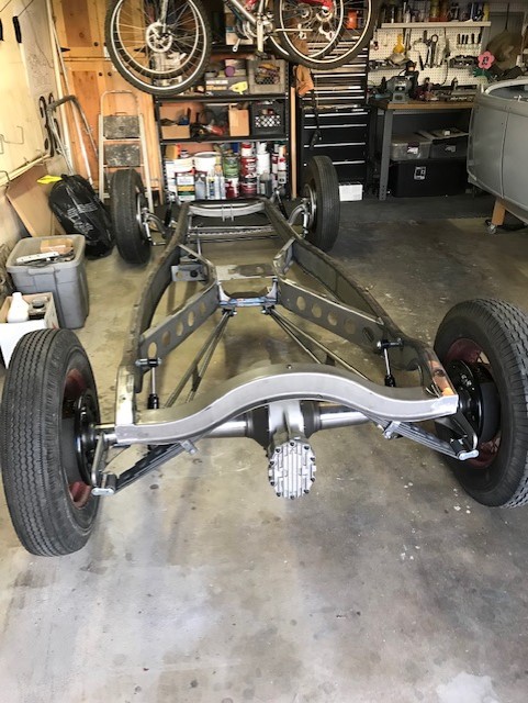

    I took a drive a to Bakersfield yesterday to finally pick up my frame.
    First impression it looks better than I expected it.
    Some of things I wanted were overlooked which force some changes to the final vision...more to come on that later

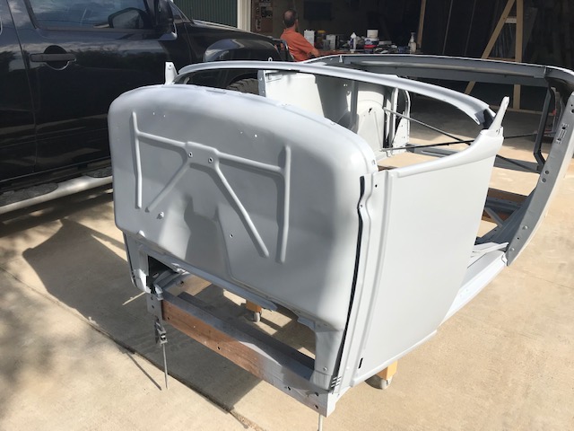

    After some more body work I sprayed another coat of epoxy primer to keep it all covered and away from moisture all the final bodywork will be done once body is mounted and all the rest of the work is done.

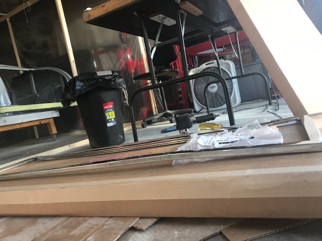

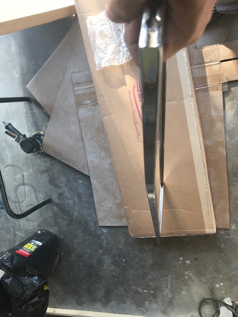

    Giving credit where is credit is due....I like the feeling of getting new shining parts! I ordered my 2" chopped windshield from Speedway and received in a couple of days.
    Unfortunately, below is what I received.
    Besides being damaged ,it is the wrong part....At least I had part of a '32 for a little bit of time :)
    Speedway's customer service was awesome. In no time they sent me the right part and picked up the wrong part.

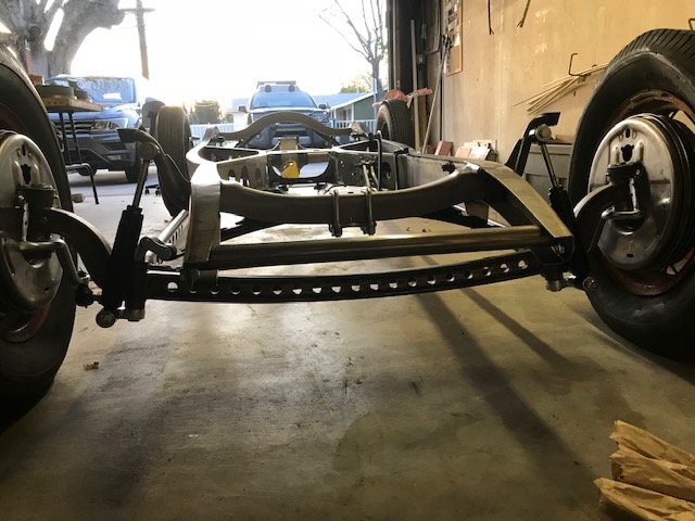

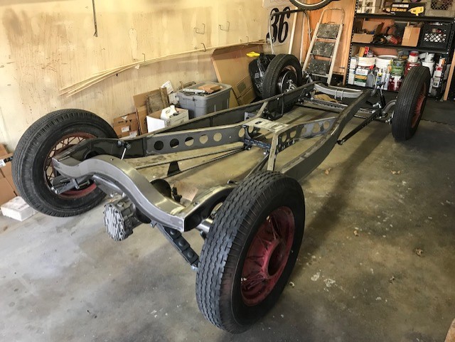

    So the new frame required small changes to the original plan. With all the time that elapse between the order and fabrication, somehow the rear end came with newer brake drums and not the Buick drums that it was supposed to.
    The wire wheels will not fit the newer brakes without 1.5" adapters so I decided to go with 1940 Ford 4" wheels in the front and '41 Ford 4.5" on the rear.
    The 4.5" make feel better in the rear since I apply to use 750s and should avoid some of the balloting look on the tire.
    Sold the wire wheels and now waiting on the other wheels to get here.
    The c-notch on the front was also forgotten so the frame might not sit as low as planned.
    I am still very please with the frame and can't wait to sit the body on it. I love the look of the quick change and I think the the brake and clutch pedal should make for an easy set up.
    I soon will start figuring out mounts for transmission and engine
    Next up I will post updated cost for you to see :)

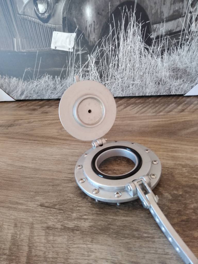

    Here comes some jewelry....Outkastaluminum, a HAMB member here, built this Halibrand style gas cap.
    This thing is awesome! Outstanding craftsmanship and Robert is a great guy to do business with.
    I will be partially recessing this in the panel above the deck lid. and connecting it to the fuel tank below.
    ...more to come on this later... IMG_20190127_161425665.jpg IMG_20190127_161443101.jpg IMG_20190127_161448920.jpg IMG_20190127_161509327.jpg IMG_20190127_161536685.jpg
