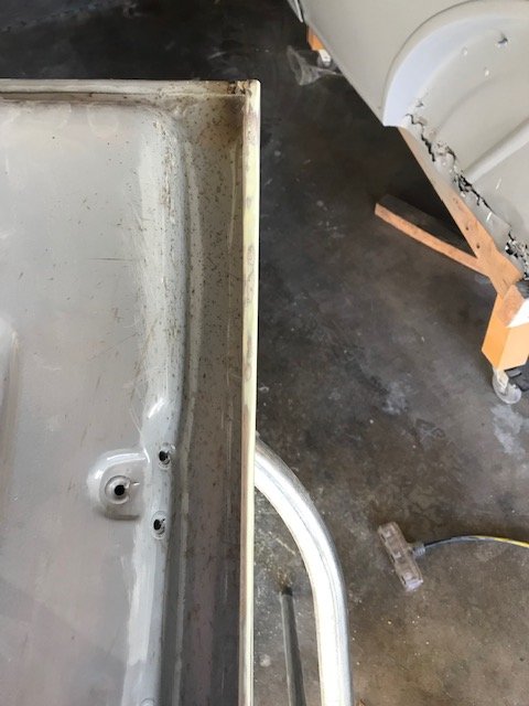

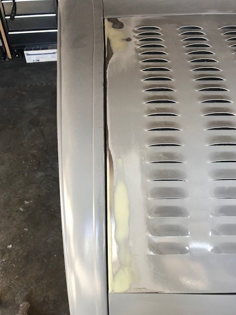

    Just before the frame got here I was working on the corners of the rear deck lid.
    As you can see the gaps at the corners inconsistent. The small piece of wood on top was my gauge and below you can see the pencil marks showing how much metal I needed to add to close the gap,
    I welded pieces of metal to create a wedge, which I later grounded to be one piece.
    From the top, once is all painted everything will be nice and flat. The only tell-tell is at the bottom, where the rolled edge is wider at the corners. You can see the taper edge.
    If you read the previous posts. Here is that difference from the straight deck lid edge against the curved lower panel. I will address that once I mount the body to the frame.
    Now the gaps are consistent from top to bottom.
    The gap at the bottom still needs to be re-worked on, but I will get to that with the body on the frame to make sure it doesn't move when fitting the body.
    Left side is already touching the bottom panel
    While the left side is about 3/16" or 1/4" gap

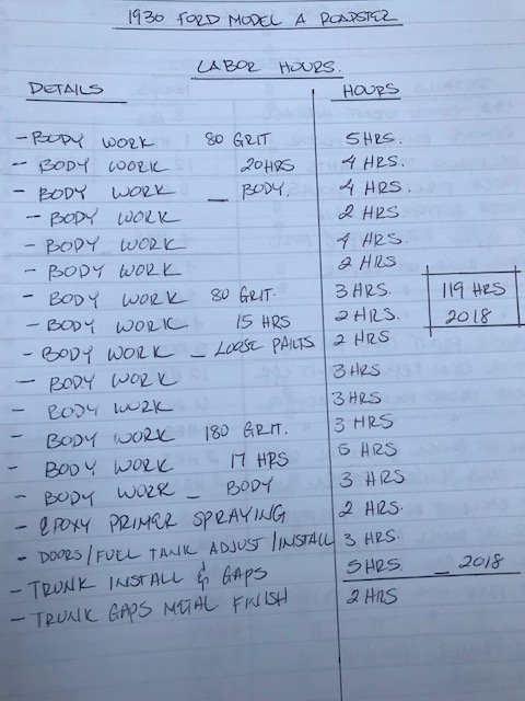

    Let's talk money!
    Funny thing while looking at ePay I saw a '29 model a for sale for $25k. It reads "Can't even buy the parts to build this car for what I am asking" Not p***ing any judgement just funny to me because that right there initiated this build for me.
    So where do I stand today,
    Painting materials $507.94
    $15, 921.85 in parts, including the body, frame and all.
    154 hours of work. Not sure how much a shop will charge for the hour but I've seen from $40/hour to $100+/hr. I am ball parking $50/hr. That puts me at $7,700.
    All and all around $24k so far.
    If I don't add labor as a cost then around $16k

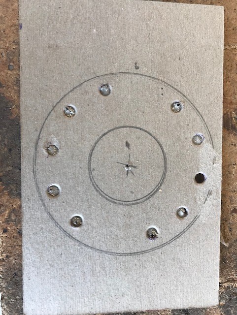

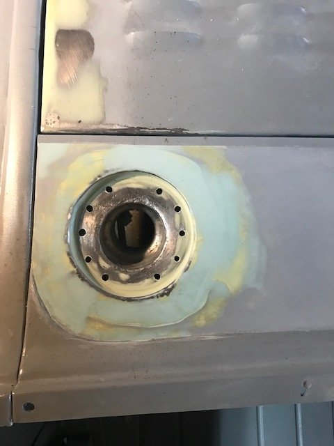

    With the little room that I have in the garage, I managed to start the recess cup for the fuel cap
    A quick template first,
    A hole in the panel above the deck lid later
    I only plan to recess it about 1/4" but left enough material to trace the curvature of the panel and trim to fit.

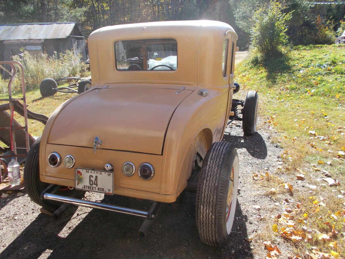

    I made the same tunnels, sunk them 2" … grabbed a '33-'36 tail light, set it in the tunnel, looked great...
    never seen it...
    love to have someone take the idea an go with it...

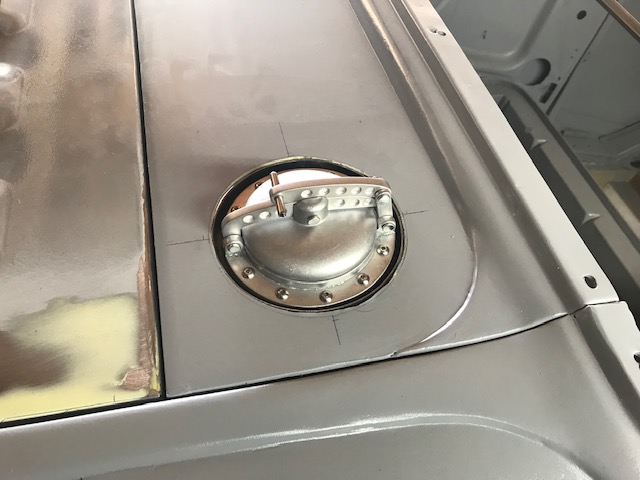

    Not sure how you plan to finish your recessed fuel cap, you might want to consider putting a drain hole in there. My 52 Jag has fuel doors in a similar position. Sorry I don't have a better picture, but there's a 1/4" tube in the bottom of the 'can' where the gas cap is. You can see the hinges for the doors in this shot P1030018.JPG

    Not much progress. Been traveling for work and very little time to play. Got the the recessed fuel gap done for now.

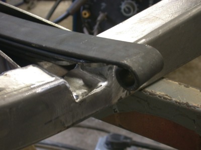

    The c-notch in the front would allow me to use a lower front spring
    This is what the c-notch on the front looks like. This picture is looking at it upside down.
    I didn't really mind loosing this, since the car is still going to sit pretty low as is and with the plan of using a cross steering set up and vega box I could use all the scrub height possible.

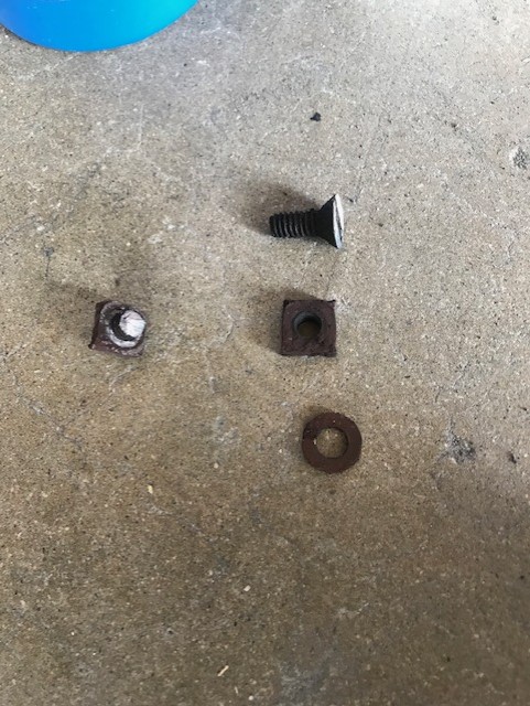

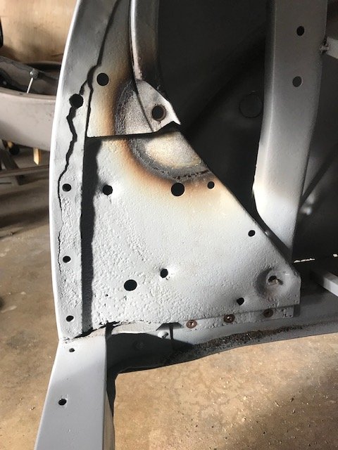

    First on the list is to remove the reinforcing corners....what a *****!
    The bolts I removed with a combination of heat, cold water and eventually a air saw.
    The heat and cold water worked very nice. Bolts came out easily.
    The rivets was a matter of using a center punch and a couple of drill bits to remove the heads off.
    A good blow with a hammer and a pointy chisel and out they went

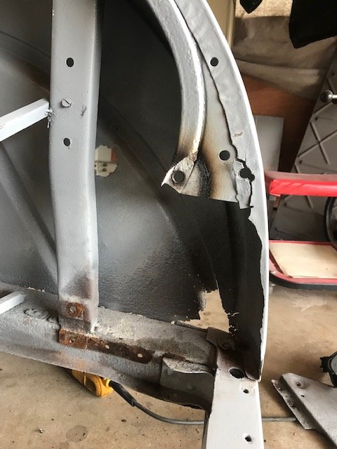

    The wrap around metal on the edge of the rear quarter panel was split open. An easy fix down the road. Took a paper patter to have a reference point to repair later.
    After a couple of hours of work, the corners were removed.
    I might be able to reshape and reuse the corner braces, depending on the curve of the kick-up in the frame or might have to fab my own.

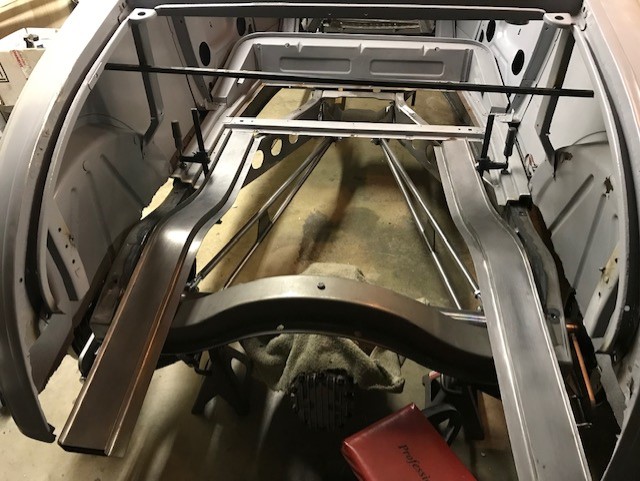

    I could get the body on the frame. The weather yesterday was rainy and couldn't get much done.
    A lot of measuring, day dreaming, remeasuring, but no cutting yet.
    Got my existing rails marked for the first cut, the frame level and found center at the drums to line up the rear of the body to it.

    Today, was a better day and got a bit more done on the car

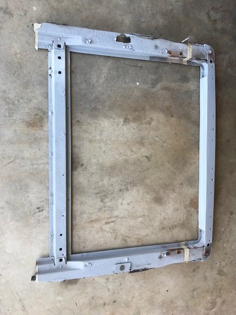

    I end up removing the rear subrails completely, as these were rotted badly.
    Spent a good amount time grinding rivets off from the rear crossmember
    Badly rotted all the way up to the rear crossmember
    A good amount of rust still came off the inside of rear crossmember and a good amount of sand too...I am ***uming from the sandblasting
    The curtain pan kept the body from sitting correctly on to the frame
    Damn! I was hoping to keep the curtain pan as I liked the idea of some storage underneath the seat.
    Clearly I can't keep it....It needs to go
    More rivets to cut...
    and off it goes to eBay!
    Looking better. Starting to find the right location for the body.
    Right about now I am taking me a long break...
    Looking at the back fully blown away, a very flimsy body, sub rails to be welded and mini channel to be done...it is becoming overwhelming. Can't help to think for a minute that I am way over my head.
    Off to spending sometime sandblasting wheels...I am sure that will get rid of the "oh, ****, what have I done!" feeling.
    I will regroup and start with the mini channel up front next.

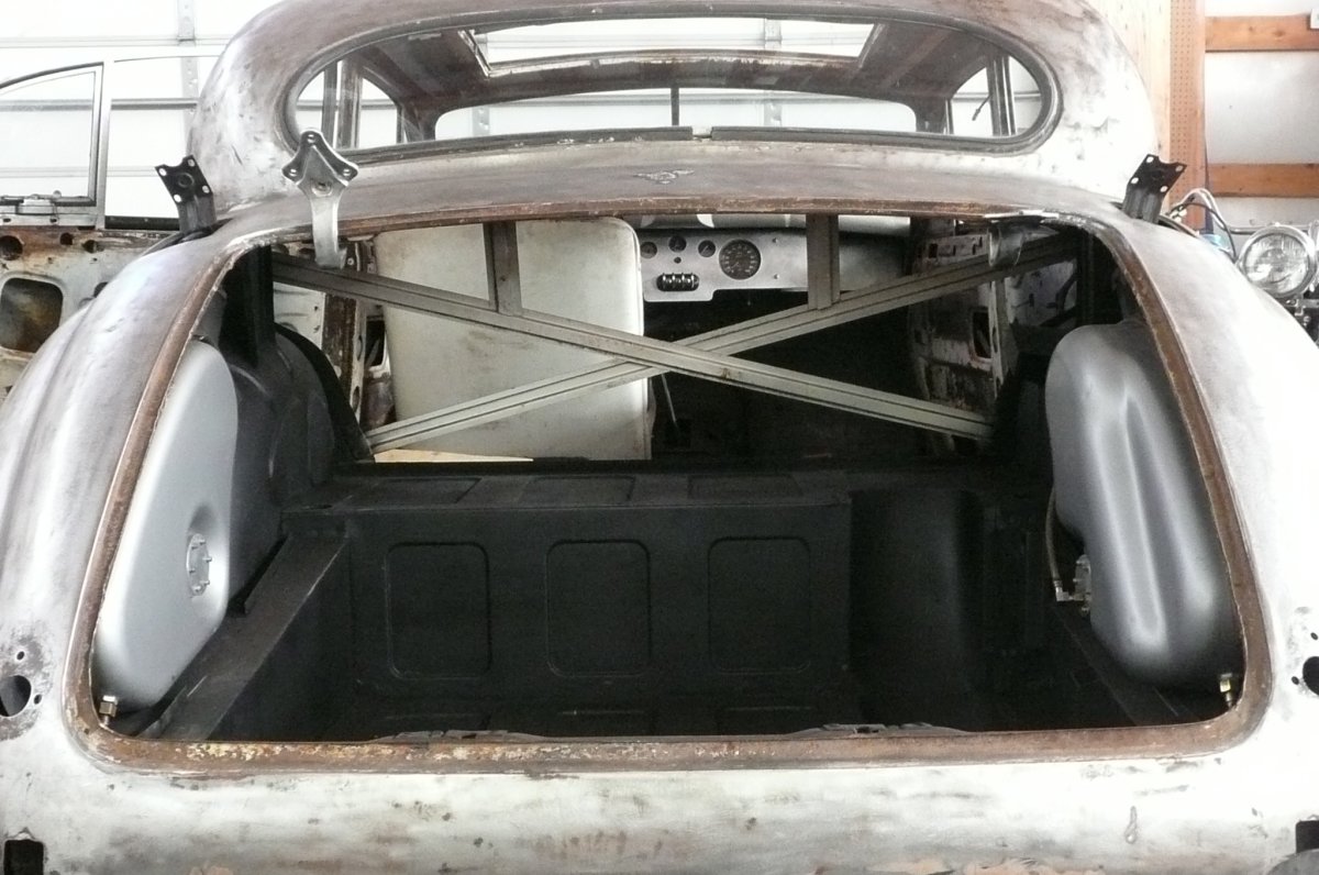

    whereinas your rear frame rails are cut off, and the coupe's rear body parts are not cheap...
    a pair of model A frame horns flipped upside down so that they flow downward like the tail end of the '32 then sort of curl upward [flatten out]… bolt in a spreader bar...
    ask your dr. or dentist if he has an old stainless pipe, 1"-2", that his stuff used to adjust its hight….
    my $0.02.

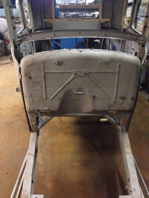

    On my A since the firewall was toasted I cut it out around the edge and made a new firewall. this allowed me to stretch the bottom of the cowl a bit to channel the body over the frame rails (not pinched). If I had a nice firewall I think I would have pie cut it to allow the stretch similar to what @Flop has done on one of his projects similar to this:
