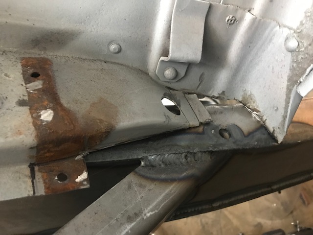

    Next on list the was fixing the fitment of the front of the body to the frame or do the so call mini channel
    After some research and looking at some photos, I was ready to go.
    The idea is to remove the gap between the body and the frame

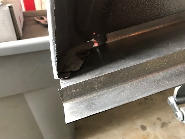

    First I removed the brackets.
    Removing them wasn't so difficult. I bought this air sander in CL for $10 and what a great investment it has been. Perfect to sand the rivet's head off to later strike them with pointy chisel and hammer.

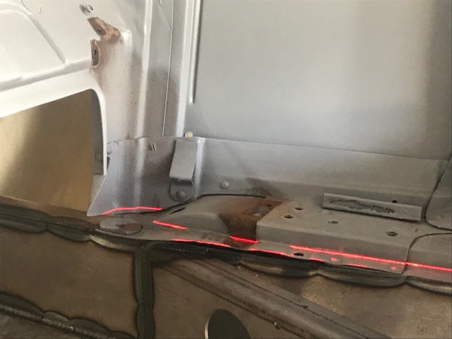

    With access to the area I could start tracing my cut lines
    I use da laser level to get an idea of what I was supposed to cut
    I traced the cuts to be made
    Cutting was relatively easy with this cut off wheel. Another CL score for $15
    The area is very tight so the long reach makes easier
    Here is the area all cut up
    It came out very nice; however, it was warm but not cigar just yet

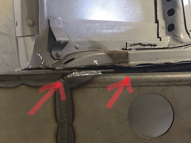

    There is still a little bit of a gap, right in the front....maybe another 1/8" to trim...
    The outside is almost there but some more shaving will make it fit better.
    That fold on the bottom of the cow panel is barely touching the frame, but enough not to let the body clear and come down as it should
    Unfortuantely, I ran out of daylight.
    The plan is to reduce the front foot a bit more by raising the cut of the subrail higher...closer to the bottom of the hole...
    That should give me the drop I need to be flat on the frame.

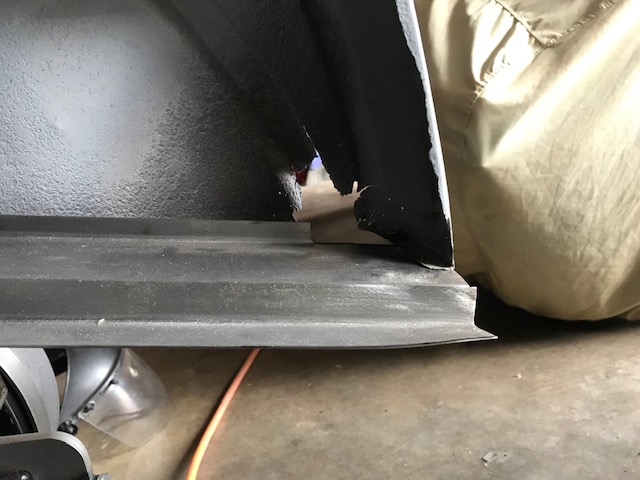

  2. Ok, round two, before taking my girls out to the park, so they too can enjoy their Sunday.
    Started by trimming the side of the body where the bottom of the cowl panel folds and it was rubbing the frame. Just a little trimming was needed
    BEFORE
    AFTER
    I recut the angle of the front and it allowed the body to sit flat on the frame thumbnail_IMG_4343.jpg
    Re-checked the center of the rear wheels...Money!
    Marked the body to the frame for future reference. There is no side to side movement.
    The body fits like a glove
    Looking back at the fat I shaved
    Made some templates for the fill in pieces. I will be using the nearby hole on the frame to bolt down the body.
    Looking back, I was hesitant to do this but it wasn't that hard.
    I was afraid that it was going to require more experience but even with my minimum experience I got it done.
    Maybe this week I will get to cut the filler pieces and spot weld them in place before traveling for work again

    Memory says the body to frame blocks "lift" the subfloor about 1/4" above the frame...
    didn't see your blocks...
    I put my '30 coupe on the '33 tube chassis that I built...
    I raised the front 4'of the frame like the '33s did... but my coupe subfloor was flat...
    I shaved the blocks, cut out about what you did...
    then used the front half of a pair of '35 tudor door patches for the cowl patches as they curl upwards towards the front...
    this kept my cowl skin even , not overhanging the frame...
    filled in what was cut away and used body to bumper brace brackets as front cowl to frame mounts...
    one split bumper mount makes 2 cowl to frame mounts...pic... [like '33-'34 trucks.] vvvvvvxxxx.jpg

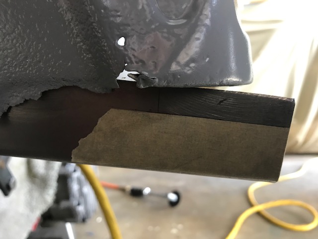

  4. You made a really good point. I forgot my wood blocks.
    I removed them before cutting all the metal, so I do have them and will need to modify them to fit the new contours.
    If I understand correct, the body will go up about 1/4" once the wood blocks go back on. I do have about 1/4" draping on the sides, which will put the body flush with the frame once the wood blocks are installed.
    Thank you for calling that out. I better get working on the wood blocks before welding the filler pieces since the front of the firewall feet will need material added.
    For the wood blocks, do I just need to reduce the height of them to accommodate the lower height of the body?

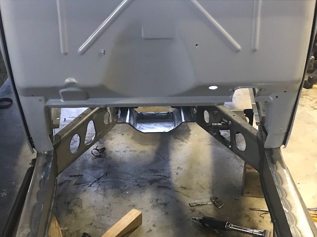

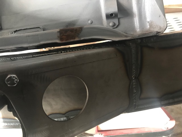

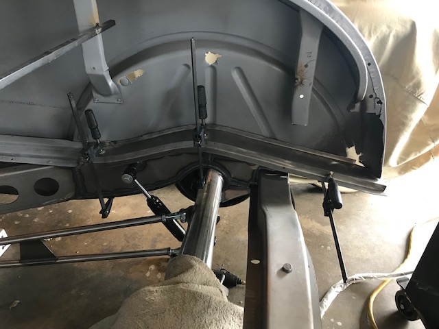

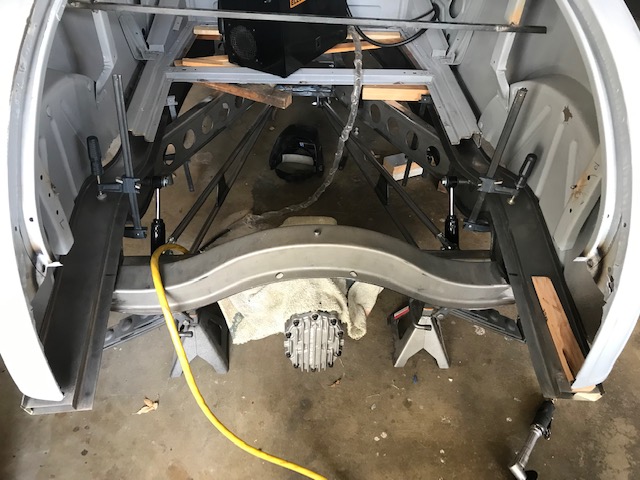

  18. Started to trace and fit the rear sub rails. These are Steadfast's sub rails.
    Good looking product but a bit steep on price. I can see how it can save a lot time and fabrication
    Started by setting them over the frame and below the body to get rough idea of where to cut them; after all, I didn't want to cut my +$500 investment in the wrong place.
    I couldn't really find many posts that would specify where to cut them or how to align them or what to look for, so I am trying to play it by ear and let the body determine the best location.
    The contour of the frame and the rails is not dead on exact, so they can move a bit back and forth. I found the best fit possible within the frame and bolt placement ,and then clamp them down.
    I was imagining that these sub rails were going to sit kind of centered within the frame rails and somehow align to the existing rails, well, that was not exactly the case.
    I started by cutting away some of the side flanges, to let the body sit over the sub rails at the back.
    After some minor trimming they dropped right in
    I marked the existing rails over the sub rails and cut them just a bit oversize. After some minor adjustments, they were fitting where I thought they felt really good. The inside of wheel wells were nice and flush against the flange.
    Using the panel below the deck lid as a reference, I sort of found the right width at the back.
    Nothing is welded yet but I think the passenger side is good for now.
    I still got the other side to do but in the meantime I have a few questions to tackle.
    1. Does the sub rails sit below or above the rear corners? Below the corners feels right; I am thinking of doing a slide cut on the back of the rail, and fill, so I can bring the sub rail straight, more like the original does.
    I am thinking if the subrail sits below the body., once I rebuild the corner I would have a base to bolt the corner down to.
    2. The rear crossmember. Because the sub rails are not the same size as originals, I am assuming the ends of the sub rails at the corners will need to be reworked to accept the rear crossmember?
    Well, that is for now. I am traveling for work all next week, so this a good stopping point.

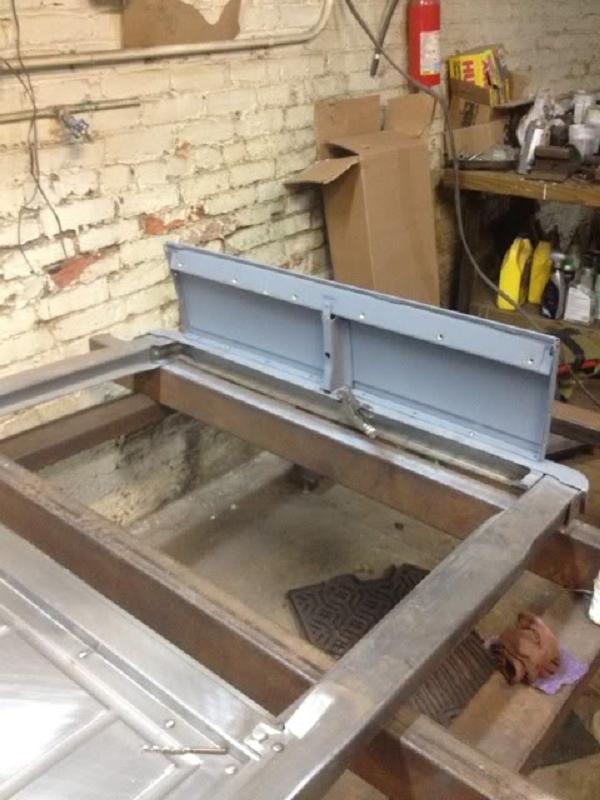

  19. lamaison
    Joined: Oct 21, 2006
    Posts: 145
    lamaison
    from Canada

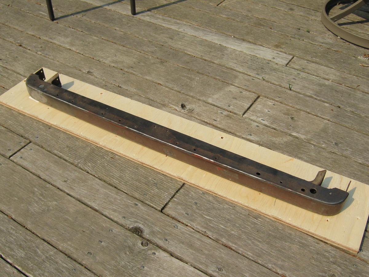

    Do you have the rear sub-frame cross-member and the panel below the decklid that attaches to it?
    EDIT NOTE: Since going back thru this thread I see you have all the original pieces - are you not going to use and attach
    the rear sub-frame cross-member to your new side rails?
    Model A - rear panel below deck lid #1.jpg SUBFRAME REAR CROSSMEMBER 005.jpg

  20. sloppy jalopies
    Joined: Jun 29, 2015
    Posts: 5,256
    sloppy jalopies

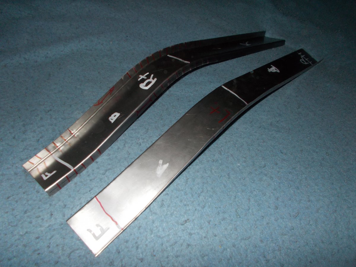

    Don't forget to use some wooden blocks or shims under the steadfasts…

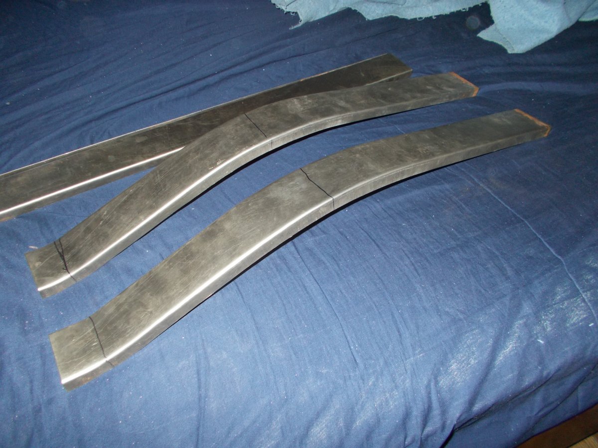

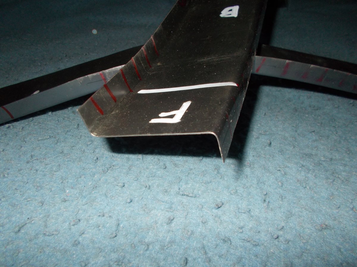

    any budget builders wanting to save a few bucks might try this...
    just made these with some 90*s, U channels, Z bent steel strips and a buddies shrinker stretcher... the U channels will also work as crossrails when installing ...
    I may slide a 90*s strip under the Zs to double the surface gauge, it making a channel over the blocks and still have the vertical to weld to the wheelwell... will also encapsulate the mounting blocks...
    at the metal shop the strips cost about $6 each... DSCN3960.JPG DSCN3959.JPG DSCN3957.JPG

    Any coupes I have messed with had a slotted crescent plate that riveted to the heavy rear crossmember pinching the quarter's rolled under rear skin to the HRC... memory ?
  22. HUGHES AUTOMOTIVE
    Joined: Jun 22, 2006
    Posts: 73
    HUGHES AUTOMOTIVE
    I'm using the same kit on my project Coupe. Tack everything and make sure your trunk lid fits before you weld it.
  23. I do plan to use the original crossmember but attaching it to the new sub rails is the part that I haven't figure out how to do just yet.
    oliver westlund and 1947knuck like this.
  24. That's how my roadster is and how the rear quarter's corners were attached to the crossmember.
    Well, more like rust was holding everything together but I could see traces of what you describe.
    I think my plan is to put a base plate to the rear corners when I rebuild these and use a bolt to secure them to the crossmember and then some how make a transition from the Steadfast sub rails to the crossmember, much like the original, to hold everything together.
    1947knuck likes this.
  25. When I saw your post on these it was too late for me, since I had already bought mine but I thought it was a really good way to make the sub rails. It would have given me a good excuse to buy a shrinker/stretcher too :)
    oliver westlund, 1947knuck and brEad like this.
  26. Solid advise. I can see how things can get out alignment really easy.
    Any movement to the body and the doors and cowl shift.
    Once I get some time to get back to work on the crossmember, the plan is to hang all the sheetmetal, check it, mark it and start tacking in place. Double check and weld it.
