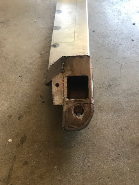

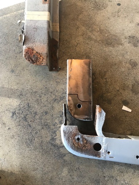

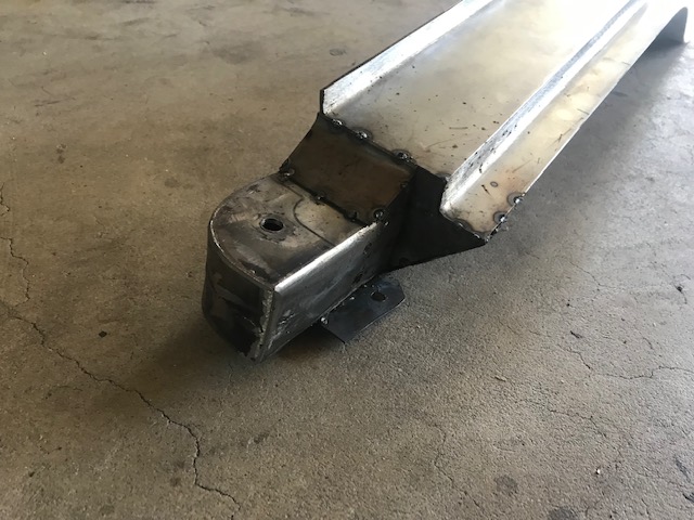

    Got some more work done on the crossmember ends. Using all the original attaching points on it. It should be nice and solid at the end.
    All together I have about 6 hours on these.
    Unfortunately, the welding part of it is what is taking me the most time...still not good enough at it.
    I am still struggling with weld penetration, speed and heat. I have what I think is a good solid weld but once I grind it, it cracks, showing penetration wasn't right. After a couple trials I get it right but it takes time.
    Good thing I have patience and have come to I love welding....
    My beads are getting better, not such thing as roll of quarters style beads....mine look more like loose change in my pocket :) but getting better
    Still need to properly squared the openings at the bottom.
    I made a base to prop the crossmember against the bottom of the car, since both corners are shot, and start tracing the sub rails to it.
    It should help while blending the two pieces together..
    Sub rails pitch down 10 degrees. and crossmember ends will come straight in to these.

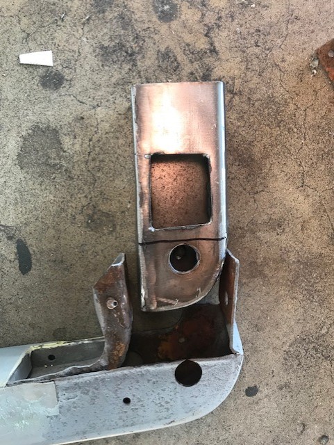

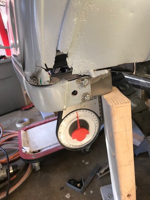

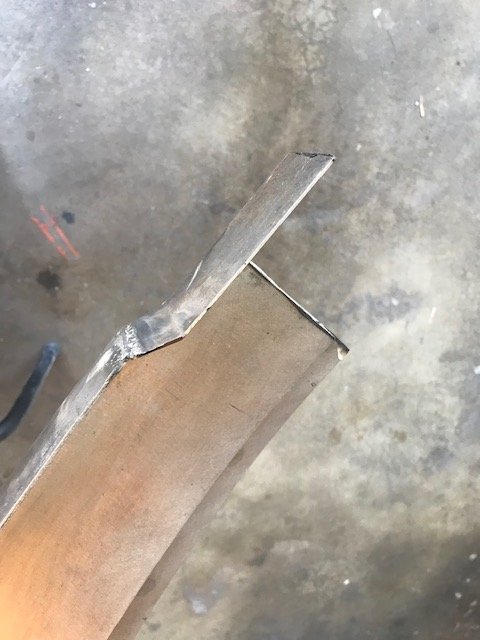

    Started working on the corners to bring strength back to them and be able to attach the panel below the deckled and eventually the crossmember.
    The return flange was very damage mostly held together by rust itself. This is the first thing to tackle.

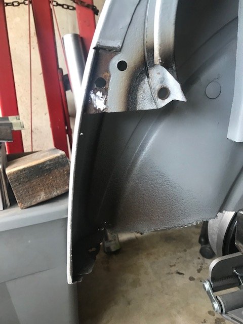

    The corner bottom flanges were the crossmember attaches to were also gone beyond repair.
    I replaced those too.
    Holes for the bolts will be added later, once I match the crossmember to them.
    Spot welded in place for now. Will fully weld once the corners are fully repaired
    Panel below the deck now has something to attach back to it.

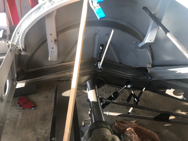

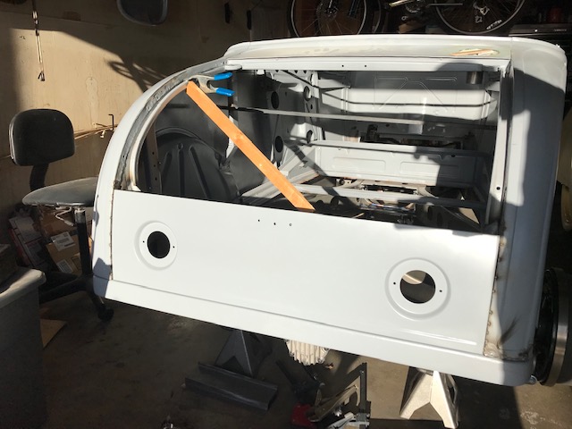

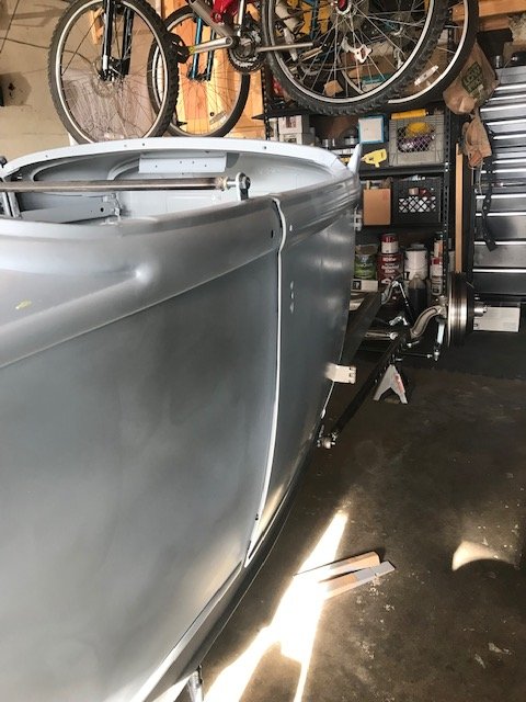

    ***embled the rear and started to squared the body off. Things are starting to take shape.
    Distance from the rear/side of the frame to the inner wheels wells are equal...a good sign!
    The piece of wood is prying the body over from the rear cross member to help center it. Once the rear sub rails are in place the body will have some structure back to it.

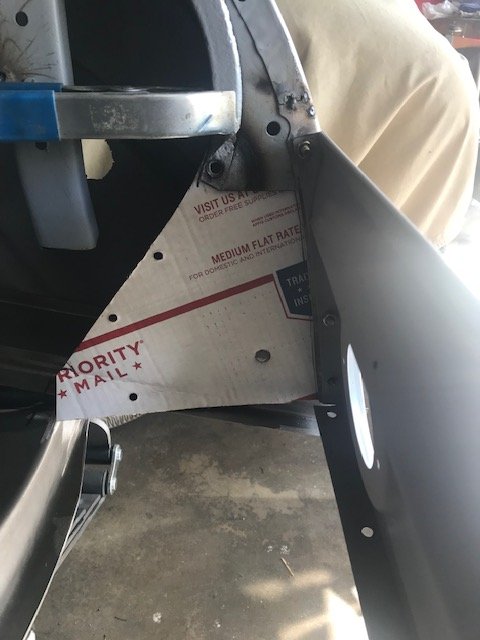

    Still got an hour to spare, so I started thinking how to rework the rear corner braces and supports to fit the new rails.
    The supports will be easiest, just cut them to size, following the angle of the brace, and attach it to the sub rails same as original.
    The corners were a bit more involve but not bad. Stated with a cardboard template. Thank you USPS!
    Clamp it in place, trace the subrail, and look for the best fit and areas to trim.
    With some t*******, the original pieces will work just fine and the brace will sit behind it.
    The corners still will have the two holes to attached the curve trunk piece.
    You can see how little material I need to remove, to make the corner braces work.
    I will cut out the dimple and add metal to make flat so I can spot weld to the bracket that will run behind it.
    Feeling good about these!

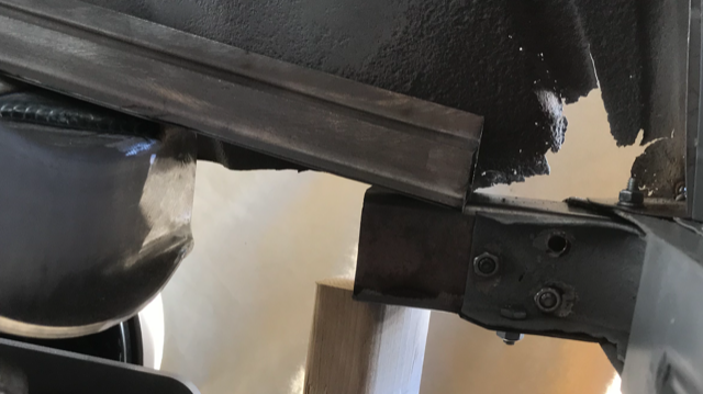

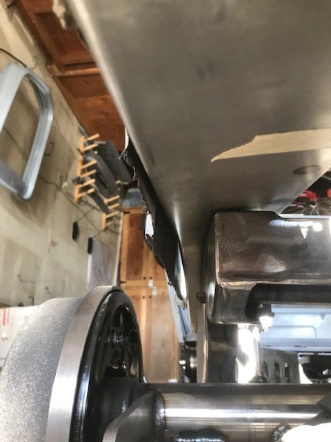

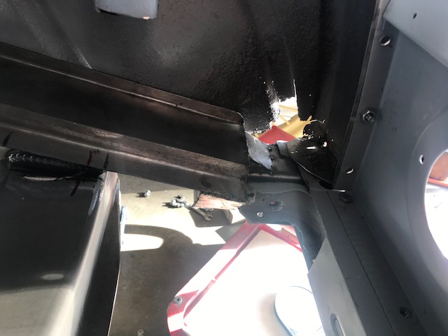

    I've been getting requests for pictures from underneath looking up at the rails. You can see how they taper out. They are flush to the outside of the frame, where the rear wheel wells start and the at end of the frame they are out about an 1" out
    That's what I meant above by saying they don't seat dead centered on the frame. You can see the different color marks, as references, as I have been adjusting the position.
    Today, I trimmed back the rear of the sub rails and mounted again the rear crossmember.
    Now, I have a clear view of the transition between the two and plan to blend them both together.

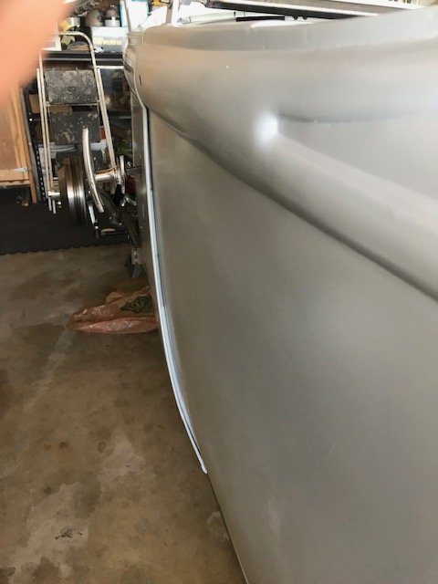

    Bit of a slow day today...but a productive one.
    Stating to secure the body to the frame and starting to measure the wood blocks to ensure the doors fit and close properly.
    Started by securing the package tray to give the body all the rigidity possible. Just now I realize that i should have secured the fuel tank too to keep the front from bowing.
    Front blocks are 1-1/4" but most likely will end up at 1". The middle blocks might not be needed and the webbing might be enough.
    The crown on the doors is sitting nicely against the body. I might have to rework it a bit, to get it to sit flush.
    Not sure how close is suppose to fit to the body but as of now, it is as close as it should.

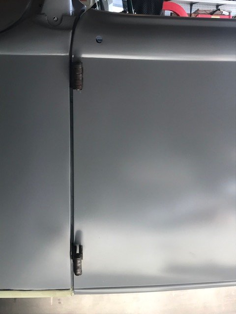

    The gaps in front of the doors are starting to come together. The driver side fits better, even top to bottom, The p***enger side wedges top to bottom.
    I may end up adding metal to close the gaps...3/16" finish gaps would be nice
    The upper belt moldings are starting to line up correctly. too The driver side looks better than the right one.
    The belt molding in the aftermarket door skins are a bit wider than the rear quarter panels....might have to do some cutting and diccing to fully get them to match.
    Gaps in the inside are looking nice and even around the door.
    Doors are closing with no effort and locking very nicely. Even my younger daughter can close and open them :)

    Not a lot of progress. Just working on adjusting the doors and making sure the body is straight and square before I start spot welding things in place.
    Mostly going back and forth on adjusting the body, playing with wood block heights and different amounts of tightening on the bolts to see what feels good.
    Bolting the fuel tank, or whatever is left of it, made a big difference. Those bolts are 10-24s for of those like me that struggle finding bolts sizes.
    I am very happy with the way the doors are fitting. Took a bit of persuasion with a woodblock in a corner and the right amount of pressure on the other. The gap down the side is looking nice and tight.
    The p***enger door locks a bit easier and better than the driver size door but I think at this point I am just splitting hairs.

    I will be moving to the rear sub rails again in the next few days.
    The plan is to mark the holes for the frame and insert and weld a metal tube to the sub rail to avoid crushing the rail when tightening the bolts down. Those frame bolts are 3/8-16....yes, I do struggle finding the right bolt size.

    The fit on the doors look excellent to me. I’m sure it is better than when the car was new.
