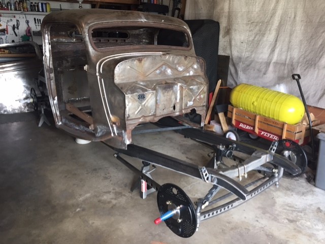

    Took some time off to clean the garage and move the roadster to the other side, so I have access to the p***enger side.
    Crazy how much dust is created when cutting and grinding. Today was cleaning day.

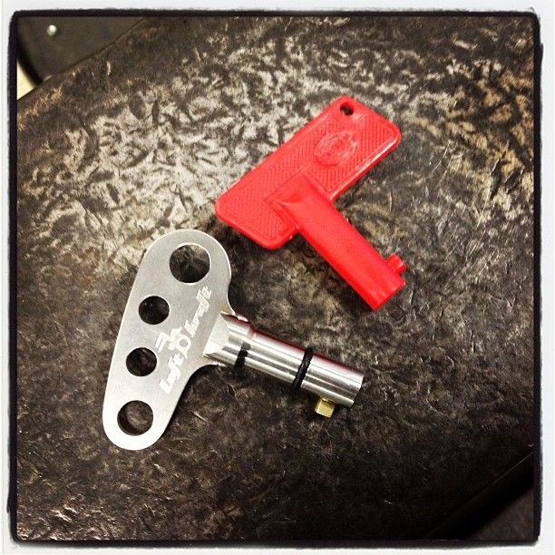

    I had a couple of hours to spare, so I shifted gears and worked in something different....still for the roadster!
    I plan to use a battery kill switch, mostly to keep the battery off while park for long periods of time.
    Not sure yer if the battery will be in the trunk or underneath the seat; most likely it will be underneath the seat for safety, but I will definitely need a kill switch.
    The problem with the kill switch is that ugly plastic red key. It screams made in china and not vintage at all.
    I looked for other options but haven't found anything I like. I did found this key which looks really nice., much better than the red one...but damn expensive, too expensive for me!
    $115 just for that key :-(
    I figure I can make one and I already had all the materials, 3/8" and 1/8" metal rod for the shaft and some 1/8" plate for the handle.
    Copy a simple design
    Few holes later and some t*******, handle takes shape.
    For the shaft, I made two opposite 1/8" holes. One to lock in the handle and one for the plunger. I welded them shut and grind them.
    The metal key is a bit longer than the red one, since I plan to hide the body of the switch and not have it sick out.
    The plan is to round off the edges, sand it to a fine grid /polish finish it and clear coat it.
    Fits my needs and sure didn't paid $115 for it.

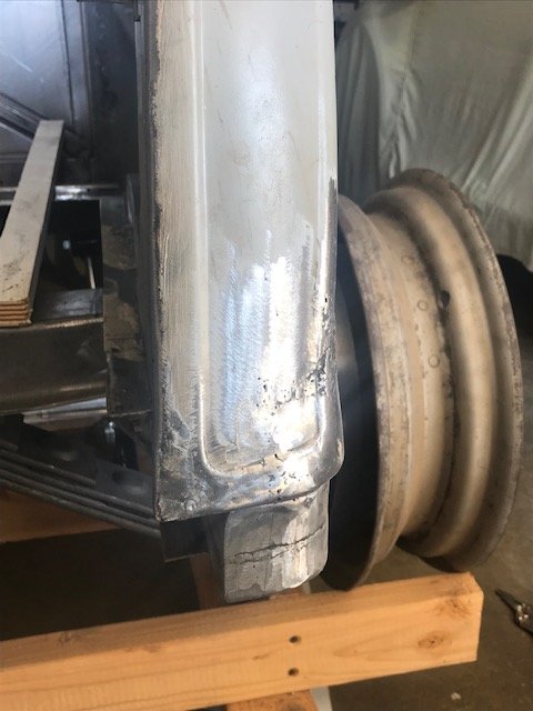

    P***enger side is almost done. A little more dolly and hammer, a few more pin holes to weld and I can call it done. For now it is done, I will do the rest of the work when the body comes off the frame and I have better access to it.
    The last pasr of the rear panel is not welded yet, as I am waiting to patch in the rear corner first.
    Looking good! I am happy and impressed. I am learning how to weld and doing it at the same time. I can see myself getting better little by little.
    I can hear the bacon sizzle now :)
    Here comes the next mountain to cross. The rear corners.
    Removed the rear cross member for better access.
    The metal is thin and pitted.
    P***enger side worst than driver's side
    Driver's side look better but still will need to trim back the thin metal and replace with healthier metal.
    Patch panels from Mac's are warm...but no cigar.
    The bead moldings are different, rounder at the crowns and the edge detail is different.
    I will need to do some cutting and dicing to get them right.
    Looking down you can see the crown of the molding is much different.
    I ***ume the piece is larger than the original since it can seat over it.
    Challenge accepted. Let's get it to it...

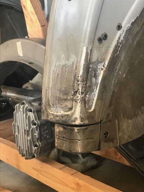

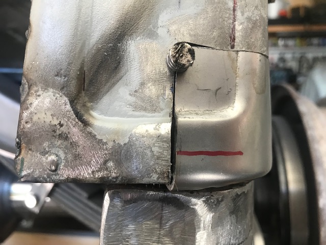

    Spent some time tracing my cutting lines to trim as little as possible but still remove as much as the bad metal as possible.
    The metal is really thin in this area, so welding this one will be difficult for me.
    This is probably one the hardest pieces I have fitted with all the lines, curves, details and making it all match....I am taking it slow...
    Not too bad! It has room to go up and clear the crossmember underneath.
    The bottom of the patch panel is longer, so thinking a pie cut might help me.
    The side detail belt molding is not long enough on the patch panel....so a another cut pie to stretch it...
    This one I can pie cut it again and reduce it so the bottom can be aligned. The cross member needs room to fit underneath.
    Will also need to slice top to bottom to light the molding line correctly.
    These corners are going to be a *****! How can you fit a dolly and hammer??? Everything seems to be in the way...can't event fit my hand back there.

    This corner has been a ***** to weld in. I am not looking forward to the other side.
    The metal is so thin that it blows out very easily. No room in the back to put a dolly back there....this is where the experience that I don't have would come in handy.
    Very slow but making progress....still lot of work ahead before it is done.

    Those patch corners are really bad copies. At first glance, they look ok but once you get to start fitting them then you can see how off they are.
    By far, since I started this project this has been the hardest thing I've done.

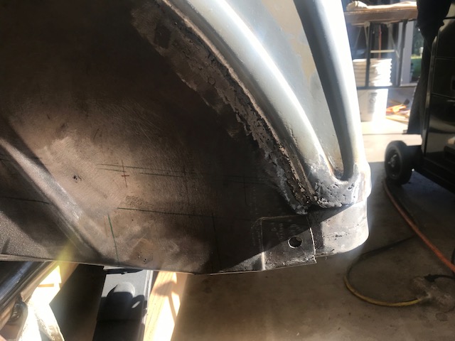

    I decided to go a different route with the driver side corner.
    Because it wasn't in as bad condition as the p***enger side, I opted to patch it rather than replace it.
    I still have some more building up to do and some pin holes to fill but definitely a lot easier than cutting, replacing and trying to blend bead details that don't match.
    Slowly and full of patience....coming along
    The inside corner corner came out really nice. Everything is aligning the way it should....light at the end of the tunnel!
    You've done a nice job on the metal key. Here's a thought...was it plastic because of insulation feature? Guess we'll find out when you turn it on.

    I thought of that too...of course when the key was done :)
    Looking at the original key, the plunger looks made out of br*** or similar material and it appear to have an o-ring on the shaft.
    I plan on doing a quick connection to battery and start testing different ideas. I am sure after zaps, I will figure something out. I will keep all posted.
    Didn't get a lot done this weekend. Spent most of the time with the family.
    However, I welded back on the inner rear braces to the inner fender panels and removed the temporary braces
    First time the body seats fully supported on it's own weight without braces or supports.
    The doors and rear deck still fitting really nice, gaps didn't changed.....happy dance!
    Need to still repair the stress fracture on this brace but happy to see it without the temporary brace,
