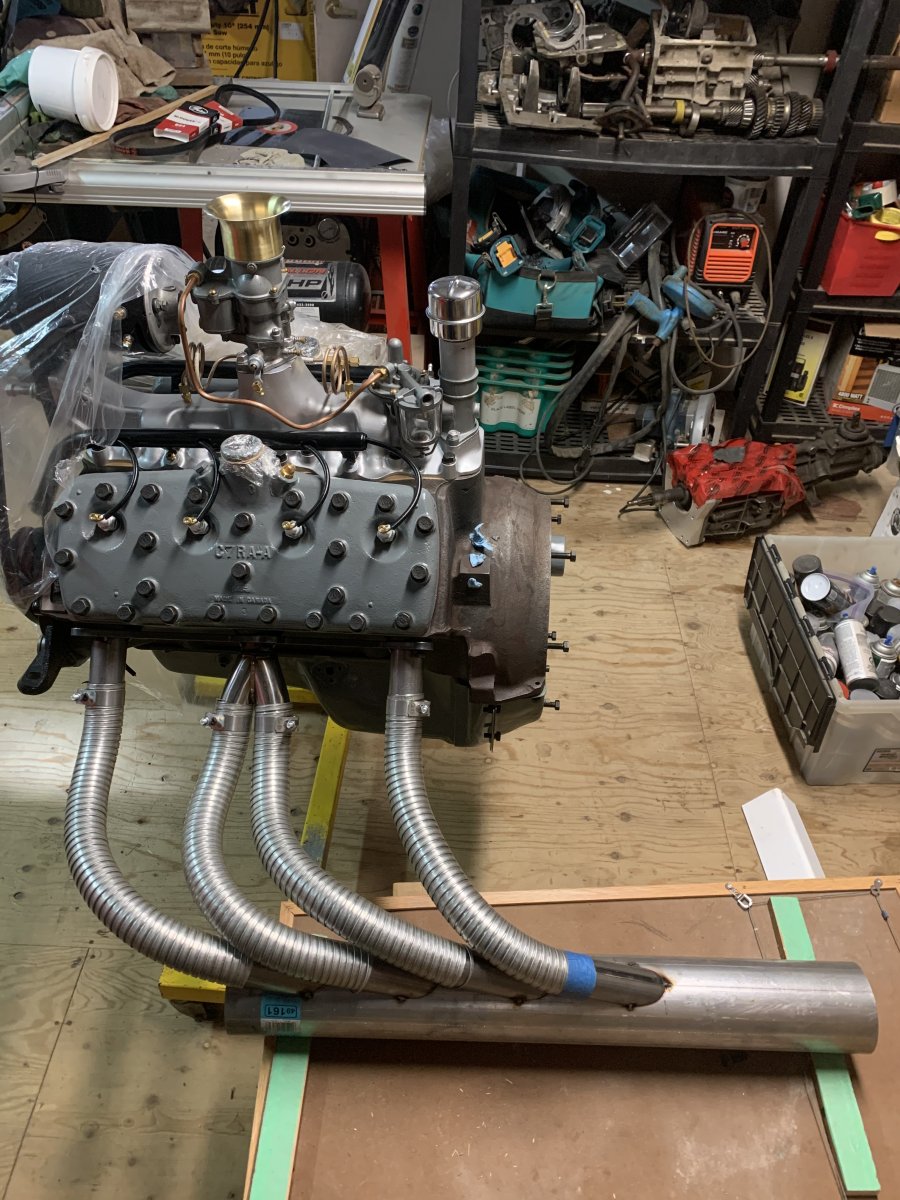

  11. Adam that is one good looking flatty, I had to hit the like as much as it pained me to do so being an inline Chev. 6 guy.

    Thanks Robert!

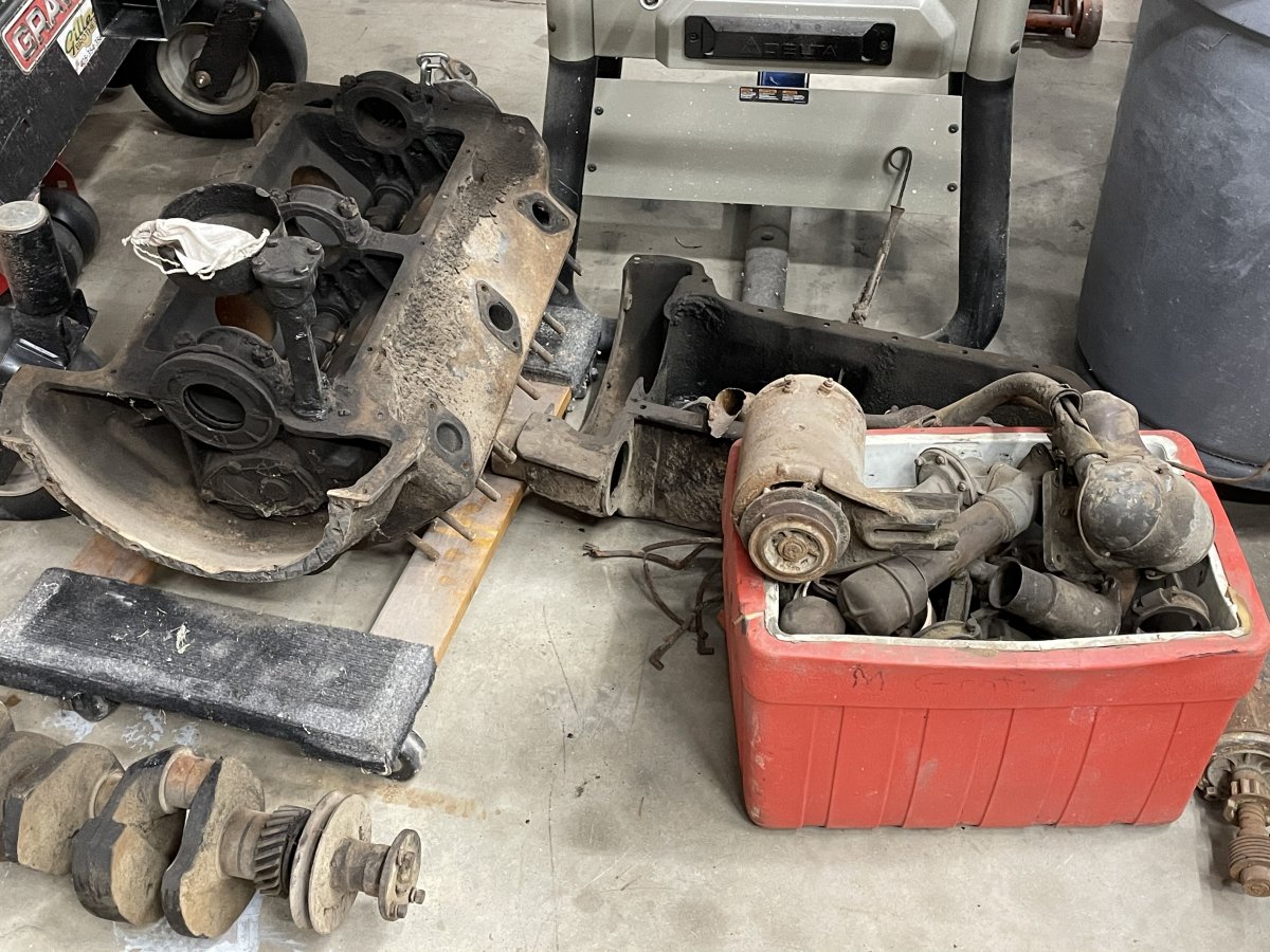

    Well my buddy @guthriesmith dropped off a pile of Flathead stuff. I think I should have taken the hint when he offered to deliver it and then was laughing as he drove away.....
    Jet96, R A Wrench, Aaron D. and 4 others like this.
  24. guthriesmith
    Joined: Aug 17, 2006
    Posts: 11,913
    guthriesmith
    Just hoping it can work out for Colby. I knew I wasn't likely going to do anything with it anytime soon or ever... You have to at least admit that the price was right anyway. :D

    MAN, just look at the pile of stuff he just gave you!:) That is a plethora of gold until you sort through and clean it all up.:cool: Then.:confused: Who knows.:D
  26. guthriesmith
    Posts: 11,913
    guthriesmith
    I’m sure it is pure gold under all that grease and dirt. :rolleyes:
    In all honesty, pretty sure it is a very buildable flathead. I got it from another friend that pulled it from his 40 Merc to rebuild. He looked everything over after pulling it apart.
