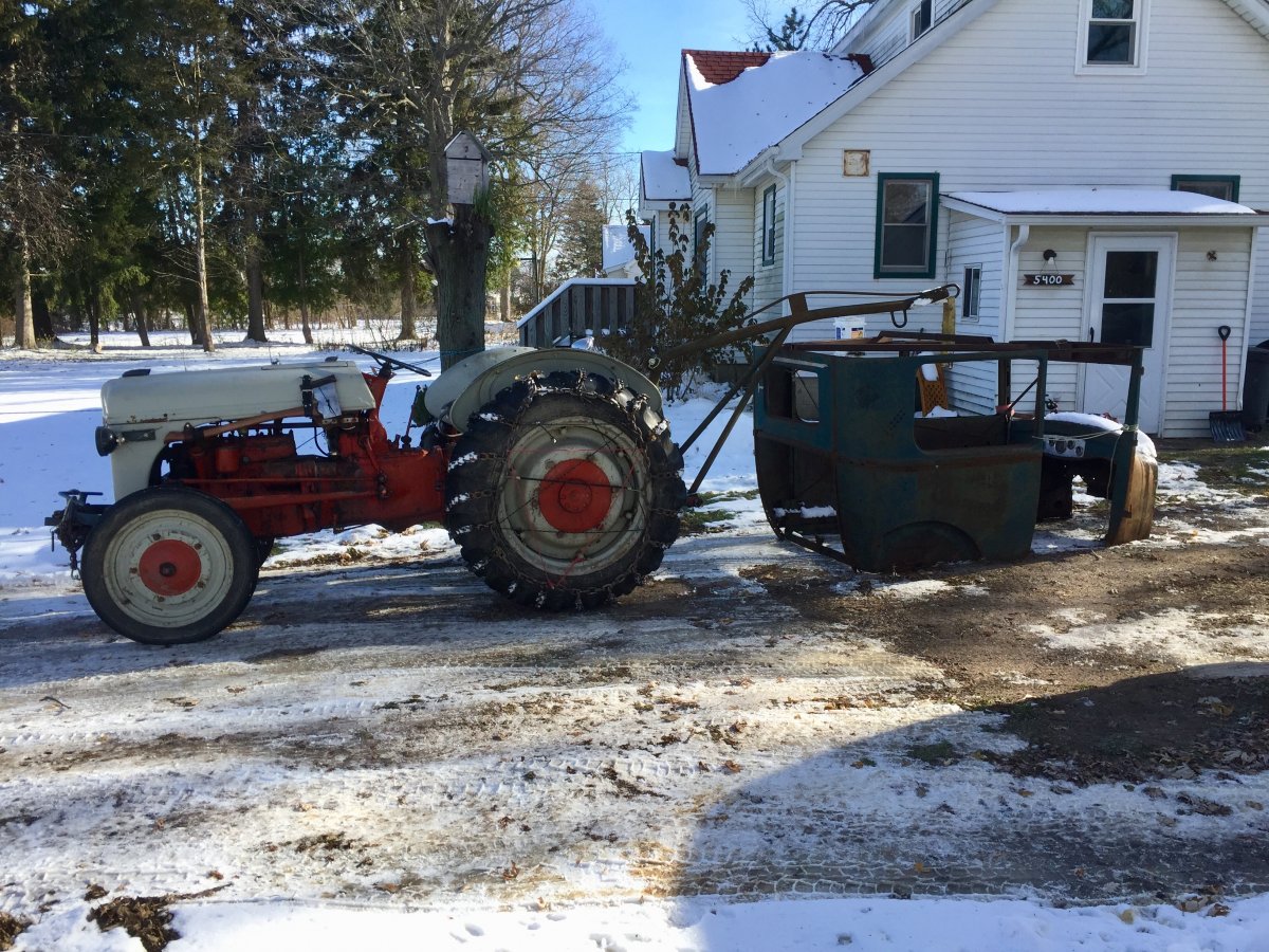

    I only have one at this point in time....
    ...and it's the best running engine I own. But my big V8 was a lot of fun!

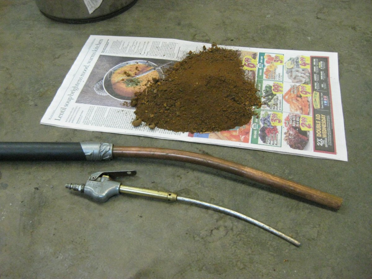

    Cleaning a flathead block. First, get a long skinny screwdriver that you can get all the way to the bottom of the water jackets. when you hit bottom, twist and turn, it may go in another inch. Feels like trying to dig in compacted gravel. you will find sand, rust, wire, etc. I emptied out my shop vac, then reduced the hose size to get it in the hole, keep it running while you chip away with a screwdriver, and alternate with a reduced air gun. This pile came out of one side! IMG_1182.JPG

    Dang. I guess 85 years will do that.
