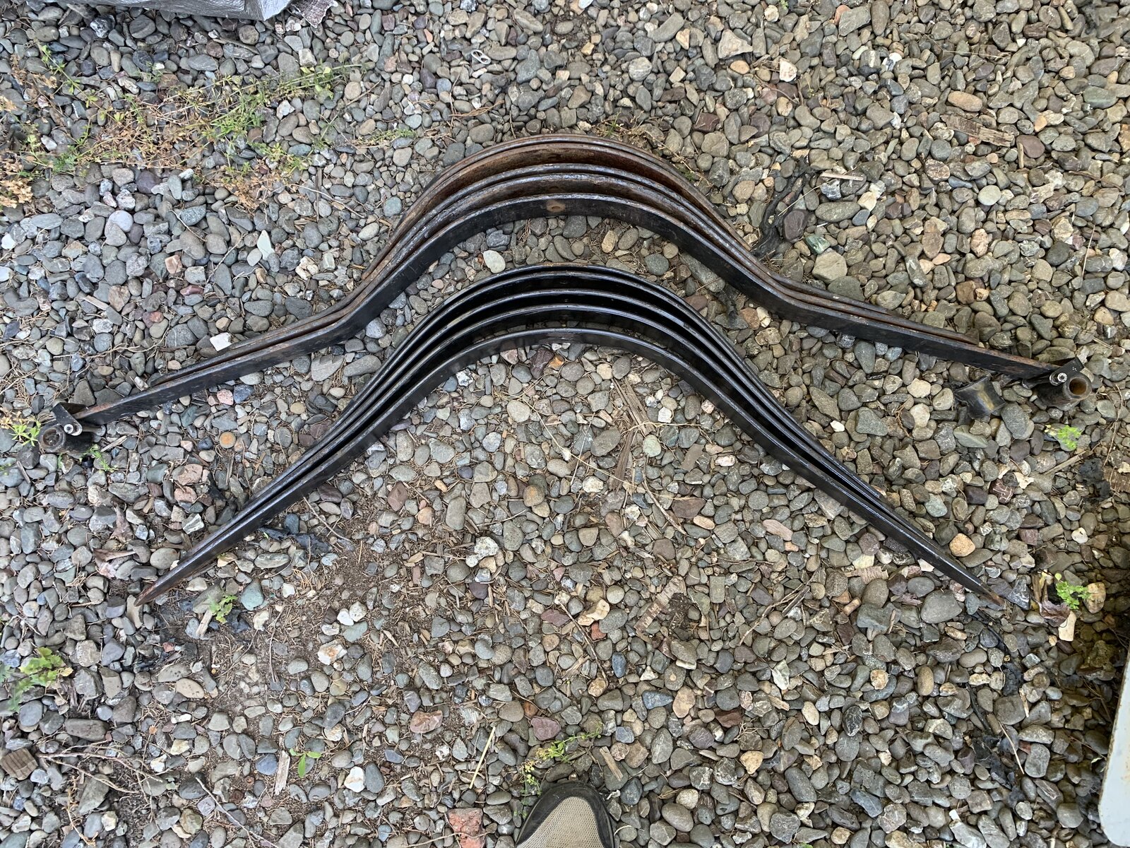

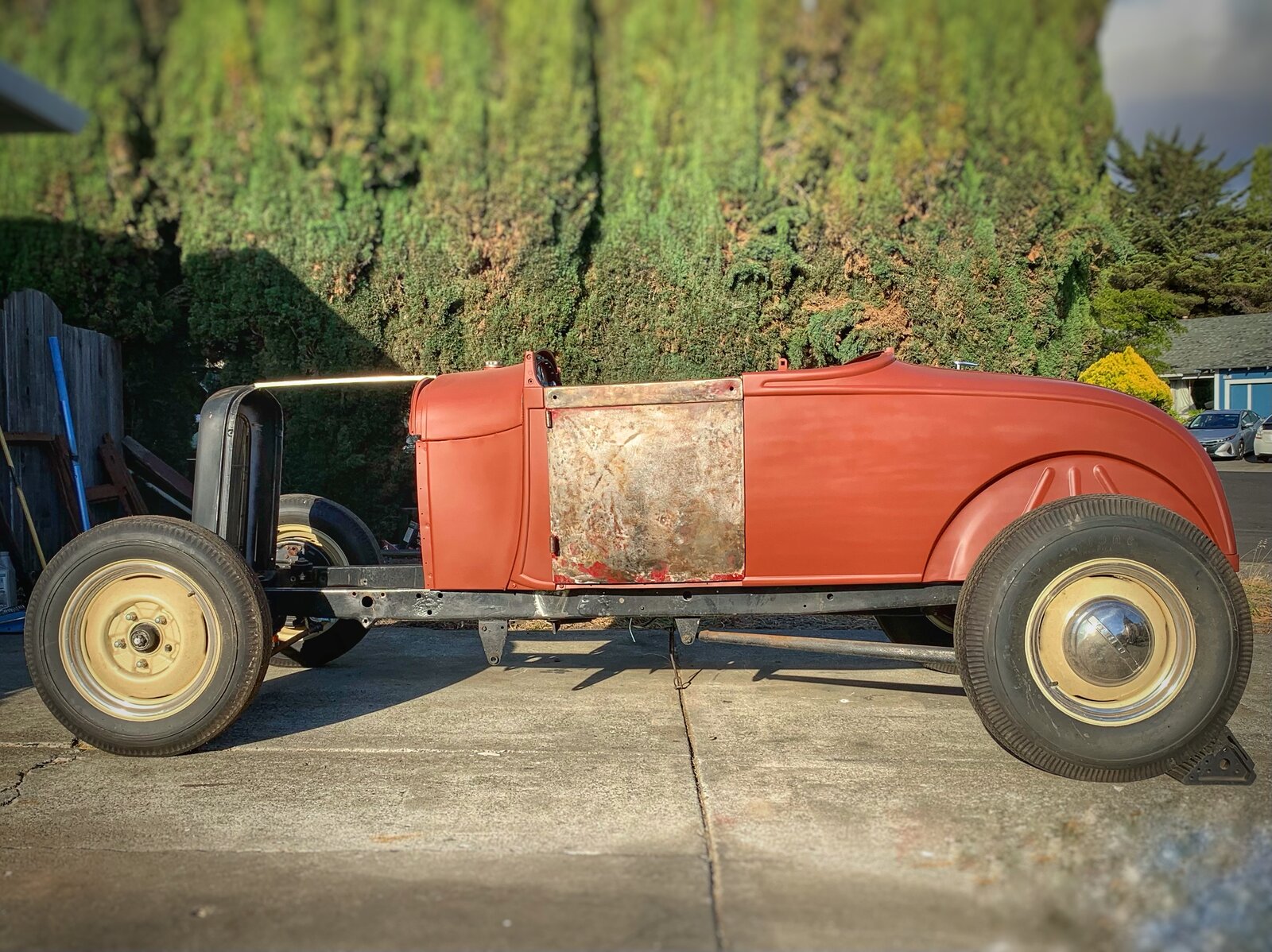

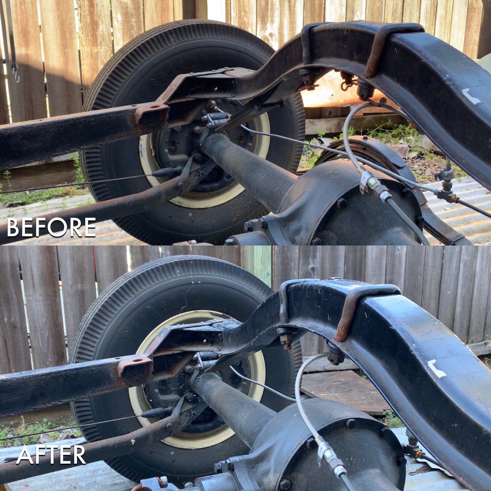

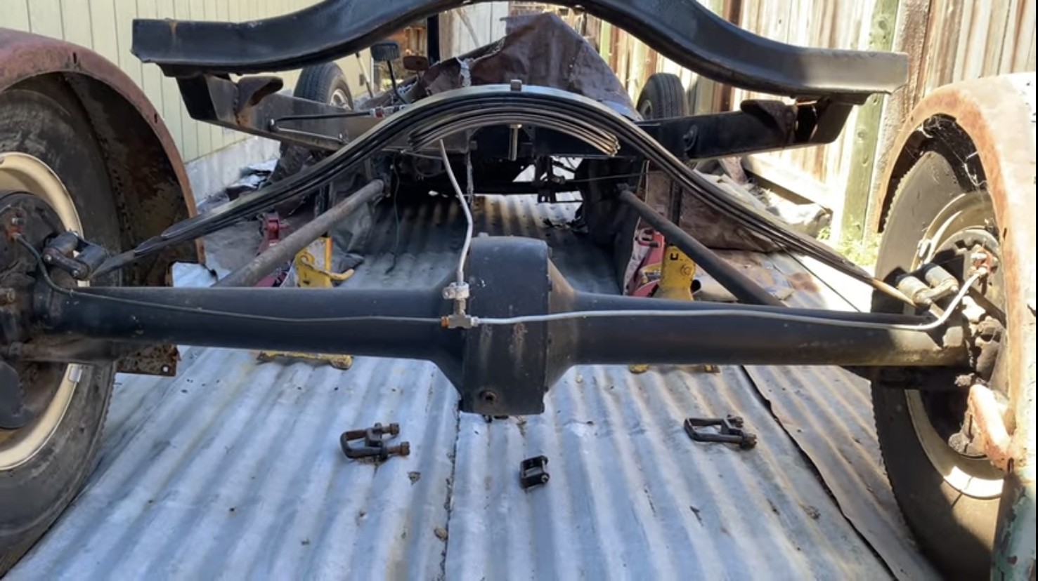

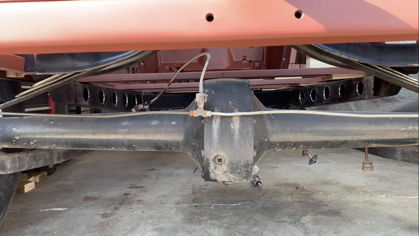

  9. Alright guys. So, for those of you with “the boss” constantly peering over your shoulder, here is the traditional project update.
    Ahem! Anyway…
    I’m not sure if I’ve posted this info in the forum, or not, but the ch***is I’m using on this roadster was under another car, originally. It was VERY tall, and it rode like an unloaded truck.
    So, at that height it had (in the rear) a frame-width rear step, and some aftermarket looking spring with reversed eyes. The front was another story; I swapped in a dropped axle long before I started taking pictures of the project. But I knew I needed to change up something with that rear spring.
    My original plan was to use this T-profiled spring (the one on top; it’s actually an A-spring that somebody re-profiled), but the main leaf is too long for my current perches, and I don’t really have room to move them out any further. All but the main leaf of my current spring is pictured below, for comparison. I *may* still experiment with the T-profile spring, later, depending upon how things shape up with the car fully loaded, but for now, I wanted to try the “Tardel Book” method of lowering my existing spring.
    And so here that is done. Watch the video for more info if you don’t grasp the concept, but here is one important point. The lowest of all Model A springs is the roadster at 7 leaves with a “dummy” spacer underneath. Tardel’s method takes that “dummy spring” concept to the next level, adding the top three springs (cut down to the “dummy” length) underneath the effective leaves. So you end up with 4 main leaves and 4 dummy leaves. This lowers the car two ways; first by physically moving the main leaf (which is directly attached to the axle) further up into the crossmember, and second, by reducing the effective rate of the spring.
    My aftermarket spring only had 6 leaves total (no dummies), and there was evidence of it moving around in the crossmember. Additionally, it wasn’t really “clamped” in place, because you need at least two inches of “pack” for the u-bolt perches to engage the spring properly. I cut some leaves from another spring to get the pack to the proper thickness, but right now I only have three effective leaves (1 less than Tardel specs in his book). It seems like it’s going to be just right.
    And these are the results:
    All in all, it was about a 2-1/2” drop, but before the ch***is didn’t budge even with full vehicle weight and a 150 lb person in the rumble seat, and this moves about two inches with all of my weight (I’m not small) jumping up and down on the rear crossmember…so I think that “fully loaded” it could be a 5” drop. I still have two leaves that I can put back in, if it’s too low, but that’s the problem I was “hoping” to have.

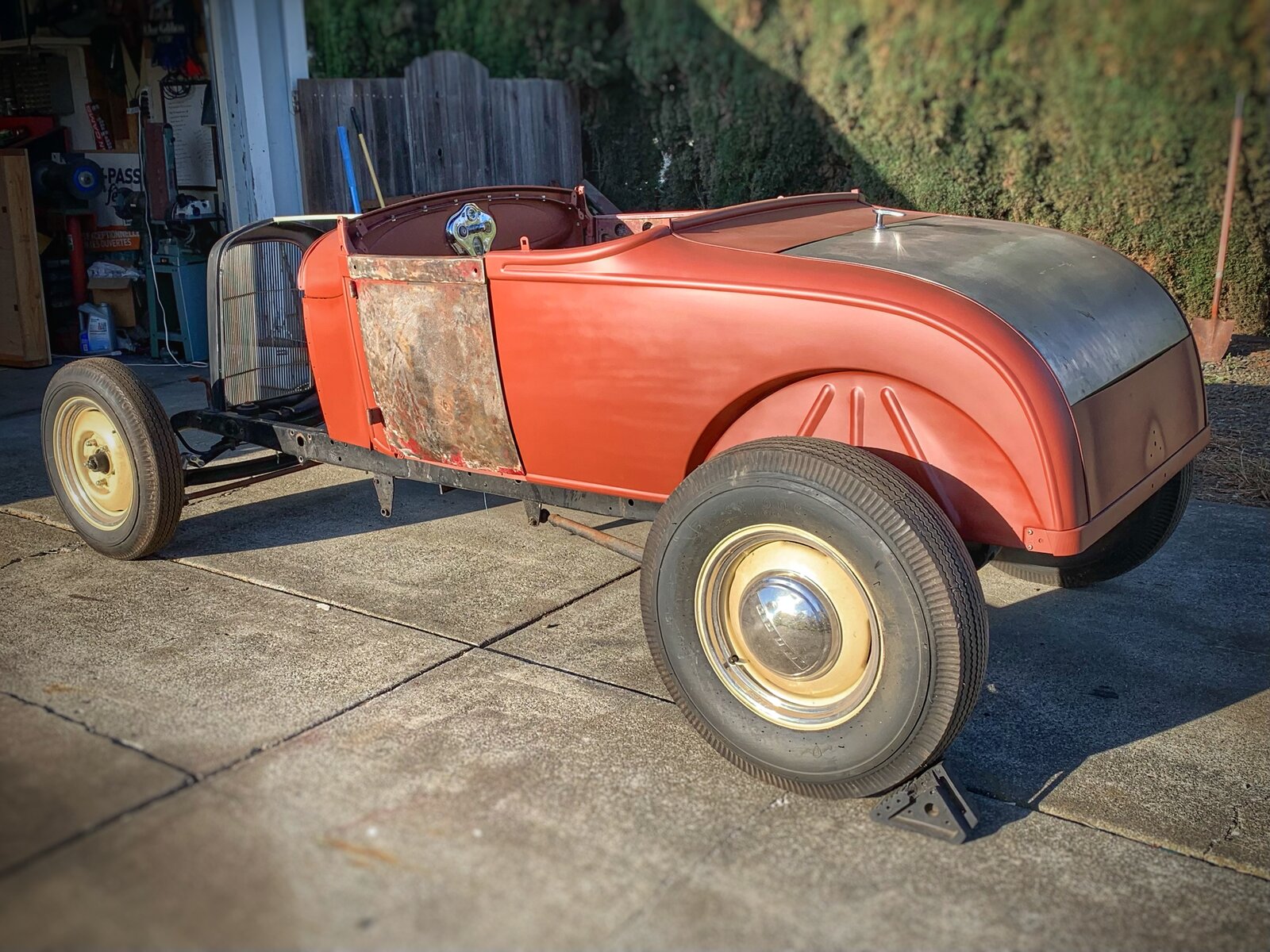

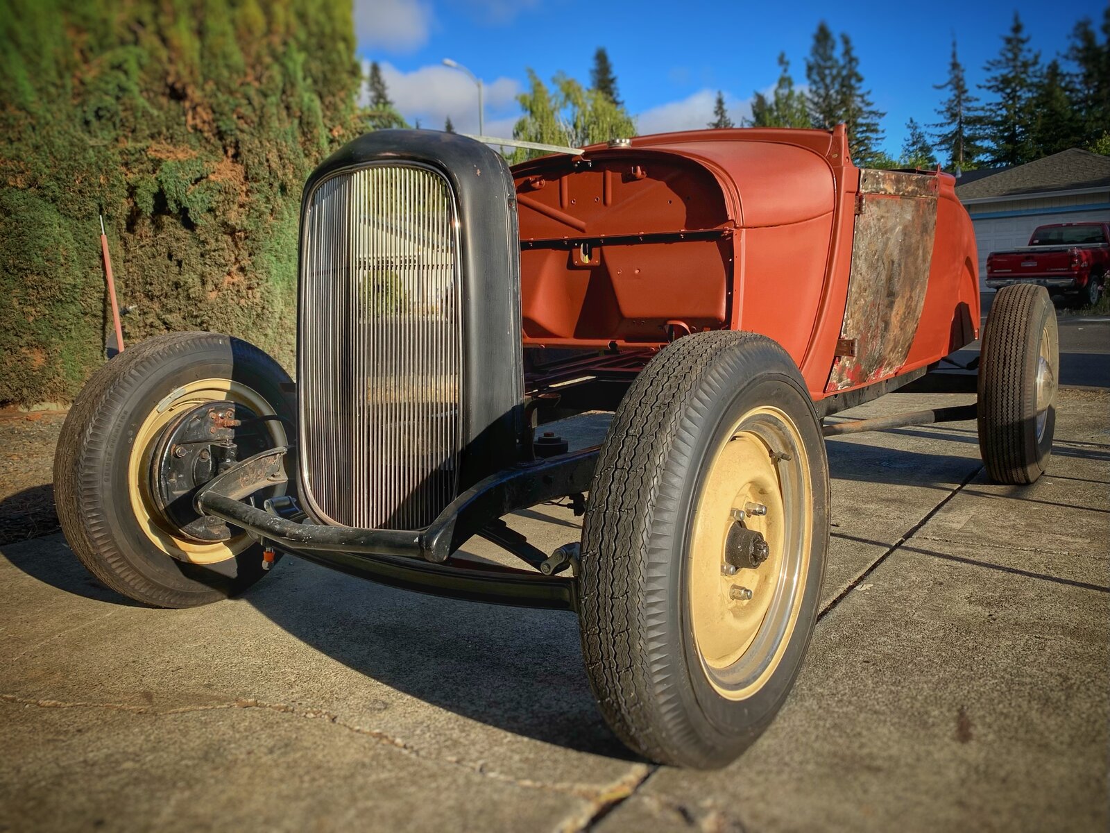

    Anyway, after finally sorting out the rear spring, I put the newly ***embled body on the lowered ch***is for the first time:
    And, now, I’ve gotta REALLY get to work.

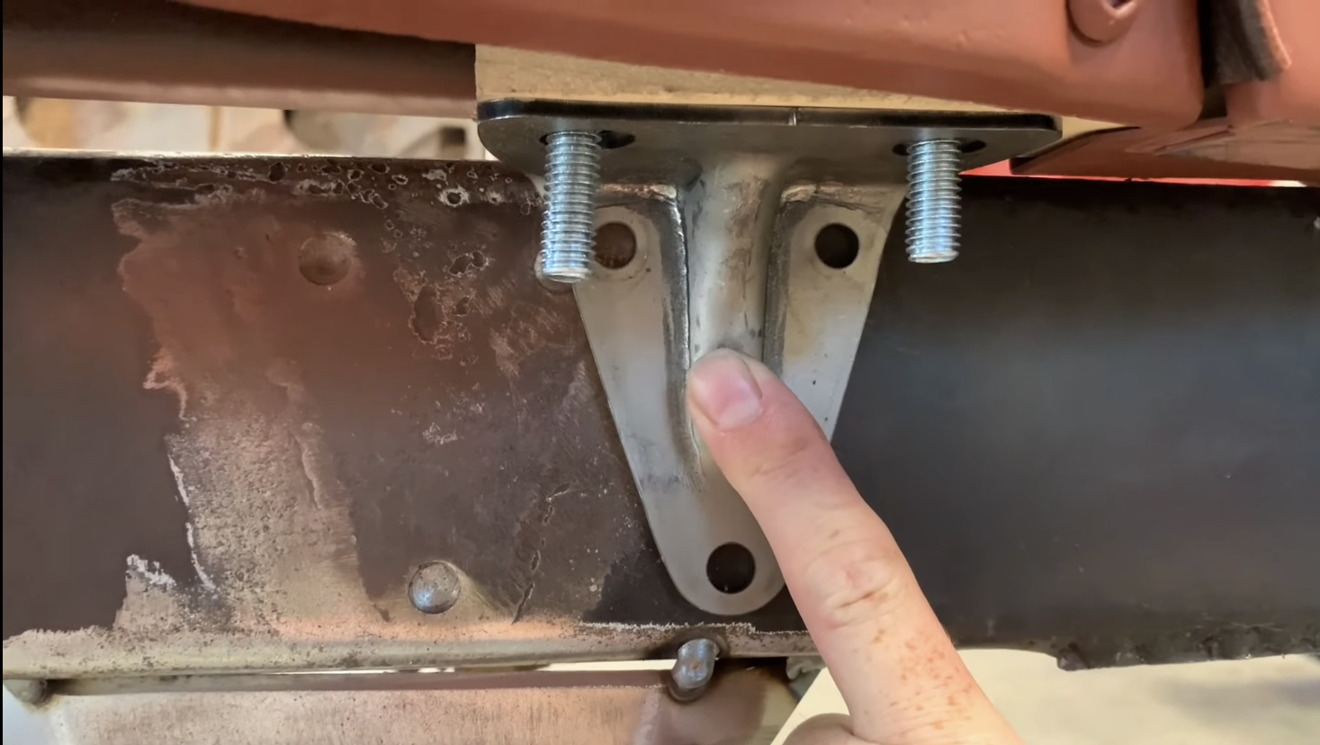

    I have another question, what is the bracket sitting in front of the kick up for, from what I understand the sub rails sit outward of the ch***is? I ***ume a left over from previous build?
    Thanks again and keep up the good work, both yours and Mart's videos make everyday a school day!
  12. Thanks Mart! And yes, it does seem like the views and subscriptions are happening exponentially. There must be an algorithm that shows the videos to even more people, based on how many likes and subscriptions they generate, or something…
    Thank you 35Cab! And keen eye, sir. Yes, those were some kind of body mount for the body that was on the ch***is when I got it, and I had intended to cut them off before setting the roadster body on, but forgot, so now I have to get under there and do it. They’re actually holding the back end up an extra 1/2” or so. That said, when you do the rear step, you lose your rearmost body mount, and should come up with some kind of additional support near the crossmember.

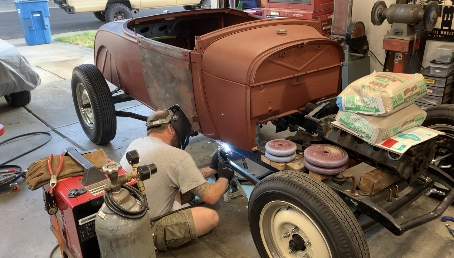

  15. Hey guys. Sorry for the lack of a text update. I will try to get on that for you. I’ve had many irons in the fire lately (trying to build a road racing engine for my Mustang has me mentally consumed). But here is a new video update.
    I got the wishbones split and tacked in place:
    In the words of my favorite California Governor, “I’ll be back”.

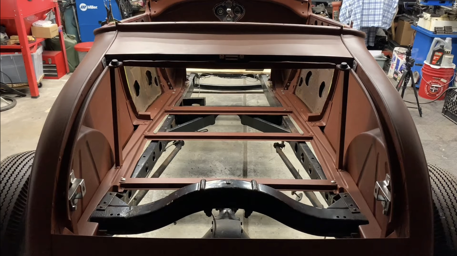

  17. Hey folks. So for the people who can’t or don’t watch the videos, here is the long overdue text and photo update on the roadster project. I have about 30 pictures, so I’ll break this up into a few posts over the next few days.
    You all will have to forgive me for the lack of progress lately. With an infant and a full time job, there’s not a ton of time for projects, and the roadster is just one of three currently on my plate. Well, that, and every single neighbor still asks me to fix their cars as well. I am getting better at saying no, but they still **** me in quite often. Anyway, here we go!

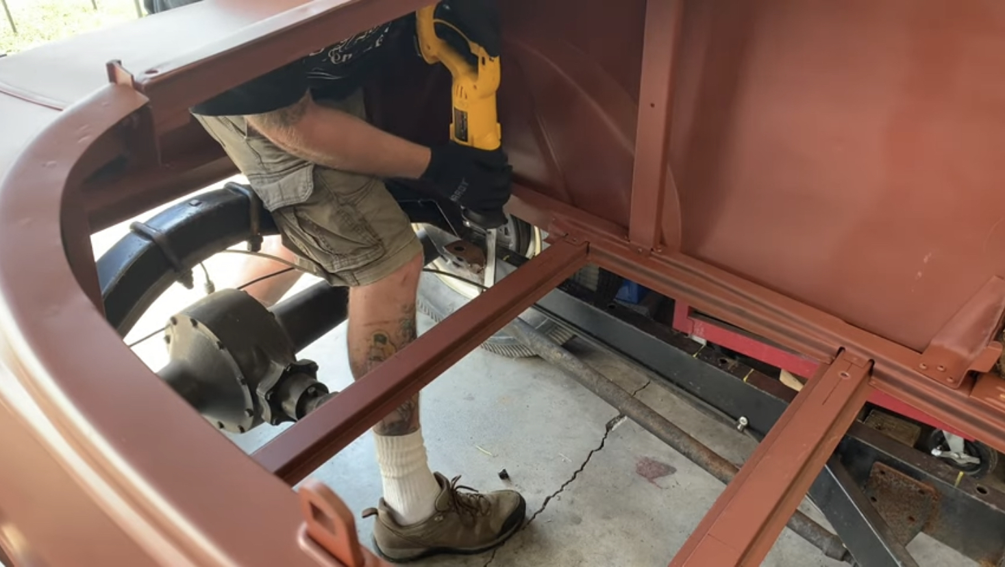

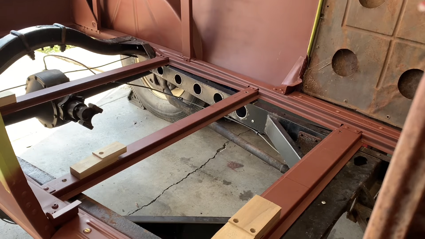

    Mounting the Rear Quarters to the Subrails

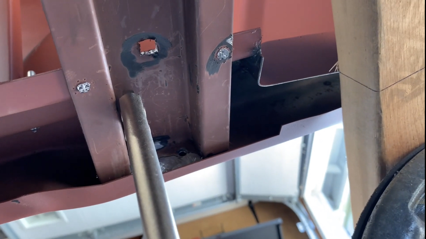

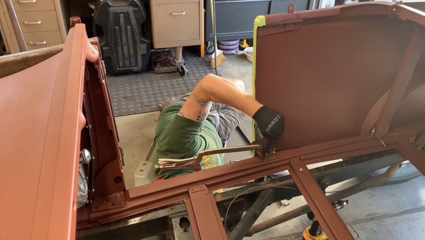

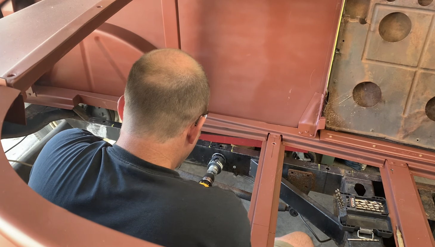

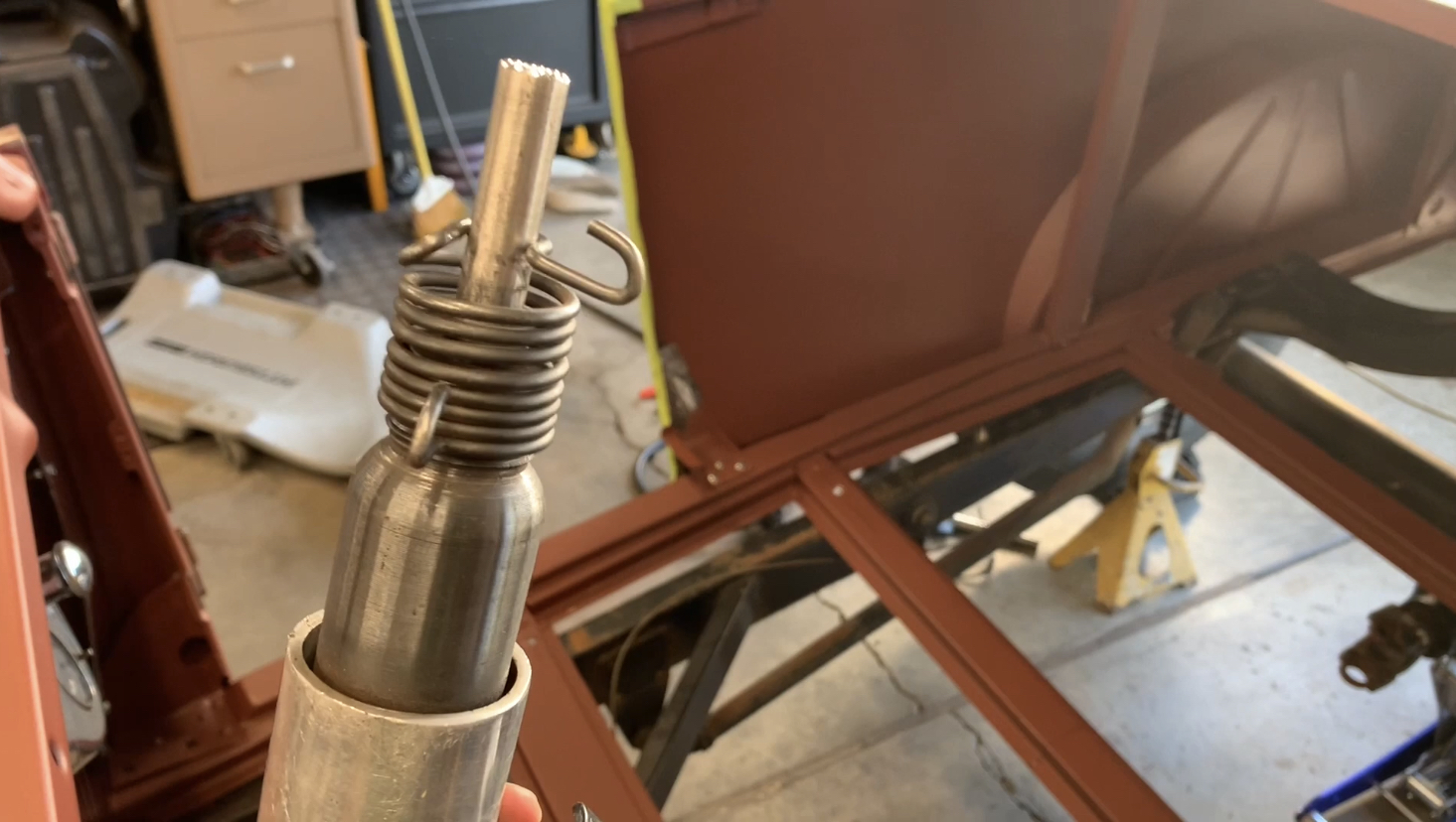

    So, I screwed up when ***embling the subrails. The rear-most cross channel has two rivets that go through it and the outer rail, which I installed. Well…they’re supposed to go through the quarter panel as well, sandwiching all three pieces of metal together. So I had to drill those rivets out.
    And at that point it was impossible to get my riveting buck up inside the subrail, so I cheated. A pair of alloy steel ****on-heads with hardened washers and mechanical interference nuts ****oned everything back up. A dab of bondo in the hex opening should fool most folks…and these DO sit behind the tire, anyway.

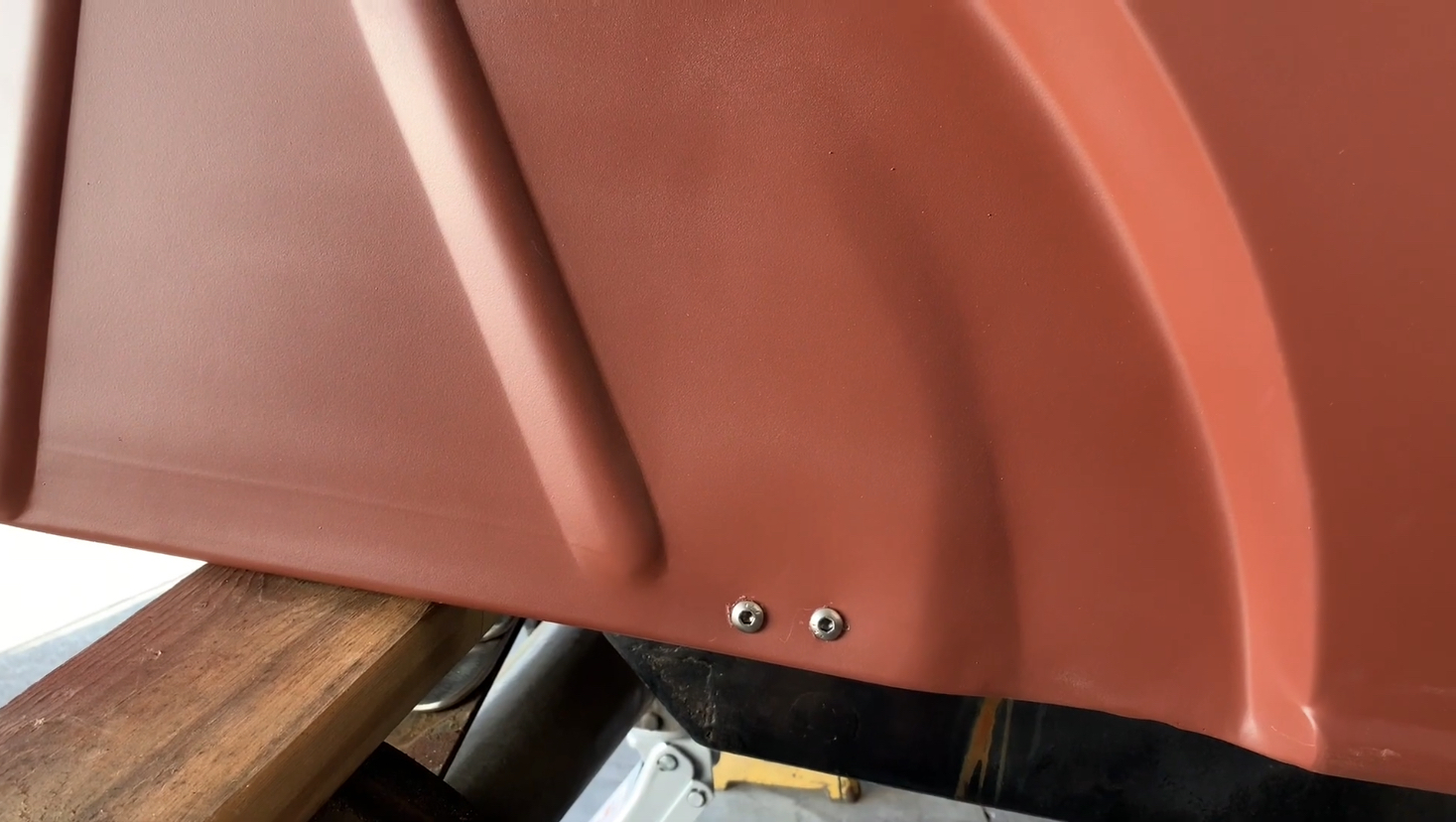

    The next order of business was to rivet the front quarter panel braces to the subrail. I believe that I showed you guys earlier my process of riveting and spot-welding the braces to the quarter itself. I had just used clekos going into the actual rail, in case something had to come back apart. Now they’re permanent.
    My Harbor Freight Air Hammer and Ford pattern waffle tool.

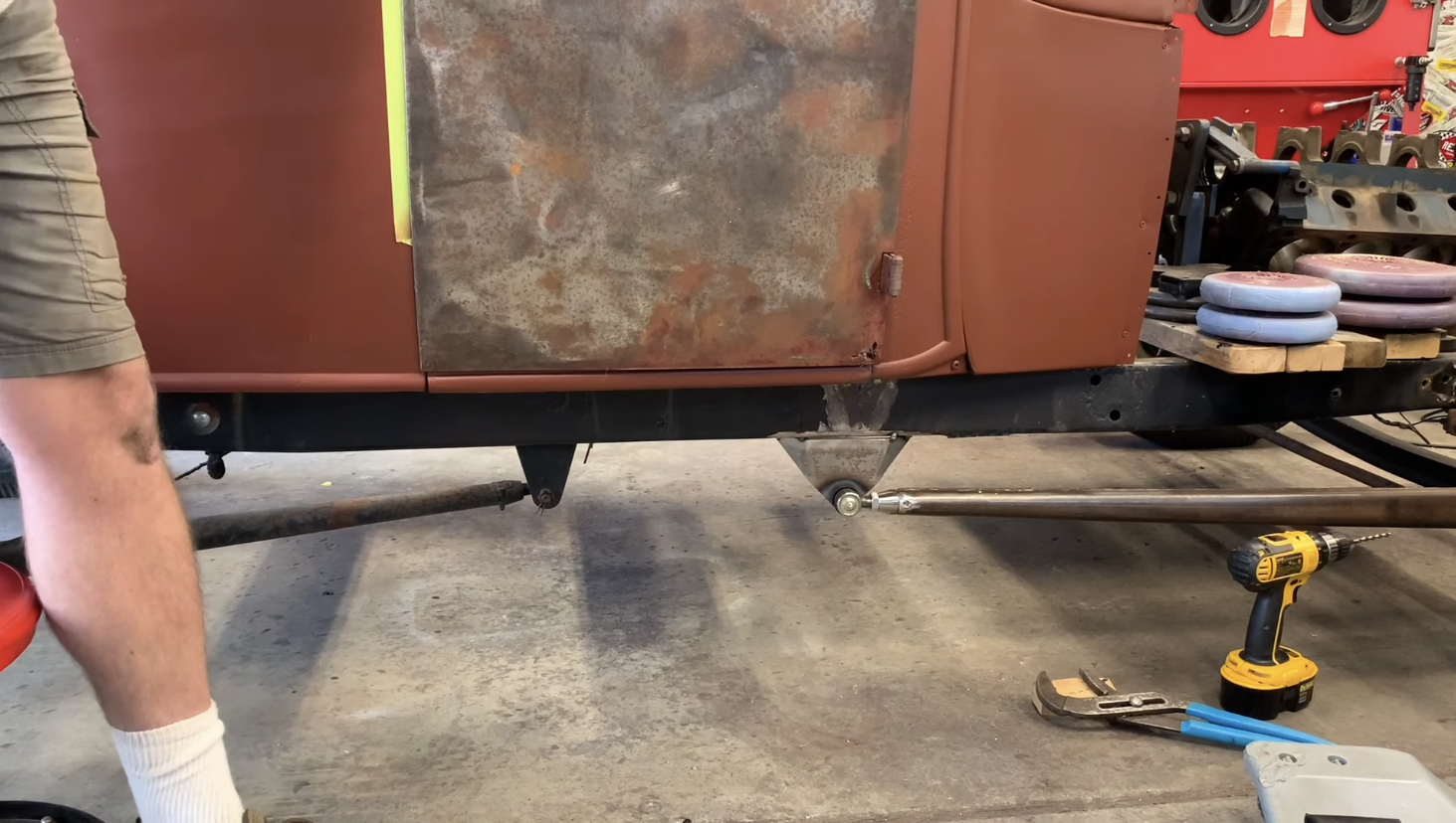

    The bottom edge of the quarter panels wrap around the outer edge of the subrail. The easiest way I found to accomplish this task was to use a block of wood and my HUGE channel-lock pliers, and I just sort of worked very slow and gradual back and forth, a little at a time, until all the fingers were bent up uniformly. I’m sorry I didn’t take a picture of the inside of the panel…

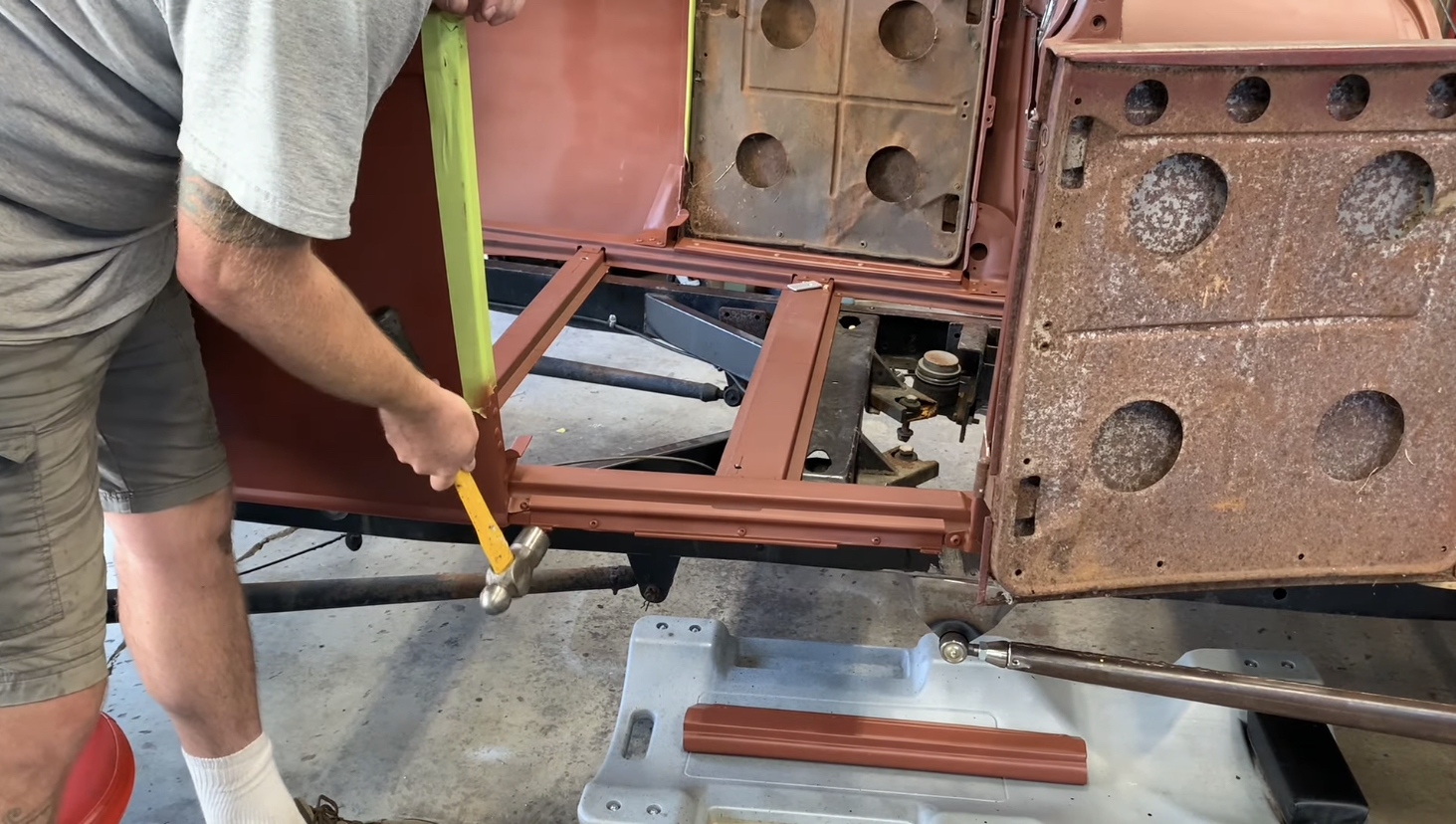

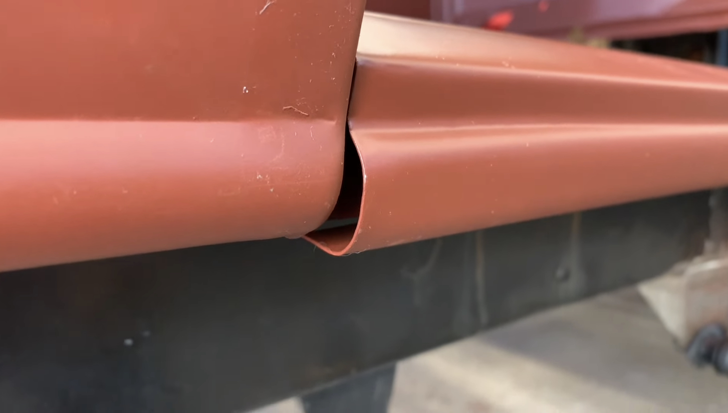

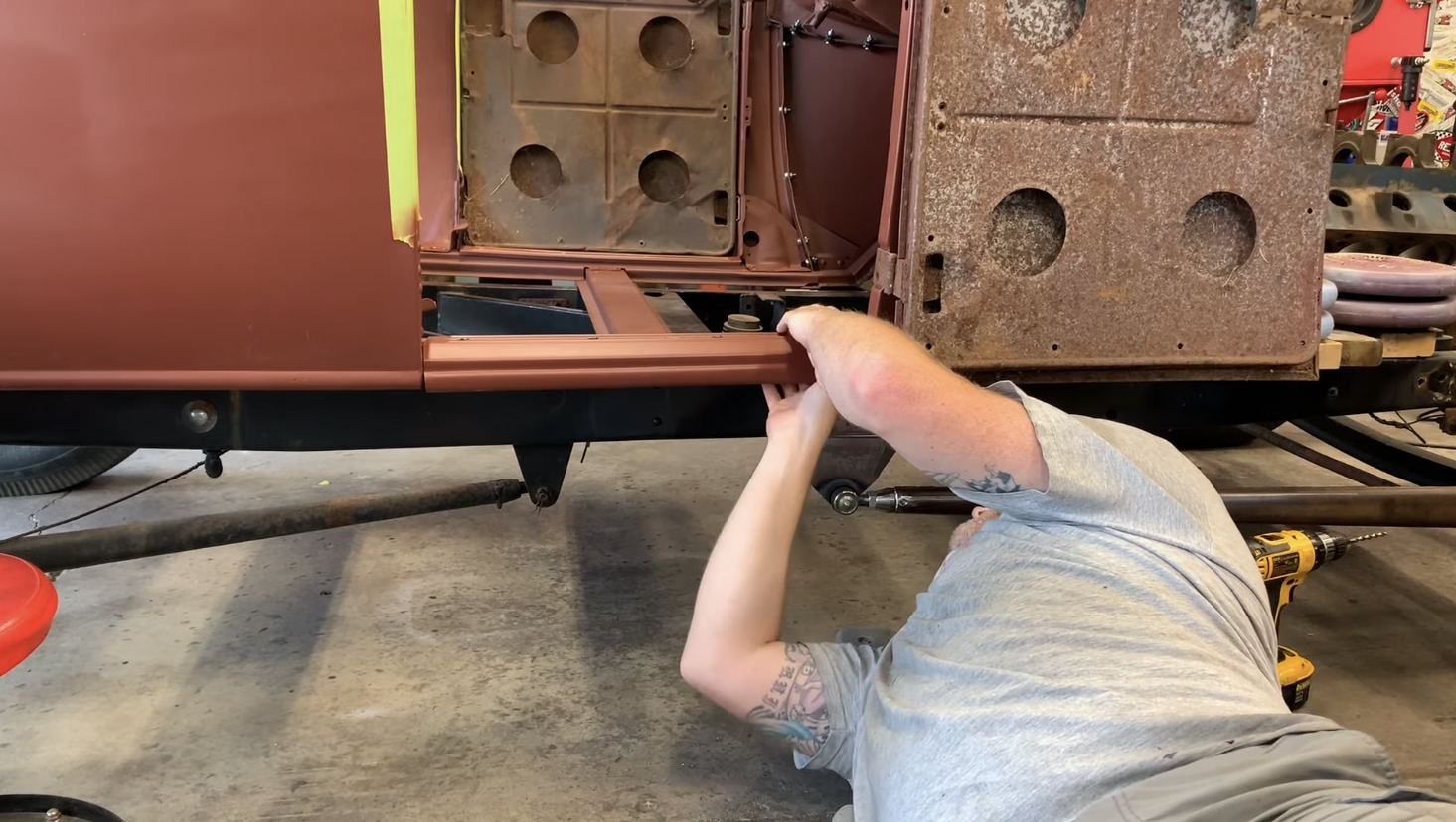

    Mounting the Door Sills

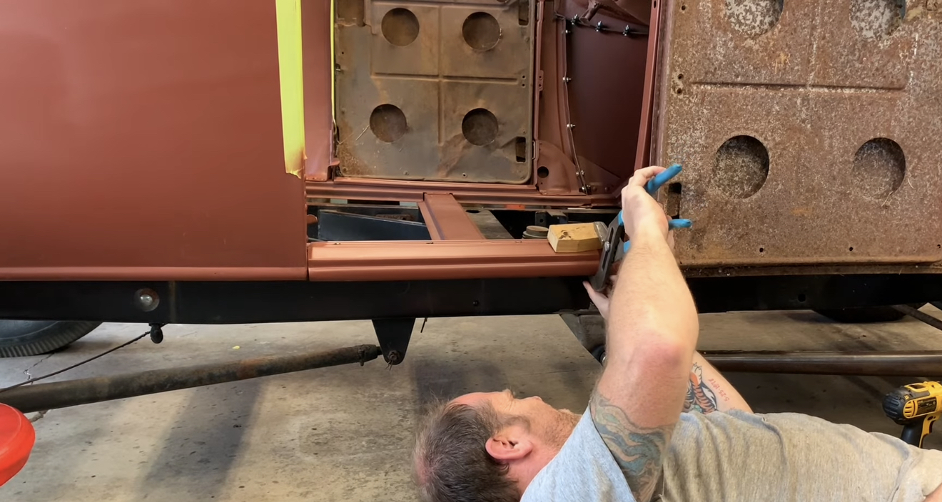

    What I thought would take 10 minutes literally took a day. But I’m getting used to that with this project. The “generally accepted” level of aftermarket fit, is the usual culprit (this is a Brookville sill on a Brookville quarter).
    BFH to the door sill brace; the brace was pushing the sill plate out about a 1/4”. That was about half of the issue solved with three sharp whacks!
    Then m***aging the sills by hand into a general shape that more closely resembled the body line.
    Followed by my trusty wood block and channel-lock trick. I did come in with a body hammer after this for some final finessing
    And le voilà!

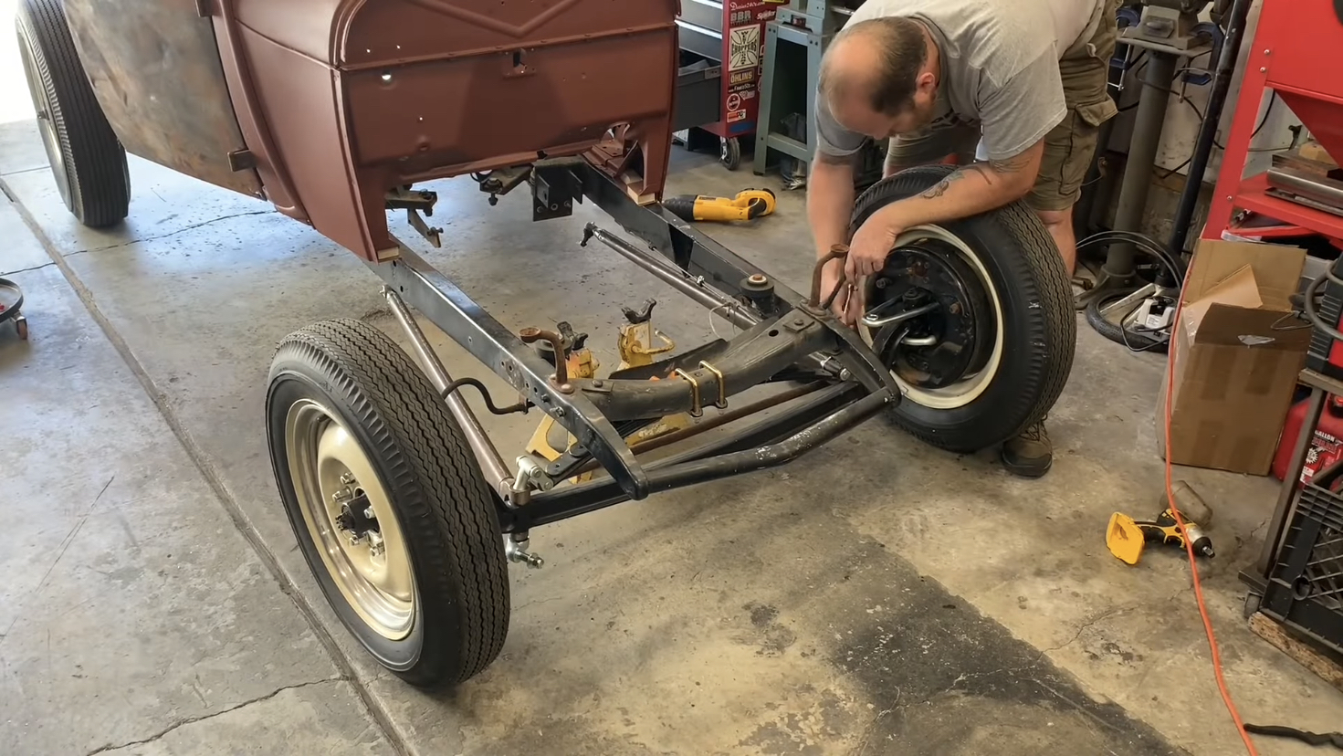

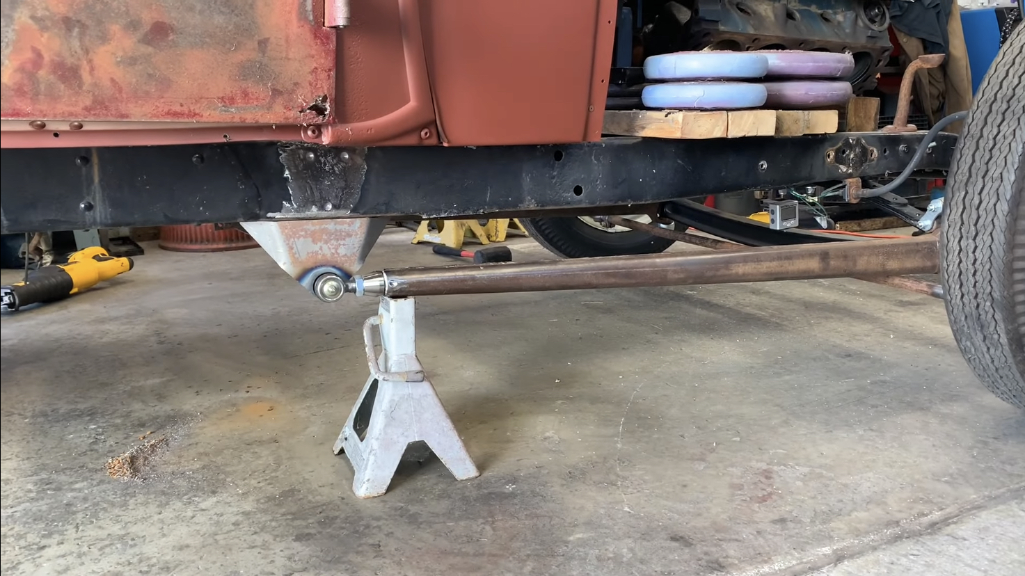

  23. Split Bones
    ***Disclaimer***
    I have never done this before, and I have no idea if my methods are correct. So even though this looks and feels like a “how-to”, it’s really just a “how-I-did”…

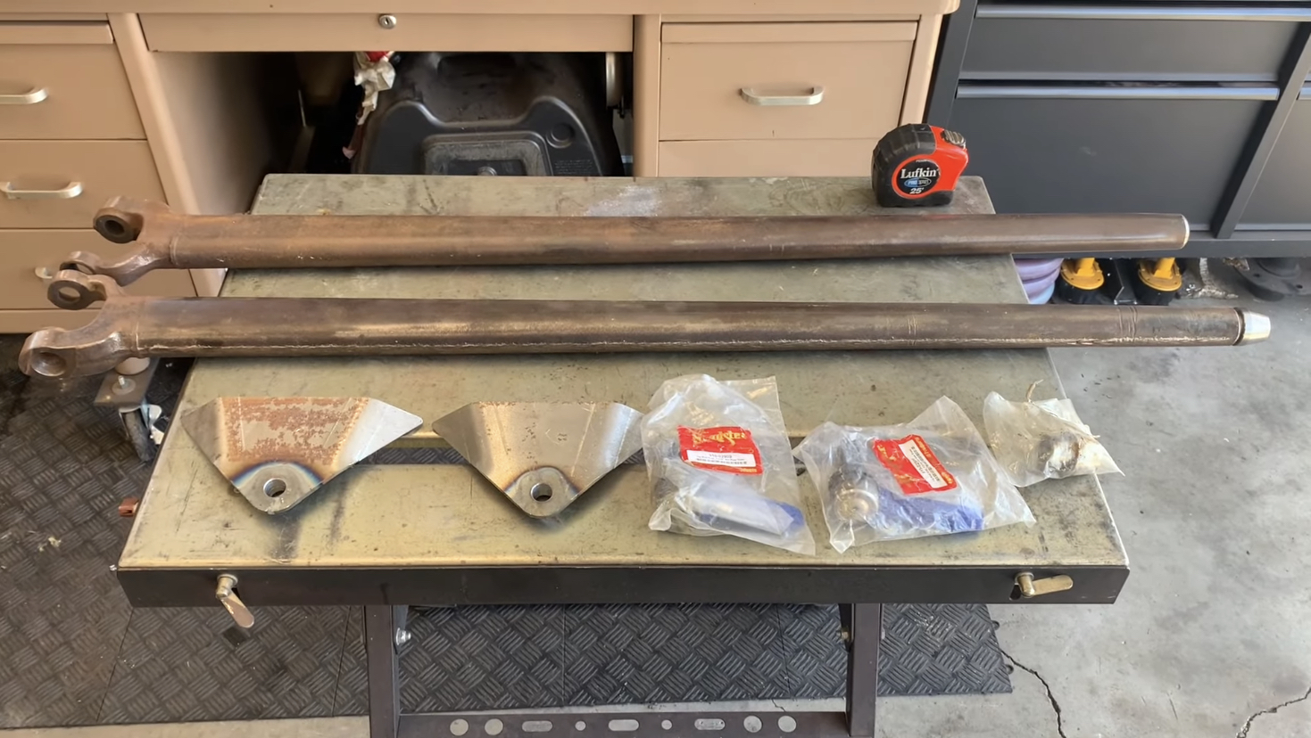

    So I got this ‘40 Ford complete front suspension for another project long ago. A buddy of mine ended up with the axle, spindles, and drums, but didn’t want the bones. So I lopped the shock mounts off, cut them at the knuckle, and stuck them up in my attic. When I (years later) scored this ch***is, with poorly split and too short bones, I knew I would eventually dig that ‘40 pair out of the attic and use them. So this update is a brief synopsis of that process.

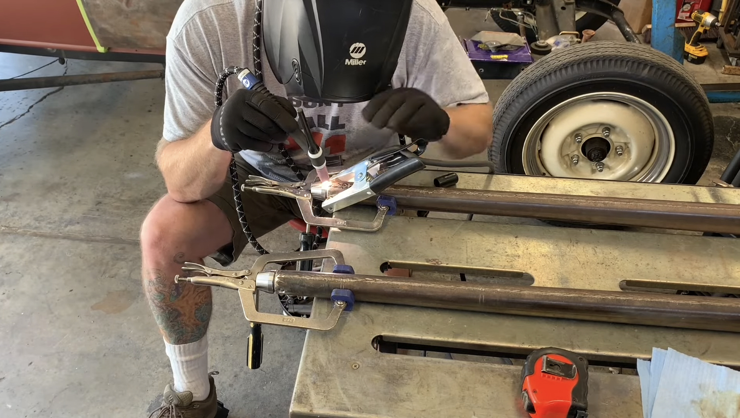

    These are the “split” bones along with the Speedway bone splitting kit that I used to add weld bungs and tie rods to the ends of them, as well as the frame brackets.
    https://www.speedwaymotors.com/Spee...MIucysh5zf8QIV5wqtBh0e7Aa_EAUYAyABEgIEv_D_BwE

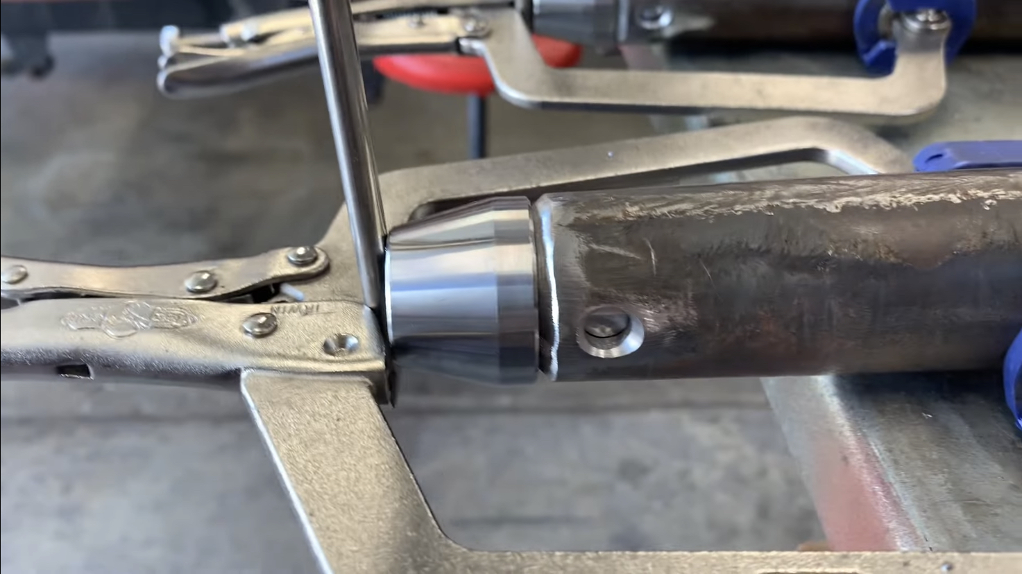

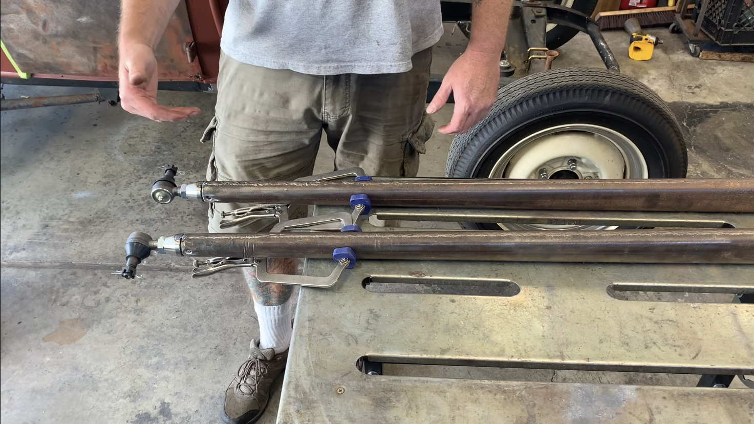

    Pro tip: make sure you cut your bones squarely, and the “exact” same length. Chamfer the edge.
    I also drilled a hole through the bones for a rosette weld. And then I devised this little setup to make sure that the bungs were held into the wishbone opening squarely, and wouldn’t move whilst I was tacking them in place.
    All killer no filler! Just kidding. But for those tacks (two on each side) I just melted a little bit of the bung into the wishbone. I wanted them to come back apart easy if my measurements were wrong. I mean, hey, I’ve never done this before. :eek:
    One other thing I did was make sure to tread the tie rod ends into the bones equally, the same number of turns per side. I lucked out that I ended up with a right and a left that way…in hindsight, I should have threaded the ends in before I tacked the bungs in place.
    Just sorta getting things roughly in place…
    Notice my magnetic angle finder on the axle. You actually check the kingpin inclination angle at the kingpin, but this angle was good for a reference.
    And, tacking the brackets in place. I put some weight on the front end to simulate ride height before doing so, and took SEVERAL measurements to square everything up. The closest way I could find was to measure from the rear axle’s spring perch to the front king pin. Let’s hope whoever put the rear axle in got it square to the bare ch***is. Regardless, nothing will get final welded until all the weight is on the ch***is, and then the caster will get set final final, and then everything will come back apart for a check of squareness.
    And that’s all I know. See you all tomorrow or Sunday for another update. :)

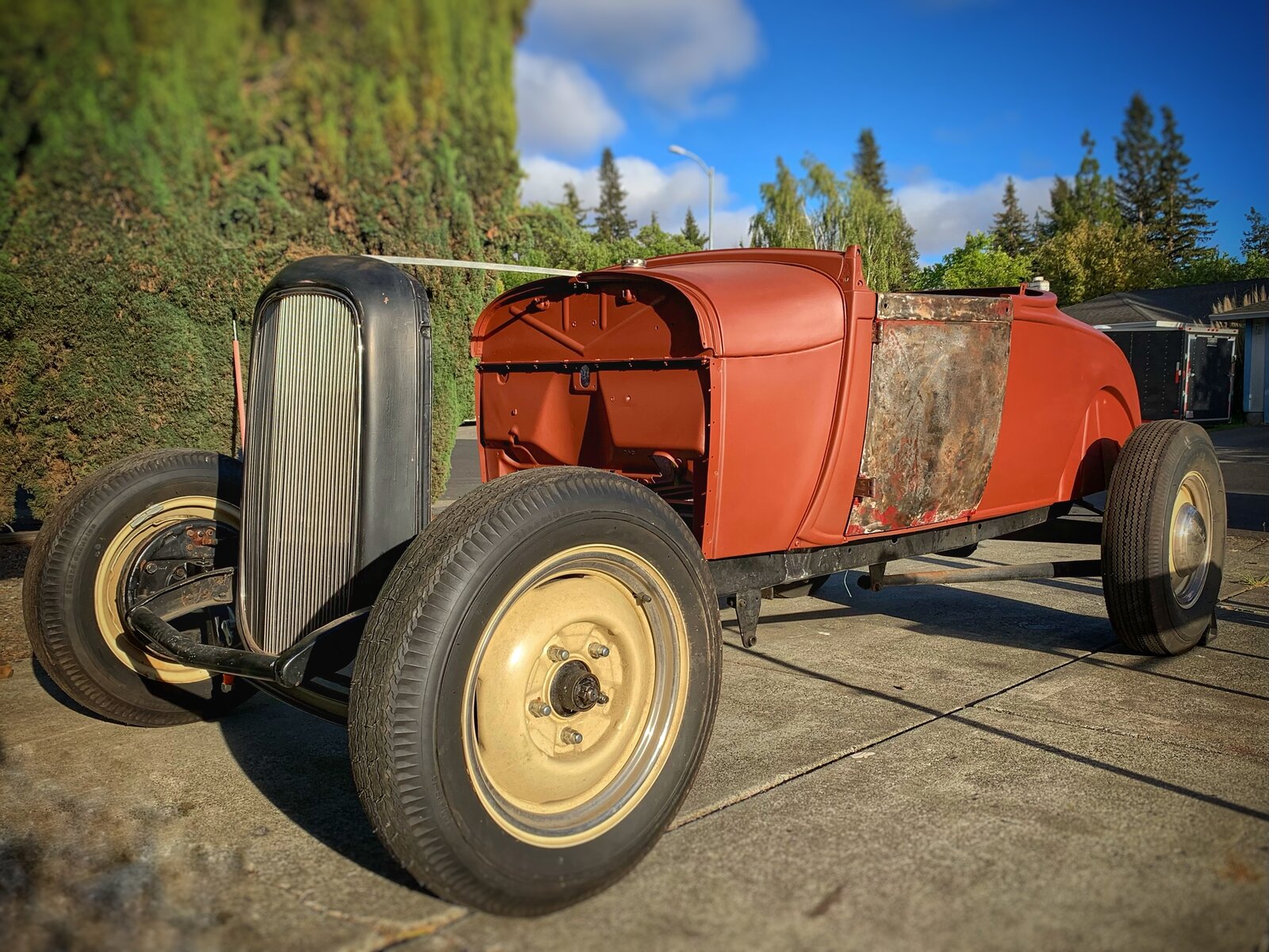

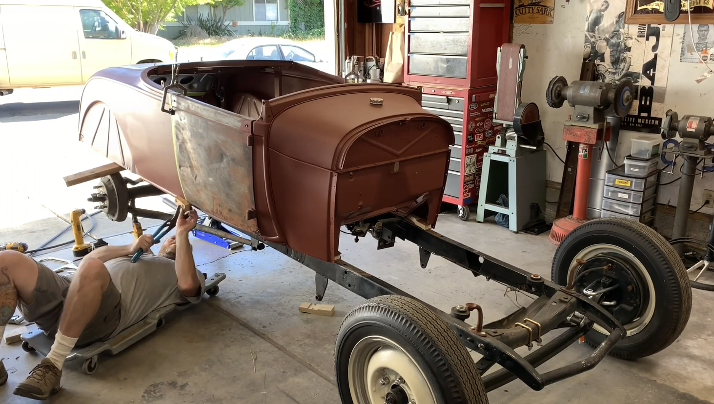

  26. Mounting the Body

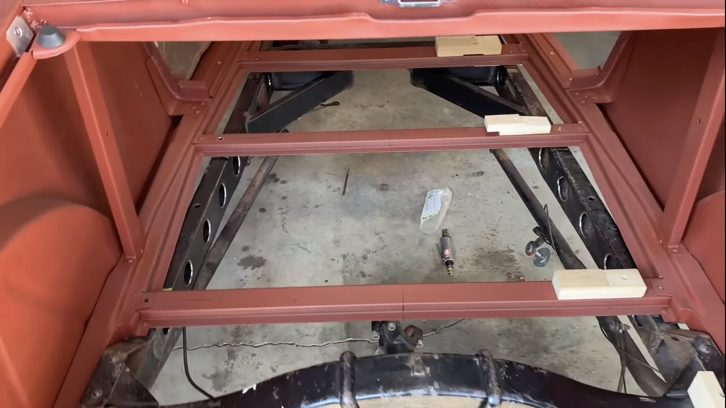

    So, for a while I had been kinda procrastinating mounting the body to the frame. I had forgotten to cut off these weird mounts that the guy who built the frame had added, and I wasn’t sure how to address the body mounts with the boxing plates. Anyway, I decided to quit procrastinating and I just jumped right in.
    I know it’s not very “traditional”, but I have always liked the look of a drilled frame. And I don’t want to go crazy and drill through both sides and weld in sleeves, or anything like that, but I kinda figured that I could solve my body mounting issue and accomplish a cool “look” by drilling holes in the boxing plates in line with the body bolts, and then spacing more holes evenly between them.
    Lucky for me, a 2” hole saw felt a little small in the location of the second cross rail, and I had a 2-1/4” hole saw on hand and decided to drill that first hole that size. Also lucky for me that a 1-3/4” holes saw fit the rail pretty good at the rear rail, because I really didn’t have a plan, but after those two holes were drilled, I decided to go buy a 2-1/8” and a 1-7/8”, and bam! Evenly spaced and decreasing size holes from 2-1/4” to 1-3/4” in 1/8” steps.
    Nobody will believe I didn’t plan it…

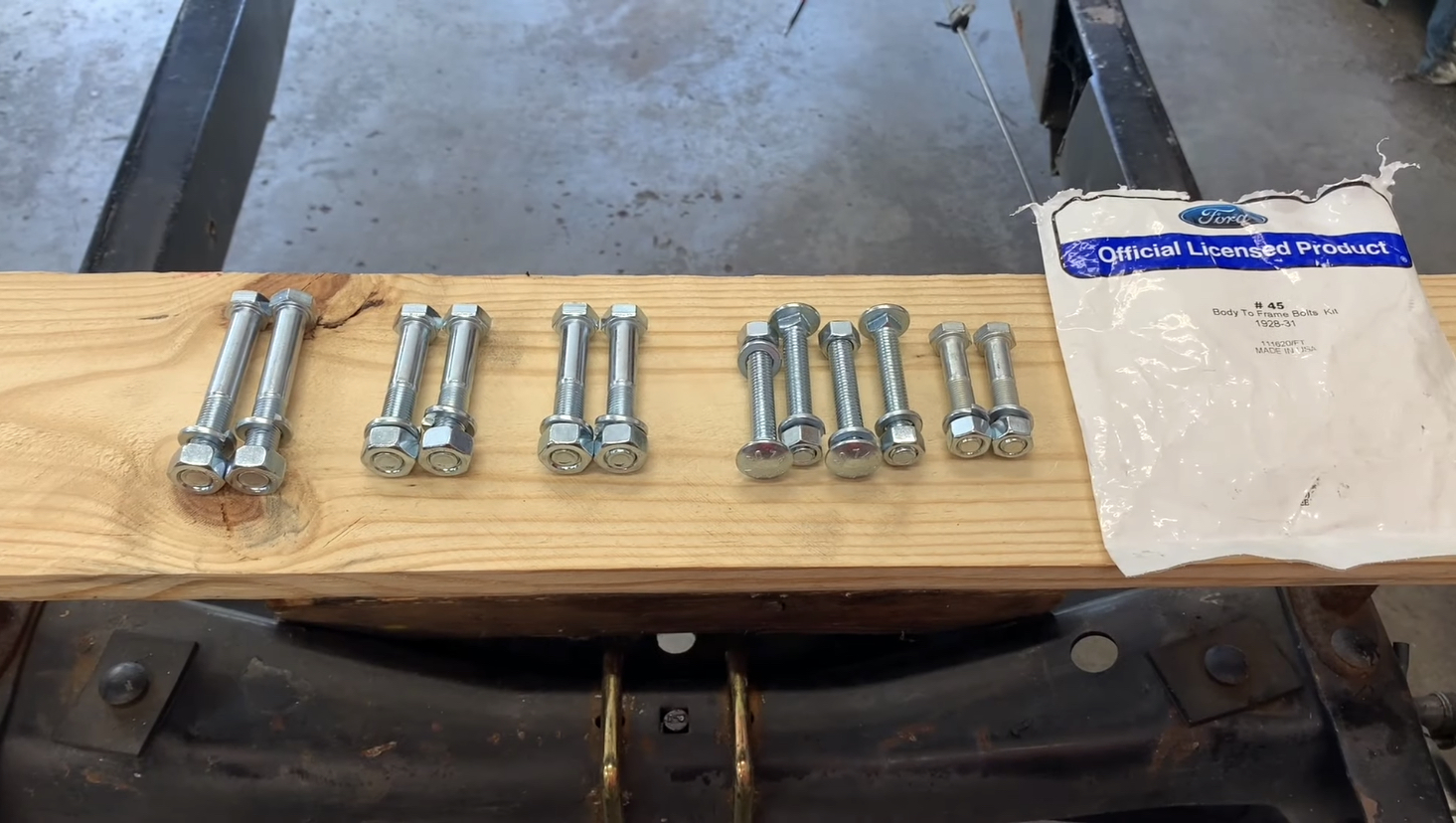

    For those of you following along at home, this is the correct orientation of the body blocks.
    And this is what comes in the bolt kit. It’s a good thing I’m not running that rear mount, because they didn’t give me enough bolts.

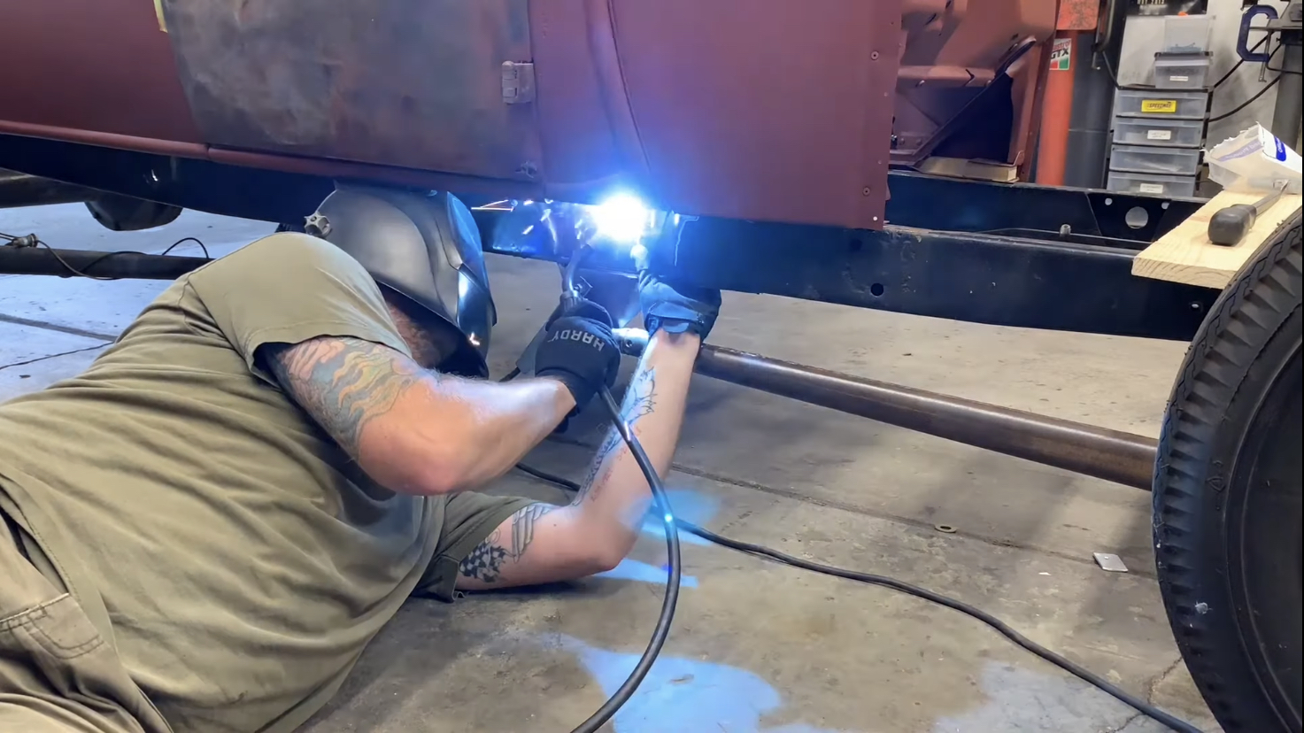

    Test-fitting the cowl mounting bracket. I’m unsure if this was a Sedan frame, originally, or if the PO had just relocated the brackets. Either way, I had previously cut them off and ordered these from Brookville.
    Just a few tacks for now…
    And there she is!
    Next steps will be to work on the floors…at least in the rear portion of the body. I basically want to ****on up everything that is keeping the rumble lid from going back on.
