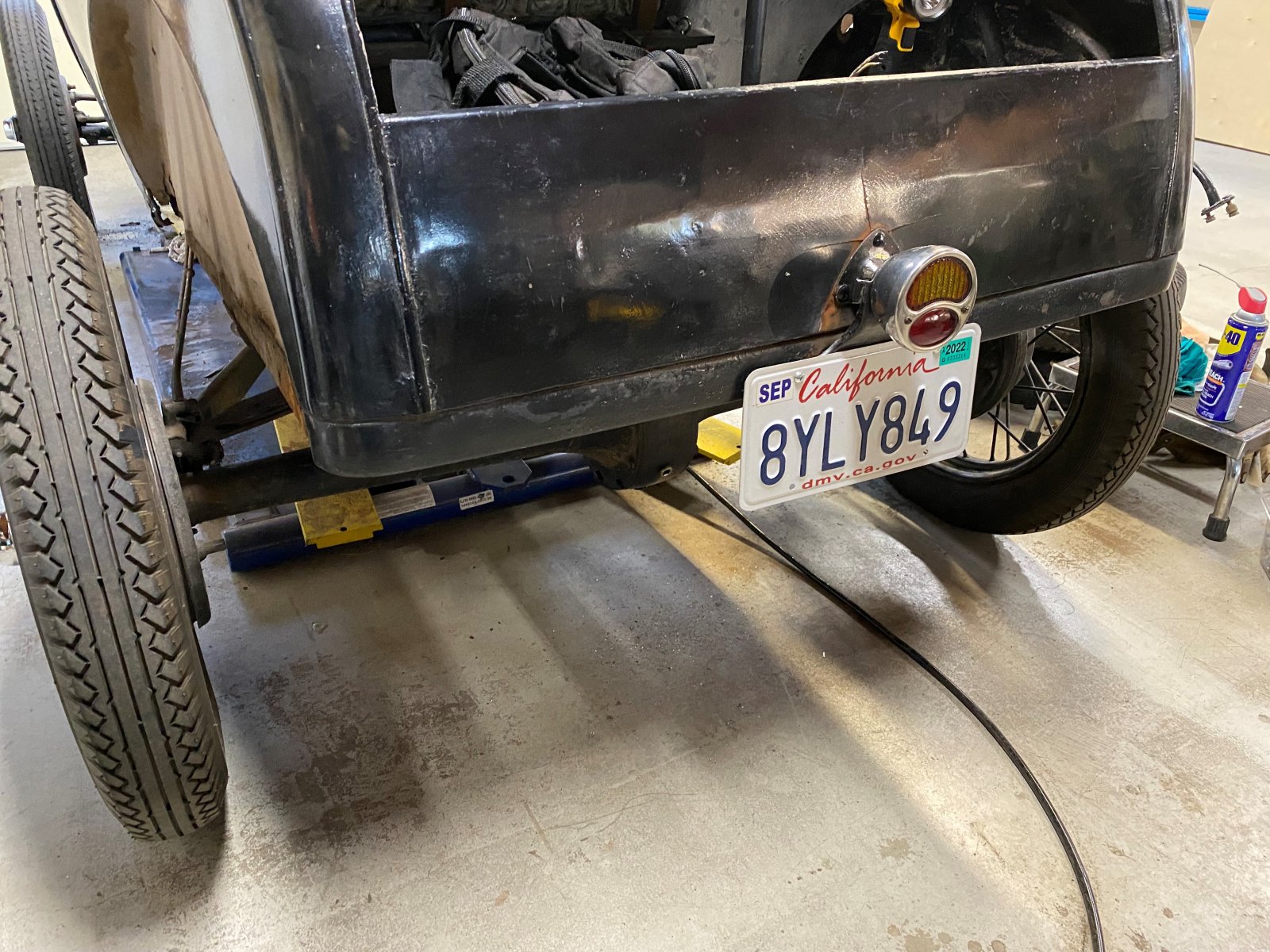

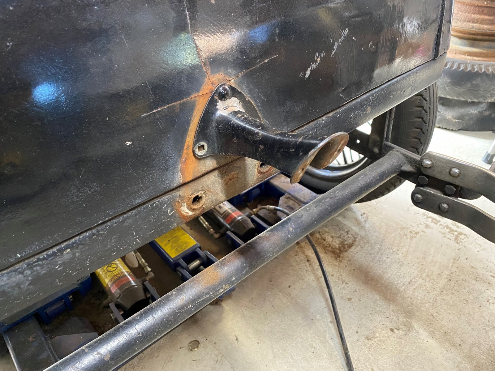

    Looks like the roadster is coming along great, Casey! I did the same with my tail light. Just modified the stock bracket and used the stock plate mount. Placed it where the spare tire mount was. Keep up the great work! Tail light 1.jpg Tail.jpg

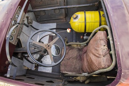

    There are two historic cars that have been the biggest inspiration for my project. The Williams Bros Roadster, and the Morris Bros Roadster. I could go on and on about all of the things that I dig about each car, but the spartan “race car” interior is high up on the list. And both cars used surplus WWII aviation componentry inside, including “bomber” seats and B-24 breathing oxygen tanks for fuel.
    Some close ups from the Morris Bros car…
    And the Williams Bros car…

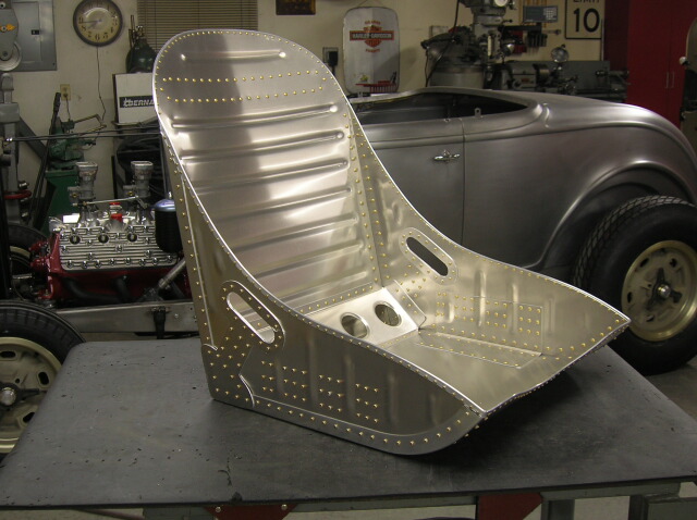

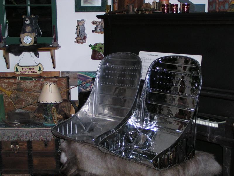

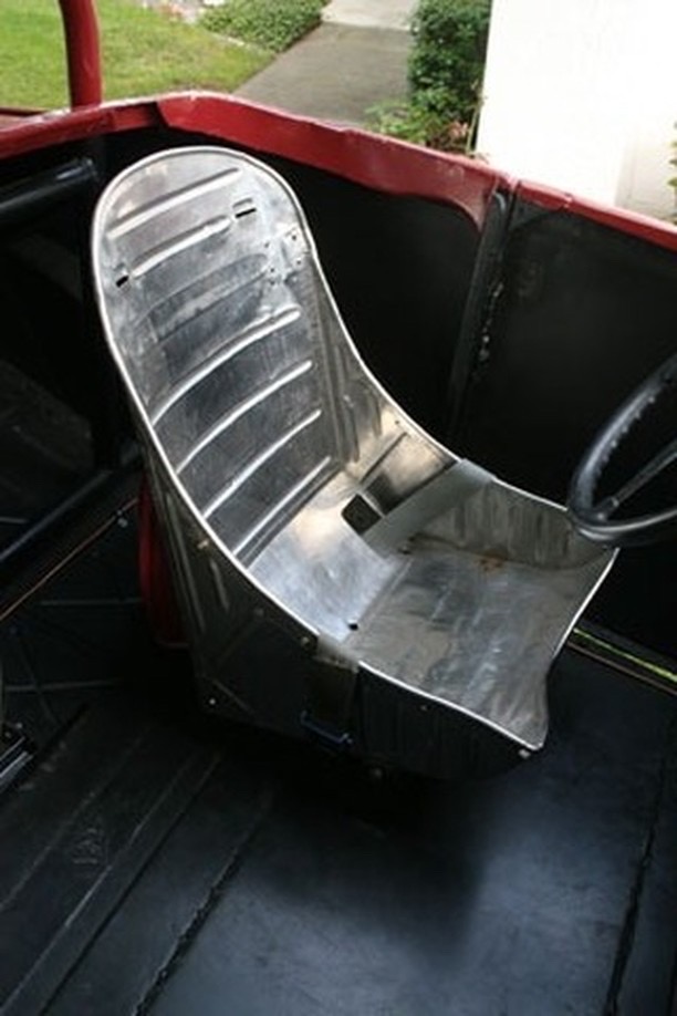

    After digging through the HAMB archives, I’ve decided that the seats Frank Wallic used to make and sell, are the best looking and most authentically styled “bomber” seats out there.

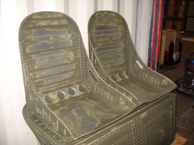

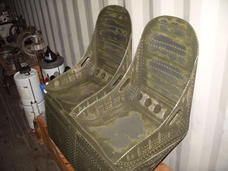

    They seem to be a “sort of” copy of whatever these seats are:
    I’ve heard some people say that these are T-6 trainer seats, others have said T-34, and at least one person said that they’re late P-51 seats (as the early ones were plywood), but I’ve also been told that all of those people were wrong. Lol.
    Either way, I find certain aspects of Frank’s seats, like the lap belt p***-through reinforcement plate, and the dimple-die reinforcement brace, to be more pleasing to the eye. And aluminum will be a hell of a lot easiest to work with than stainless.
    Since Frank doesn’t make these seats any longer, and since his were a copy of an original seat anyway, I’m going to do my best to sort of “reverse engineer” a set based on the few photos that I can find online.

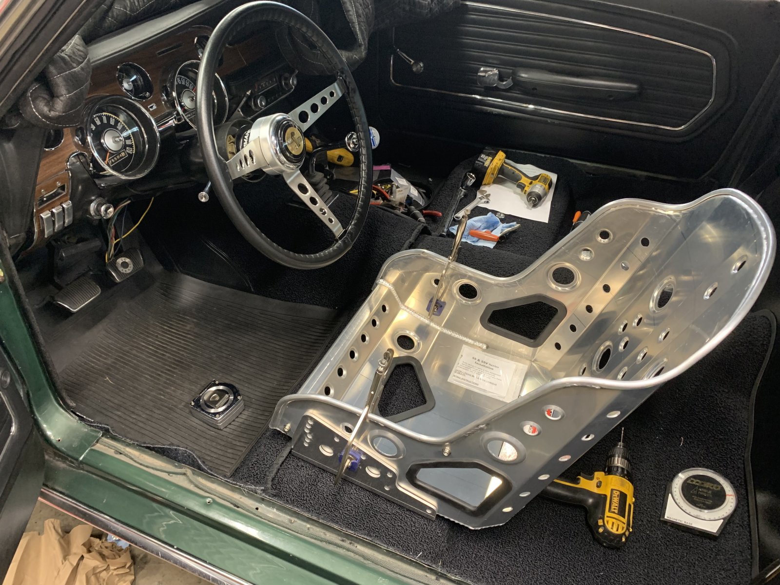

    And using the dimensions from the Kirkey 55 series race seats in my Mustang as a sort of gauge of scale:

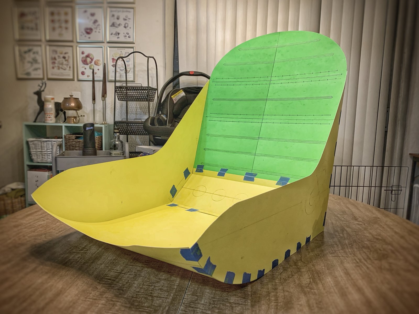

    I have come up with the following set of patterns, shown here ***embled with blue painter’s tape.
    They still need a little bit of tweaking; the pan is too deep, and the sides are too tall, but I’m at least close to the general shape, and I’m excited to start the process.
    The next steps will be to reinforce my Harbor Freight 18” Bead Roller, and see if it will handle 14ga aluminum, which is what I would like to build these seats out of; if it won’t handle 14ga, then I will have to make them out of 16ga.

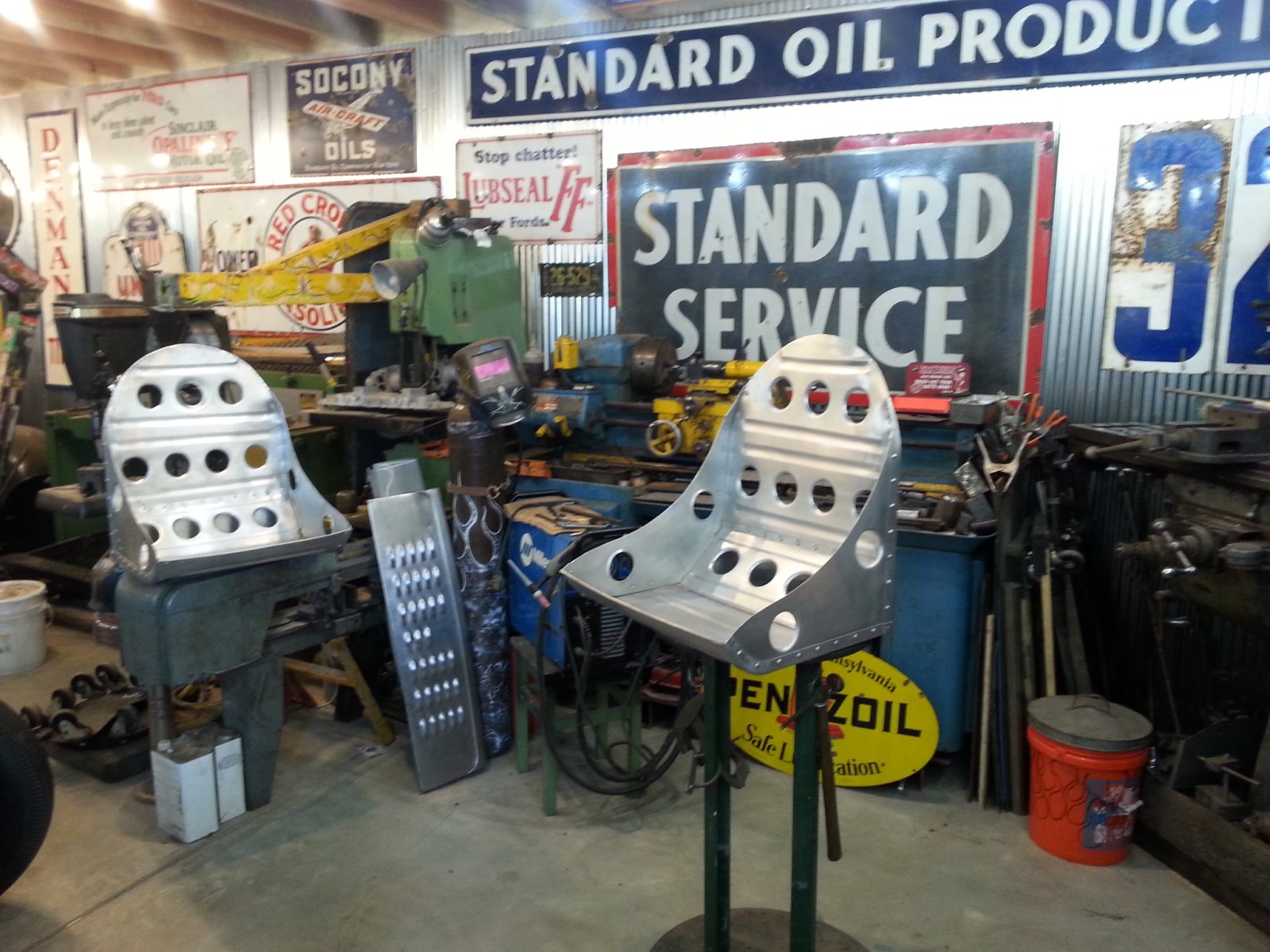

  9. Gosh…
    Over a year later, which is pretty embarr***ing.
    In my defense, my daughter hit Toddler-hood, AND we moved states, so I’ve been a bit busy. Anyway, I finally turned those Bomber Seat paper templates into something tangible, though I didn’t exactly do it in the “traditional” way…
    Hope you guys like the video:
