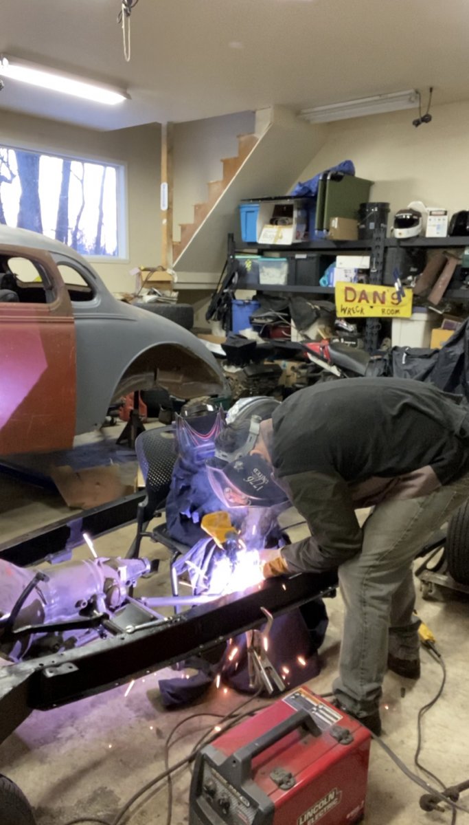

    Buddy came over today to help me line up the under car brake pedal ***embly, so I didn’t have to zip tie the pedal to my foot when trying it out lol.
    Rather than drilling a bunch of access holes for bolts (on the top hat frame you shouldn’t put bolts all the way through or you’ll sand which the sheetmetal frame like @rusty1 warned me about when doing my shock cross member) I decided to weld it on.
    You know you’ve got a rock solid friend/helper when you walk away for a water and they jump in and start welding the next seam!

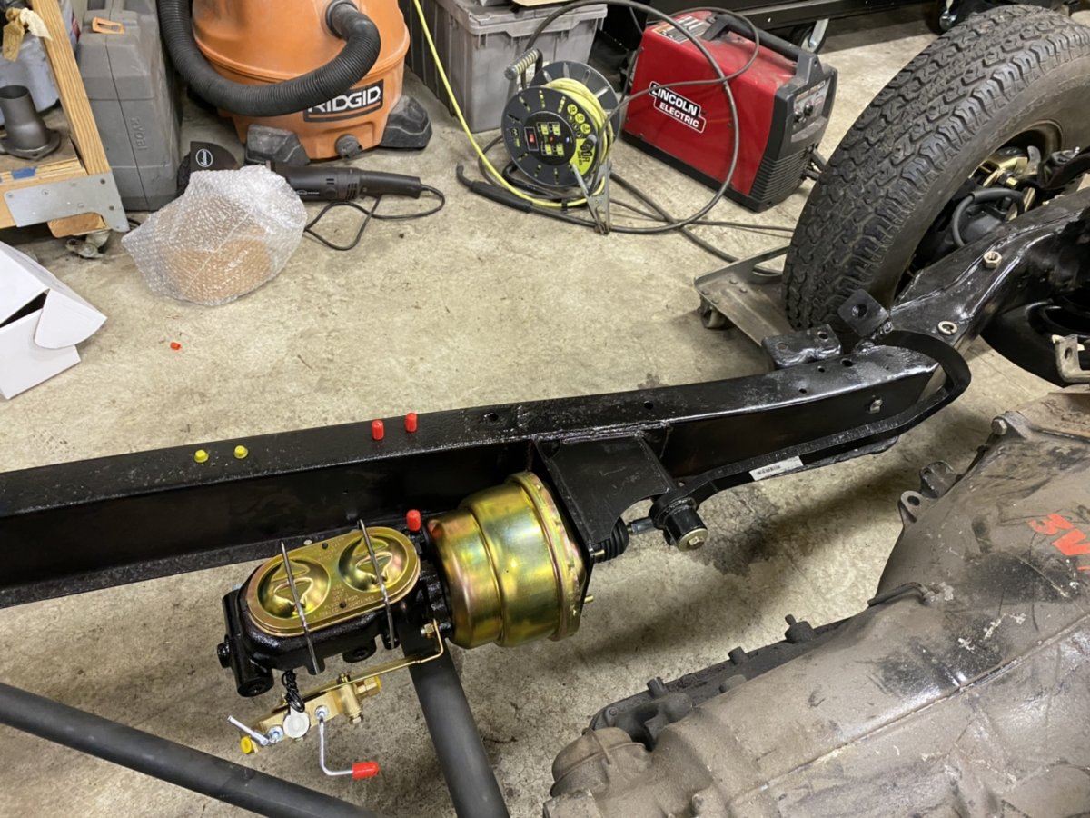

    Painted the master cylinder and did a rough mock up. ***embled as is, the pedal is clocked to the fully depressed position. I’ll have to extend the input rod to the booster. Alternatively I’ll likely cut off the output tab, reposition, and weld back to the pedal.
    I also have some interference with the trans cross member brace and proportioning valve. Given it’s not a race car I may just remove the braces rather than notching to clear the proportioning valve.

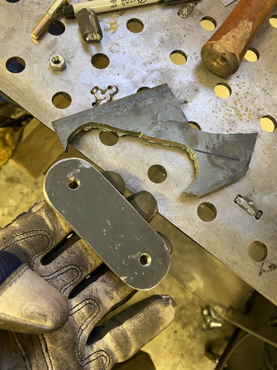

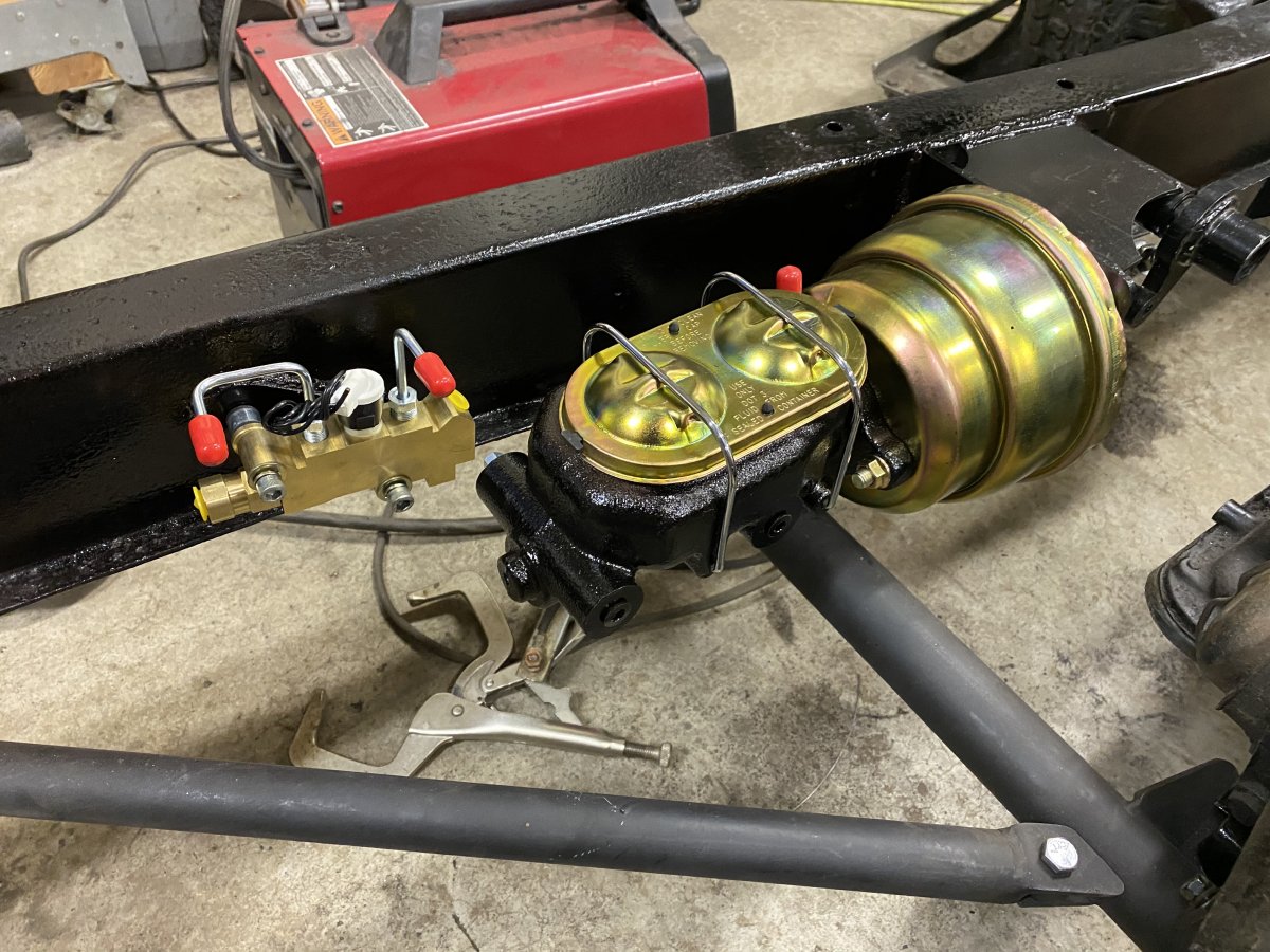

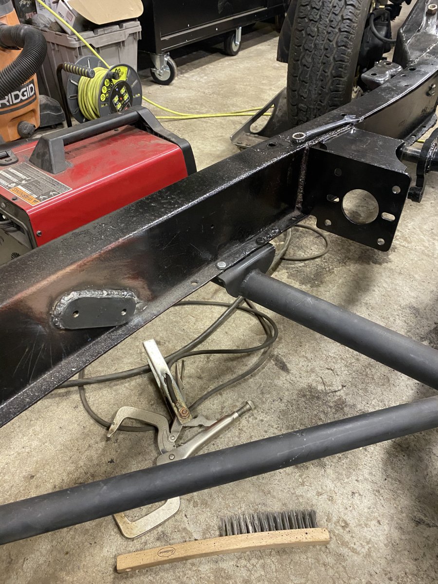

    I decided I wasn’t going to use the proportioning valve bracket that came with the master cylinder. It was going to interfere with the trans cross member etc like I mentioned in my last post. But something I didn’t mention, is since the master cylinder is backwards, the proportioning would be backwards as well, which would make for messy brake lines.
    Instead I made up a plate, tapped holes in it, welded it to the frame, and spaced it so the brake lines would p*** the bottom of the flange on the frame.
    Took the opportunity to give my daughter another MIG welding lesson!
    End result came out much cleaner. Bending the brake lines to connect to the master will be frustrating, but well worth it in the end.

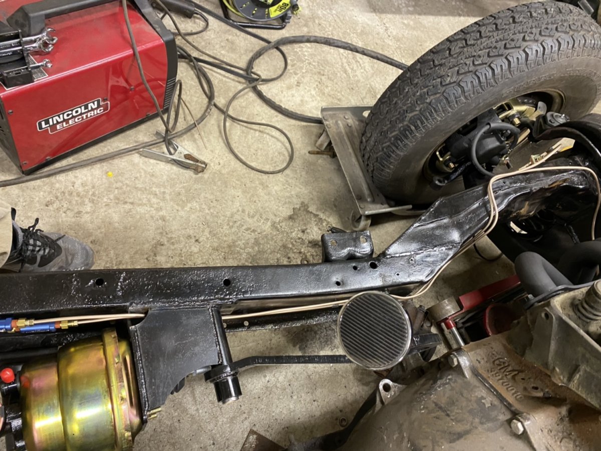

    Not super exciting progress, but I ran about half of my brake lines with residual valves today.
    Waiting on some fittings to do the rear axle and two front lines.
    Next up ill likely be making the exhaust system
    TFoch, Bowtie Coupe, brEad and 3 others like this.
  16. patman
    Joined: Apr 30, 2007
    Posts: 631
    patman
    Hard to tell from that picture angle, but...if those lines are above your MC, it's going to be tough to bleed. Pressure bleeder maybe?
    loudbang and oneratfink57 like this.

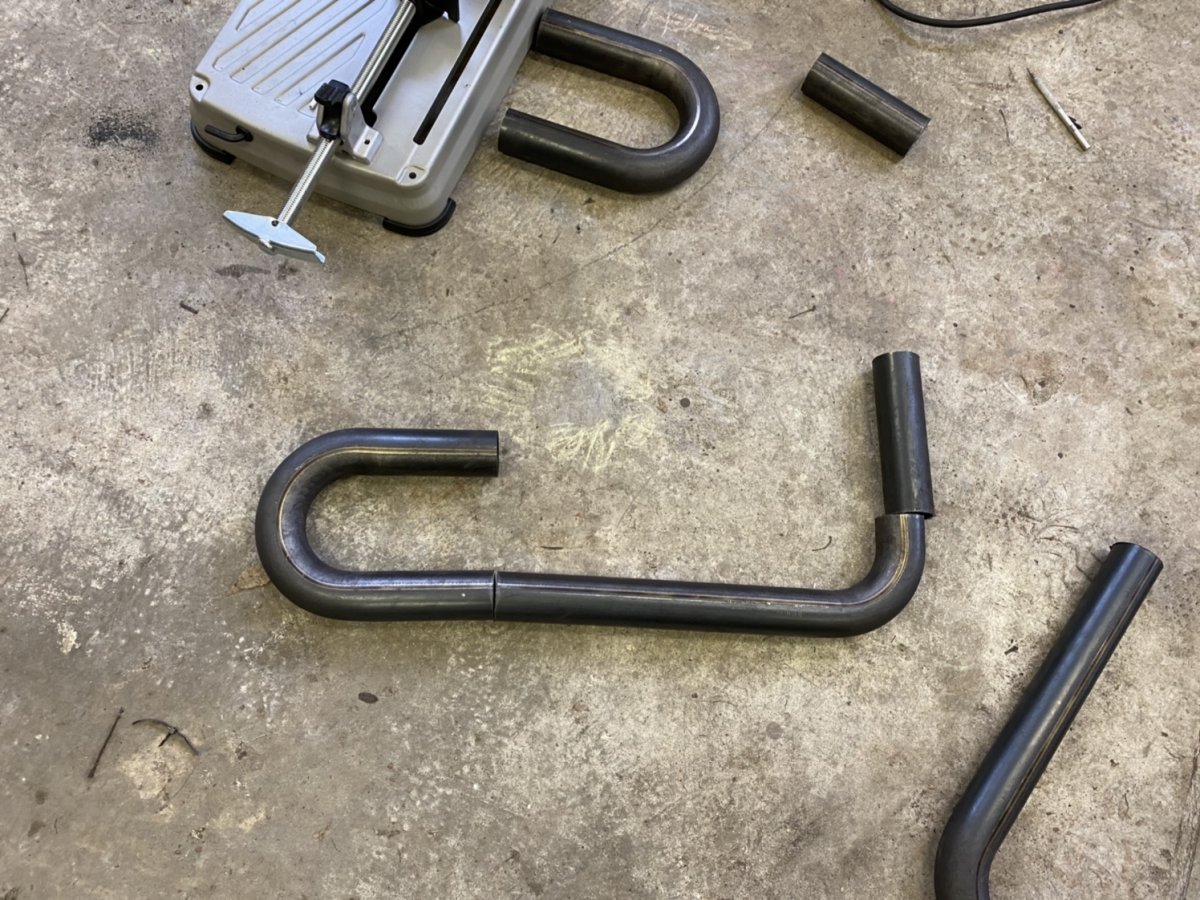

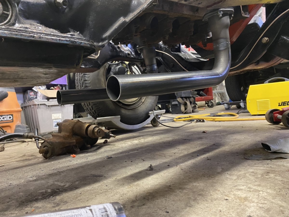

    Finished the exhaust back to the mufflers and mounted the fuel pump today.
    Started with just a couple pre bent 2” exhaust sections and made the down pipes from the headers.
    Then welded some pipe extensions to extend back to the smithy’s mufflers. If it looks bent it’s because it is! Had to cut the pipe at a 2 degree angle to kick it back up a little bit

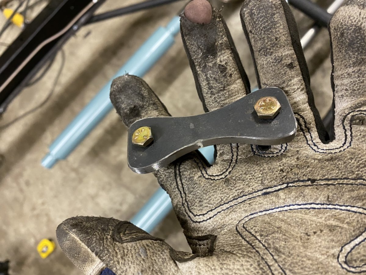

    For mounting the exhaust hangers, I drilled two holes in the trans cross member and used some 3/8” weld nuts so the hangers could be removable if the rubber bushing ever wore out.
    I also made a threaded plate (out of the drop I still had from the proportioning valve plate) so I could bolt the fuel pump to the frame without having to drill access holes.

    Welded up tail pipes today. Just need two more hangers
    I’ll bleed brakes this weekend, make sure there’s no leaks, and the body can go back on the frame.

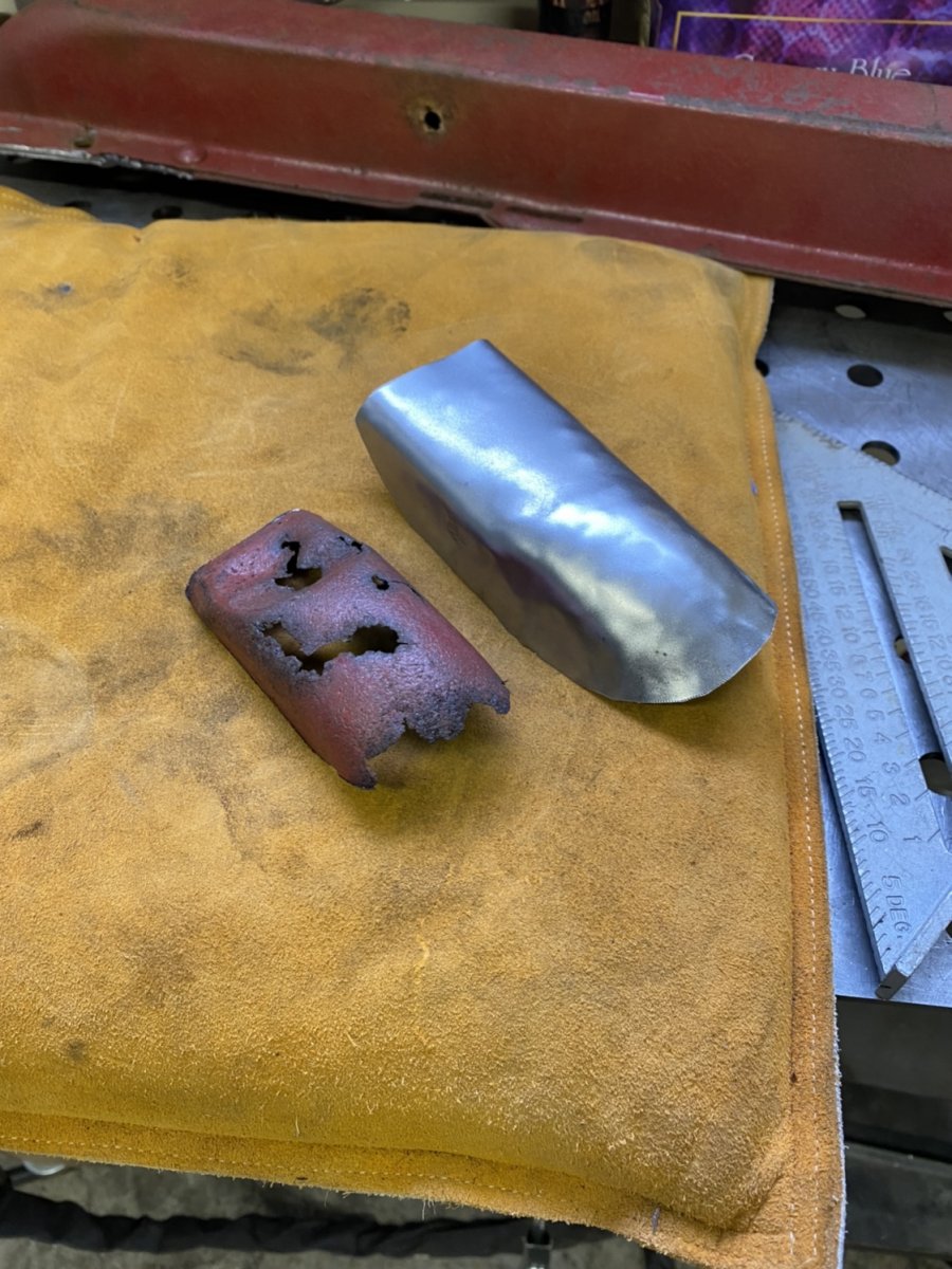

    Fixed some rust on the rearmost cross member. Used a stump, sandbag, and mallet to make the patch.
    Also used the threaded bosses on the shock crossmember I made to mount the rear exhaust hangers
