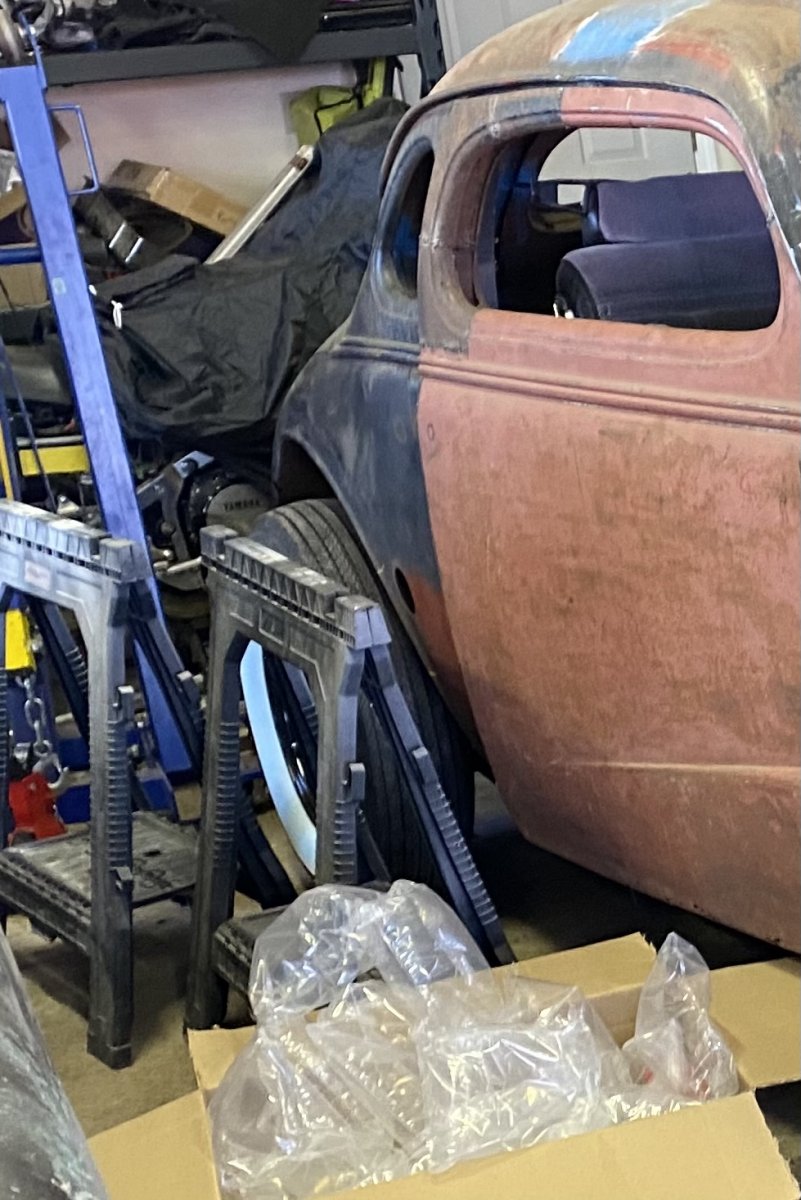

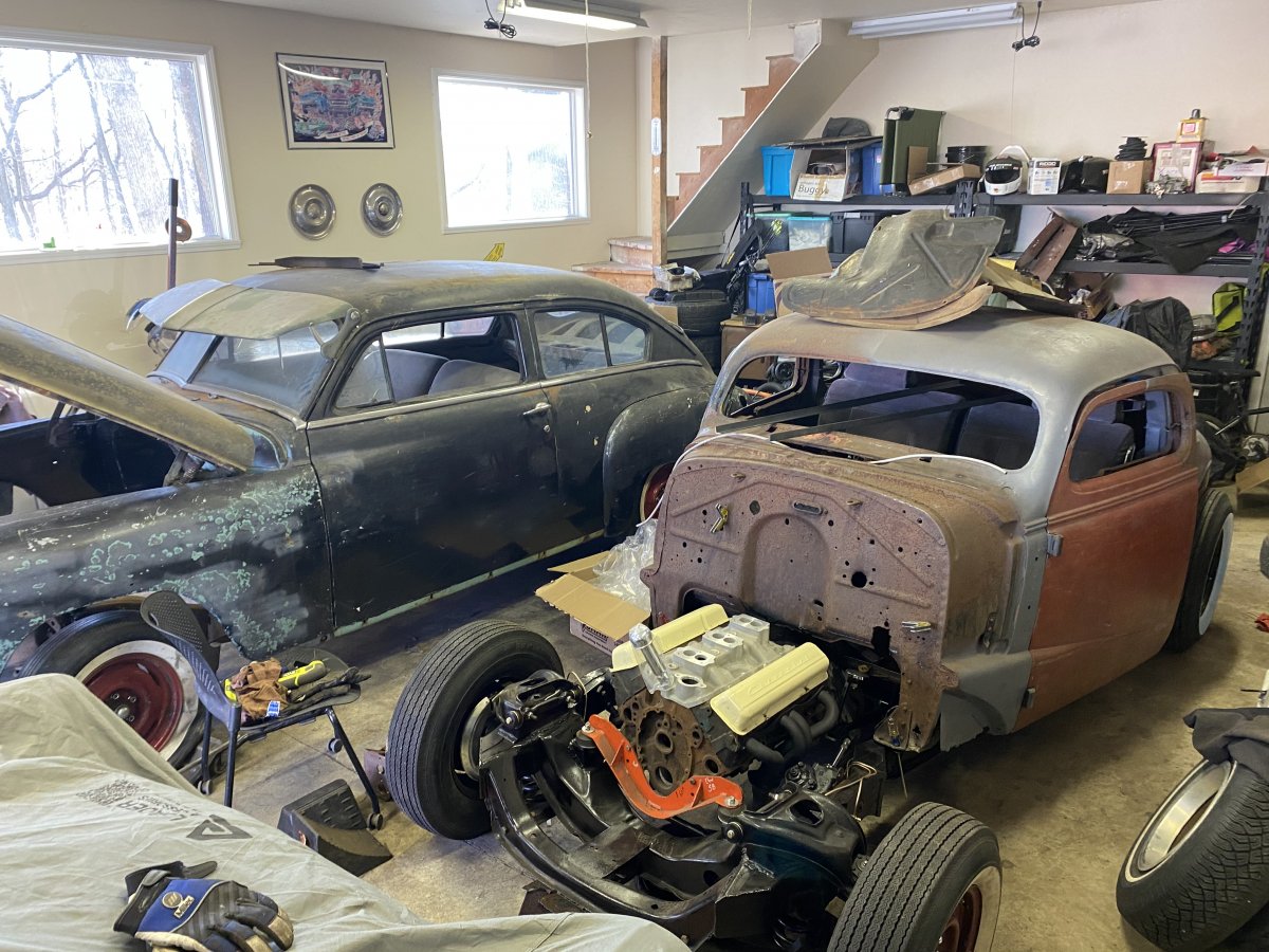

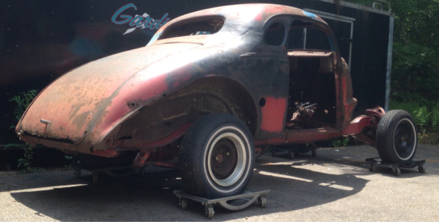

    It’s getting crowded! Had to shuffle everything to help a buddy replace the front diff in his Sierra.
    This weekend might be dedicated to just cleaning up the shop.
    one cool observation was taking note of the before and after ride height. The tire is bigger, but between channeling the floor and lowering the suspension, I got the 4 to 5” of drop I was looking for
    Before:
    After:

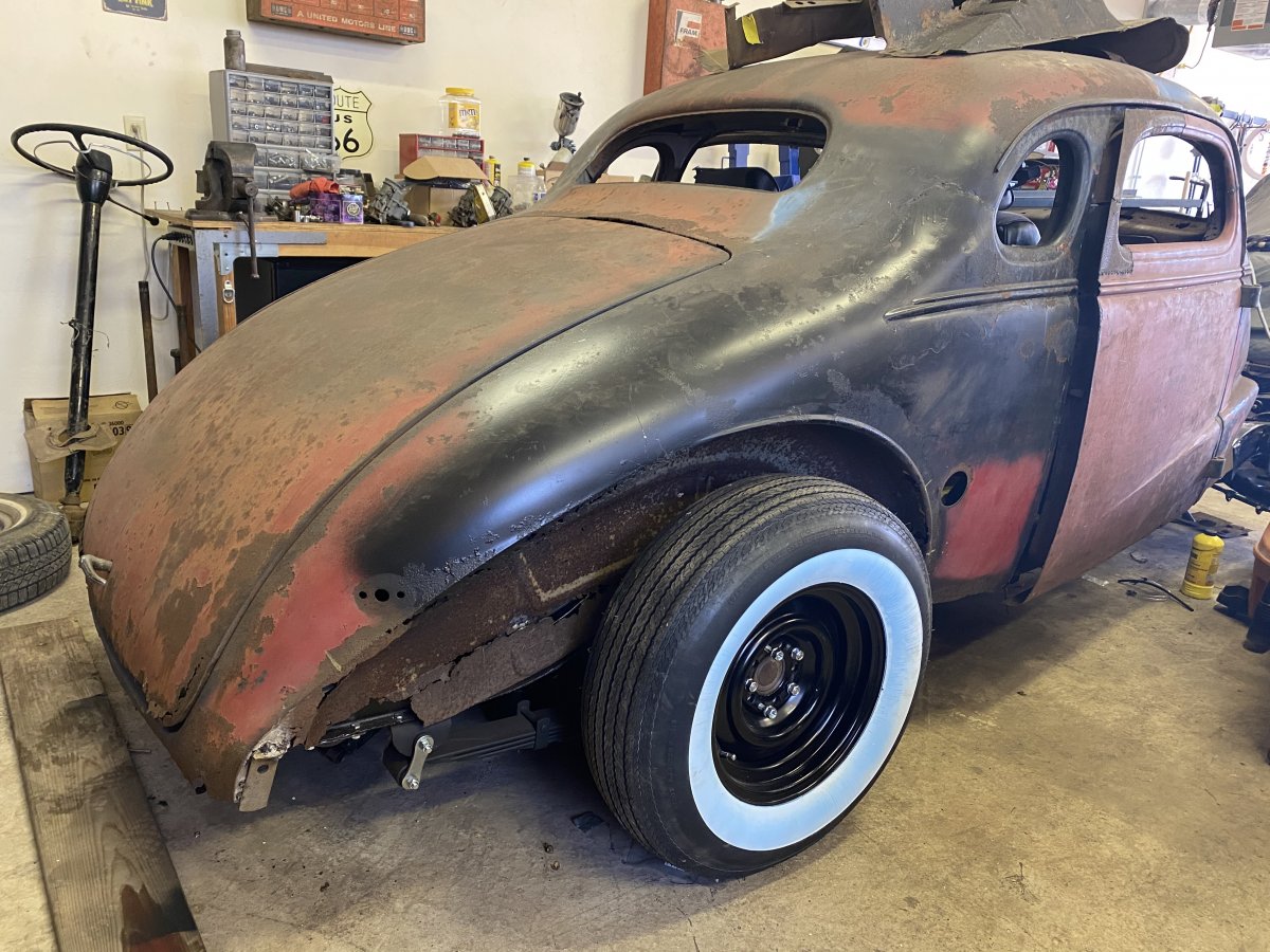

  16. oneratfink57
    Joined: Feb 12, 2006
    Posts: 785
    oneratfink57
    from Wisconsin

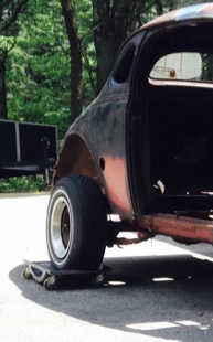

    Another ride height before and after
