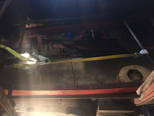

    Made some more progress this afternoon. Turns out the bottom of the drivers door opening spread open about 3/4" past what it should be during transport. Before I made too much progress on the floor I pulled the geometry back to where it should be with a ratchet strap accross the two cross supports. Then tacked in a door opening support of the correct length

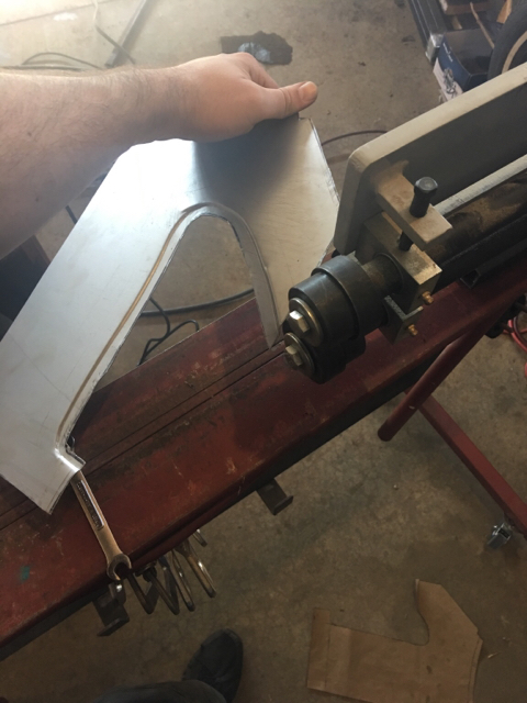

    Now that the coupe was relatively square again. I started to work on planning the floor. I realized the 4 corners of the body where the the floor would essentially attach to the body was roached.
    So I pulled out the fabrication station and started making some panels. Since most of the steel was gone, some guesswork was involved
    Started the fab process again by planning the panel with masking paper.
    I used to let my daughter write on my coke cooler welder cart with paint marker, then I'd prime over it so she could start over. I don't think I'll ever prime over it again though. Memories!
    Chose the closest set of bead roller dies I could
    Then formed the offset needed to connect the panel to the rear quarter
    It's not perfect, but fits like a glove!

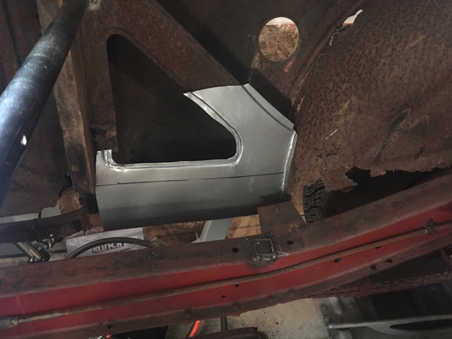

    Then fabbed the drivers front Seen below
    P***enger front panel
    P***enger rear panel

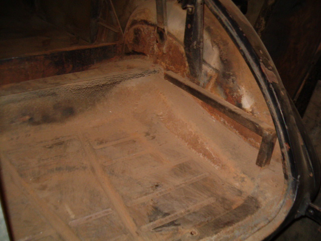

    The last step of the day was to weld some "new" angle iron where the original angles were.

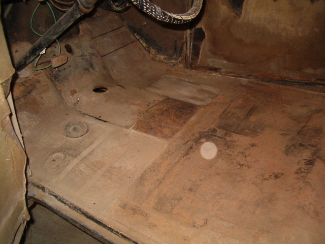

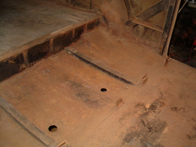

    For those of you 37 guys out there. What the heck are the angles for? Are they gas tank brackets? It's my understanding the gas tank is behind the drivers seat in coupes

    Not sure if those angle brackets are for the tank, I never had a coupe, but my 37 sedan does not have them. The tank is underneath in the sedan. You are probably right, hopefully a coupe expert will chime in. If not PM Raymay, he has had a bunch of 37s and is a very helpful knowledgeable guy.

    ..that angle was used to lay the plywood floor cover over the gas tank. The tank sat on these 2 wood supports shown in this pic, a piece of wood stood up along the front of the tank supported the plywood also.
    kidcampbell71 and oneratfink57 like this.

    from Wisconsin
    Thanks for the info and pic! I made sure to save that one. Not too many 37's floating around to reference. Especially this time of year in Wisconsin lol

    Actually if you have any other pictures of the factory floor (and trunk floor) that would be appreciated!

    Thanks for the pictures rusty1! They will certainly come in handy

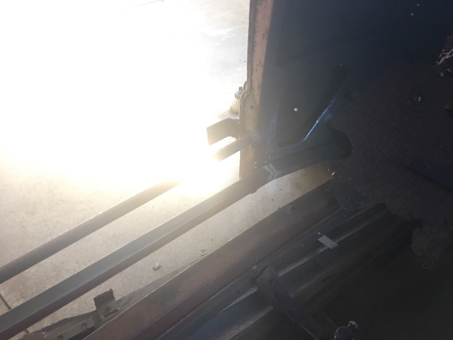

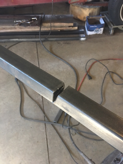

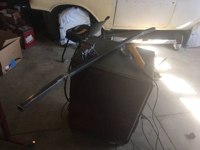

    I was able to get the outer most portion of the floor structure done today, but I ended up running out of square tube so I didn't get a whole lot of progress.
    For the couple of bends I needed, I went with the notch and weld method
    Below is where it mounts to the new patch panels I made last weekend up front.
    To give the main rear mounting points a little more support. I welded some vertical square tube up to the gas tank cover angle iron
    Once I get some more square tube, I should be able to complete the floor structure in just a couple of hours

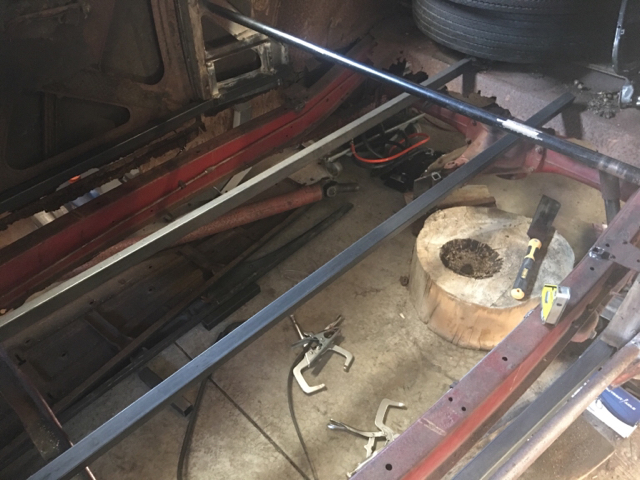

    I ended up raising the floor 2-1/2", but the body will only be dropped half that because of the tube structure.
    So at the end of the day the coupes got a 3" chop and a 1-1/4" channel.

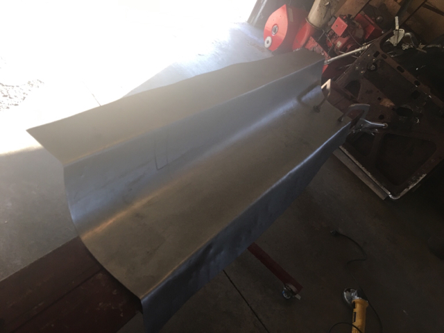

    Got my square tube on Friday and was able to finish up the p***enger compartment floor structure this afternoon. Welded 3/4 of the way around. I'll wait to do the overhead welding for a rainy day
    Then I moved on to the driveshaft tunnel so I can tie the two halves together.

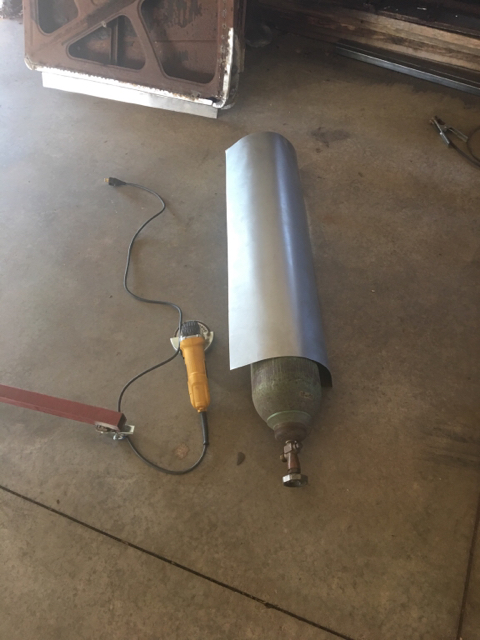

    I had this old empty oxy bottle my dad gave me, and I planned the floor dimensions around the 3.5" radius to form the tunnel
    Formed the radius
    Formed the legs
    I bought a cheap planishing hammer at northern tool that I'll use to smooth out the imperfections. Once I cut the legs down to the 1-1/4" length of the tube, I'm going to chase the perimeter with the bead roller to add a little rigidity
