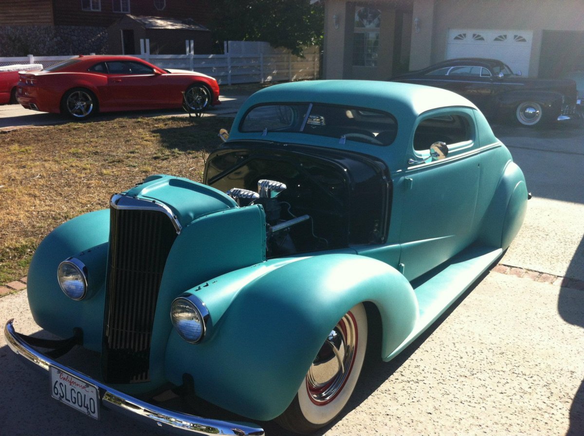

    *****in work! Heres a few shots of our 37' we built a few years back... 562281_10151161183528362_968203127_n.jpg 468732_10151200271663362_2013099907_o.jpg
  21. oneratfink57
    Joined: Feb 12, 2006
    Posts: 785
    oneratfink57
    from Wisconsin
    Wow very cool! One of these days I hope to get there, thanks for sharing!
