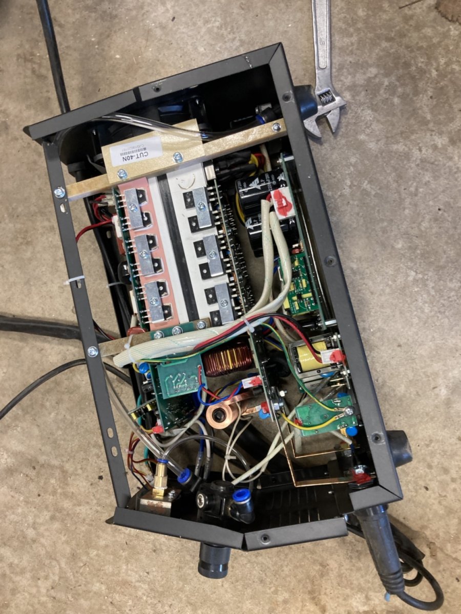

    I really wanted to use my tig welder for this, but I wasn’t able to make it to airgas on Friday to refill my argon bottle. So flux core MiG it is!
    I used the digital angle finder to find the angle of the frame so I knew how far I had to rotate the tube. I had to do this so that when I drilled the holes, they would be parallel to the floor. 12 degrees!
    I only had a 7/8” hole saw (I think it came with a kit to install exterior door padlocks) that I would use to cut the holes for the 1” diameter bosses..
    I had to follow up with a die grinder and rotary file to open the holes up so the 1” bosses would fit, then welded them up with the MiG.
    Then disaster struck! Or stupidity... I was in a rush to finish up for the day because the wife wanted to go to the grocery store. So I hooked up the air to my plasma cutter at 150 PSI and I blew apart an internal air hose disconnect connected to the internal air/ water separator. I’m lucky that that’s all that happened, and that the hardware store is on the way to the grocery store!
    So once the plasma cutter was back together I transferred a half circle using a contour gauge to the steel plates, and used the newly repaired plasma to cut the bulk of the bracket corners down. I cleaned up the edges with the belt sander and angle grinder with flap disc.
    Finally I clamped the cross member to the frame, used two existing holes in the frame to drill mounting holes in the cross member, and then drilled one interior hole on each side. Had some 5/16” Magniblack Allen cap screws that “sort of look like” factory rivets so I used those a for mounting hardware.
    Voila! I wound up with approximately a 20 degree angle on the shocks. As I recall a 15-30 degree angle is optimal. The upper Mounting location ended up being about 6” from the inner face of the frame rail.
